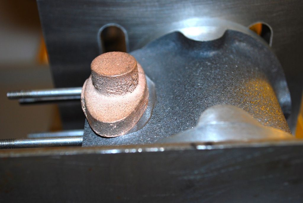

      Didn't get much time this morning, couple of quick photo's of what I did get done, along with setting up the Steam Exhaust Flange in the lathe ready to start working on it tomorrow…
      I think its lucky for me that I left this one until last as it look likes it may the most difficult to get right. The cast hole is way off centre in the tiny raised boss on the Cylinder and I would be struggling to even attempt this and the flange with a file – as it is I'll no doubt find it difficult on the Mill as the boss almost becomes flush with the circular bore of the casting on one side..

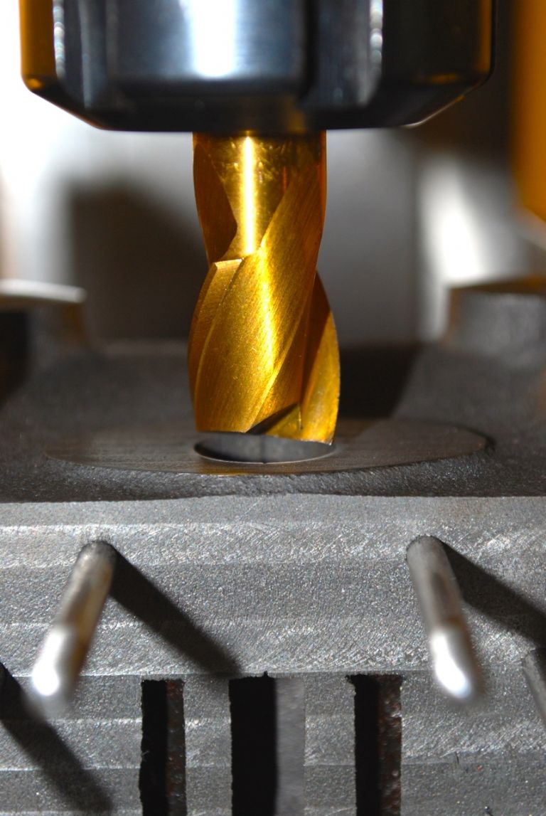

      The flange will likely sit in this approx position to line up with the exhaust hole in the casting.. The Boss on the flange as cast is slightly undersize and there is likely to be very little material left once it is drilled for tapping. Also I don't know if it can be seen very well in the photo but the boss doesn't seem to be quite straight coming off the flange base and with so little diameter material to skim….just have to see how it goes I guess.
      The cast hole is not very round, which is fair enough, but I thought I had better tidy up the mouth of the hole so at least to have something to centre on when fitting the flange. The hole is not vertical through the casting but after a short way in slopes up to the steam ports and is quite a good clean cast I think. The drawing says 7/16" for the hole but it is already a good bit larger as cast. I've used a 14mm Slot Mill to tidy the hole just to a 2mm depth which I can also use to centre… 452. the steam exhaust 6..jpg
      After tidying the mouth of the hole.
      The potential for me to get this one wrong in some way is quite high I think..! But all very interesting to do.

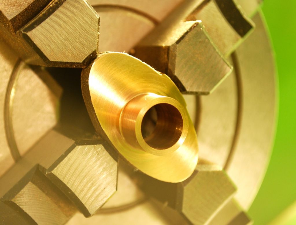

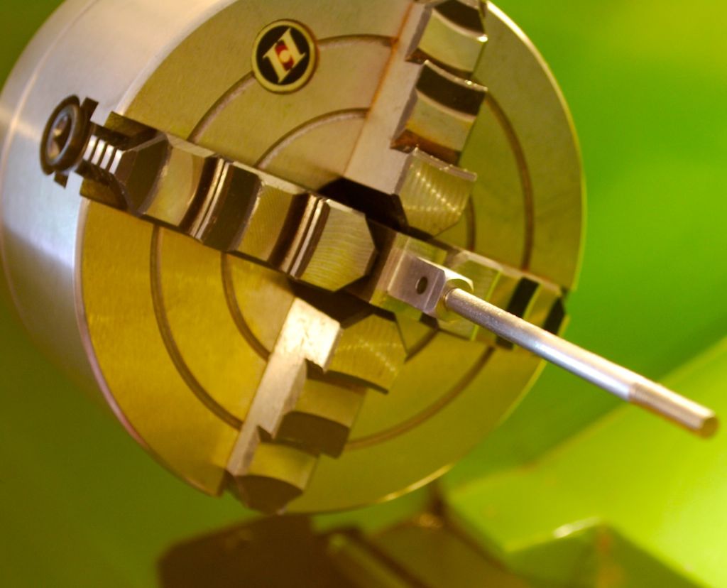

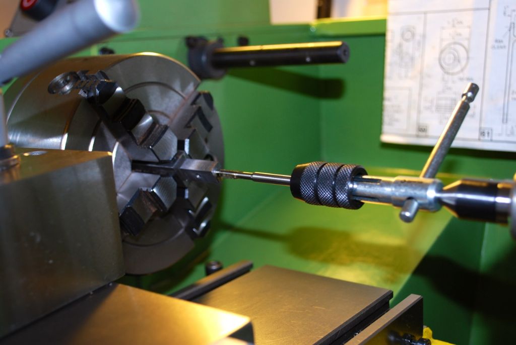

        Waiting now for the 1/2" x 26 tpi BSB Tap which should arrive later today. The OD should have been 5/8" but after being as careful I could setting it up in the Lathe the earliest I had a clean diameter was at 1.3mm undersize (last skim was 2 thou) so I'm hoping the wall won't be too thin – think it will be alright. The Exhaust hole looks quite 'chunky' and I can imagine quite a lot of steam flowing out of that, maybe it will need to be run outdoors or at least venting through a window…
        Drilled to 11.5mm tapping size. The wall is just over 1.5mm thick. Unfortunately I think I picked the worst of the 4 flange castings for this one – if i had spent more time checking them and the various measurements I could have used a better one and may have got much closer to the correct OD – my fault that.452. the steam exhaust 8..jpg
        Cheers

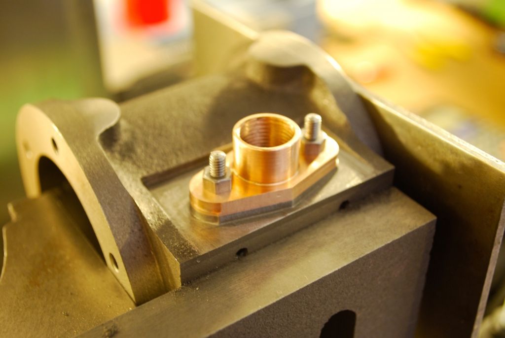

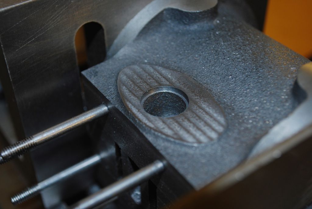

          Almost finished with the 4 flanges now…

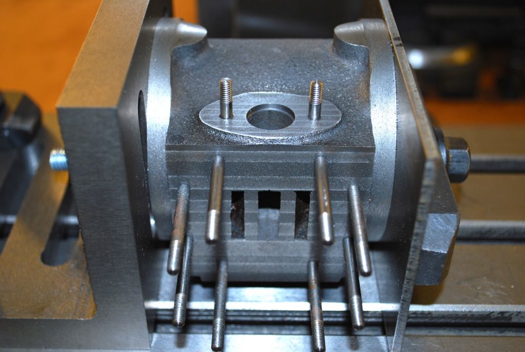

          The Studs for the Steam Exhaust Flange fitted (they are vertical – just a bad camera angle in the photo)..
          'Just' the milling to shape left to do…
          I think I'll probably leave this flange 'long' as its the exhaust – I'll see what it looks like after the milling is done452. the steam exhaust 10..jpg
          Cheers

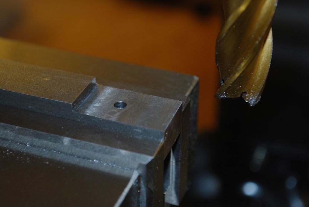

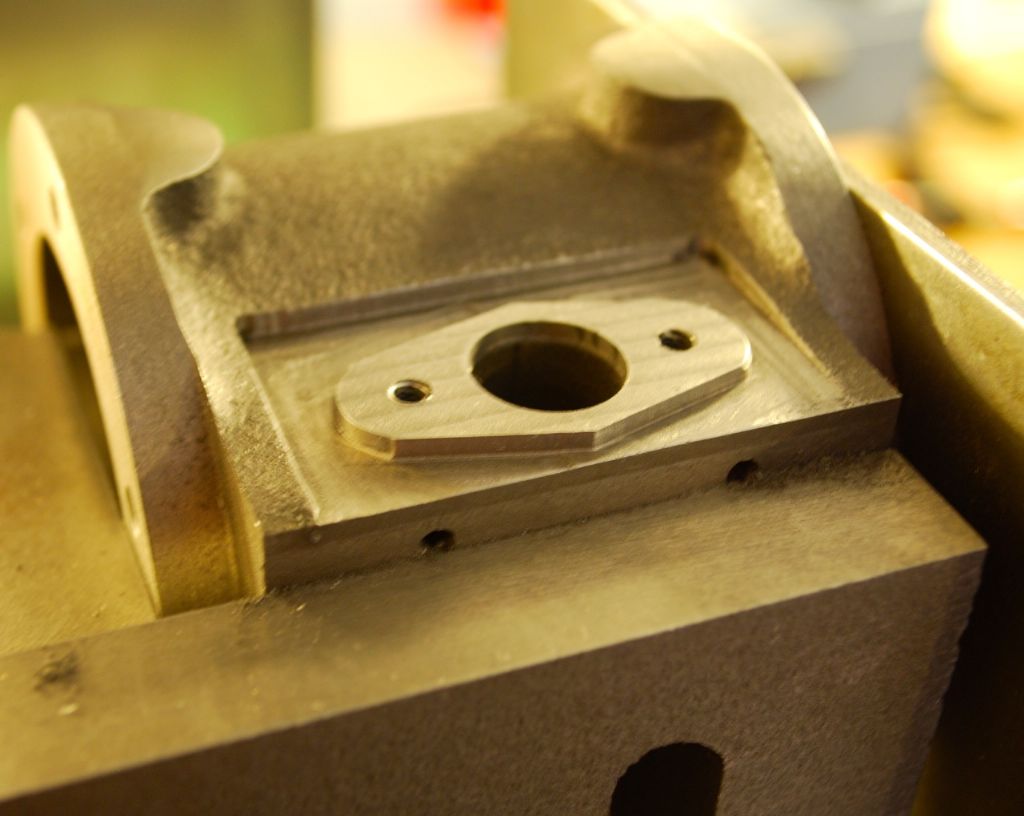

            Have to admit milling this flange with the boss merging with the outside of the cylinder bore was outside what I can do at the moment and I got into a right old mess…
            This was the best I could come up with and had to make a recess for the Flange Boss to sit in….
            Bit disappointed I couldn't do it as it should have been but not too unhappy with the way it looks..

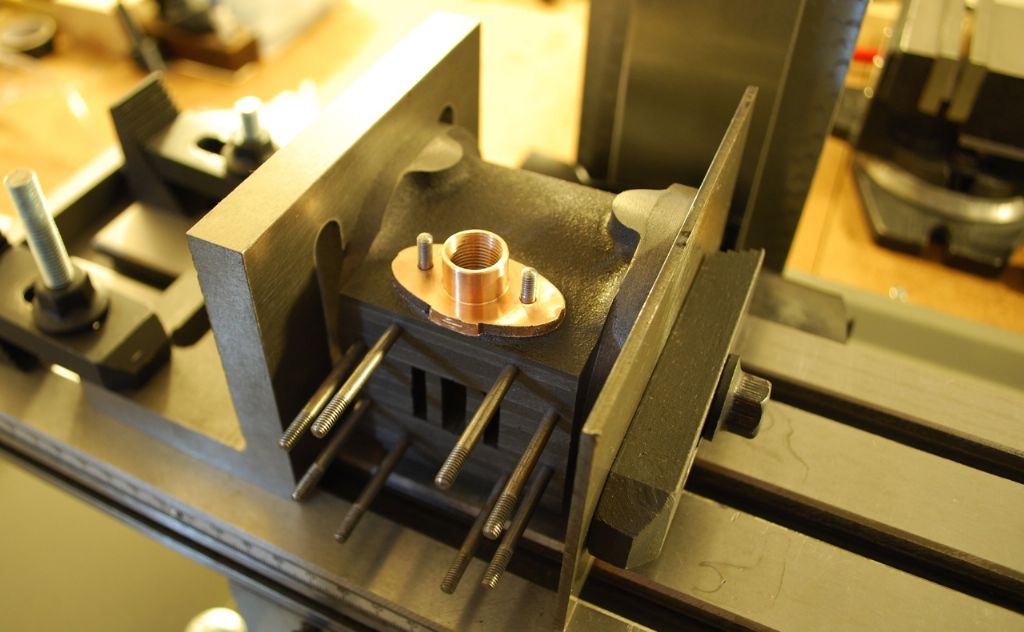

              Just wanted to have a record of the setup..
              Hopefully it'l not look too bad after painting..
              Cheers
              Garry

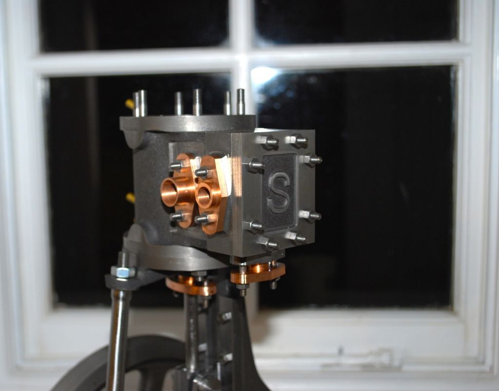

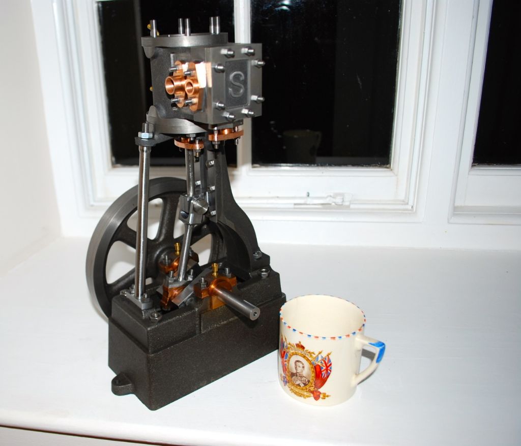

                Couple of photos of progress so far, nothing tightened and the Top Cylinder Cover isn't on – still lots to do..
                I don't think the Flanges look too bad.
                Progress so far 2.
                Cheers
                Garry
                #209055
                  Looks good all assembled.

                      #209185
                      GarryC
                        @garryc
                        Thanks Jeff, it's been a while since I've had it in one piece and was good to see the progress..

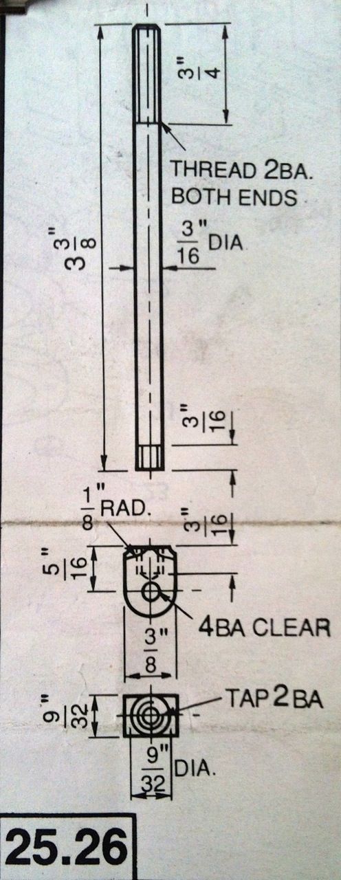

                        Next is the Valve Rod and Valve Rod Head – followed by the Eccentrics. First though is to make another split sleeve to hold the Rod in the Lathe..
                        The Valve Rod and Valve Rod Head Drawing (Rod Stainless Steel & Head is Mild Steel)454. the valve rod and valve rod head drawing.jpg

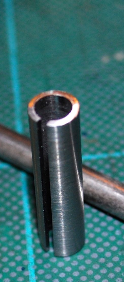

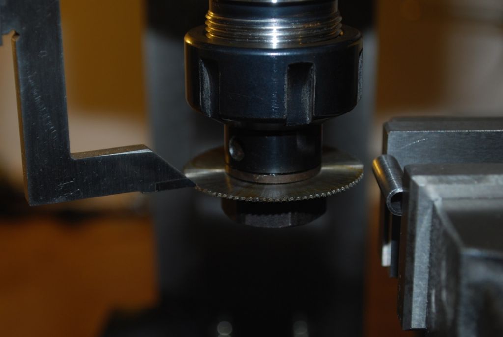

                          (Just getting ready for carrying on tomorrow..)
                          Making another 'split sleeve' this time for holding the Stainless Steel Valve Rod.
                          My collection of these is ever growing..
                          For anyone interested I think the numbers were..
                          Valve Rod diameter – 4.75mm
                          Sleeve drilled – 5mm
                          Slitting Saw thickness – 1.62mm
                          (so enough slit room to close tight on the Rod when clamped – and easy to get the sleeve on and off)
                          Not a very good photo but the sleeve should be able to hold tight enough without marking the Valve Rod – May reduce the diameter a couple of thou with a file in the lathe to make the threading easier – the rod is slightly oversize for the 2BA thread at the moment.. Unfortunately something I don't yet have is a Tailstock Die holder..
                          (I'll clean it out before using).
                          Something of nothing I guess but all part of getting the engine built..

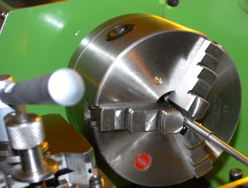

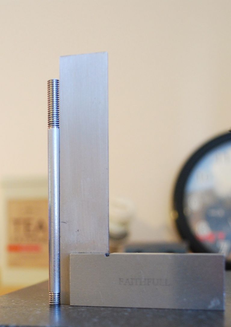

                                          Just the Valve Rod done today..
                                          Definitely a lot easier to do in two passes with the Die – I'm not sure its quite straight but very close, I'm guessing it would have been more accurate with a Tailstock Die Holder unless its just that I've not cut the 3'4" length threads quite as deep as the other maybe – it would have been easy to have tightened the die the same for both if I had thought, worth remembering next time to do that..

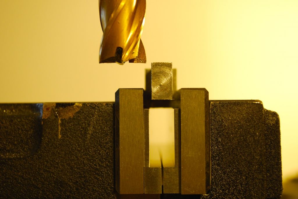

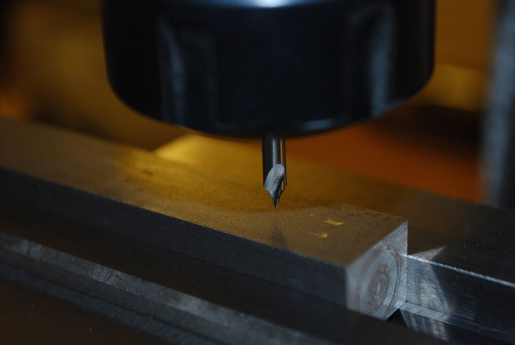

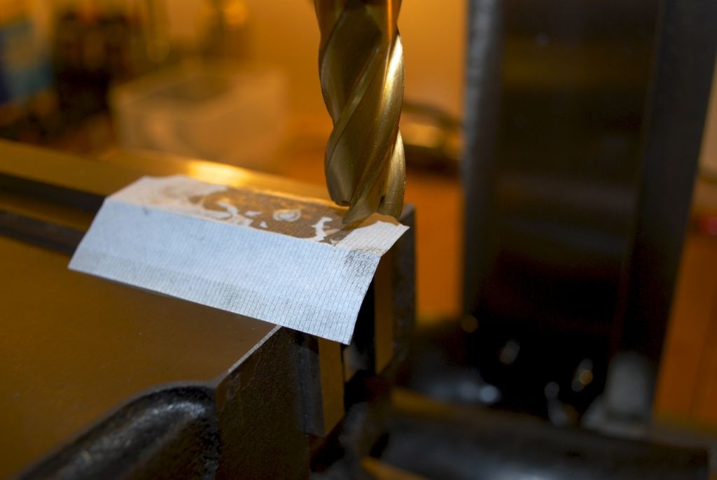

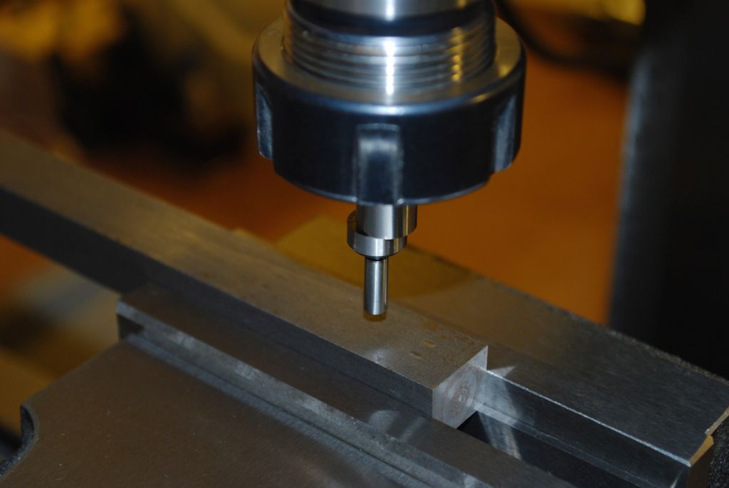

                                            Made a bit of a start on the Valve Rod Head – its only a very small piece but needs to come out of the 7" x 1/2" x 5/8" bar supplied for the Eccentric Rod…
                                            I'm finding using edge finders when possible are more accurate than marking out..
                                            Back to drilling Mild Steel again, doesn't seem a problem anymore…456 the valve rod head 3.jpg
                                            The cigarette papers are great Bert, thanks again – its easy to move the tool with it spinning to just drag the paper away, no mark left on the work – and the tool is one thou away, same result each time…

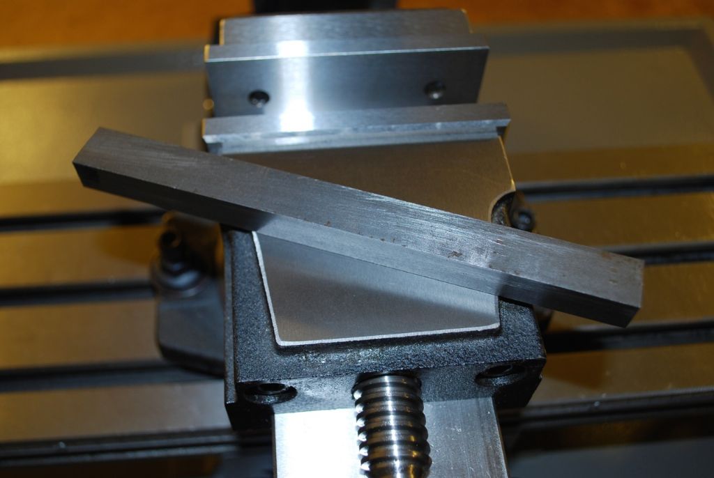

                                            I'm going to try and make on the full length bar so its easier to go on the lathe (for drilling and tapping) – after milling to size, then cut away and radius with the rotary table at the end – the chamfered end left 10 thou over length to face (and clean up) later at the same time..
                                            Jus one side milled down..

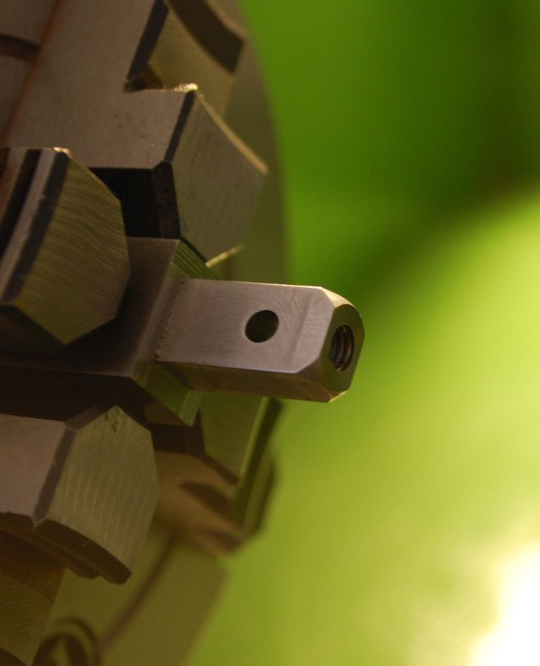

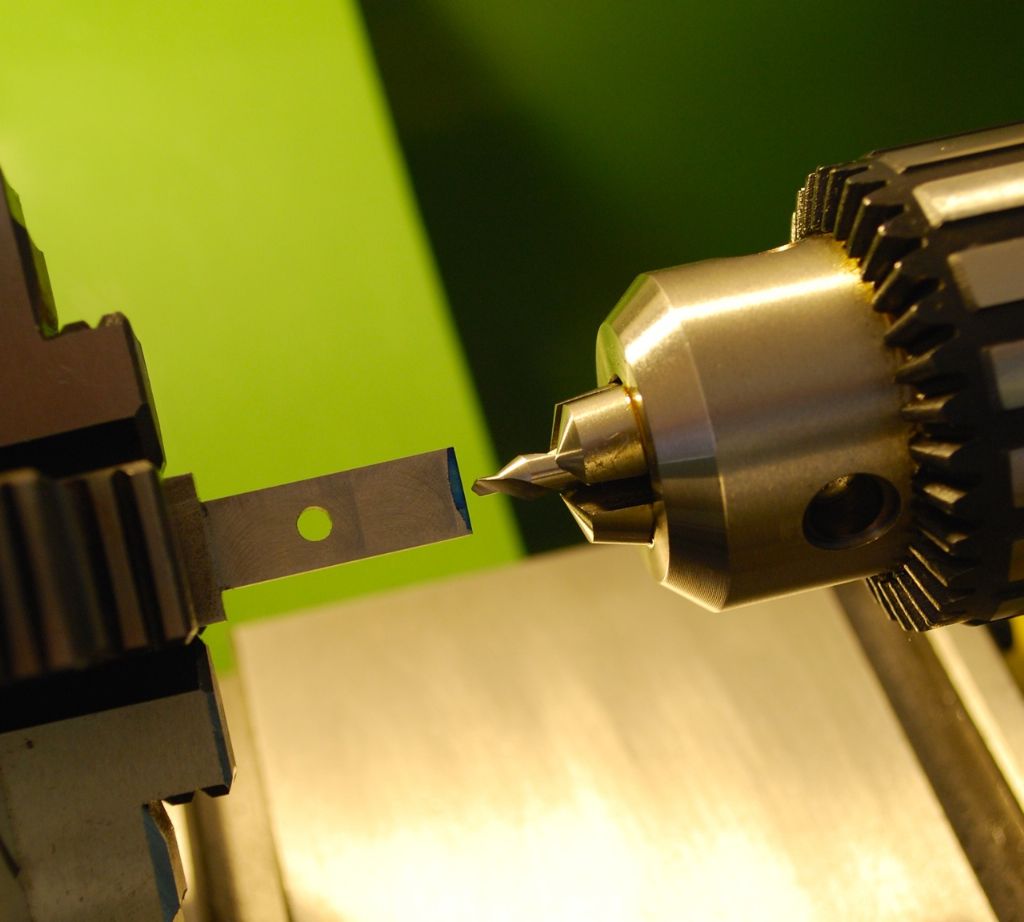

                                              A few more photos of progress with the Valve Rod Head..
                                              Milling out of the 7" bar supplied..
                                              and then onto the lathe for drilling and Tapping – I made a silly mistake in drilling the cross hole in too far from the end, so a bit more facing off afterwards was needed than could have been..
                                              Tapping the 2BA hole for the Valve Rod..
                                              and test fitting the Valve Rod..
                                              I didn't understand the 1/8" radius reference on the drawing for the ends, or rather how to do that accurately on the lathe – so I did at 20 degrees with the top slide – but looks ok I think.
                                              Next to part off and radius the end on the Mill and Rotary Table..
