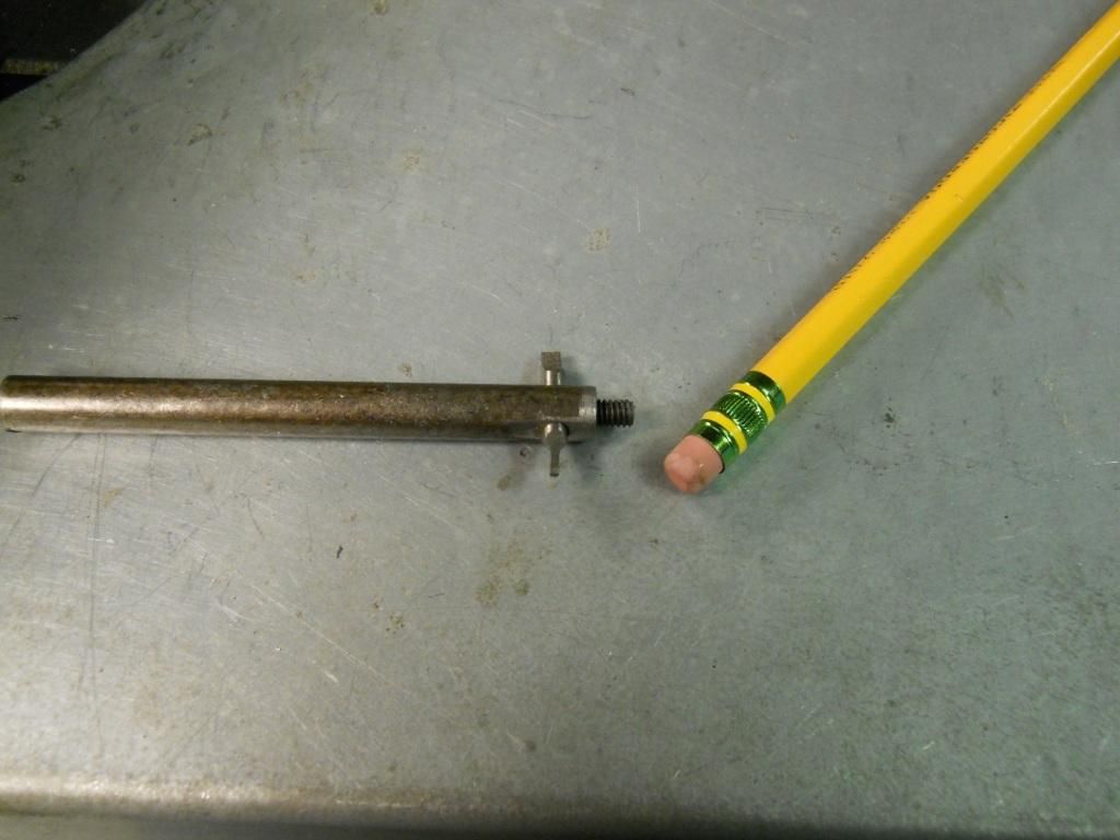

                Hi Garry, I've put up a couple of photos of my form tool below. Also a photo of the side of my roller partially assembled a few years ago with handwheel rim at upper left that the shown form tool was made for. While I was it it I made some photos of a crude groove and shoulder tool made from a scrap of mild steel and a broken tap. It has proven handy for many jobs, much more useful than just the original purpose of making an internal retaining ring groove! In the form tool pics, the middle plate is the gauge plate hardened bit. The top plate is mild steel and damps cutting vibrations and evenly spreads the clamping load from the capscrews. Hope the photos are useful. Cheers JDhandwheel-made-w-form-tool.jpggroove-and-shoulder-tool-2.jpggroove-and-shoulder-tool-1.jpgform-tool-2.jpgform-tool-1.jpg
                Edited By Jeff Dayman on 02/11/2015 13:58:57

                  Hi Jeff, that roller photo is impressive.! I wouldn't know where to start with that..
                  The form tools and holders are very useful to see thanks – and you've set me thinking that I can make one like that in the first two photo's to do the internal groove in the eccentric strap idea smile

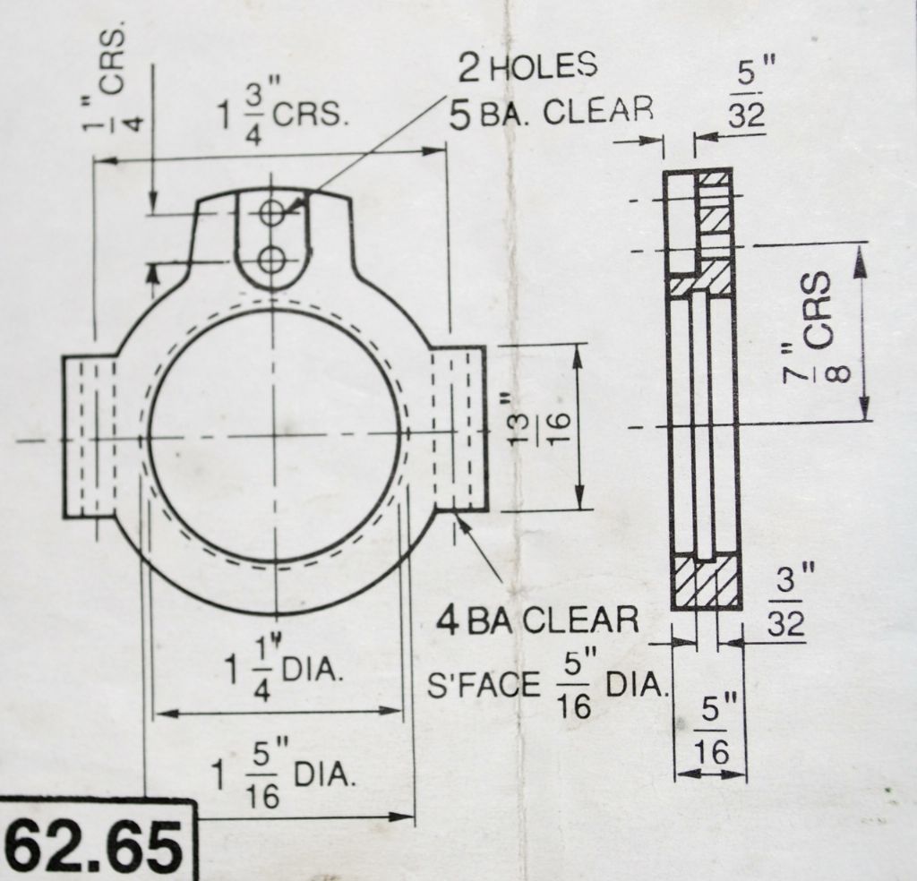

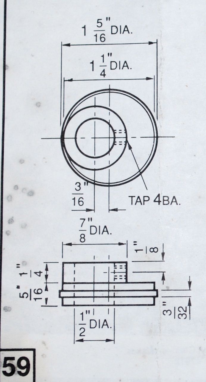

                    Next is the Eccentric Sheave (Cast Iron).
                    The Eccentric Drawing..

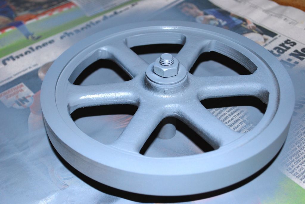

                    I did try to sort out my Flywheel, not very successfully really but I'll leave it as it is now I think – shame I was just lacking that bit of basic know how when I did it…
                    I thought a quick coat of paint (primer) would hide some of my sins – you can see I've been all around the rim on the Mill.. I've not touched the bits I skimmed between centres on the Crankshaft as they seem fine..
                    I have a video of it spinning on the Lathe but its none too pretty, if anyone wants to see it I don't mind posting it here..

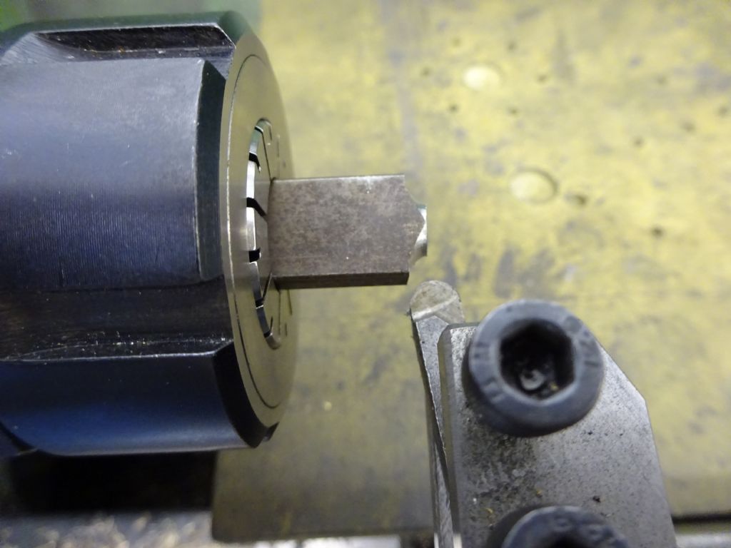

                        I'm sure it won't look half as bad once you have the engine ticking over at 60rpm or lesssmiley
                        I did a quick cut to show you how that rod end should look according to the drawing, I used a bit of 1/2 x 1/4 so not quite the right shape but should give you the general idea

                          I would not stress too much over the flywheel Garry.
                          You could always skim off a few thou if you wished and nobody but you would know. I have recently done a flywheel on the No.4 I am on with ATM and had to take off quite a bit more than I would have wished trying to get rid of a blow hole in the casting. sad
                          I also 're-skimmed' a few thou off my flywheel when I was building the JC engine. But this was down to me not being happy with the finish I had already made.
                          I mentioned it about 1/3rd down this page. **LINK** I did however support the arbor end with a center in the tailstock.

                                  #210529

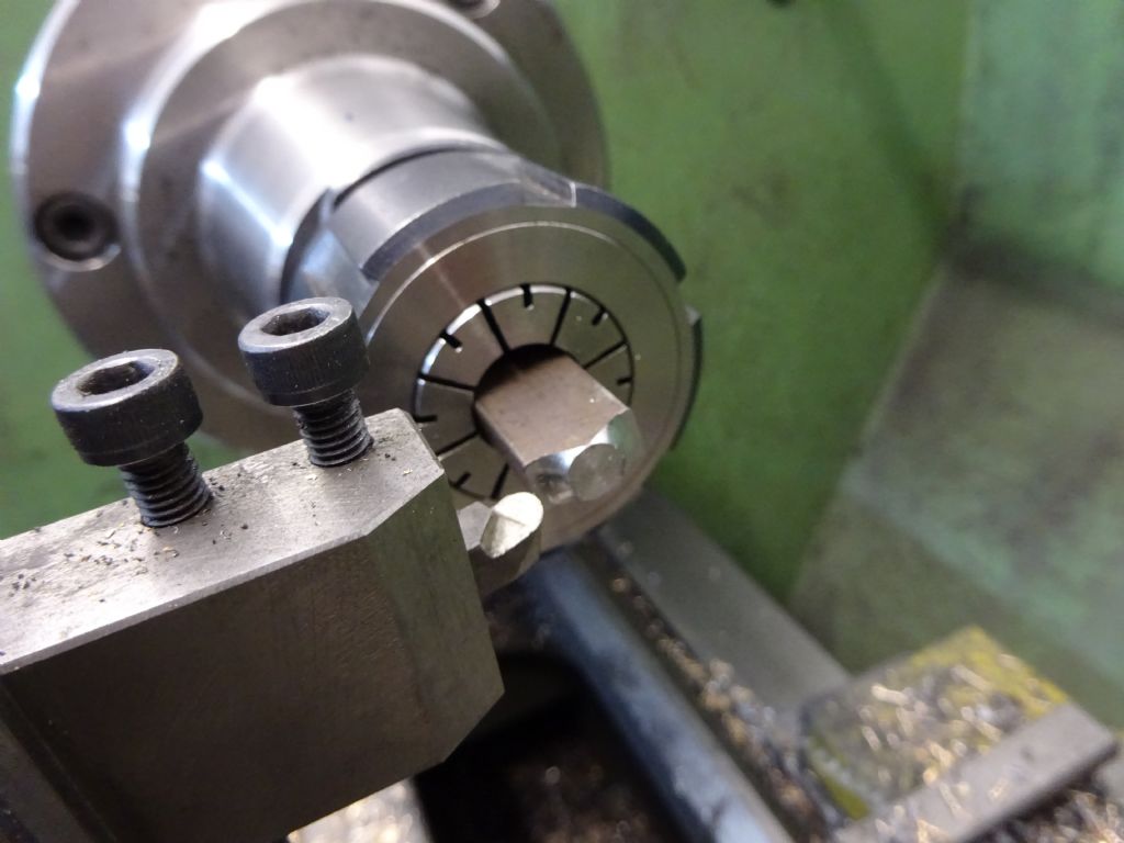

                                    Or a left handed tool/boring bar upsidedown
                                    Garry thats a ER32 converter in the 5C chuck, I don't really like using it for square/rect but could not be bothered to change chucks. I do have some square 5Cs though.

                                        I thought you were joking for a minute Jason but no I've just looked and yes square collets. Collet chucks are more useful than I thought…smile
                                        and cheers Bob, that is something to remember. I think I've only used one a couple of times to date…

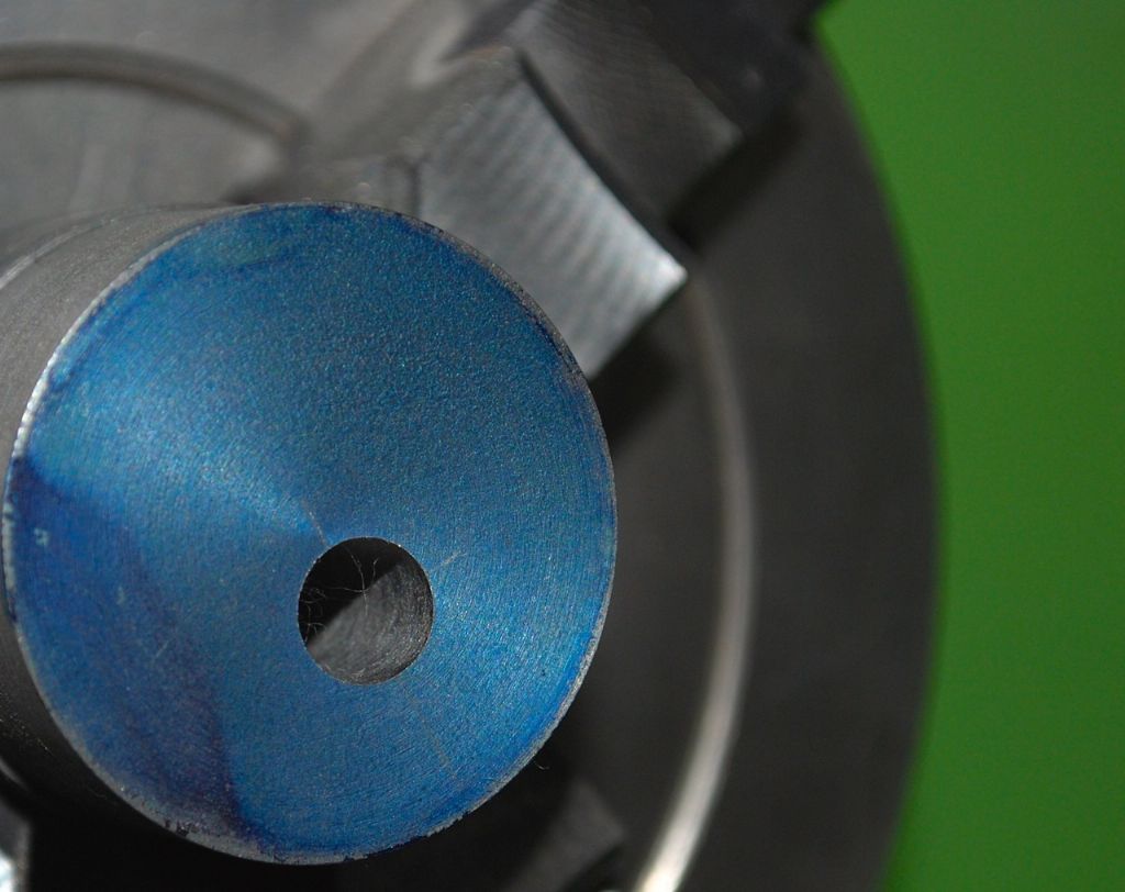

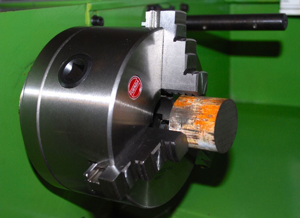

                                          Back going again today and a start on the eccentric sheave..
                                          The Cast Iron bar supplied for the eccentric sheave – the first one I've had longer than specified in the stock list – by 1/8"..

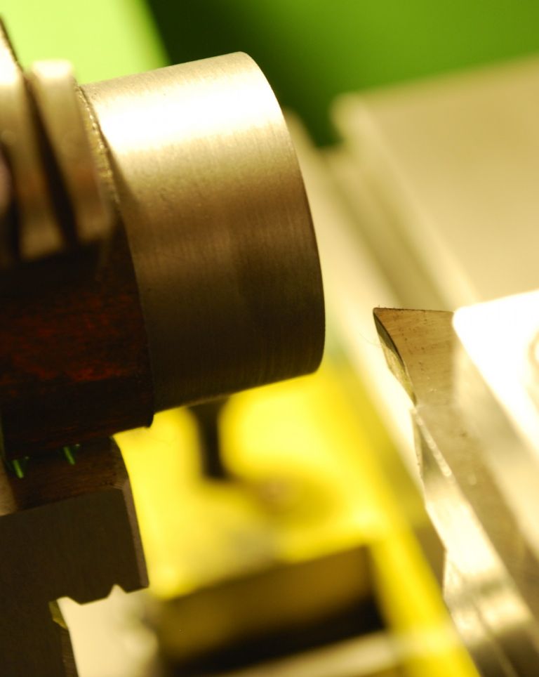

                                          First faced off and then the maximum OD turned to size in the 3 jaw chuck..

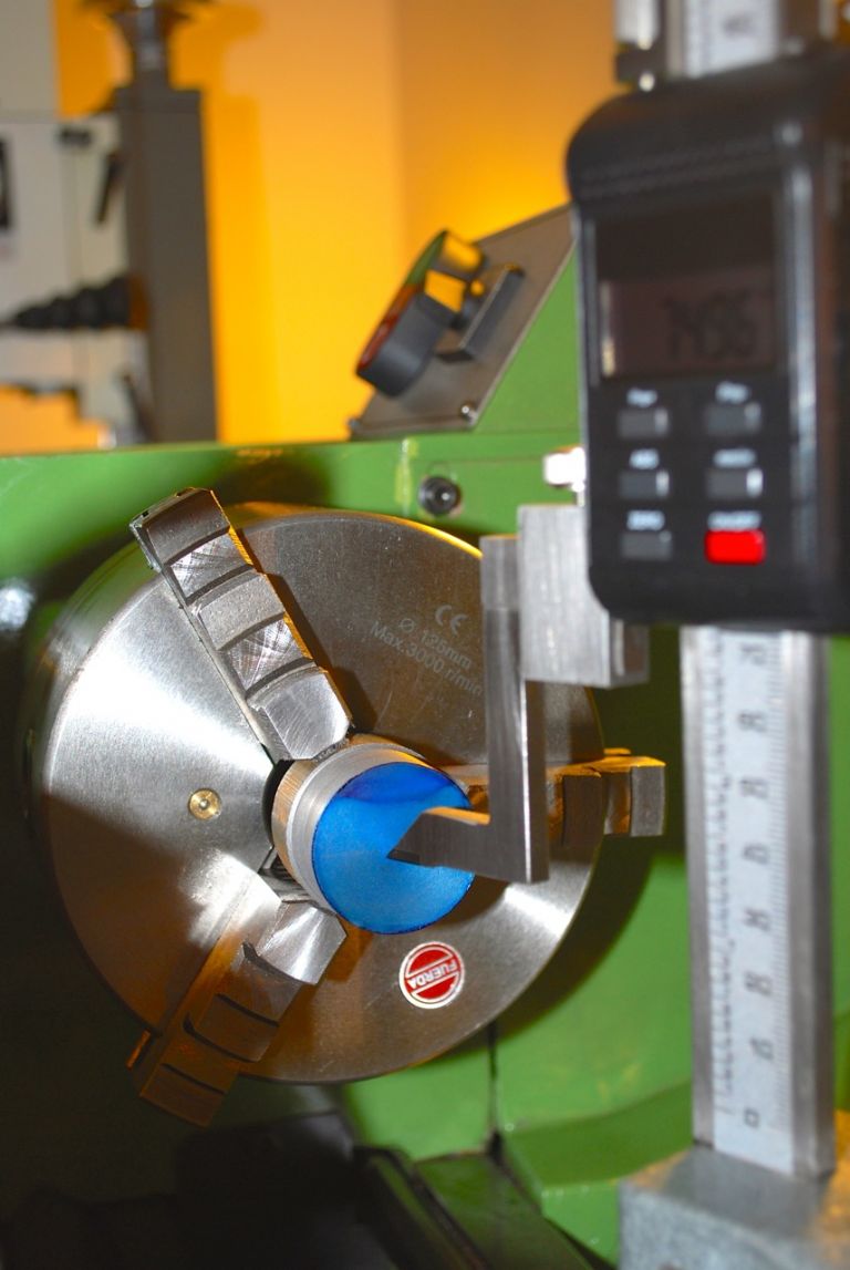

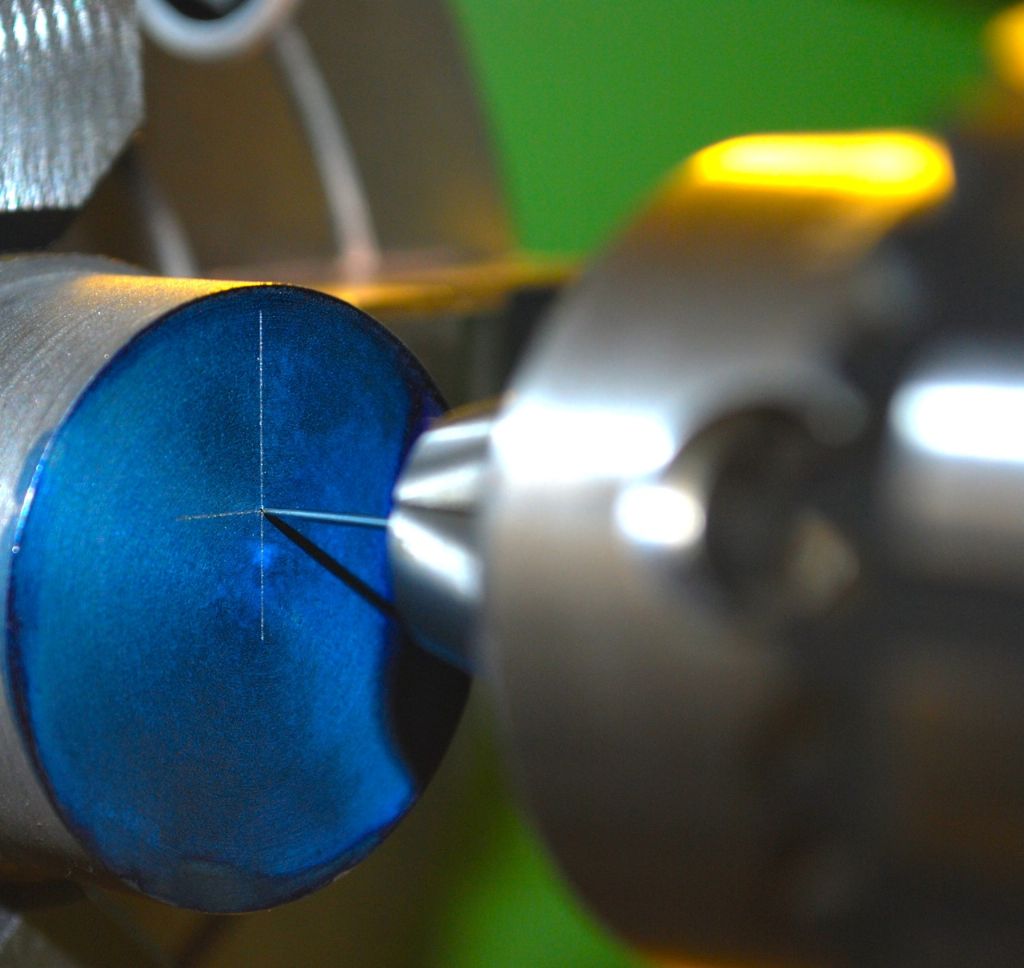

                                          then the lathe's centre height used to mark a diameter followed by rotating through 90 degrees and the offset marked for the central bore. Having finished the main bearings on the Crankshaft with a reamer its convenient to be able to use again for each time something else is fitted to it..

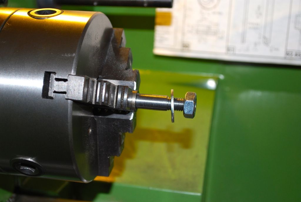

                                          I'd read somewhere about using a pin for centering for drilling so thought I would give it a try – it was ok but after managing to stab myself with it no less than 3 times I think I'll stick to the tailstock centre in future..
                                          this is as far as I got earlier – through with a 7mm drill..
                                          Once I've finished turning to size in this setup before turning around in the chuck I'll have a go at the eccentric strap so that I can use it as a gauge re. the internal groove etc…
                                          The Eccentric Strap Drawing.

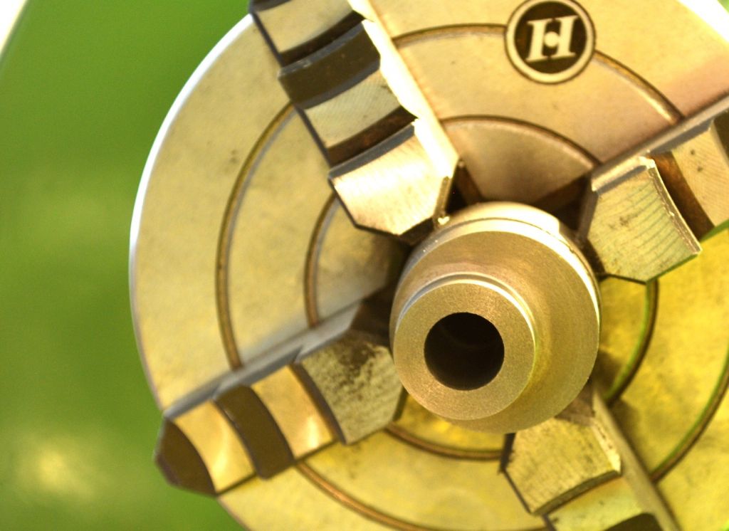

                                            A little more progress with the Eccentric Sheave earlier..
                                            The Eccentric Sheave after drilling, reaming and the boss faced to length.. Its ready for parting off now and then after the Eccentric Strap has been done it will get turned around and held by the 1/4" boss to finish it off – hopefully with the Strap available as a gauge..

                                              Garry,
                                              a process step I would have done first would have been to turn & face the end of the stock which is held in the chuck jaws. This gives one a better surface to grip on (no worries about stock taper or ovality). Plus the finished back surface is there in case you need it for a measurement or setting/clamping in a mill vice before the part is parted off. But, great progress ! It's great to see your posts.
                                              Bruce

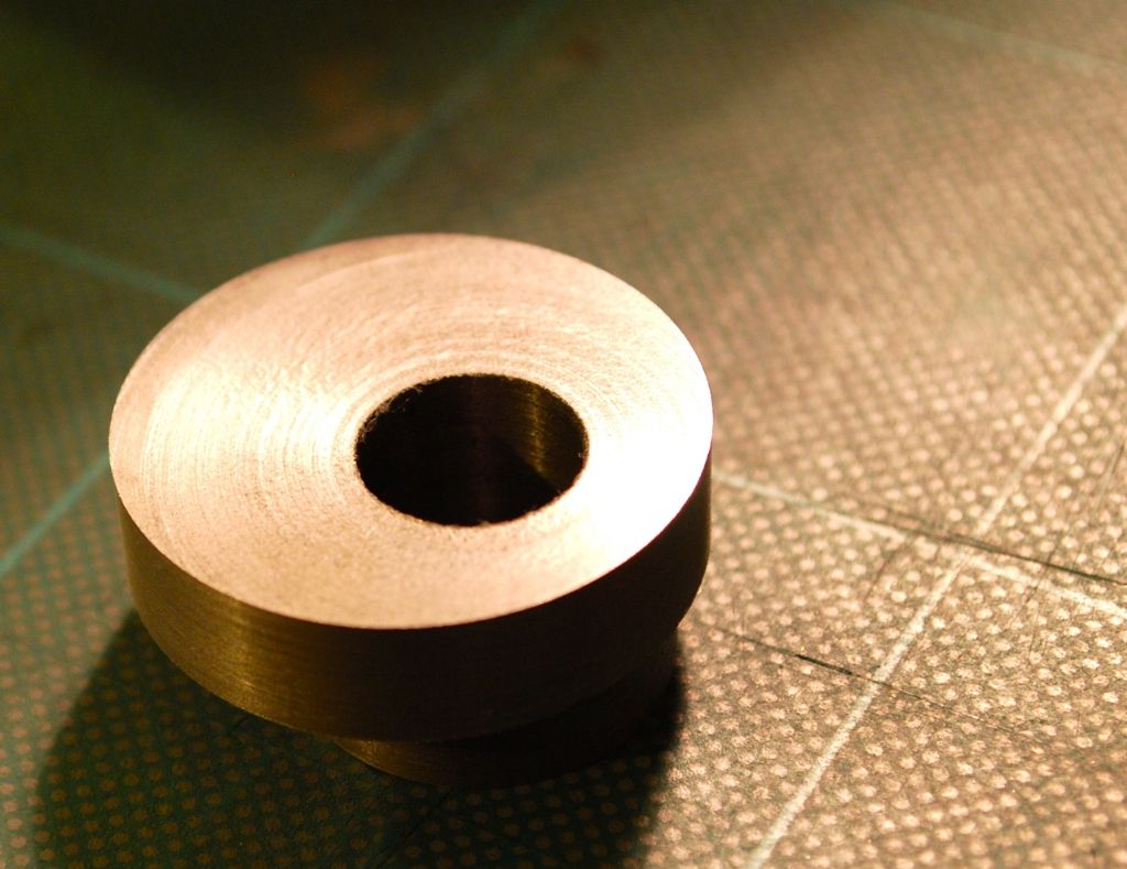

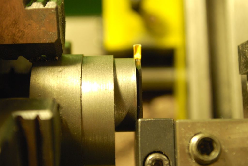

                                                  This is more me marking a bit of a milestone than a build update really – I don't recommend that anyone watches the video as it goes on a bit and then some more – (I've probably got the settings wrong as well and was just an experiment until I get some more practice). Its the first time I've tried parting off under power and I thought that the eccentric sheave with its offset diameter and the offset bore would be as good a test as I'm likely to find (the bar is about 1 3/4" cast iron). (I don't have a pump coolant system).
                                                  I wouldn't have even thought to try this with one of my 'standard' parting tools, but the Glanze I've always found to be superb when hand feeding and have been wanting to try under power for ages, also wasn't sure if the lathe was too small to even try it given some of the horror 'parting off stories' I've seen..
                                                  Setting the tool position before starting..
                                                  This is just something to maybe look back on as another first (for me) – don't watch its way too long..!
                                                  The cut I thought was great, I always seem to get a burr at the end sometimes quite big when I've been hand feeding but not here under power – there was a slight wafer thin coil left around the hole and which came away in one piece with my fingers. I may be converted to this way now.. I used the slowest feed rate on the lathe, I'm sure on a true running diameter I could have gone faster – not that matters anyways…
                                                  This was straight after the cut had finished, just the thin 'coil' removed around the bore and cleaned with a rag – no other cleaning up at all yet…. I did nothing except position the tool and engage the cross feed – and a bit of sweating I guess. I have an idea now that with the offsets involved this was a much better and easier way than hand feeding would have been..smile

                                                  #211132
                                                  Gas_mantle.
                                                    @gas_mantle
                                                    Good to see things coming along nicely Garry smiley
                                                    I must admit when I read your first paragraph that it was the first time you have 'parted off under power' I honestly thought you meant that until now you have managed by rotating the chuck by hand !!
                                                    #211135
                                                      As you get the hang of it you will find that the speed can be increased quite a bit and also the feed rate, next time play about with the speed knob and the sound of things will soon let you know if teh machine does not like it.
                                                      J
