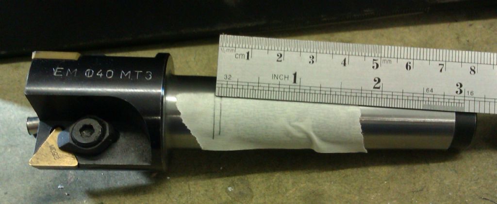

      Last year I treated myself to a Glanze 32mm endmill, the type with the carbide inserts.
      Got a job for it this afternoon, to my disdain, it won’t fit in my Warco Mill spindle!
      I’ve never had this problem before, and I have a fair amount of MT3 tooling accumulated over the past few years.
      On examination, the taper on the endmill is quite a bit longer, c10mm than my other MT3 tools. Pretty sure I can turn off the offending length, but the question I have is – Is there no defined standard for MT3 tooling (I not just the taper but the complete fitting)?

            Just make sure there is enough thread left for the drawbar, may be better to turn the end to a smaller dia than turn it off completely.
            I’ve got the 40mm version and it fits my X3 fine, let me know if you want to compare the length.

                I can see why my one fits.
                The line to the right is the 0.938 gauge, the line to the left is how far the taper fits into the spindle, about 1/16″ difference. The end of the shank is the correct 3 3/16″ from the gauge line but just to ensure a good fit the end has a reduced parallel section.
                Steve you probably only need to turn down a short section like mine, this will also be easier to hold as you can support the end with the tailstock ctr. It also means you won’t ding the end of the taper.

                  In my newest Machinery’s Handbook the depth of Morse taper in a socket is defined, as is the length of Morse taper tooling with a tang. Hence by implication the length of a Morse taper without tang should also be known. It shouldn’t be longer than the depth of taper in the socket.

                    This table gives the length without tang and is the 3 3/16 I mentioned above

                          The two chucks at the top have a taper 77mm long. The top one is an autolock type from Warco, the other chuck an ER32 type from Arceurotrade. The Glanze mill has a taper 89mm long which exceeds the 3-1/16 quoted above by some way. The parallel section is not threaded, so that can go without a problem. Depending on how hard the taper is, I could turn the first 10mm of the taper parallel and then it will fit no problem.

                              Steve have you checked the gauge dia and measured the taper from there as the overall length is not a good indication of the taper length. If you look at mine the taper is well over 90mm long but it fits a sthe gauge is about 12mm back.

                                  Good point Jason. Just measured the tapers again based on a datum which is the diameter of the bottom of the taper socket on the machine. This makes the Glanze taper an actual 9mm longer than the others.
                                  I’ll take John’s advice and have at it with a decent carbide tip tool.
