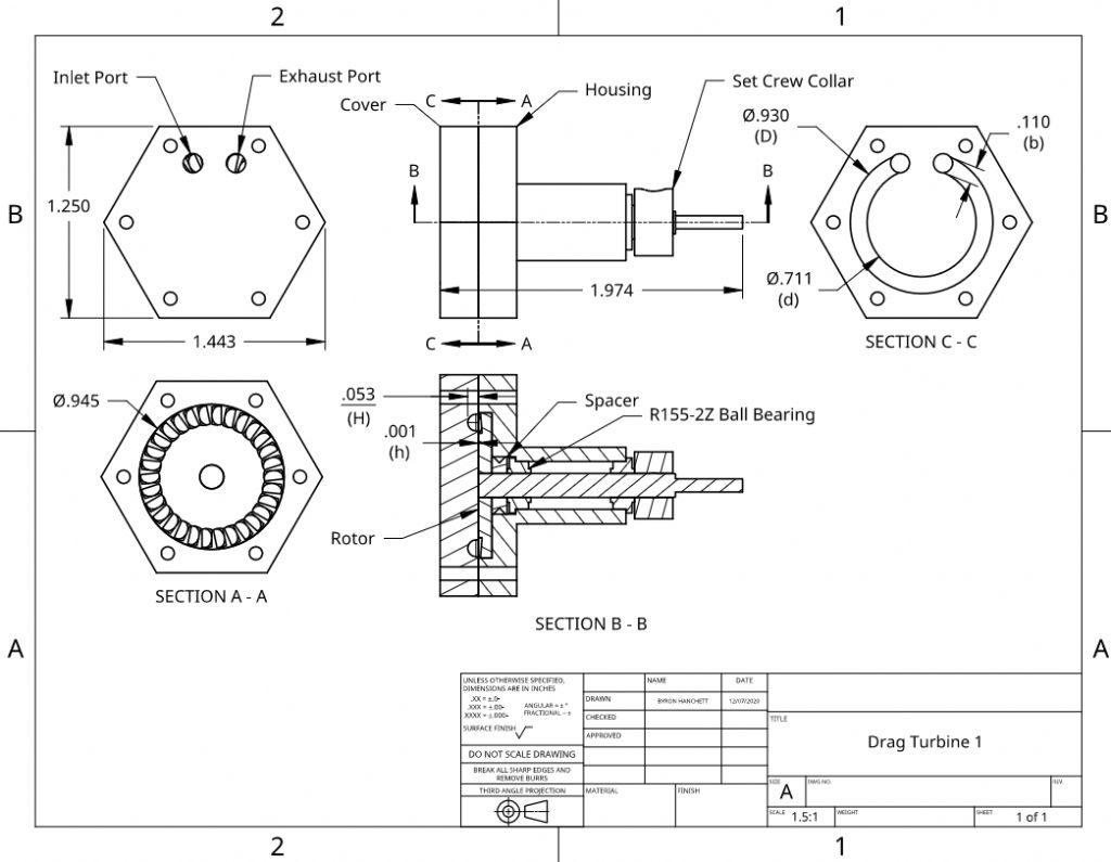

      To obtain the efficiency shown in the last post, my Drag Turbine 1 must meet certain requirements. I will list some of these requirements below and some in the next post. The requirements that apply to the cover and housing shown in the following drawing are:
      The channel diameter/width ratio, D/H needs to be approximately 17.5. The channel diameters ratio, D/d, needs to be between 1.3 to 1.5 The rotor clearance to channel width ratio, h/H, needs to be less than 0.02
      Drag Turbine 1
      Edited By Turbine Guy on 10/12/2020 20:51:15
      Edited By Turbine Guy on 10/12/2020 20:52:05

          In the last posts I gave the drawings showing the dimensions for Drag Turbine 1. I also gave the requirements that had to be met to achieve an estimated efficiency of 30%. The following is a copy of the requirements and at the end of each requirement the corresponding values of Drag Turbine 1 are shown in parentheses.
          The channel diameter/width ratio, D/H needs to be approximately 17.5 (17.5). The channel diameters ratio, D/d, needs to be between 1.3 to 1.5 (1.3). The rotor clearance to channel width ratio, h/H, needs to be less than 0.02 (0.02). The rotor pocket depth to cover channel depth ratio, H’/H, should be approximately 1 (1.0). The angle of the rotor pockets should be 40 degrees (40 degrees). The blade thickness to cover channel depth ratio, s/H should be less than 0.20 (0.17 min 0.62 max) The pocket spacing to cover channel depth ratio, l’/H, should be between 1 and 2 (1.8). In addition to these requirements the ratio of the inlet gas density to the outlet gas density needs to be less than 2. For air at an inlet pressure of 10 psig and exhausting to atmosphere pressure, the ratio is approximately 1.7. Drag Turbine 1 meets all the requirements except for the blade thickness. Dr. Balje’s report assumes a constant blade thickness and has a chart showing the loss of efficiency with s/H ratios greater than 0.2. Since Drag Turbine 1 has varying blade thickness, I make a few assumptions to use the chart. Because the flow enters the bottom of the pockets and flows out the top of the pockets, I assume that the blade thickness on the lower half should be used. The average blade thickness on the lower half is approximately 0.015”. This makes the s/H ratio for the lower half 0.015/0.053 = 0.28. For a s/H ratio of 0.28, Dr. Balje’s chart gives an efficiency correction of 0.95. With this correction, the estimated efficiency of Drag Turbine 1 is approximately 28%.

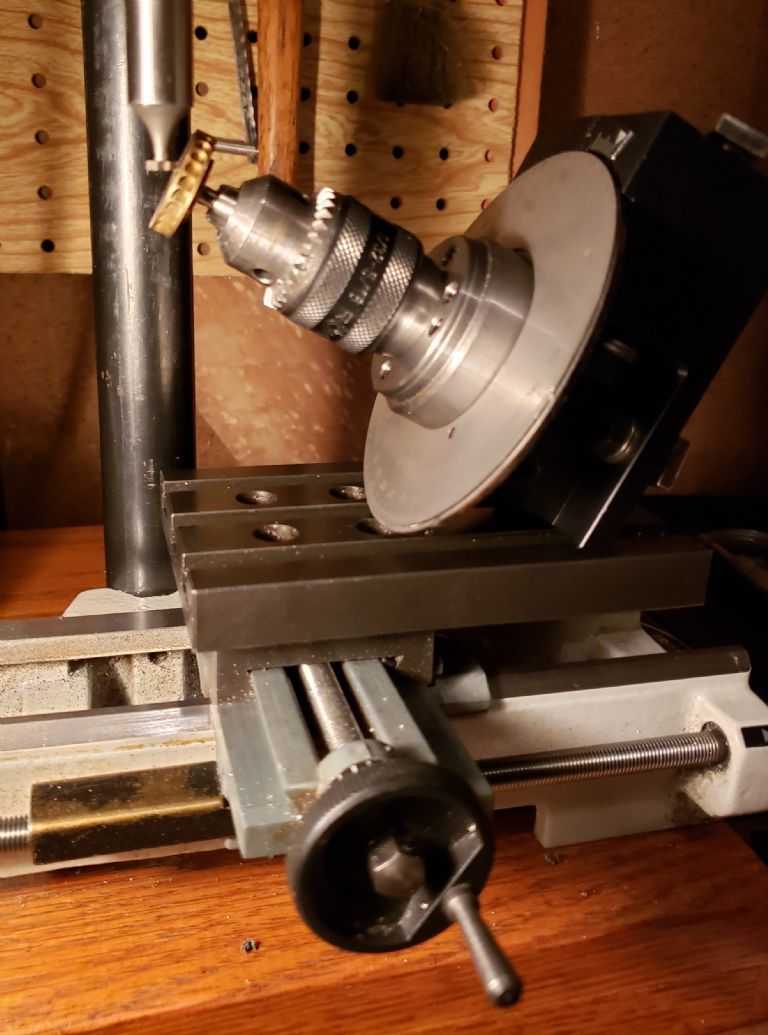

              The following photo is a mockup of the best setup I have been able to come up with to make the pockets in the rotor of Drag Turbine 1. The rotor used in the mockup is approximately the size of the drag rotor. The keyway mill is the only one I have and is much bigger than the size needed. Also, the indexer is just set at the approximate angle. I used this mockup to determine If I had room to get everything in position. A 45 degree angle bracket shown in the next post is available and could be used for mounting the indexer to the carriage mounting plate. This bracket could be used instead of the 40 degree optimum angle with just a slight loss in drag coefficient.
              Drag Rotor Setup 1

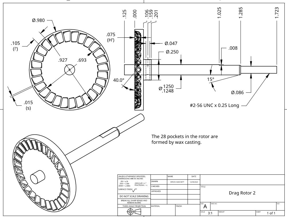

                      I designed a wax cast rotor that would work in place of the machined rotor in Drag Turbine 1. I added a couple of what I think are improvements. I added a boss on the rotor to replace the spacer in Drag Turbine 1. This extends the grip on the shaft and would allow a pin to be inserted through the rotor and rotor shaft. I also extended the shaft so that it passes through the rotor. This would allow balancing the rotor using Werner’s method described in the post of 29/11/2020. I made a 3D model of the rotor adding an allowance for machining the critical surfaces to their final dimension. I then scaled up the solid model 2% to allow for shrinkage. The following drawing of the solid model was made to show enough dimensions to confirm the scale. I went to the Shapeways Website and followed their instructions for getting a quote. The instructions were very straightforward except they always call it 3D printing even if you select materials like the bronze I requested, that is only available with wax casting. To get a quote you need a 3D solid part file. I made a step file for my drag rotor and dragged and dropped it where they requested. Their program responded that the file was very complex and would take a little time to analyze. After a short time, their program showed a 3D model that looked correct, but their assumed scale was wrong. I used the dimensions in the following drawing to correct the scale. The only thing left to do was select the material. After selecting the material, the price, expected ship date, and shipping cost were shown. My rotor cost $63.46 including shipping and has an estimated ship date of 13/01/2021. I thought the cost was reasonable for a quantity of 1, so I placed an order. The keyway cutter I required for making the machined rotor cost $52. Werner was right, this is a better way to go.
                      Drag Rotor Casting
                      Edited By Turbine Guy on 22/12/2020 19:49:25

                        The following drawing shows the dimensions of the cast drag rotor after machining. This drawing assumes the casting will clean up to these dimensions. These dimensions assume the minimum amount I think will have to be taken off. There is quite a bit of additional allowance for cleanup if needed. The changes from Drag Rotor 1 are reducing the shaft diameter from 5/32” to 1/8” and adding a boss to extend the contact surface of the cast rotor to the shaft. The extra contact length also provides enough room to add a pin through the rotor and shaft. The change in shaft diameter was made since the ball bearings for the smaller diameter had higher load capacity and a higher allowable speed. Also, shims were available in 0.001” thickness where 0.004” was the minimum thickness for the larger shaft. The drag turbine requires the minimum clearance of the rotor and housing to get the best performance and the 0.001” shims will be very helpful in lining up the rotor with small clearances. The cast rotor allowed the pockets to have a full radius on each side, whereas the shank of the keyway cutter limited the depth of cut. Also, the blades of the casting have the same thickness from the bottom to the top of the pocket.
                        Drag Rotor 2
                        Edited By Turbine Guy on 24/12/2020 15:10:22

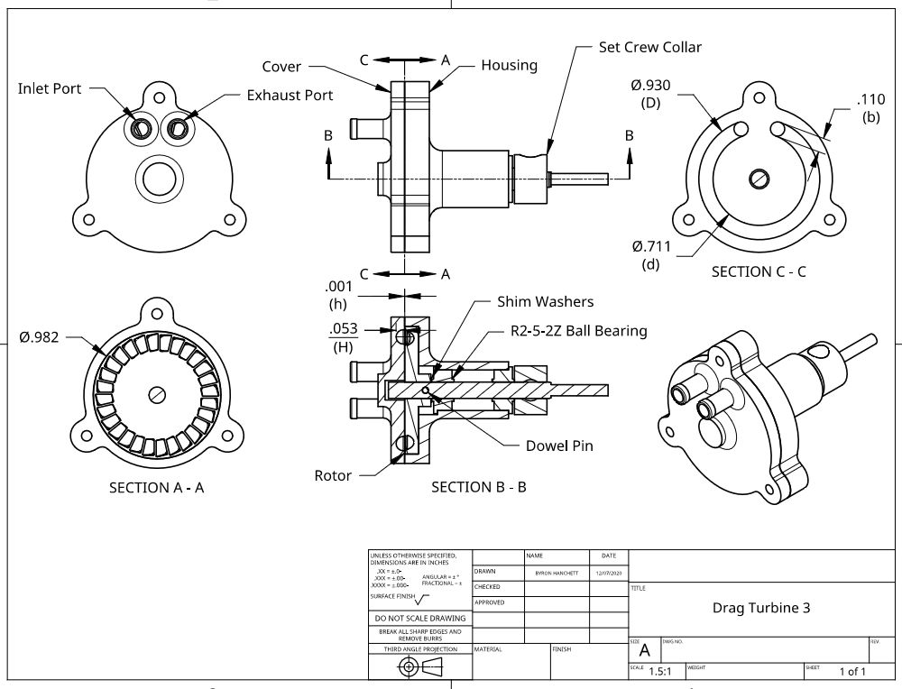

                        #515309
                        Turbine Guy
                          @turbineguy
                          The following drawing is the assembly with the cast rotor, cast housing, and cast cover. After seeing the cost of the cast rotor, I thought I would look at using castings for the cover and housing. If Shapeways can cast them and the cost is reasonable, I will probably place an order. The castings save a lot of machining and simplify adding fillets and rounding surfaces which reduces the mass and improves the appearance.
                          Merry Christmas,
                          Byron
                          Drag Turbine 2

                            #517299
                            Turbine Guy
                              @turbineguy
                              While working on the cast housing and cover plate, I asked Shapeways what the minimum allowable thickness was and was given this link Shapeways Materials. Since I had already looked at the materials, I took a closer look and found there was a separate tab called ‘Design Guidelines’. This section gave the minimum thickness as 0.6mm for supported or unsupported sections with a natural finish. Since the minimum thickness of the blades of Drag Rotor 2 is approximately .01” (.3mm), I was concerned that the rotor would not be able to be cast as designed even though it passed the initial review by Shapeways. I mentioned what I had discovered to Shapeways and Mitchell Jetten of Shapeways Customer Service sent me the following response.
                              “The minimum acceptable wallthickness for this material is 0.6mm. For details, parts that stick out, you should be able to go down to as low as 0.35mm thick and 0.35mm long. If the detail sticks out more than 0.35mm this will be classified as wall instead and would require to be 0.6mm thick.
                              The main reason we have this guidelines is because we need to actually be able to 3D print the wax model, clean this and create a negative mold around this before we are able to cast the model in brass. Since the wax material is really fragile, going below this guideline greatly increases the risk of parts breaking or warping.
                              On our materials page by clicking on the Design Guidelines tab you can read more about this:
                              That said, our checking process is manual, it does happen from time to time that a model that is below the design guidelines gets approved. In your case the model was successfully printed and cast, however it often also happens that a model gets accidentally accepted and then gets printed or cast but fails at either of these stages, which will result in the model being rejected".
                              After receiving this response I was notified by Shapeways that Drag Rotor 2 was cast and cleaned up successfully and has been shipped. I thought I would share Mitchell's explanation of the importance of the minimum thickness, The reason the blades of Drag Rotor 2 were able to be cast was probably because their unsupported length is so short.

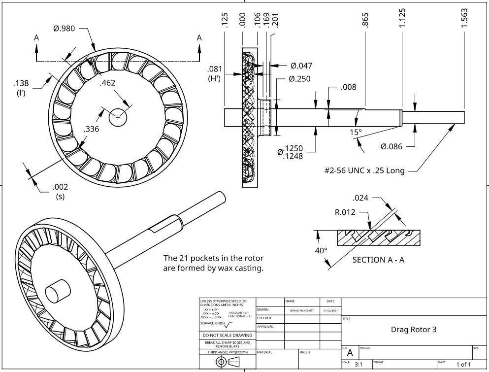

                                      I designed Drag Rotor 3 following all the guidelines from Shapeways. The two guidelines I missed on Drag Rotor 2 were keeping the minimum thickness greater than 0.6mm minimum for bronze and having a sharp edge on a thin section. The blades on Drag Rotor 3 are 0.6mm thick and have a round end. The following picture shows a 3D view of the blades. The drawing for this rotor will be shown in the next post. I should point out that Shapeways minimum thickness is not the same for all materials so should be checked. I may try this rotor if I have a problem with Drag Rotor 2 since it will work with the cast housing and cast cover plate of Drag Turbine 3.Drag Rotor 3 Blades
                                      #517880
                                      Turbine Guy
                                        @turbineguy
                                        This is the drawing for Drag Rotor 3. I had to make the pockets deeper and reduce the number of blades to open up the flow area with the extra blade thickness.
                                        Drag Rotor 3
