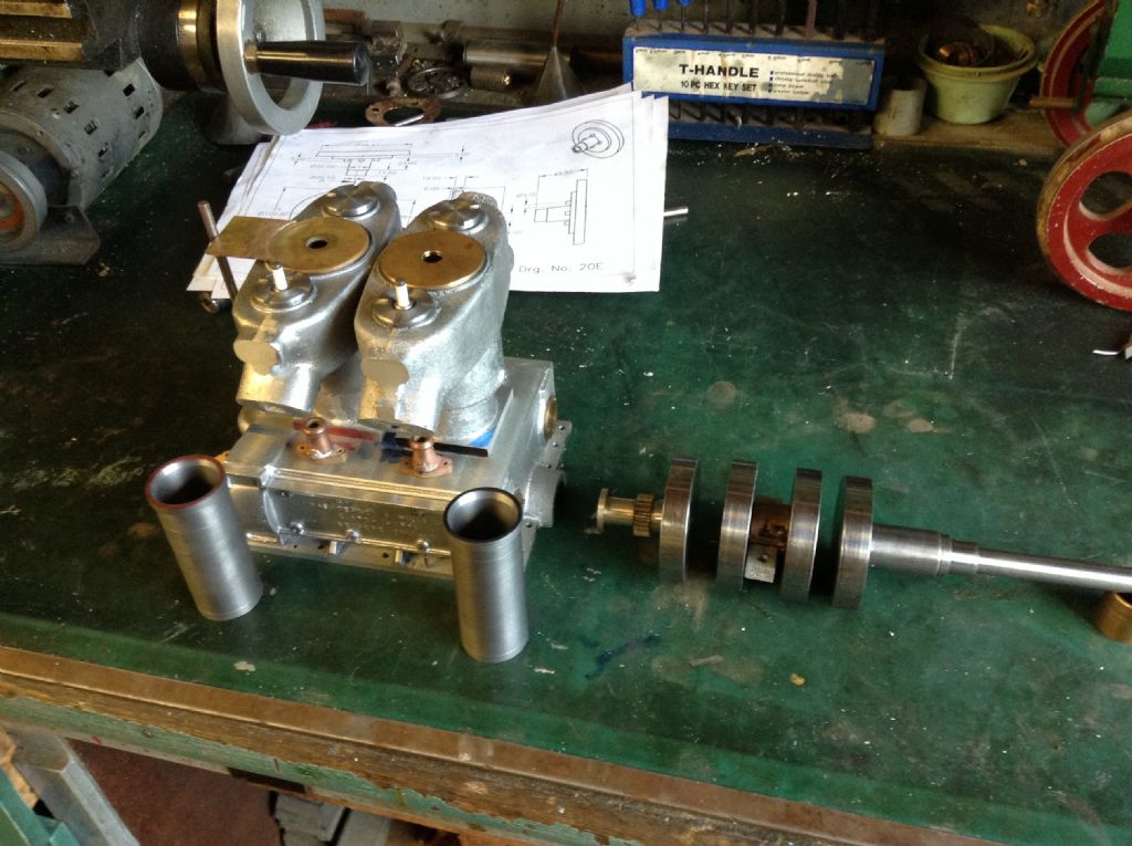

    Four stroke Fred
      @fourstrokefred

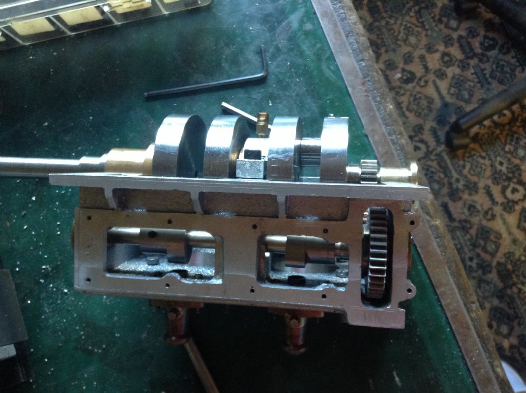

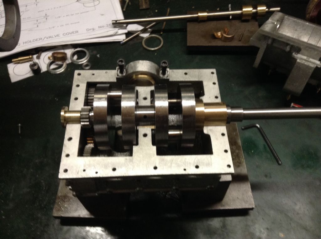

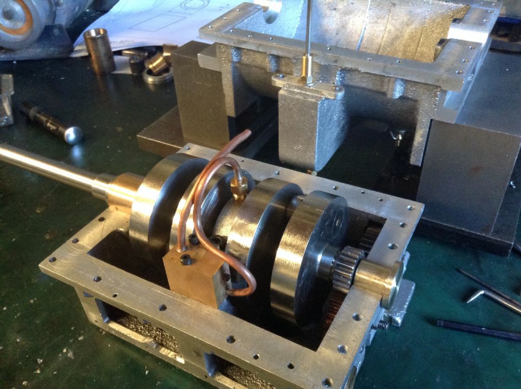

      Progress on the tractor is ticking over at a steady pace and this week saw the crankshaft finished and fitted with the main bronze bearings. Photo in the album. Today I have just finished the oil pump that works off a cam on the inlet camshaft. The connecting rods are being laser cut to profile from an alloy steel and will be machined and fitted with bronze bearings at both ends. Also completed some underside details. Also took some time out of the workshop today and went for a ride on the bike (Kawasaki W650) .

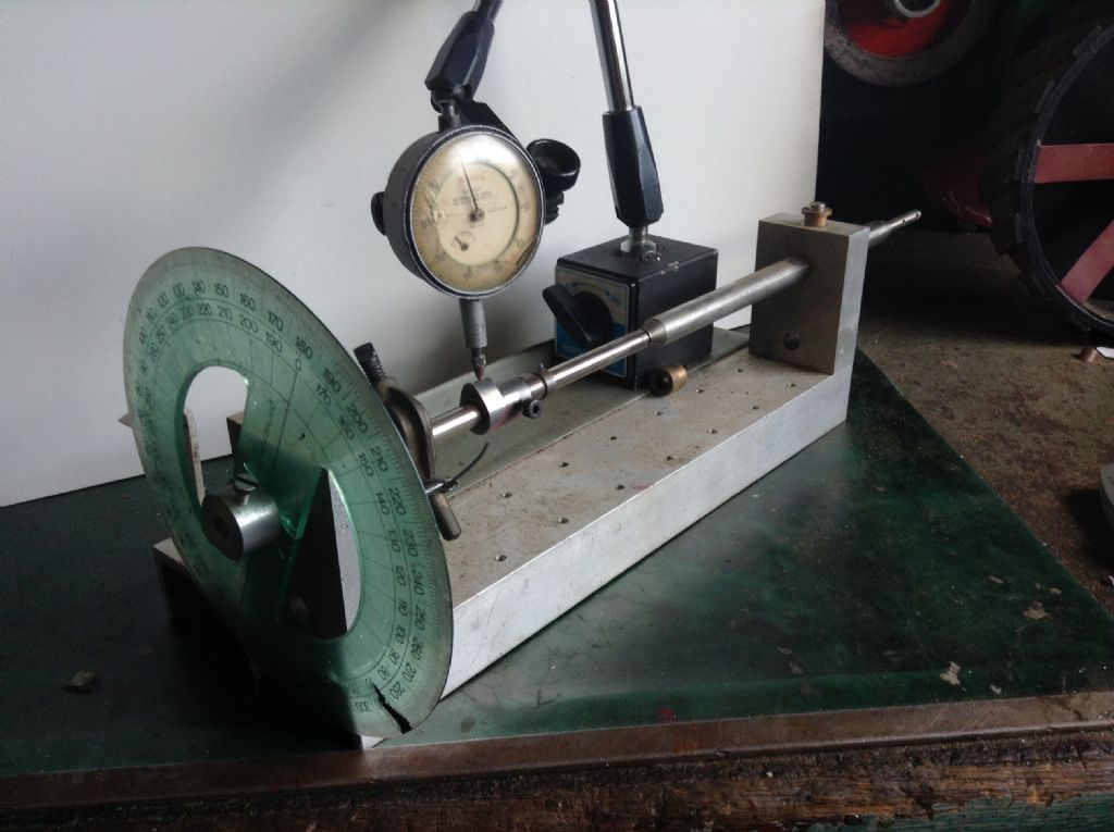

          Today I made and fitted the cams to the tractor engine. These cams are individual items that are pinned to the shaft. The photo shows a cam on the test jig. The jig is used to check the lift and the rise and fall cam angle. This afternoon I hope to make the cam followers and collect the con rods from the laser cutter. The engine is beginning to gather momentum and although the end is still some way off at least it is in view!
          George.

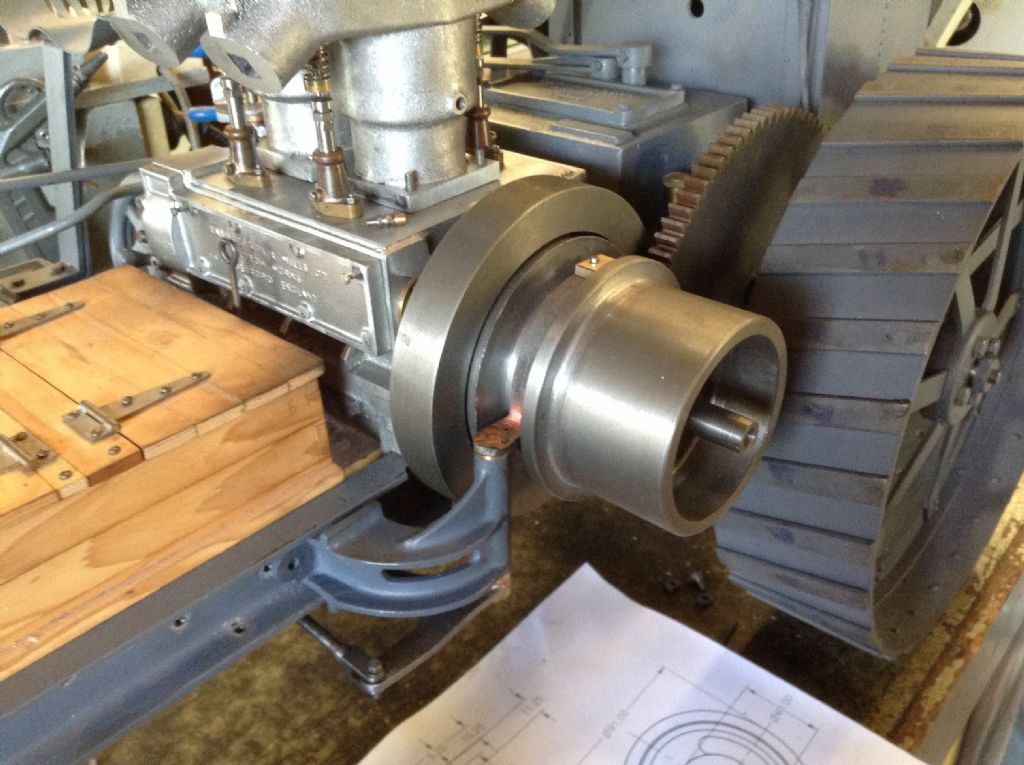

                        1. This week I have made and fitted the cone clutch. The flywheel,clutch plate and the pulley are all made from cast iron and the contact faces of the clutch have yet to be faced with friction material. I intend to try cork but have the option of the type of material used in car clutches as an option. The clutch is attached to the pulley and as pressure is applied to the clutch pedal and a series of levers, pressure pads push the pulley out causing the clutch to disengage. The clutch will be very much "on" or "off" as there is very little movement between engage or disengage. There is still some machining to be carried out on the pulley. The bracket on the side of the frame is fabricated and made from eight pieces of steel silver soldered together!
                        2. George.

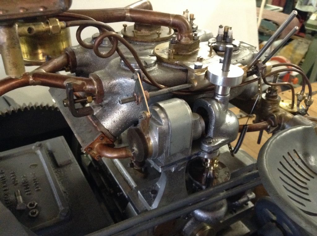

                            I have now reached the stage of making all the small details relating to the governor,carburettor and ignition system. The magneto is a "dummy" as it houses the Hall effect transistor and trigger mechanism. The aluminium part on the vertical shaft has now been replaced with a distributor that has been made from an insulating material. It is difficult to scale the sparks as they are prone to jump to the nearest metallic part! The link from the governor to the throttle still has to be made. The longer of the two levers controls the advance / retard and the other is attached to the governor/ throttle.
