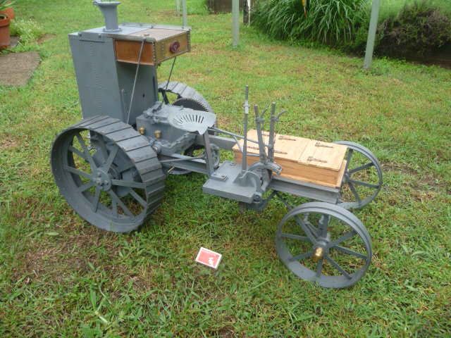

      This is an unfinished 3" scale model of a Saunderson & Mills tractor (1913). The original was seen in a museum on the South Island of N.Z. (Geraldine). The engine has been designed but has yet to be made. All the work is carried out in a home workshop.
      Edited By JasonB on 25/05/2014 13:29:39
      #121133
        That looks an interesting project George, whats the power source?
        I do have the drawings for an IHC Titan but they are not upto much but could be tempted if you write this one up for ME.

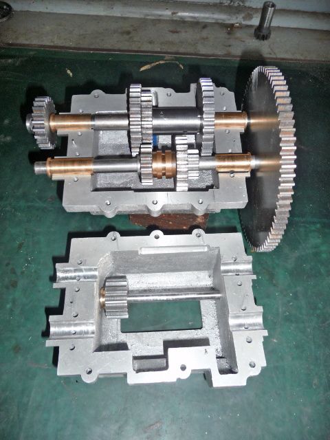

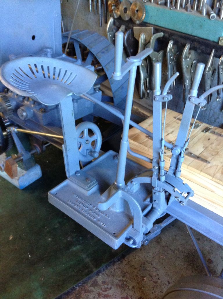

                  I have been working on this model for the past two years and now have the main chassis , differential and gearbox completed and am now working on the engine. The engine is a 180 degree twin with fixed head, water cooled and "T" valve placement. Over the last few weeks I have been making the patterns and core boxes for the cylinders – quite complex! The crankcase haves have been cast and machined and have the cam shaft gears fitted. The model is just over 700 mm long.
                  Edited By JasonB on 25/05/2014 13:32:24

                    A 3″ scale model of a 1913 Saunderson and Mills tractor powered by a 55cc SV twin cylinder “T” head water cooled engine.

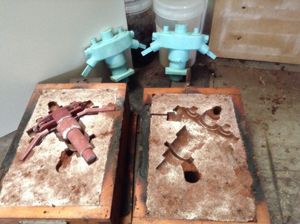

                            I have been working on the cylinders for this model tractor for the last five weeks- still not there yet but not far away now! Spent today making new core boxes for the inlet and exhaust ports. The manifolds are square in section so there is a transition in the ports from round to square. The sand cores that fit inside the cylinder are very fragile and have to be glued together before being inserted into the mould. The photo shows early flawed attempts that were cut up to check the inside. Back in the workshop tomorrow making more "sand castles". Temperature in Bundaberg a bit cooler thank goodness.

                              I did notice that there was a sub title relating to 3D printing. The core shape shown in the photograph is made from sand and was made in a composite core box. I am not sure that a 3D print would withstand the temperature of molten aluminium.

                                The 3D print is not used as a mould. It is used as a pattern to make a mould as in lost wax or lost foam casting. Here is a video showing the full process

                                  Les it is possible to 3D print the corebox and use that to mould the core material in as its often gas set you don't need the printed part to be that strong as the forces when paking the sand are not so high

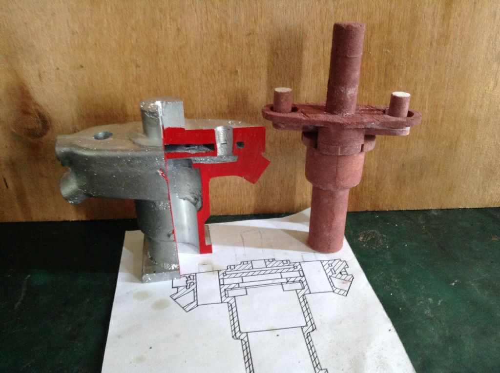

                                    I had a good day today and actually cast a cylinder with out any faults. It has taken many weeks and I was beginning to wonder if I would ever happened. I still have to cast one more and have the box ready packed and hope to cast it tomorrow. The photo shows the flask complete with all cores ready to have the top box fitted and then filled with the molten aluminium. Another busy day coming up!

                                      Today I cast cylinder number 8 . I will eventually cast a perfect pair but this casting for the tractor is the most difficult that I have attempted, mainly due to the thin section of some of the internal parts. I did pour another one today – the outside looks good but tomorrow I will find out what's has happened inside.

                                              Thanks Ian and Jason for the information and photo of the Saunderson and Mills tractor. When I went to the museum it was very difficult to get a good view due to the close proximity of other tractors so I will add this one to the collection of information that I have been able to gather. It would have been good to go to the auction but I live in Queensland, Australia and Geraldine is across the pond in NZ. I was asked if I was going to produce any drawings – well so far I have accumulated 249 A 4 sheets and I still have more to come. This model is certainly testing my patience and skill level but that is what this hobby is all about .

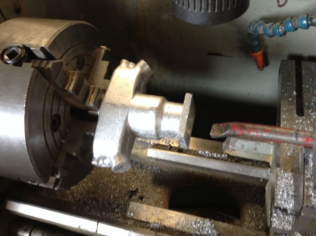

                                                  What did I do today. As I have been on holiday at Noosa Queensland it was good to get back into the workshop feeling refreshed and ready to go! I turned up the valve covers that are screwed into the top of the cylinder head of the Saunderson and Mills tractor. These also hold the spark plugs which have to be "pocketed" so that they reach the combustion chamber. For display purposes I have made another two units and these will have two 3/16" plugs and a primer tap and will replace the working units when on display. The full size tractor had twin plug heads but at this scale it is difficult to fit two 1/4"x32 plugs in. Tomorrow I will finish these of off if all goes well.

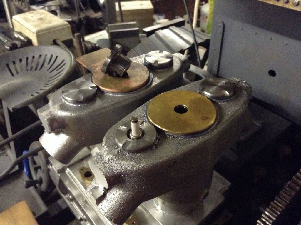

                                                    This week I have been working on the valve covers that also act as the spark plug holders. The plugs have to be "pocketed" in order to reach the combustion chamber. The original tractor had two plugs per cylinder and for display purposes I will make a set but for the working modeI have made single plug units. I am gradually working through the drawings to make them more presentable and expect the full set will be about 150 plus sheets of A4.

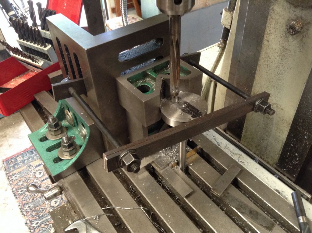

                                                      What have I been doing today? Well I spent most of the morning trying to work out how to set up for drilling the crankshaft for the crank pins. The crank is made from three main parts in the form of internal flywheels and two pressed in crank pins. The problem was trying to work out how to hold the long end of the crank and keep every thing square and accurate. I had to use the mill as the lathe head stock was not large enough. Photo shows cylinders, cast iron liners and unfinished crank. More drilling of holes this afternoon – keep the fingers crossed!
