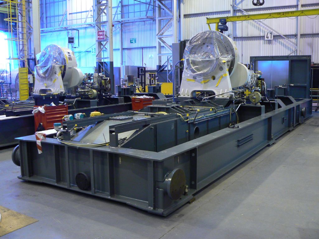

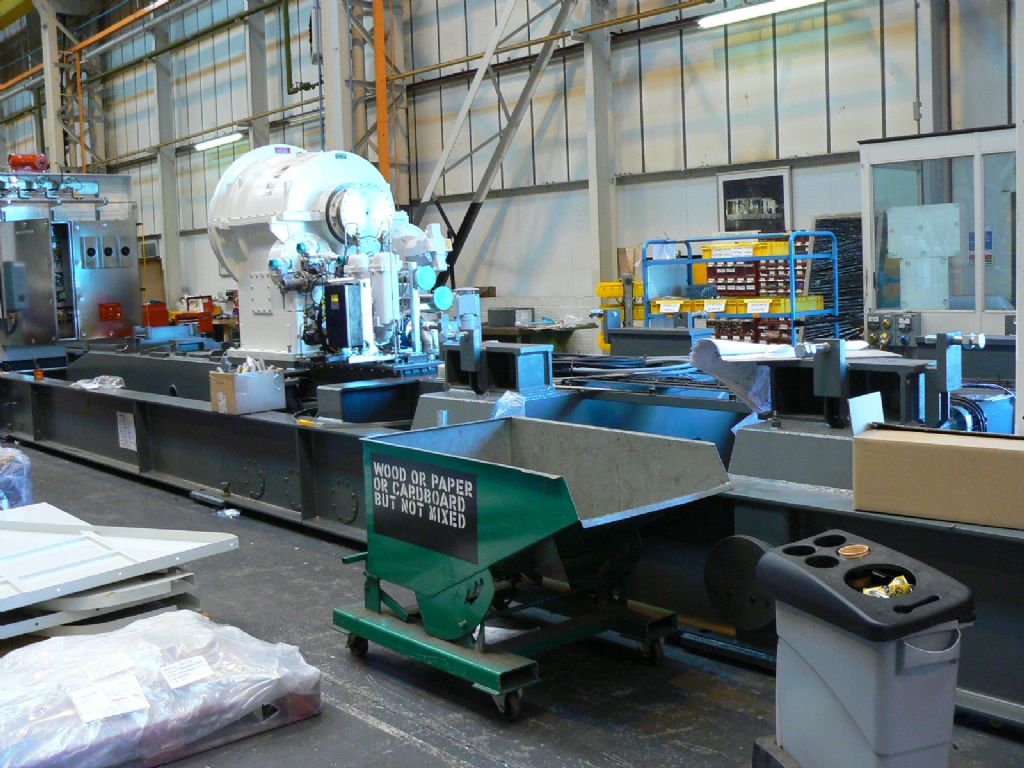

                    Martin Connelly
                      @martinconnelly55370
                      Gearboxes in position of the sort shown in the "Typical Gearboxes…" photo.

                      Henry Brown
                        @henrybrown95529
                        A test bed build picture at Lincoln I presume Martin?

                        Martin Connelly
                          Not test bed. These are contract builds.

                          Henry Brown
                            @henrybrown95529
                            Posted by Martin Connelly on 04/10/2021 18:15:50:
                            Martin C
                            Interesting, the first part of the jigsaw was the gearbox, central point so logical I guess. Unfortunately I didn't ever get to Siemens at Lincoln, my main contact was through Greenray as I latterly worked in the Service department. I did get involved with a few of the technical people when things went wrong though…
                            All good stuff, thanks Martin.

                            Martin Connelly
                              The fabrications were levelled using rules on the machined features and dumpy levels to the as machined position then benchmarks were fitted all round, you can see theses as small rectangular plates on the fabrications. These allowed the package to be levelled on site when the machined features had things on them or were obscured by enclosures etc. The gearboxes were then placed on the fabrications and aligned then drilled, reamed and dowelled to lock them in position. They became the datum for positioning the turbines on the fabrications. The fabricators made a small block with a groove and welded them on the end, one can be seen on one of the photos. We usually had to ignore these and replace them with another benchmark plate in order to get the required tolerances of position and to assist with package alignment on site. Often the last major part to be added was the turbine, sometimes they were shipped without the turbine and that was fitted on site.
