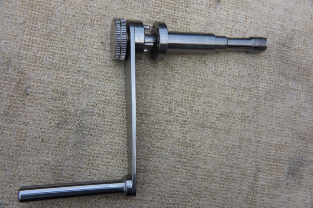

              #536592
              bernard towers
                @bernardtowers37738
