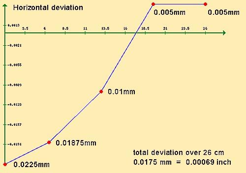

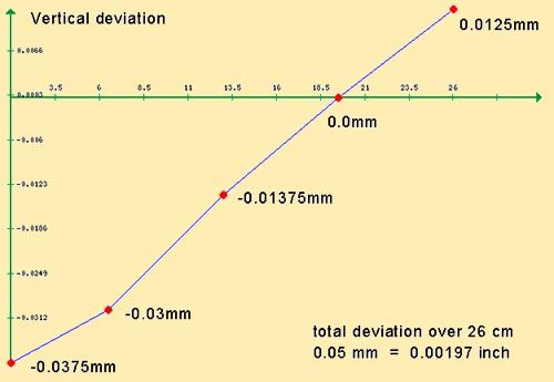

                          Received my steel stocks from the supplier the other day. So, on with the testing…
                          Rollie's Dad's Method of Lathe Alignment
                          Almost immediately I realized that the method has its limitations. This deviation test would work very well if we assume that the bed of the lathe is flat and true. That is not the case with my old ML10 where there is definitely wear on the saddle. This means a hollowing at the chuck end, vertically… and also horizontally bacause of the wear on the dovetail and gib… I am assuming there is also some wear to the carriage slide (bellmouthing?) where it contacts the rear dovetail of the bed.
                          So rather than simply take a deviation reading from the chuck end as well as at one spot further out, I elected to take a series of stepped readings along the length of my test bar. I chucked up a length of 14mm silver steel and proceeded to test horizontal and vertical deviations in the manner suggested. I did this at five locations along the test bar, starting 1cm away from the jaws of the chuck and then at four other locations, each time 6.5cm further on down the length of the test bar towards the tailstock end of the lathe. At each test location I tightened up the carriage locking screw.
                          The five locations are thus: 0cm, 6.5cm, 13cm, 19.5cm and 26cm
                          The vertical readings suggest a condition of 'spindle high' towards the tailstock. But is this just a trick of the low readings due to saddle wear near the chuck end of the lathe?
                          The horizontal readings are also much more out at the chuck end… resolving to what would indicate correct alignment at the tailstock end (where there would be far less dovetail wear).

                          One other problem I found is a certain amount of what I will term 'Vertical Oil Film Droop'. This must be attributed to wear in the main spindle and journal. When turning the test bar the measurement would start at one reading, but rapidly change as the end of the bar sagged… doubtless due to the weight of the chuck and workpiece forcing the spindle down through the layer of oil between it and the cast iron journal.
                          I measured this 'droop' at 0.02mm ( = 0.0008 inch ) out 26cm away from the chuck.
                          I don't know if the deviations I've measured are necessarily so bad for this old machine. In any case, I wanted some feedback on the results before I start tinkering with the headstock mount and playing around with shimming.
                          After that I can try some test cuts for parallel on some free maching steel I've secured.

                            If I had an old lathe that was within .00069" of alignment horizontally over 26cm (10 inches) I'd consider myself blessed. Hell, if I could even accurately measure anything to within .00001" in my home workshop I'd consider myself blessed.
                            Vertical alignment is nowhere near so critical. Until you get down to very very small diameters, the surface of the job where it meets the tool is virtually vertical so the tool being a tad higher or lower makes very very little difference to the turned diameter of the job. GH Thomas discussed this at length in one of his books, I forget which one.
                            I'd leave things well alone until I took a fine test cut over a four to six inch length of 1" bar and see how it measures up.
                            Yes, you will get some droop over 26cm of 14mm bar. Quite a bit in fact. ISTR in Connelly's MC Tool Reconditioning book he says a piece of 1" bar 6" long will droop by .0004". I would imagine almost double the length at almost half the diameter would have considerably more.
                            Re oil film "sag", when making these types of precision measurements, it is customary to run the lathe for 20 minutes at medium to high speed first, to get things up to operating temperature and conditions.
                            Let us know how your turning test on a piece of 1" bar measures up. Will be real interesting to see how it compares with the static test already done. Theoretically, based on the deviation of .00069" already measured, it should be pretty good.

                              from your figures I think you have conclusively proved there is nothing much wrong with your lathe! You would be hard put to find anything affordable in the hobby market giving much better results than < half a thou out at 6 inches, whether you think it is wear or alignment causing the issues.
                              Try to bear in mind also that the spindle also needs some freedom to move, so I don't think there is excessive bearing play either- less than a thou 10 inches out? come on!!! how much better do you expect it to be?
                              Time to stop chasing your tail and start having fun making something useful.

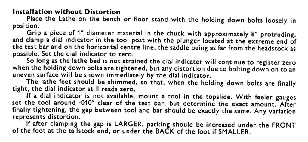

                                      What you need to do next is put a thin shim under one of the lathe's mounting feet at the tailstock end. To correct for a test piece that is larger at the tailstock end like yours is, you will need to put a shim under the FRONT of the lathe mounting at the tailstock end. (The lathe mounting where it is bolted to the bench top, not where the lathe stand is bolted to the floor.). Thickness of the shim is by trial and error. You might start with .005" thickness. Beer can material is traditional! Cut a square about 40mm square and then cut a slot into one side of it about 12mm wide, so the piece ends up a U shape that you can slide under the mounting foot with teh U surrounding the mounting bolt. Then tighten down the bolts and take another test cut.
                                      Another point is that it's best to use a very sharp high-speed-steel toolbit for these tests. Using carbide insert tooling on such fine cuts can provide false reading as the insert can tend to rub rather than cut cleanly.
                                      Also, you might try holding the test piece in the four jaw chuck if you have one. It holds more firmly than a three jaw and is usually less likely to be bell-mouthed slightly, which can skew readings toward larger at the tailstock end.
                                      For a full description of the bed-mounting shimming process, see page 13 of the Myford ML7 User's Manual. It is freely available for download on the internet as it is long out of print and copyright is no longer enforced by the holders. More information here **LINK**
                                      Edited By Hopper on 08/08/2018 05:25:00

                                        Yes, I could try some shimming under the bed, and although it might help that portion of the cut out away from the headstock, I have my doubts about the area closest to the chuck. One would be asking for rather a fair amount of twist – and just along that short section of bed – to correct for the difference. I'm really thinking that this is a case of accumulated wear over time.

                                          But still worth reading the User's Manual on the shimming procedure recommended by Myford, and tested with a four to six-inch test piece so it must influence performance up close to the chuck, which I agree seems surprising but is the way it works.
                                          Plus tightening up the headstock bearing may take up some of the taper turning tendency.

                                              Following Myford's standard procedure for shimming the bed feet to get the lathe cutting straight would be a lot easier.
                                              #366229
                                                Myford's ML10 instructions:

                                                  So I'm left with a few choices.
                                                  Tighten up the main journal a wee bit and try to shim the bed a bit. Couldn't hurt and might help. At that point I would just continue to use the lathe as it is until a better option (new or used) presents itself.
                                                  Totally agree that a replaceable bedplate would have been just the ticket for the ML10, most especially given the fairly straightforward profile. But that is all in hindsight as Myford chose not to take that route. And, yes, one could elect to have that sort of thing done, but this demands access to larger machine tools which I do not have. Paying for same – let alone finding someone with the necessay expertise for such an adventure – would seem to be prohibitive.
                                                  Regrinding the bed is always possible. Pursuant to that I got in touch with Myford Solutions in Holland. The bare minimum would be to true up the bed way with a surface grinder, clean up the dovetails on a Bridgeport and similarly treat the carriage and the gib. The price for this is at least €500 and that is not even allowing for the cost of shipping the bed and carriage up and back (since I don't have a car) . If I went further and had the man do both the cross slide and tool post slide it would bring the cost up above €750. Pretty high considering that the feed screws and nuts would still be doubtful… and again, that is a hefty chunk of the cost of a new lathe.
                                                  I'm hoping to perhaps find someone in my own area (Gent, Belgium) to do the work, but we don't enjoy the same healthy engineering hobbyist community as up in the UK so my search may be both long and in vain.
