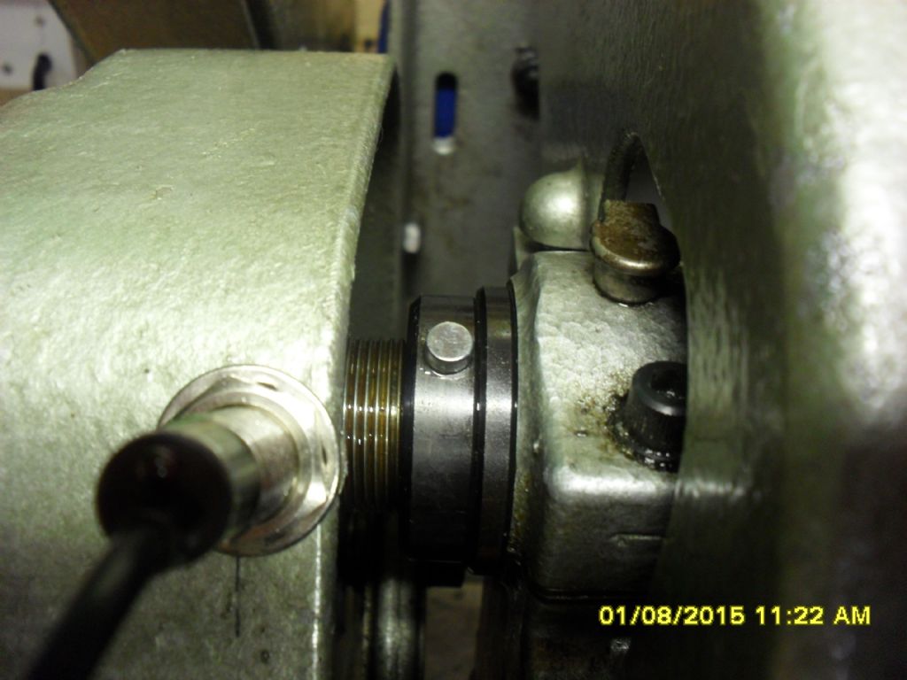

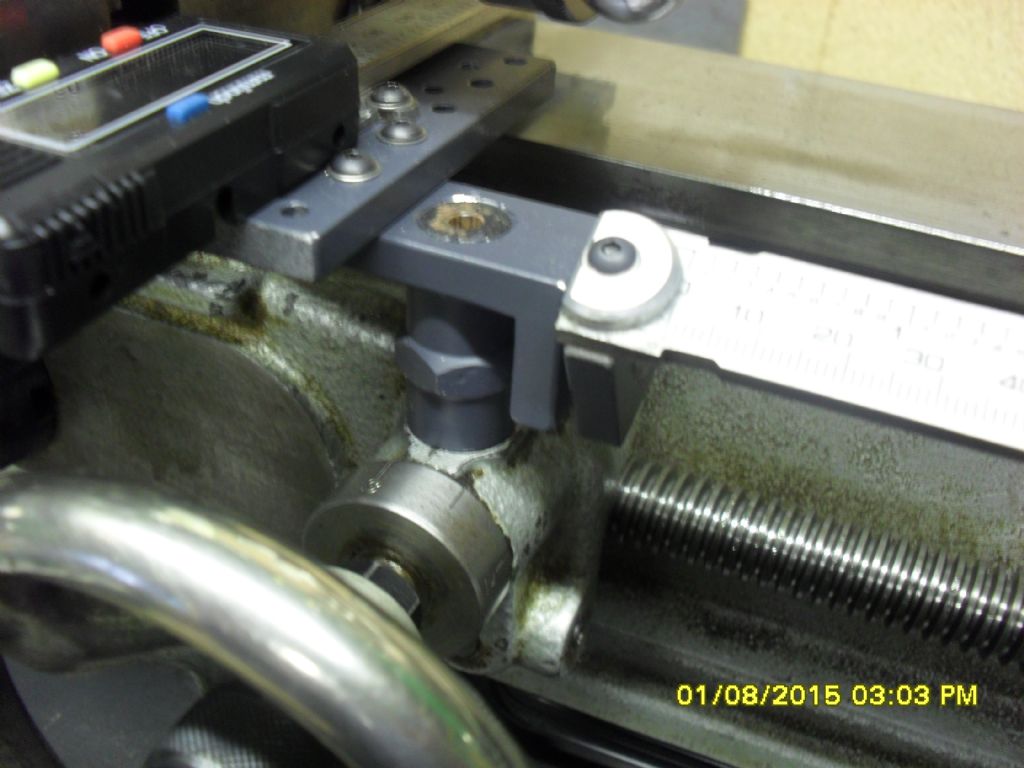

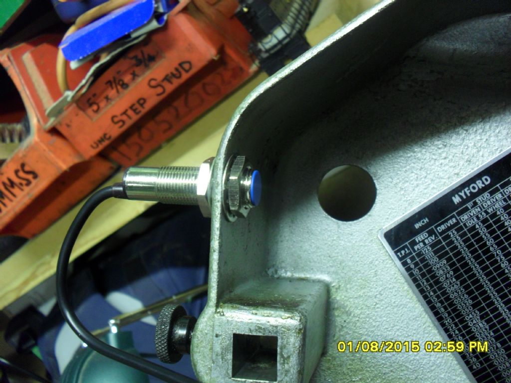

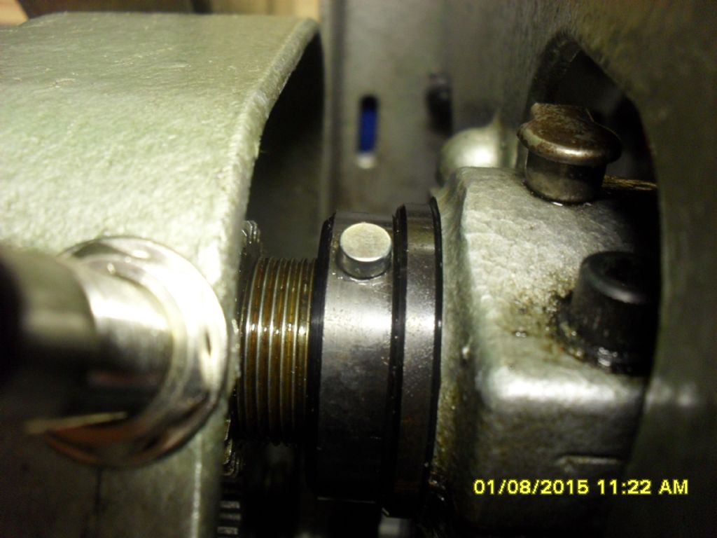

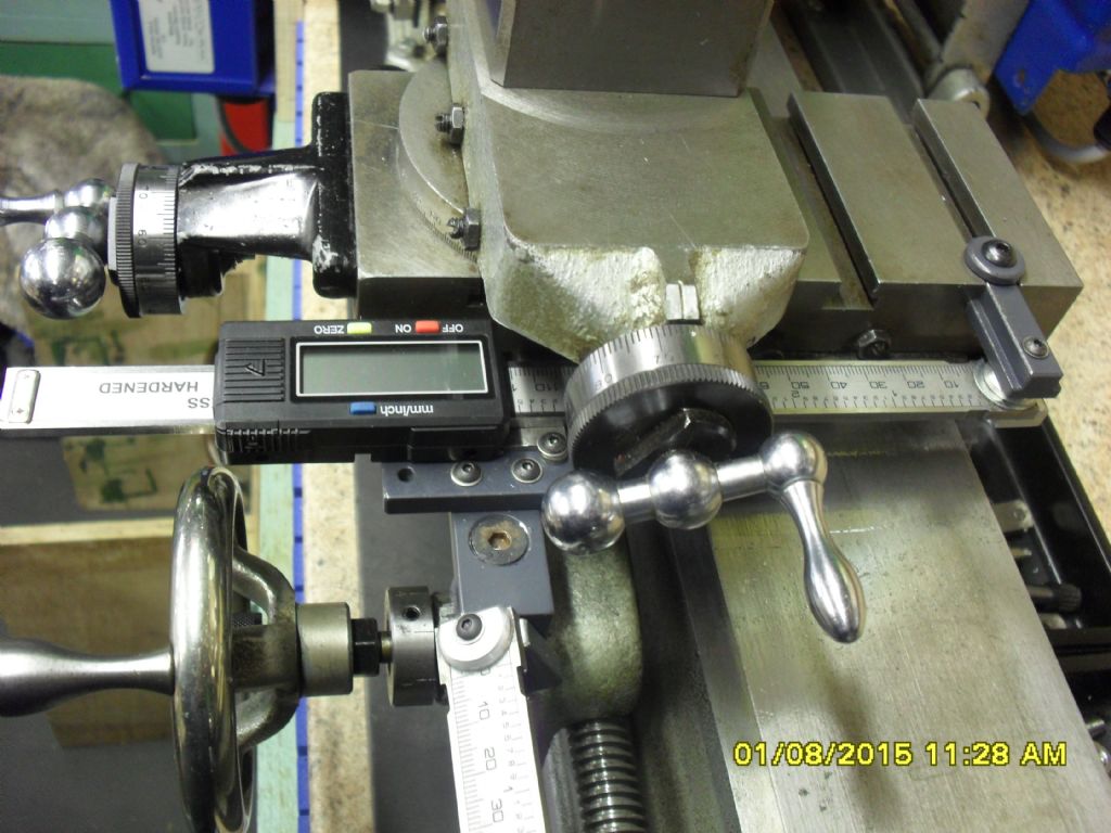

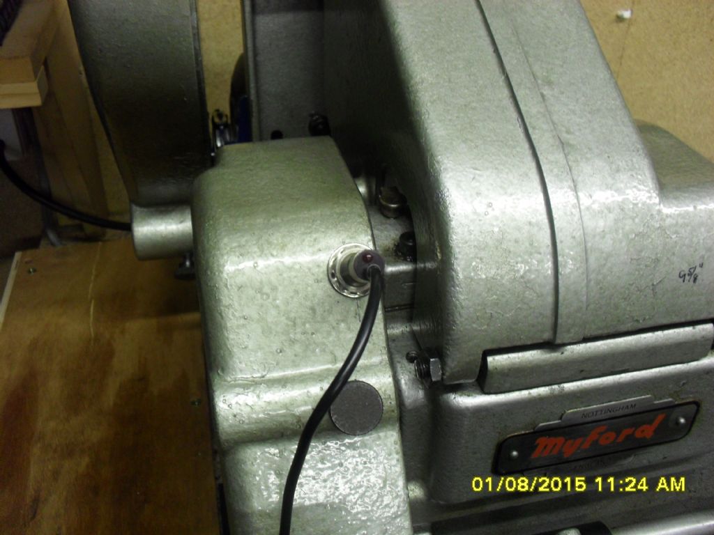

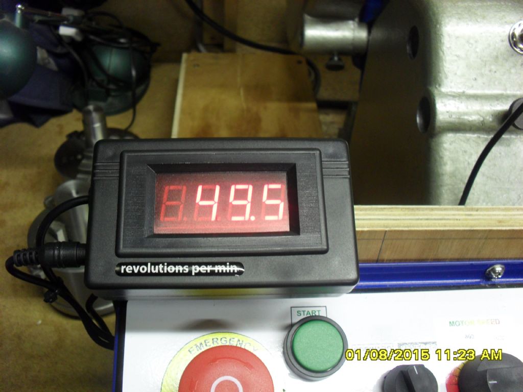

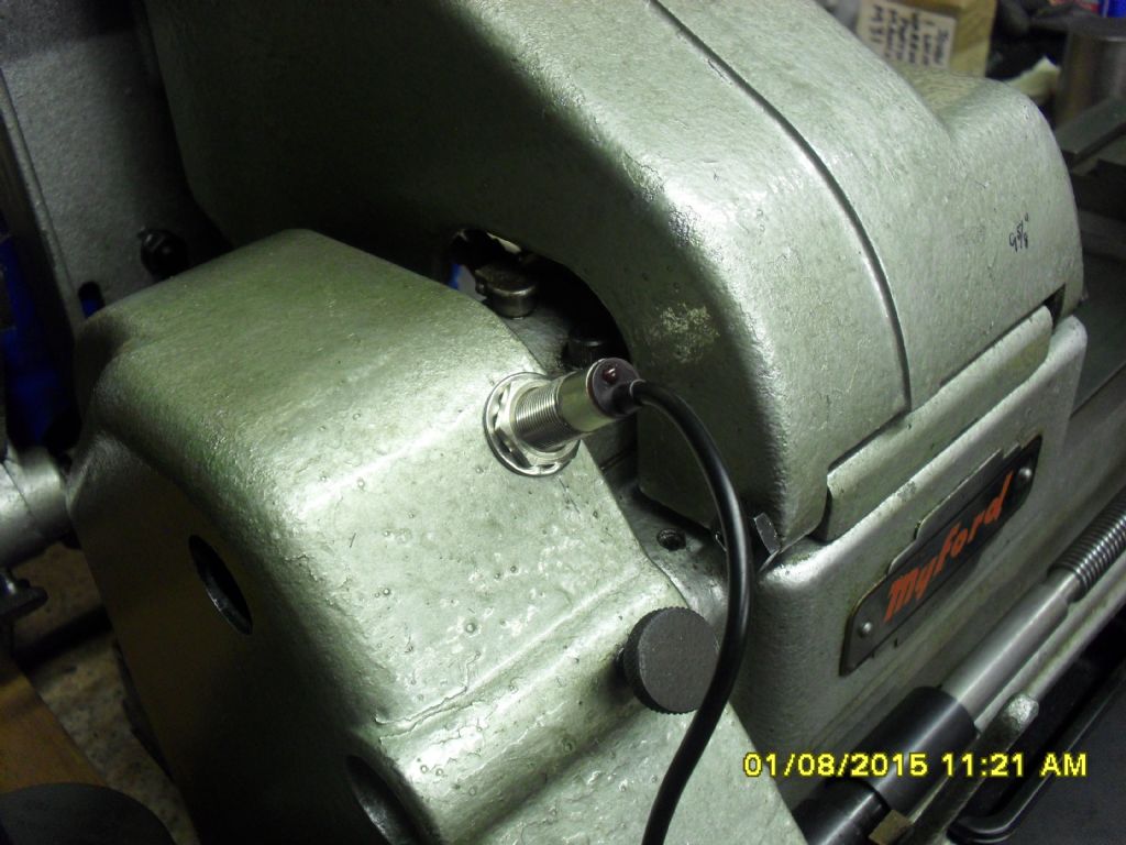

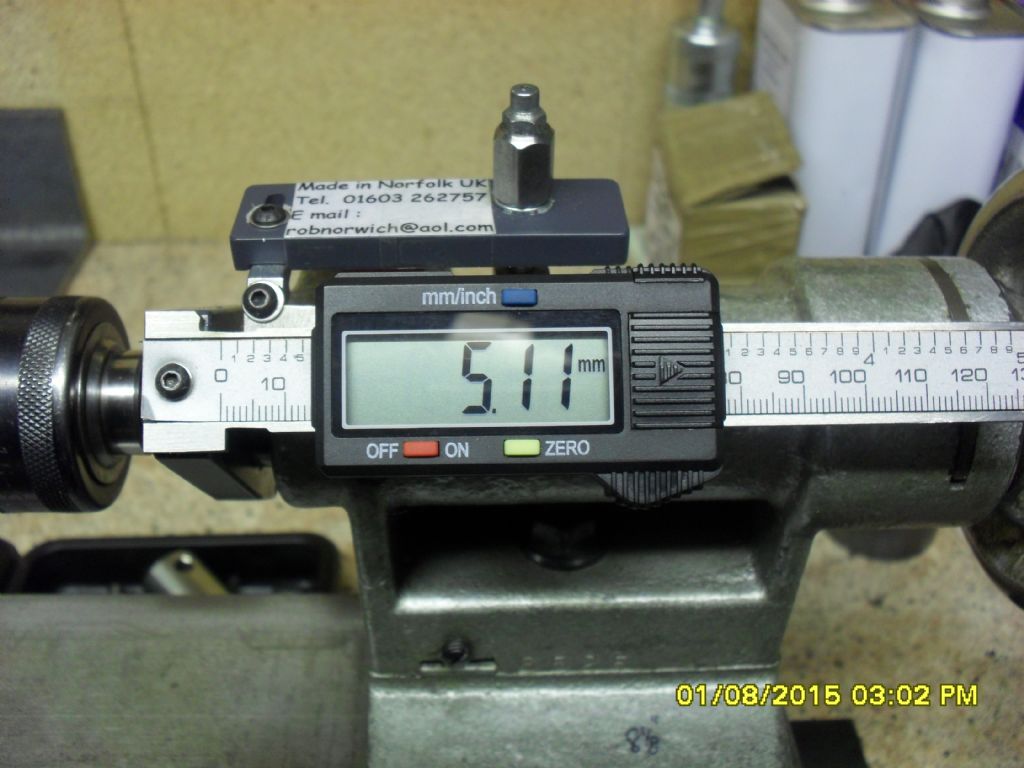

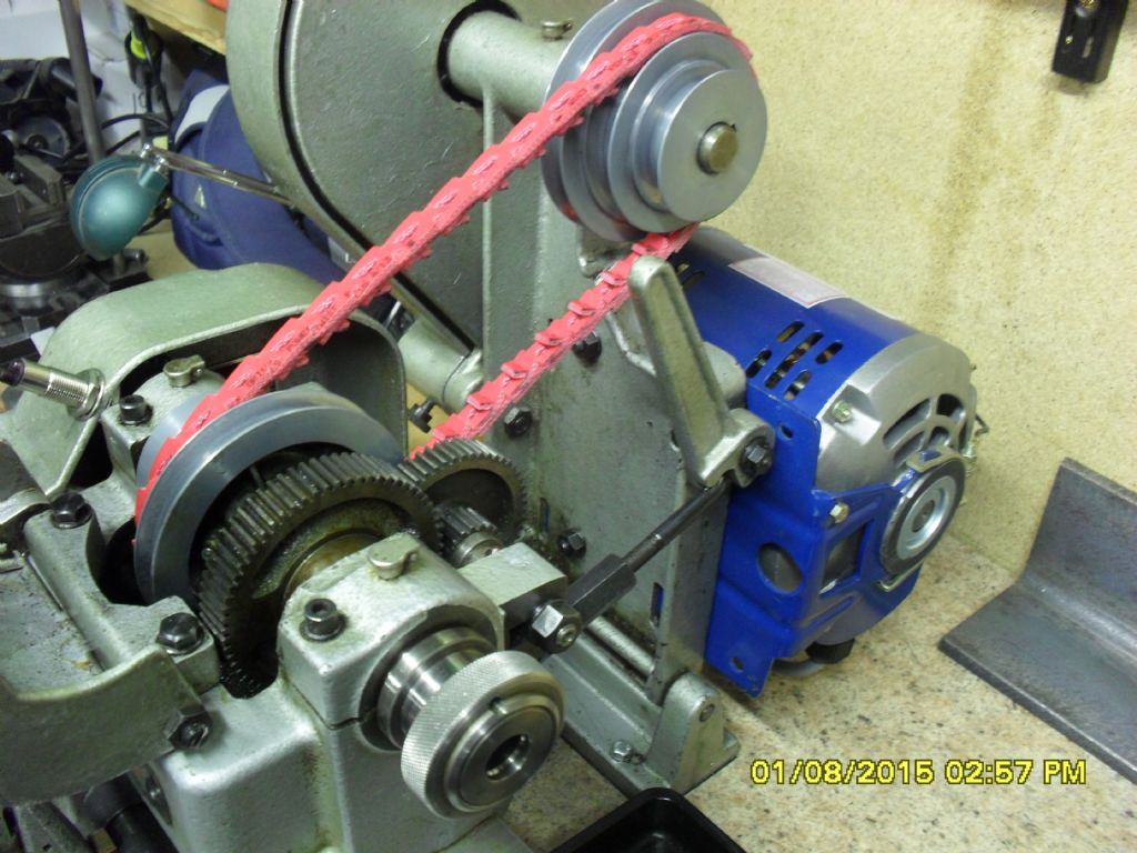

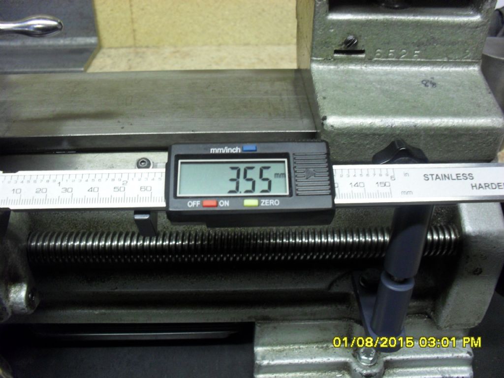

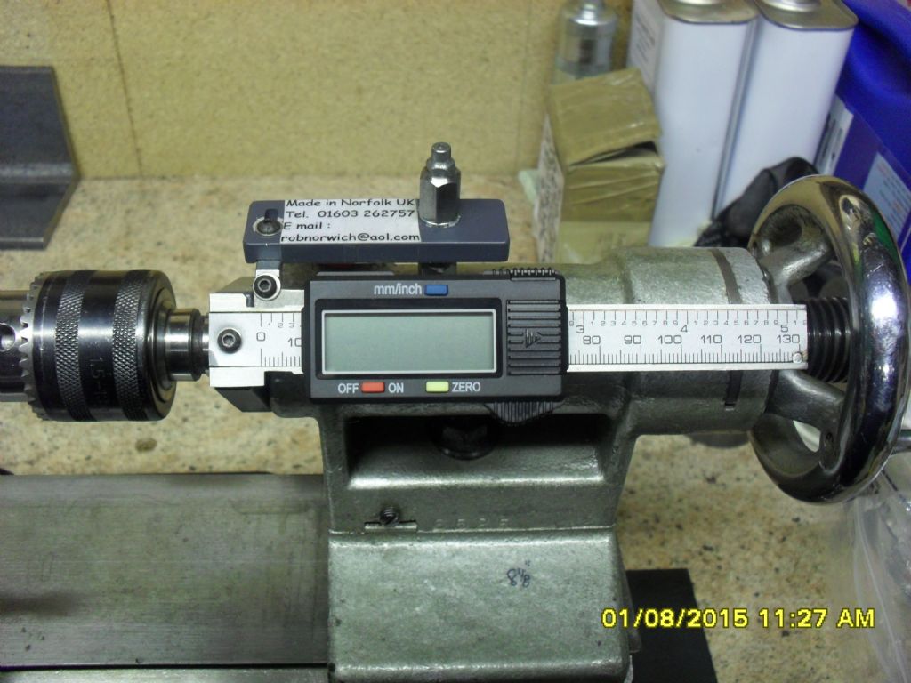

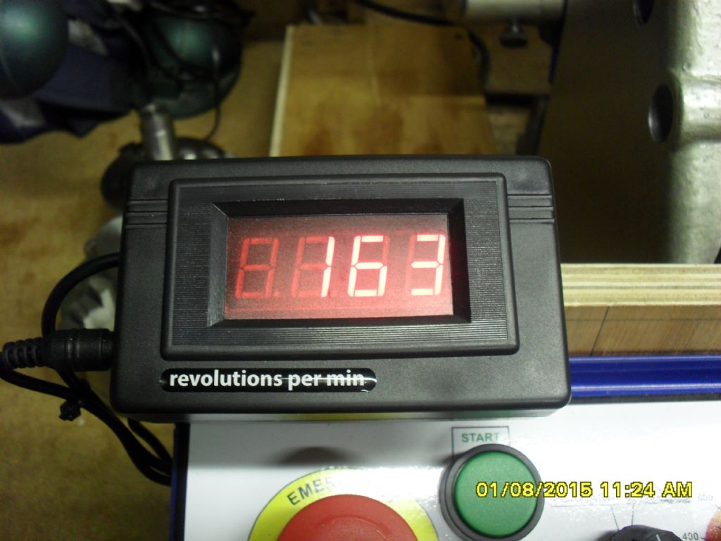

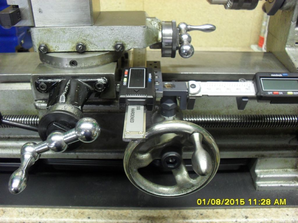

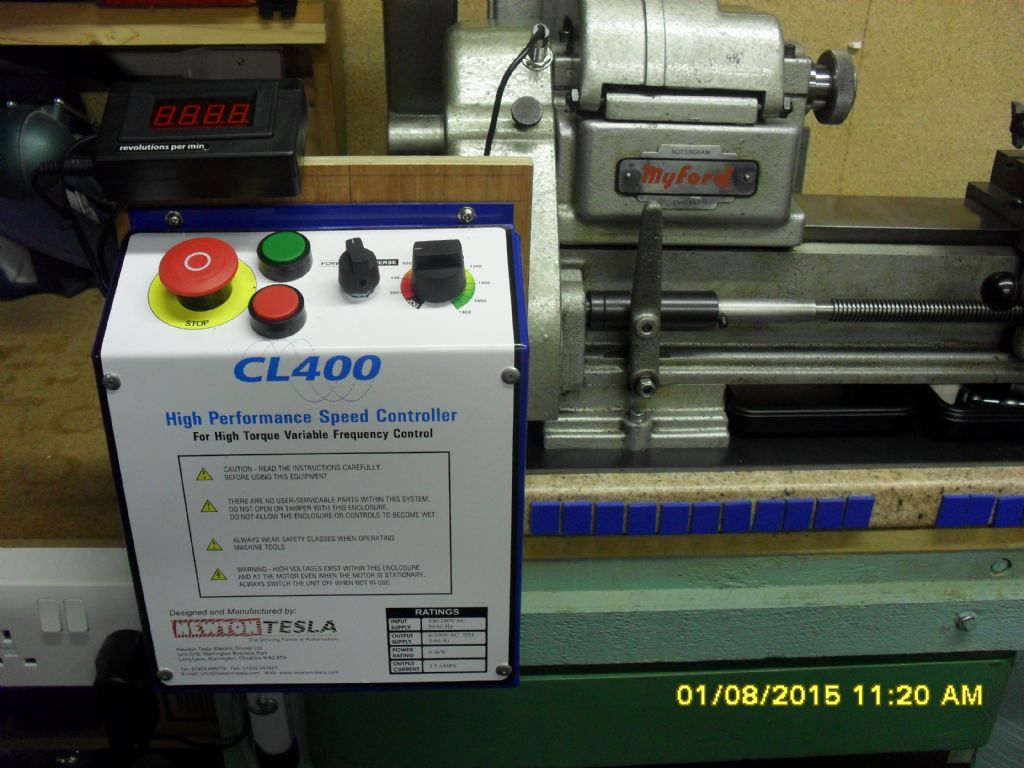

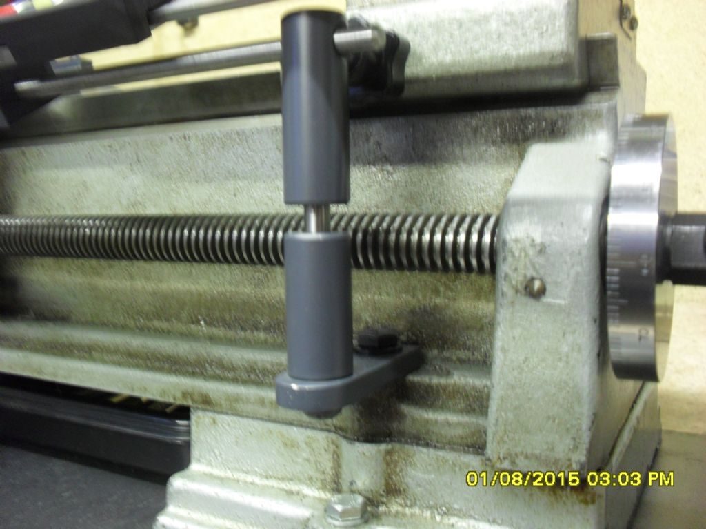

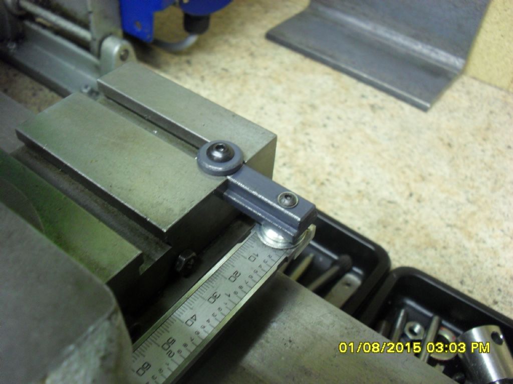

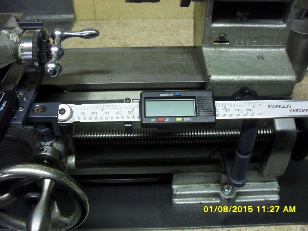

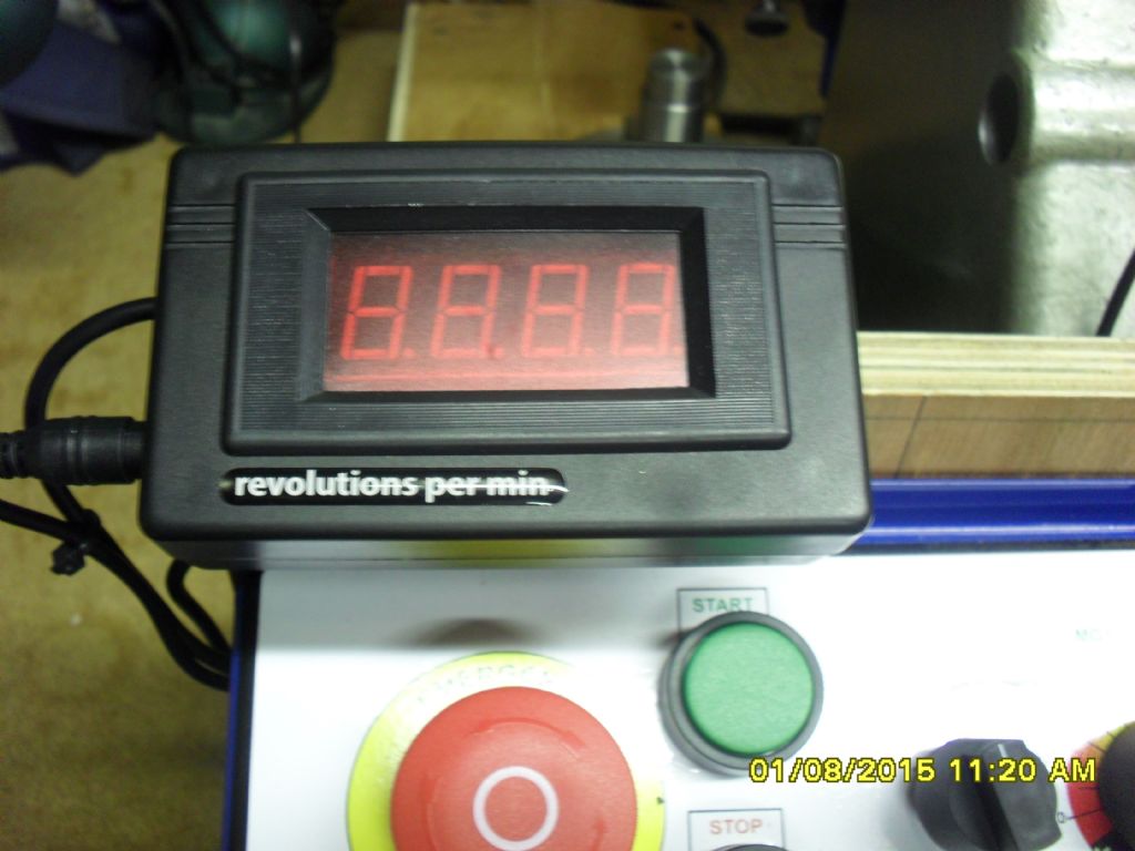

      DRO unit fitting to cross slide rearMounting for carriage & cross slide DRO unitMounting for carriage DRO unitTailstock DRO unit diplayx y Axis carriage DRO unit 2Cross slide DRO unit 3Sensor mounting 5New link beltCross slide DRO unit 2Cross slide DRO unitx y Axis carriage DRO unitTailstock DRO unitSensor mounting 4Digital rev. counter working 2Digital rev. counter workingSensor mounting 3Sensor mounting 2Digital rev. counter sensor mountingDigital rev. counterAs promised some photos of the finished mods on my ML10 lathe so far.
      John.Newton Tesla variable speed controller

        What a well kitted out ML10 and it looks in excellent condition. I do like the large hand wheel on the saddle – a much better option than the standard ball handle supplied on mine.
        One thought I had about using the Super7 base is that the tool seat might be raised since the centre height of the Super7 is higher than the ML10.
        Jim.

              Hi Jim,
              Glad you like it so far.
              The ball handle on the saddle had to go I'm afraid,but then these machines were made at a lower budget years ago to make them more affordable and they do offer potential to bring them up to ones own standard,do they not.
              I do agree with you on the height change using the Super 7 swivel base but then it could be possible that the ML10 top slide may just be smaller in height than the Super 7.I really need to find this information.
              John.

                  john pickens
                    @johnpickens21750
                    Thank you for this info ,much appreciated.
                    Will let you know asap.
                    PS do you prefer Robbo or Phil?
                    #175360
                    john pickens
                      @johnpickens21750
                      Just checked the measurements.
                      Top dovetail for my top slide is 37.5mm base is 28mm.
                      My cross slide bore is 35.0mm.
                      My height from top of cross slide to top of top slide base is 21.5mm.
                      Thank you for your input anyway, at least I now know that the Super 7 top slide base is not compatible and so the search for the correct one continues.
                      John.
