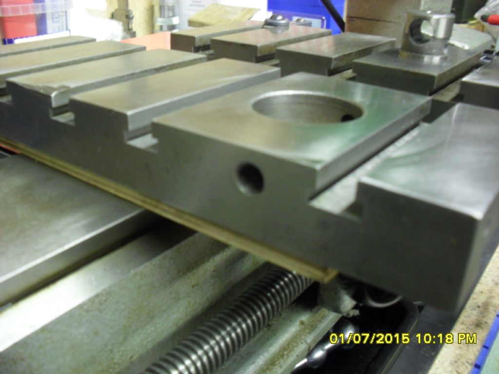

                              I was very kindly given a long cross slide for the ML10 which also had the gib strip included and no feedscrew,not a problem as they are still obtainable.It is the base unit which is used to hold the top slide which is very similar to the Super 7 which I cannot source.My set up at the moment is the short cross slide with the large countersunk hole with a countersunk short arbor which attaches the top slide base.To change over to the long cross slide is not possible on this set up.Can anybody shed some light.

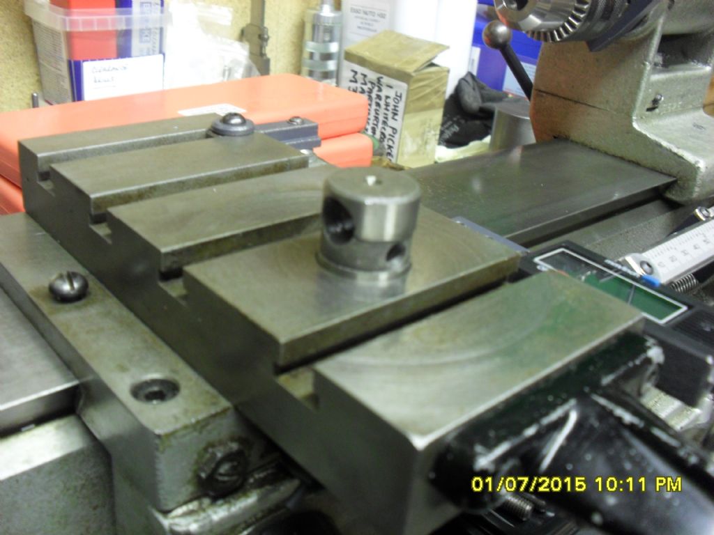

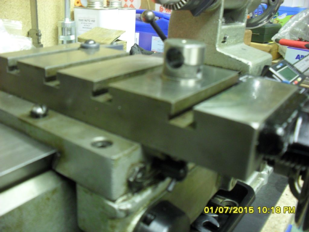

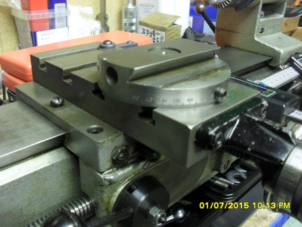

                                            The long cross slide does fit the the swivel base,I've tried it.
                                            I think pictures paint thousand words.cross slide
                                            #175167
                                            john pickens
                                              @johnpickens21750
                                              I hope these pictures help.
                                              Dimension of long cross slide (left) is 9 7/16" x 3 1/4" with a 1 3/8" hole.
                                              Dimension of short cross slide (right) is 7 1/8" x 3" with 13/16" hole
                                              Notice there are no tapped holes in the side of the short cross slide for the thrust pads as they are in the top slide swivel base which shows where the thrust pads contact the smaller holes in the short post protruding through the cross slide.
                                              So the problem is that I need to source the correct swivel base in order to fit the long cross slide.
