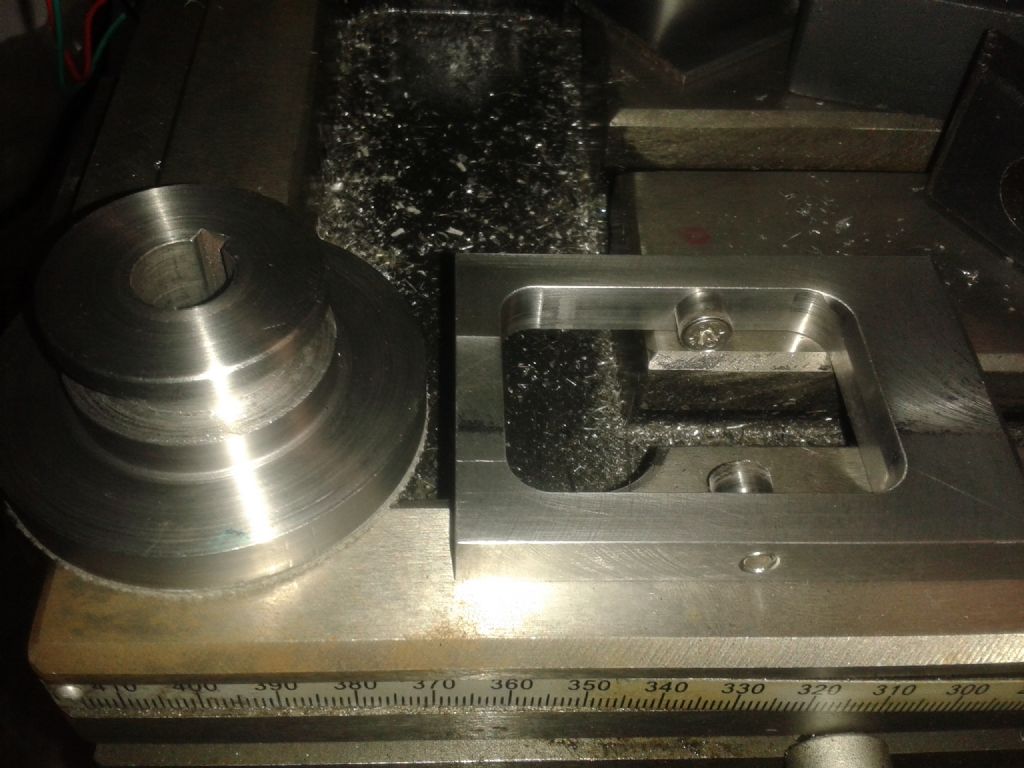

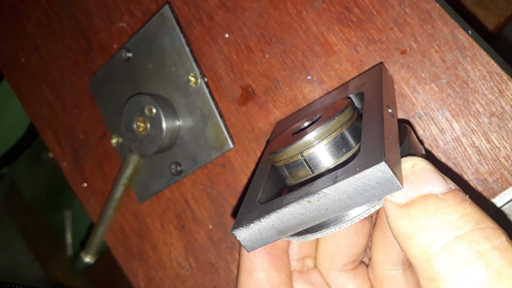

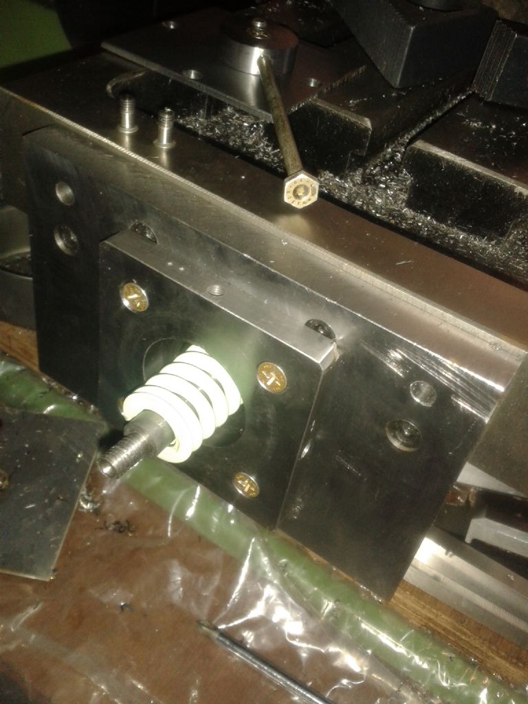

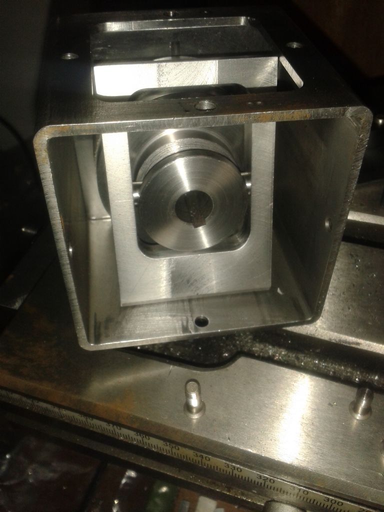

      Much better if there's no chance of damage by manual turning of the hand wheel. Looks like I have done a bit of extra work then, as mentioned in my previous post I have already machined the parts, so I'll make do with what I have for now – served me as good exercise!

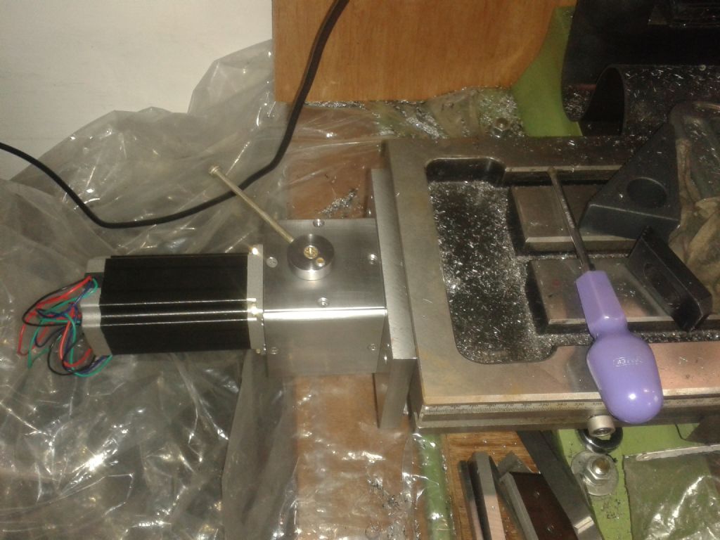

      Some photos of the project so far – mechanical bits ready.
      Assembled unit, nema 23 and drive module

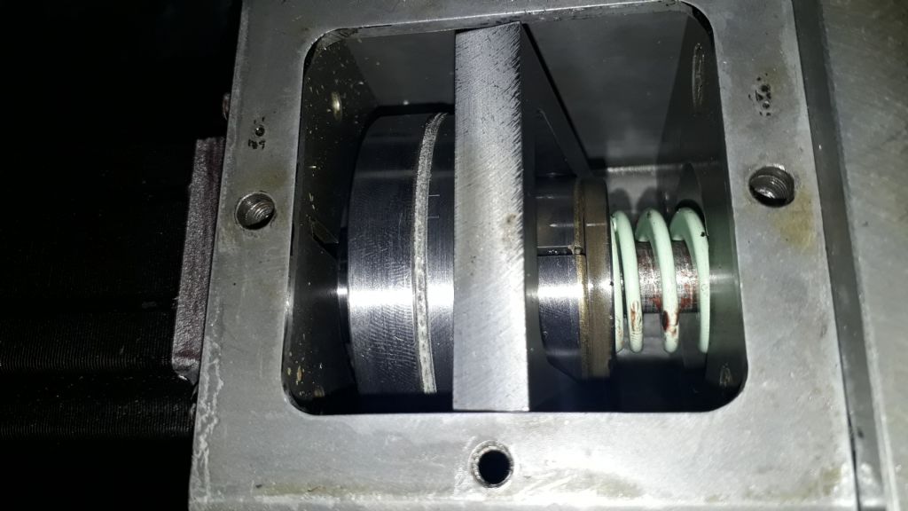

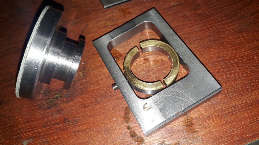

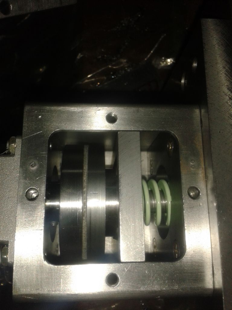

      Clutch cover off: a drive hub secured by a grub screw to the motor shaft, a keyed clutch plate sliding on the lead screw, a die spring to press the clutch to the drive hub and a release fork to release the clutch plate.
      Machined a new table endplate using the original to pick up the holes.
      Clutch and fork

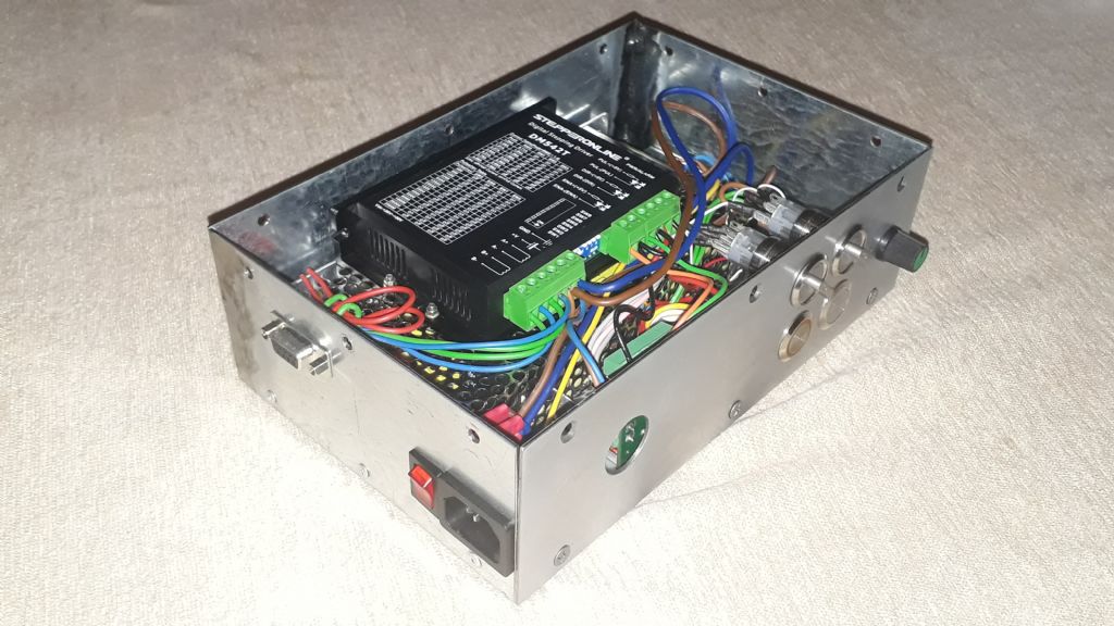

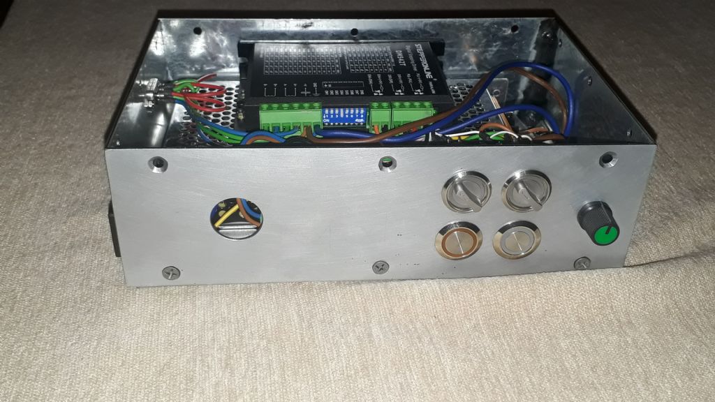

              It's been a while, time for an update on this project. I had finalised the mechanical part of the powerfeed and got the electrics "temporarily" connected to figure out what goes where before I place everything in a control box. Unfortunately the temporary became permanent, so it been wires and boards hanging since.
              Last week I finally got the ball rolling and built a little box and tucked in the power supply, frequency generator, motor driver and switches. I tried to place everything as neatly as I could and I'm quite happy how it turned out.
              The hole in the fave plate is for a still missing a switch which I want to use for operating a separate stepper motor to lift and lower the head. I'm using one driver to control both stepper motors, one at a time by switching.

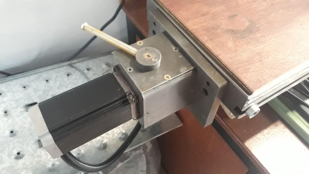

                Powerfeed project finally finished.

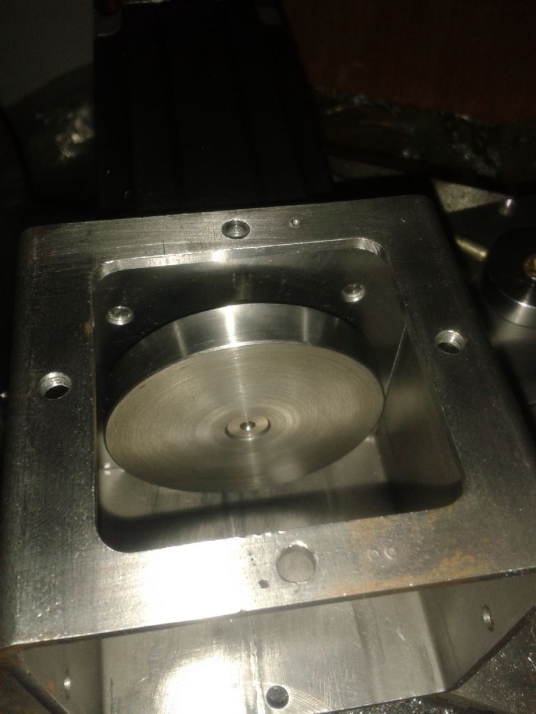

                Did some changes to the clutch release mechanism which was not working as intended – rather than the two rollers mounted on the fork to release the clutch I replaced them with a bronze thrust bearing. This gave a smoother feel then turning the handwheel with the motor decoupled.
                Here's a video of the powerfeed operation.
                Nema23 stepper, direct drive to the lead screw.
                Clutch internals, motor drive disk, clutch friction disk, thrust bearing on fork, actuating spring.

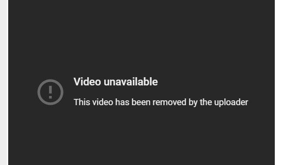

                            Unable to view video… message says…
                            George.
                            #479939
                            ChrisB
                              @chrisb35596
                              Posted by mechman48 on 14/06/2020 23:14:23:
                              George.
                              Sorry about that, I edited the video and thought I saved it, but apparently instead I deleted it!
                              Here it goes again…
