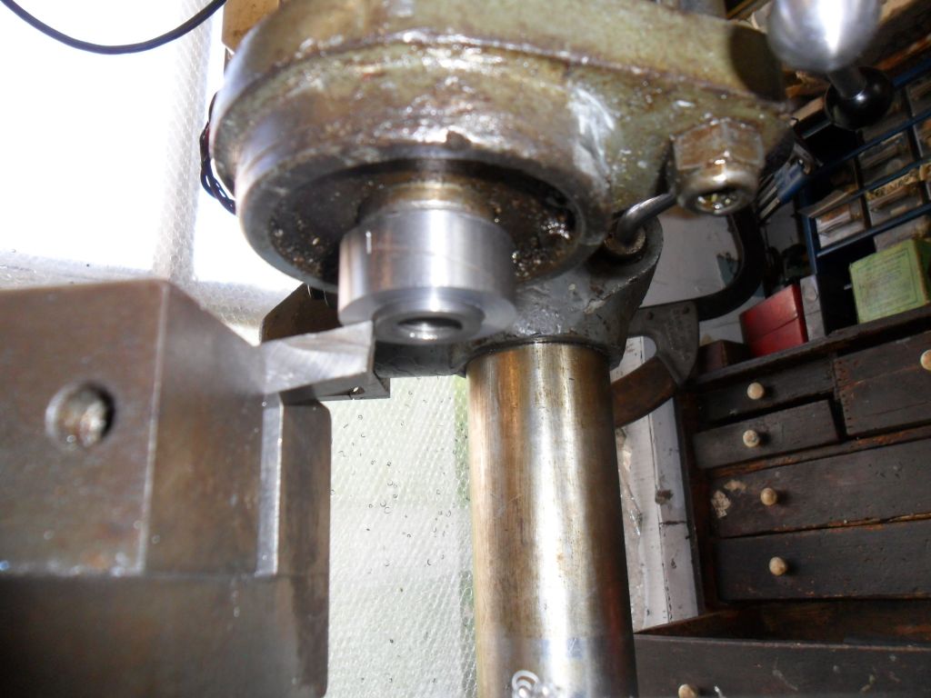

        Nobby- is that a cross piece you insert through the 'MT tang extraction hole' which you then thread an inverted drawbar into that runs up inside the collet chuck from below?
        If so, I like the idea…. if not, I've no idea what you've created?!

          I can see how the cross bar and bolt retain the 'thing' in the Morse socket, but how does the tooling fit to the 'thing'

            The tools fly cutter boring head ect screw on with 1/2" thread 2nd picture shows me turning the location nice and true in situ I have made several cutter holders 6MM one shown in 1st picture 6 m.m cutter holdertruing 3/4 location
