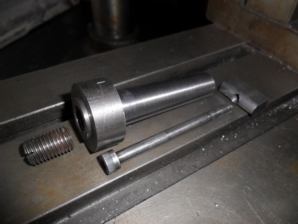

                                                    no drawbarvarious cutterstry thisHi Guys Have a look at my idea to hold cuttersparts
                                                    Edited By Nobby on 03/07/2017 12:51:00
                                                    Edited By Nobby on 03/07/2017 12:52:45
