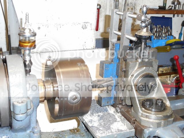

                    I do all my milling with a vertical slide on my M-type. It works fine for model-sized stuff but I find that tooling sized jobs really are pushing the edge of the envelope to where it really is a make-do scenario. For example, milling a piece of 1" thick plate to make a fixed steady was something I would avoid doing again on a vertical slide. I milled the body of my GHT-style fabricated versatile dividing head on the vertical slide and again it was stretching the device to its limits – but got the job done. Ended up bolting my 4-way toolpost blanks straight to the cross slide on parallels to eliminate the flexiblility of the vertical slide.
                    IF you do go with a vertical slide, avoid the double-swivel type as I find mine moves rather easily if a cutter tooth digs in on larger jobs. I plan to drill, ream and dowel both the swivels to lock them in position and I will also put a packing piece under the bottom of the vertical ways that rests on the lathe cross slide table to minimize flex there also. I reckon the solid non-swivelling vertical slide would be much more secure under heavy loads, and cheaper to buy. I have yet to really use the swivelling facility. The vice can always be mounted at an angle, and the whole slide can be mounted at an angle on the cross slide table, so the swivels are maybe nice if you ever need to mill helical bevel gears or such exotica but can be a nuisance on the other 99 per cent of jobs if they are heavy cutting.
                    The other thing I find is that heavy milling wears the headstock bearings, necessitating adjustment more often than turning does. Much more. This is on my old lathe with smallish bronze bushing headstock bearings. Tapered rollers may be more durable.
