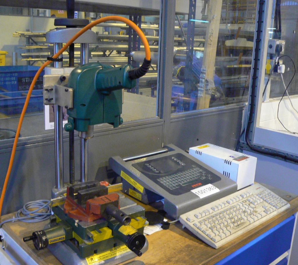

                  #248354
                  choochoo_baloo
                    @choochoo_baloo
                    Thanks all for the input – most helpful.
                    I have a related question: in browsing standalone compound tables, e.g. http://www.axminster.co.uk/proxxon-kt-150-aluminium-die-cast-compound-table-474334 , I don't know what die cast aluminium is.
                    How common is it to use instead of steel for a milling table? Wouldn't being aluminium seriously limit its performance?
                    #248358
                    Martin Connelly
                      @martinconnelly55370
                      I bought one of these at work for positioning items under a dot matrix marker.
                      **LINK**
                      It is well made and suits the purpose it is being used for here. For milling it may be too weak for working with steel. The problem with the material it is made from is that it is easily marked and I can imagine getting some debris into the slides and causing damage. Cast iron will be far more resilient. The leadscrews are not acme style, just basic 60°. The leadscrew nuts are short and made of brass, the operating knobs are plastic and there is no way to reduce backlash without modifying the table.
                      I would look for a suitable cast iron option.
                      Martin
                      Edited By Martin Connelly on 28/07/2016 14:59:30
