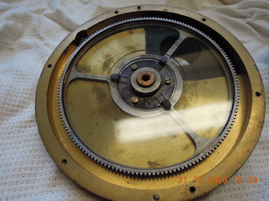

        I've finally got around to cleaning up the optics on my OMT microscope. The eyepiece heads, or 'oculars' contain a 3" glass disc which you can see in the picture below. What you cant see in the picture are the myriad of microscopic graticules, thread profile lines and cross-hairs that lie on the surface of the glass.
        Also sitting on the glass unfortunately is 70 years of doom and gloom which I would like to try to remove. Having previously successfully dissolved numbers on an old watch face with alcohol I'd like avoid making a similar mistake this time.
        So, are there any experts in the house that can enlighten me and comment on:-
        a) how were the graticule lines actually created on glass in the 1940s~50s era ?
        b) what would be a safe cleaning solution and method to remove the contaminant ?
        Gerry

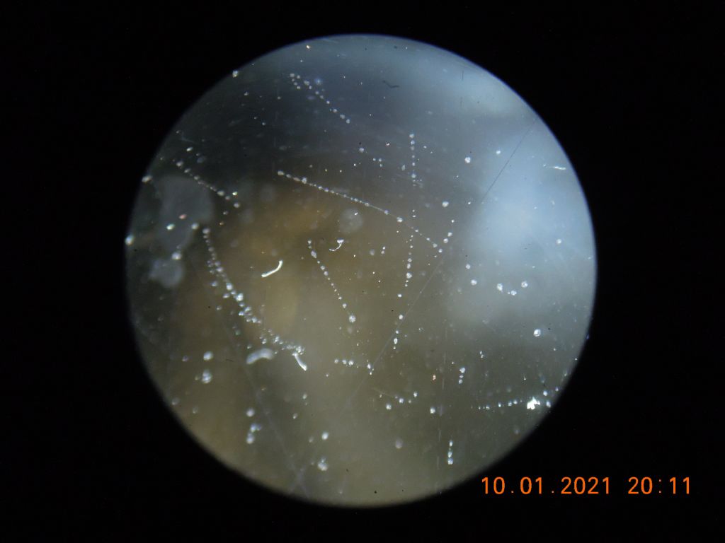

                        In the words of Bernard Cribbins "we wos getting nowhere" ! I began to clean the lenses and graticule discs as carefully as possible, fluids and no abrasion etc, but in the end only mechanical removal worked. The culprits were these things…..
                        100% of the glass surfaces seemed to be covered in these myriads of fine lines which where interspersed with white dots. Invisible to the naked eye, these dots were very tenacious, quite hard and almost crystaline in their texture. I found the only way to shift them was to take a new flat-edged scalpel blade and run it carefully over the surfaces.
                        I couldn't detect that the scraping with the steel blade left any mark on the glass, but if it did it was invisible to my small 20/40x microscope.
                        I'm puzzled as to what might have created this phenomena. I have heard of fungus being a problem on lenses, but fungus doesn't normally follow straight lines, does it ?. So perhaps it was the deposits of some kind of spider or mite?
                        I have more lenses to do. What are your thoughts on the use of an ultrasonic cleaner next time ?
                        Gerry
                        #519161
                        Shadow
                          @shadow
                          Fungus growth usually creates more of a fog effect with permanent etching. I have had lenses with a pattern similar to yours that were described to me by older experienced technicians as a glass eating bacteria, usually from instruments stored in a damp high humidity area. Extreme cases looked like a vine pattern nearly covering the area.
