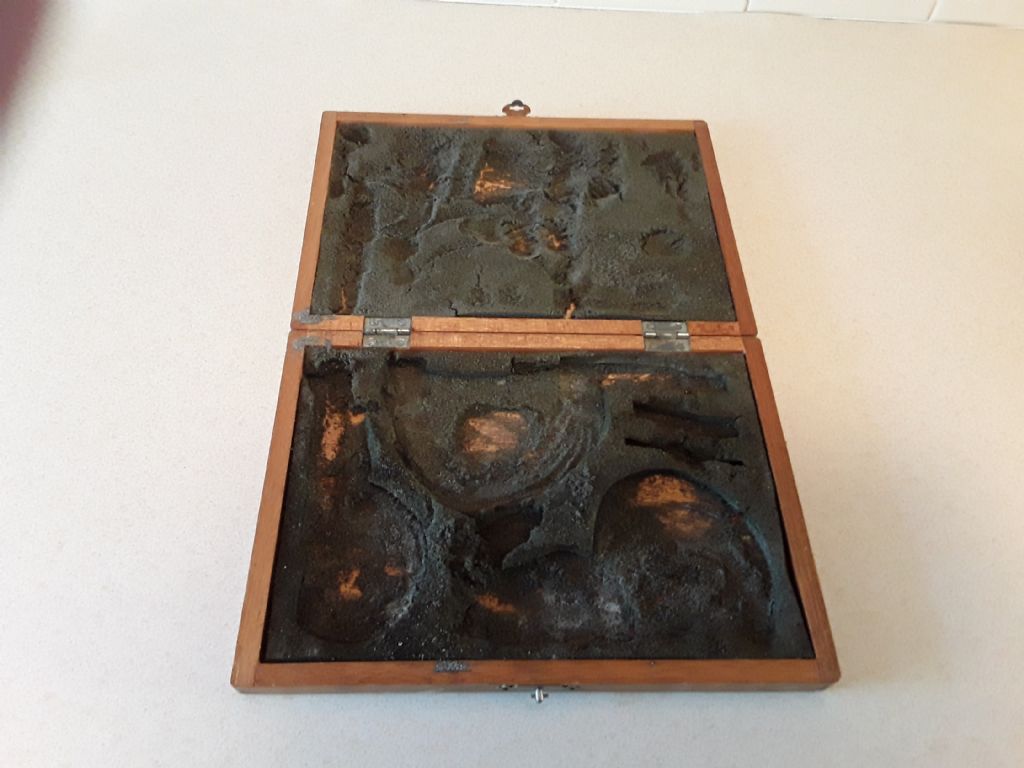

      I have had a 0 – 3" Mitutoyo micrometer set in it's original box for some 40 years, the 0 – 1" mike is usually to be found on my bench or lathe but never in the box. Imagine my horror earlier when I went to use the 1" – 2" and found that the nesting foam in the box has turned to dust. Worse still is where the dust has adhered to parts of the mikes and setting bars has caused some kind of corrosion, not on the painted frames only the satin chrome and bare metal. I've managed to clean most of it off by scraping with a finger nail, cocktail stick on the knurled parts and metal polish, but there is some staining which I cannot remove fortunately not that prominent. Has anyone any idea what could cause this to happen? I can't remember when I last opened the box maybe a year or more and it was ok then.
      I have just opened another Mitutoyo box that I have containing a dial caliper which has definitely not been used for many a year and the nesting foam in that is starting to turn to dust, fortunately I've caught that in time.
      Need to source some hard foam to make some new nesting packs, suggestions anyone?
      Phil

          Hi Phil,
          I get this all the time with old cased micrometers, it does not seem to matter what make they are although perhaps Mitutoyo are slightly worse than M&W.
          All I do is blow the worst off and out of the cases; I use meths to clean the instrument and if really bad a gentle touch with very fine grade Garryflex block. Not much can be done about the staining.
          For the case linings I have tried all sorts and latterly have settled on either the soft black padded vinyl that HALFORDS sell as boot lining OR the black non slip material that lines drawers. Both are good.
          Using foam when you have a lot to do is abit of a faff as it does not cut well leaving ragged edges.
          I use spray mount sparingly to stick the new linings in.
          For larger cases I use adhesive backed sound proofing foam from EBay, cost very little and one lot will last me literally years and I do a LOT of cases.
          Cheers, Martin

            Phil … I share your pain
            Not only micrometers, but exotic microscope parts, have suffered.
            The only truly stable foam that I know of is Plastzote

                        #393159
                        peak4
                          @peak4
                          It's an issue with many plastics as the plasticisers evaporate, or migrate to the surface.
                          N.B I'm not a chemist, just an observer.
                          Rigid plastics get brittle, foam disintegrates, which might actually be the same process.
                          I'm guessing its more obvious with foam due to its much higher surface area. I wonder of the longer term solution is the old fashioned one and to use felt as a box liner.
                          The other really obvious problem with disintegrating foam, is in the compliant pars of loudspeaker cones. Rubber lasts longer, but the foam falls apart after a few years, especially if you live near the sea.

                                        The Mitutoyo foam seems to be excessively sensitive to temperature fluctuations. Back around 1995 a friend got a used Mitutoyo dial capiler. maybe 5 years or so old and clearly well looked after. After about 3 years in his unheated, but properly brick built and dry garage, the foam had pretty much crumbled away. Due to its location and alignment that garage was very cold in winter and very hot in summer. Similar Mitutoyo foam in a temperature stabilised lab environment still good after 20 years to my certain knowledge. Not bought new during my time in the lab. Probably pushing towards 30 years old when I left.
                                        I wonder what wood Starrett used for their plain wood cases? Attractive, lasts well and clearly doesn't affect metal.
                                        I have some micrometers in "distressed" plastic cases and really should get round to making something better. Starrett style would be pretty easy to copy and looks well if I knew what to use.

                                          Mitutoyo tools are excellent, but their boxes are rubbish. The cream coloured boxes that their micrometers come in are extremely brittle, i have several where they have cracked or broken, leaving the tools open to damp and dirt, not good.
                                          The felt in the micrometer boxes, is in the lid, and yes i have several that have turned to crumb rubber, leaving the mic covered in little black specks.
                                          I also have a metric mitutoyo depth mic, that came in a nice wooden box. It was in perfect shape, but i went to use it one day and was disgusted to discover the depth rods covered in rust. I had to clean them off and some were pitted. Things like wood and felt absorb moisture and rust tools.
                                          Someone told me mothballs in tool cases resist rust, or maybe things like vp90, as used in gunsafes and things like that.

                                                I know that some woods, oak for one, will promote rusting and corrosion. However I have Starrett, M&W, Benson, Mitutoyo and B&S micrometers and verniers in wooden cases with no evidence of case induced corrosion. Some I know for certain have been essentially unused and un-opened, save for a very occasional inspection, for 15 to 20 years as I've had them that long. Pretty sure that some were unused for many years previously.
                                                So its clear that some woods or combination of woods and some felt linings are fine. Benson used leatherette covered wood with felt lining. The B&S cases I have appear to be plain boxwood with the typical, slightly unpleasant, feel that naked boxwood starts to develop after the first half century or so. The M&W instrument boxes all have the usual coated, not really a paint / varnish / stain, finish in both pure black and slightly grey forms. Starrett cases are the usual wood with a slightly reddish brown tint, nicely polished and probably varnished on the outside. Mitutoyo wood looks very much like Starrett. Weber gauge block cases are finished in a heavy, wood grain effect varnish. Other gauge block sets in various mixes of natural wood and plywood panelling.
                                                Why so many? Around the turn of the century I hoovered up a decent set of micrometers, verniers and depth gauges from various sources at prices it would have been rude to turn down. Many on "take the boxful" terms. Micrometers from 1" to 12" and the metric equivalent thereof. Internal micrometers and gauges over a similar range. About 4 sets of vernier depth gauges too. Plus other oddments. Over half, maybe 3/4 , of them in wooden cases of some sort. Several duplicates of course which I've not bothered to winnow out. Do I really need five 2" micrometers in three frame variations! But frankly for the £100 or so the duplicates and overstocks owe me E-Bay isn't worth the effort.

                                                    Apple cider vinegar will help with the corrosion on the parts from the degregrading foam.
                                                    I have not found a foam that does not break down over time. The best I have found is wool felt for a liner.
