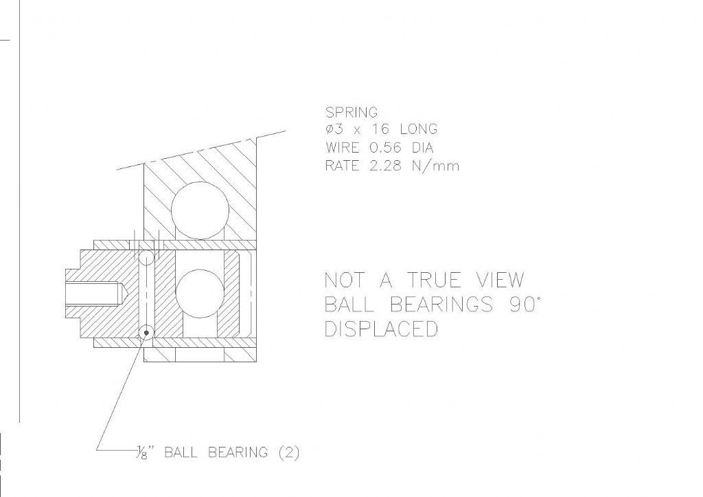

                                  An idea constructors might want to consider for the Myford 7 series selectors is the one I have used on the Emco Maximat Super 11 earlier this year.
                                  This does away with the need to have vee grooves and the possibility of one of the ball bearings coming adrift. The holes for the Engaged positions are slightly smaller than for the Neutral setting. Despite the remote control lever on the Maximat the control is very positive. It is a pity I had not had the benefit of CAD all those years ago.

                                    That is a neat solution which at the same time separates the operational indents from the neutral and allows more space in cramped surroundings.

                                            Thanks for the kind comments regarding the selector detents, wish I had thought of it earlier.

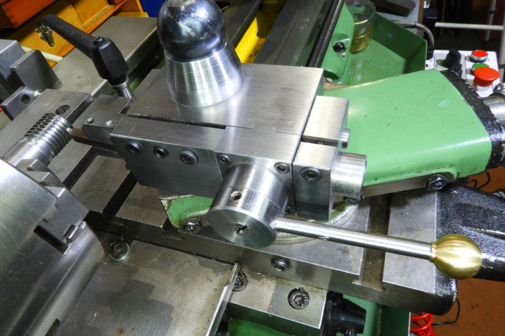

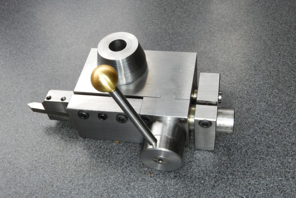

                                                I thought that you may be interested to see my retractable toolpost to your design (more or less).
                                                It bolts straight down to my topslide as I thought that this would be more rigid than mounting in another toolpost.
                                                Now back to viewing the videos of your clutch in action!
                                                The photo on the ML7 is a mock up, but the metric thread was done on the Super 7.

                                                  That is a smart looking job, congratulations

                                                    Your interpretation of my design is very good. Am I right in thinking you have scaled up the original design a little?

                                                      Regarding the size, it is exactly as yours except that the body is 54mm wide – sawn from a rough cast? steel elevator counter weight from a domestic lift. The raised tower was added so that it just fit straight on to the toolpost of the top slide and the normal ball handle that I use on my toolpost swung to a suitable position to be out of the way. I adjusted the height of this "tower" by trial and error to get that right and then fixed it to the retractable toolpost with epoxy resin. I do cheat on many occasions.
