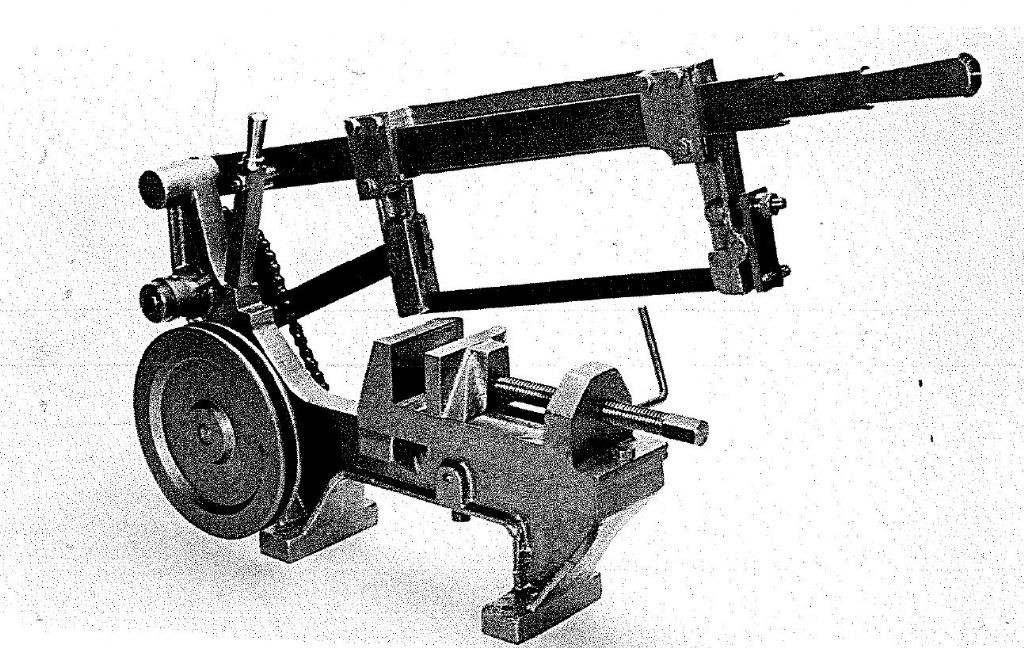

              Fowlers Fury
                @fowlersfury
                " no one seems to do powered hacksaws now – that I can find anyway. "
                Perhaps not strictly true?
                Like "Plasma", I favour a powered hacksaw.
                Blackgates offer a machined kit but you will need a motor & a few other bits. I've had mine for years and since it takes standard hacksaw blades, it's quick & easy to change them over when cutting different materials. The capacity isn't huge but it'll cut through 1.5" bar stock if pressed.
