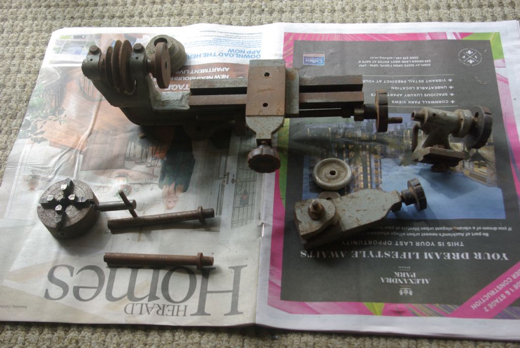

                                        Hi All,
                                        The cabinet with the TNC lathe in it has just emerged from behind a stack of wood, so I have taken the opportunity to photograph it. As you can see it is in kitset form, but the major parts seem to be there. Someone seems to have made a couple of extra long spindles for it too. I don't have any centres for it, and the gibb strip for the saddle is missing, but that would not hold me up for long if I actually needed to make it work. But what would it do that my Unimat 3 would not do better I wonder? Maybe clean it up a little, and use it for decoration somewhere on the wall.
                                        #258801
                                          John's photo, just like a Super Adept, note spare spindles, two topslides and an original chuck key, by the look of it!

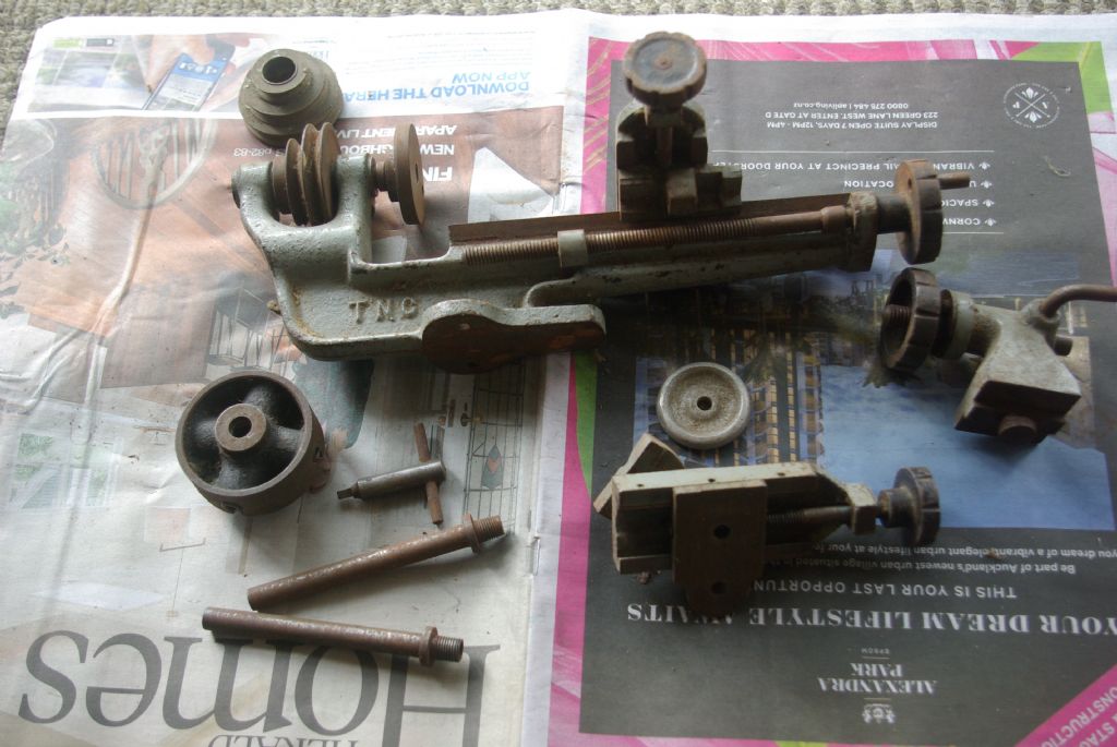

                                            Sorry, I loaded them to my album and then forgot to link to them. Here is the other pic, with things turned over a bit.. There is only one top slide, but there are plenty of spare spindles for some reason. The two spares are longer, so maybe someone had ambitions? I'm not sure what the alloy wheel is for, but it was with the bits.
