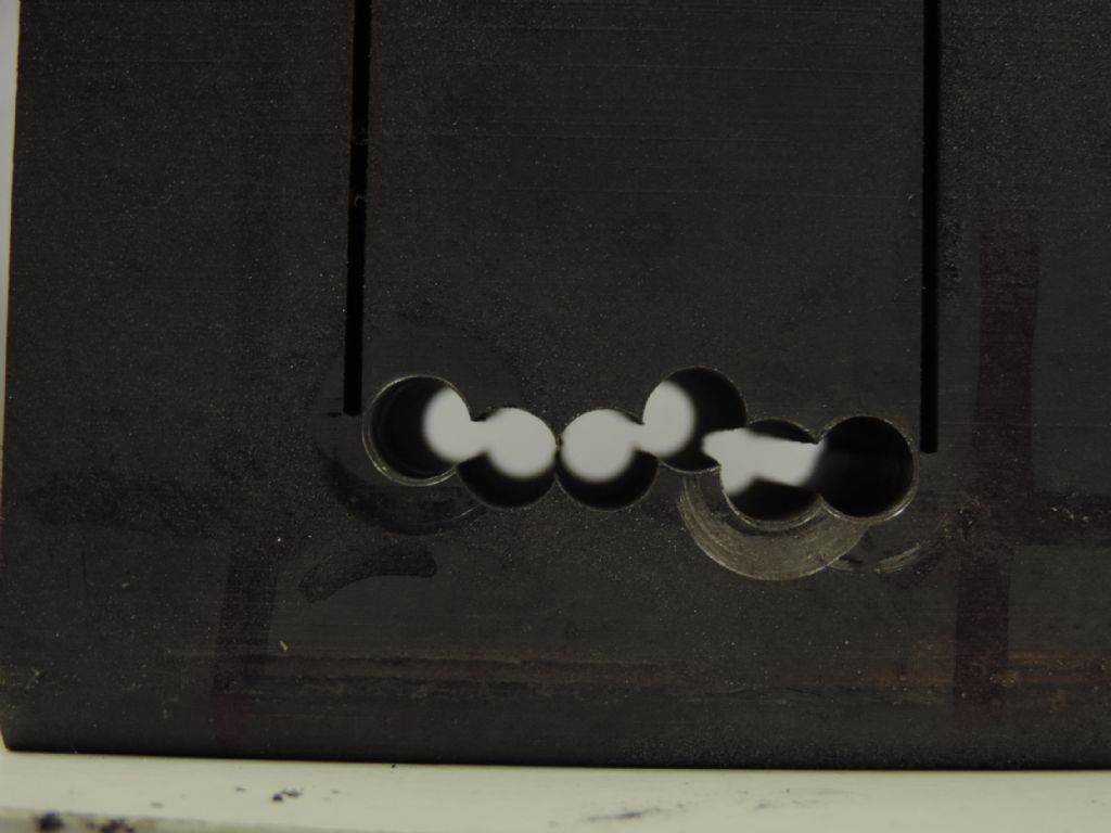

      A little while ago I started chewing away at a block of continuous cast iron for the headstock. It started at about 4lbs, the bed casting is about 2lb 10 oz. So.. there's obviously plenty of waste in there worth saving. I took a large chunk out by a combination of power hacksaw (see above) and chain drilling.
      The chain drilling with the 2 1/2" depth of hole was challenging. I used a very nice Brooke split point 6mm drill in two stages, the second bit with the drill pulled right out of the chuck, and the table raised so the drill started well into the hole.
      Now my pillar drill is a fifteen year-old bottom-of-the range Clark 5-speed drill. How would it cope with such deep and overlapping holes. How accurately would they come out and would it be a disaster? Well as the swarf flowed freely and the drill bit was good, it had the best chance to show it's metal. Bit didn't catch and the holes didn't wander significantly – this pic shows how accurately the holes went in. Not far off straight, bearing in mind it was over 2 1/2" depth. Yes the score marks show how close I was to the depth limit!

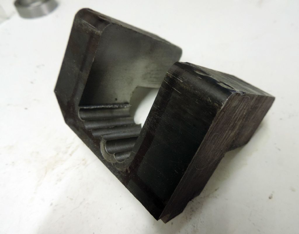

      #169138
        Here we go, the tale of a new headstock, about a two day's power and hand hacksawing, drilling, reaming, boring, milling, more milling and filing… remains to be fettled with the dremel, but the critical faces are all flat, the bores are parallel (spindle bore bored on lathe, backgear holes reamed at same setting) and they are also (hopefully!) parallel to the tenon on the bottom in both planes… although I can correct for errors when making the matching tenon on the old bed. There will need to be fettling and filling to disguise the join, and one joining screw will have to be down a hole crossing the front bush's bore – I will plug it with a mount for an oiler.
        4 lbs of iron:
        1lb 14oz of iron
        12 oz of iron:

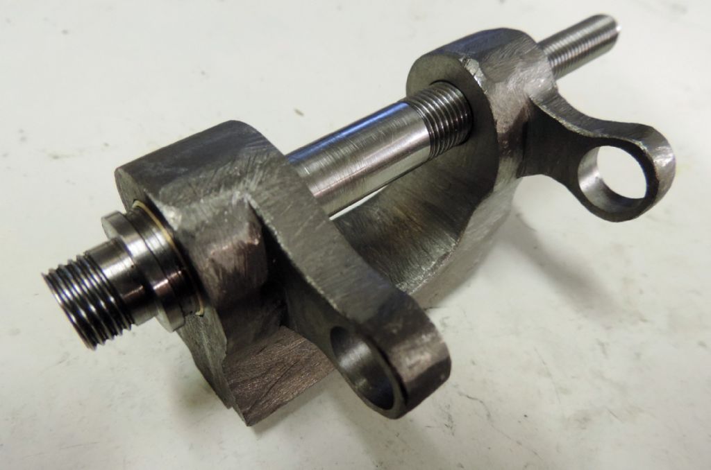

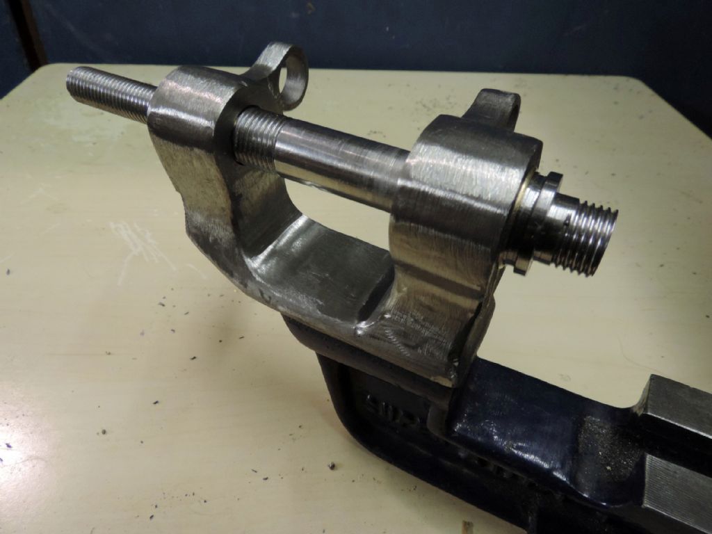

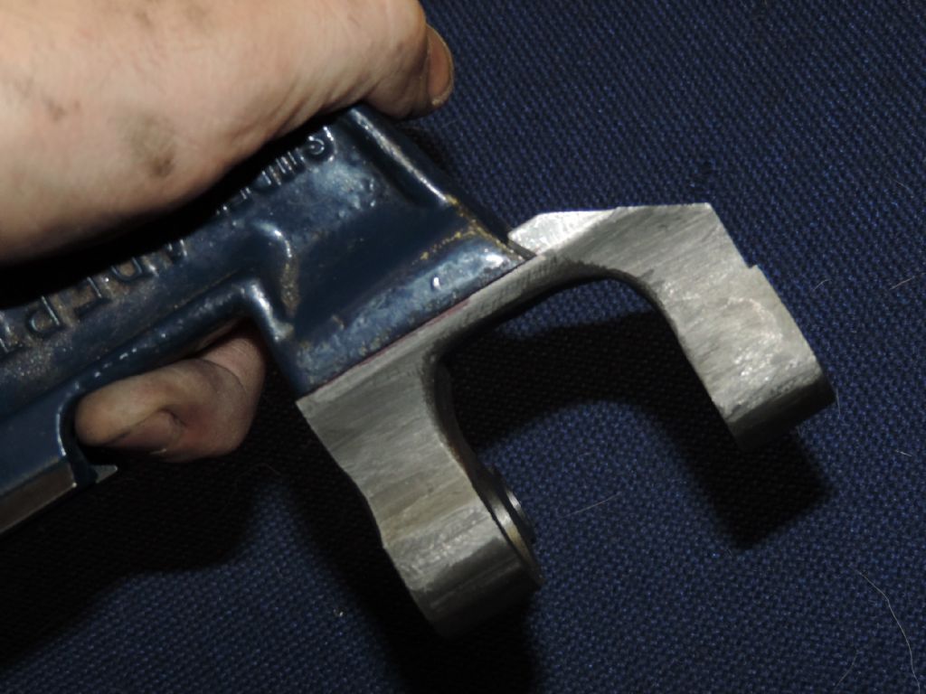

                                #169325
                                  Hacksawing that headstock off by hand took several sessions!
                                  But it took a lot less effort to set up this time! I did my trick of sighting across the edge of the bed to the edge of the mill table. Incredibly, the DTI showed it was dead parallel, I had to check three times to make sure! Five clamps/stops so hopefully it stayed dead solid. The iron machined better than I expected, although the screw on my DRO coming loose gave me a small heart attack – it suddenly acquired 20 thou of backlash!
                                  Anyway, the result appears to be a good fit, its alight push in and hangs in place upside down, which I take as a good sign:
                                  Next stage, was to get out the files and teh dremel and start blending in:
                                  Not obvious at that angle, but there's an ugly 'notch' between the back of the old headstock and the new one, which I will fair in with JB weld or similar epoxy putty.
                                  Next task, fixing screws…

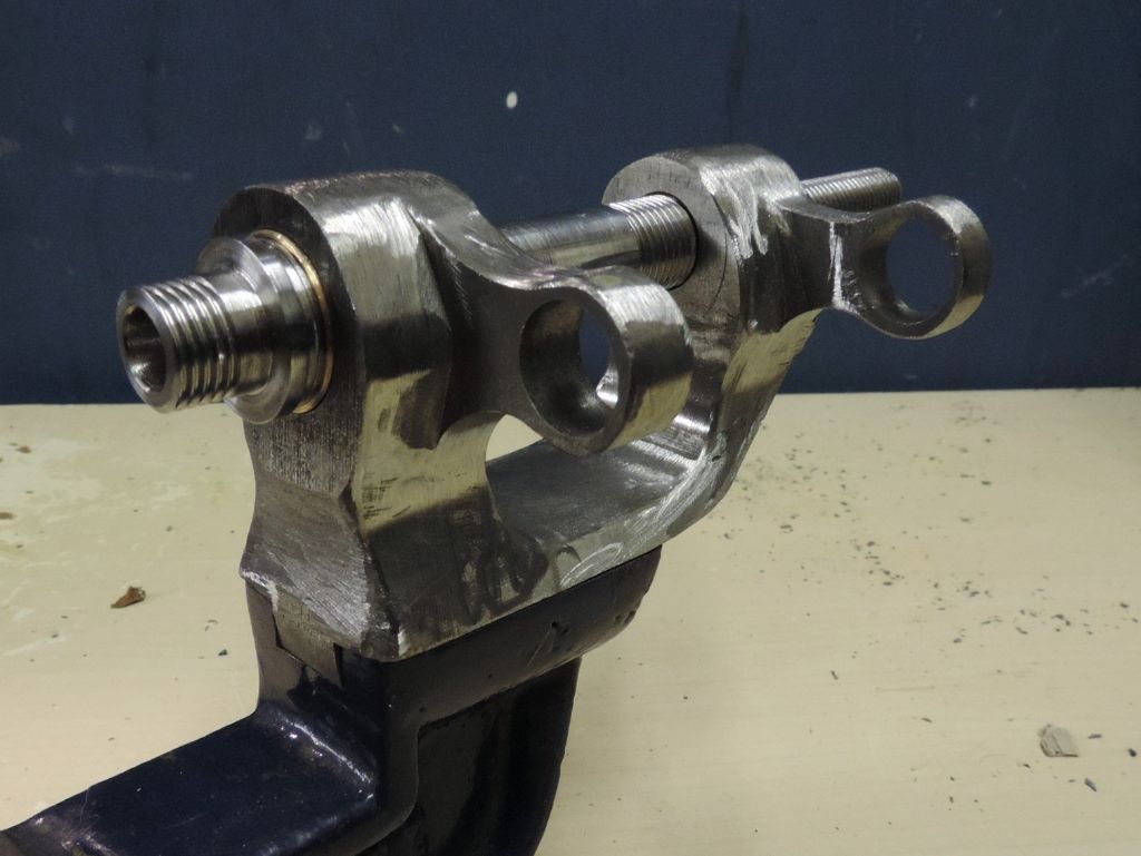

                                            #169412
                                              Headstock now firmly attached with two M5 bolts and metal-filled epoxy. Cosmetic fairing in is under way, using epoxy putty – can't praise the dremel Micro enough, using it with the sanding drum.
                                              I have a 10mm hole down through the front bearing for the front fixing screw. Annoyingly, this is too big to tap 3/8" x 32tpi, and making it M12 seems OTT… I think I'll press in a brass plug and tap it for an oiler.
                                              Now, has anyone got any advice regarding the size of oil hole I should use for the (plain) bearings?
