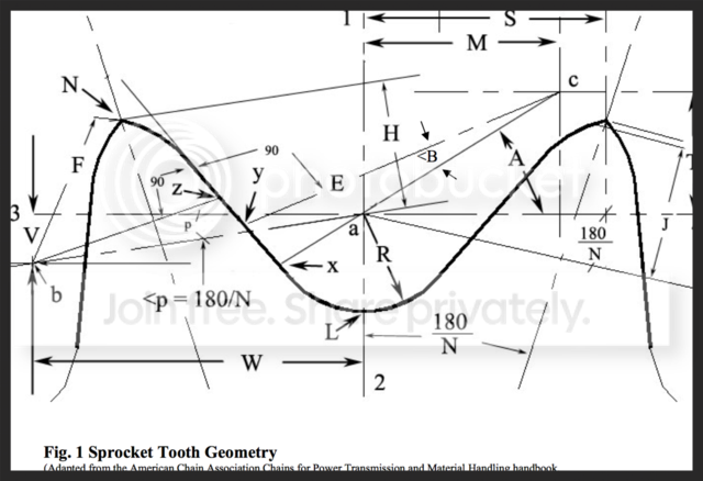

      Then it suddenly occurred to me that chain rollers are round so the tooth cuttout should possibly be a semicircle & do not actually mesh with another gear. So what if I drilled loads of holes of the correct diameter at the correct radius & at the 8mm pitch of the chain then milled the excess metal away
      Would that leave me with a working sprocket?The teeth would need little points on the end where the rollers drop off  for clearance & there must be a way to file/mill those off or just cut the teeth a bit short to reduce the engagement.Or even go round again drilling overlapping  holes with a bigger drill/mill at a wider radius & catch the teeth ends to form the points. Not really correct but would get me to a position where I could touch up with a file

          Your theory would hold good if the chain and sprockets did not move. Unfortunately they do. The chain in a linear then circular path and the sprocket purely  circular. The design of sprocket teeth is about as complex as that for gear teeth. The root of the space between two teeth is as you suggest, a semicircle about equal to the roller diamter, but the tops of the teeth need to be clearanced so they roll smoothly into and out of contact with the chain as it arrives and departs on a linear path,, while the sprocket moves in a circular path.
          See details here: **LINK**
          That said, for your low-power, low rev application, you could probably make a suitable cutter using close-enough dimensions, eg bottom radius, angled straight sides and pointed tops. An alternative might be to look at using a standard size chain from a small motorbike or mini bike and readily avialable and cheap sprockets. Or bicycle chain and sprockets, available at any tip recycle shop by the bootload for a few pence a piece.  Is there a need to re-invent the chainwheel?

                                      Ah well, if you have a mill and a dividing head, you should be able to use an end mill cutter that is 2 X R in the drawing posted above and traverse it in a straight line to cut one side of each tooth. Then flip the sprocket over and use the same setting and traverse to cut the other side of the teeth. Then all you ahve to do is put the little point on top of each tooth, which could be filed at a pinch, or cut with the same end mill cutter with the sprocket set at the appropriate angle, again flipping the sprcket over to use the same set up to do the other side of the teeth.
