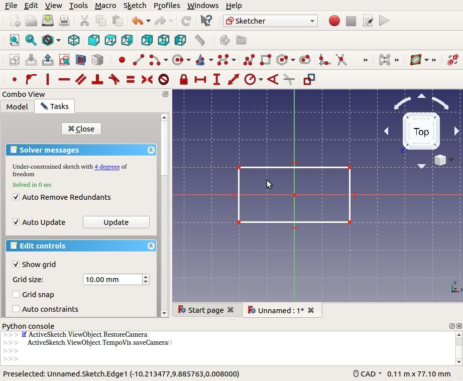

              #415398
                Part 8

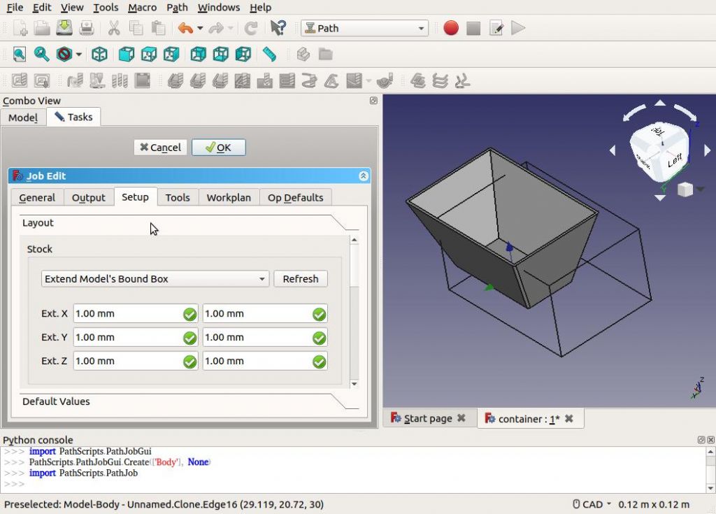

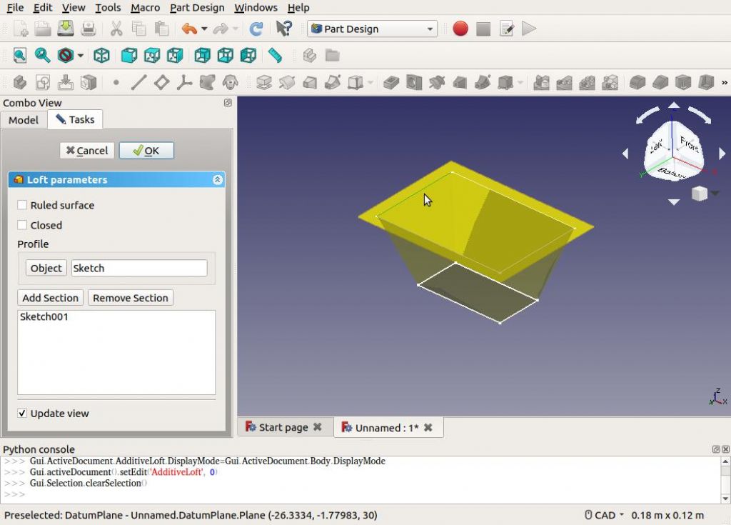

                Many simple parts can be 3D modelled with only the Pad, Pocket and Revolve tools. For that reason it’s worth practising with them several times. Early on keep it simple, pick simple shapes, and don’t be discouraged when you hit brick-walls. They may be because imagination has failed, more likely another modelling tools is needed. Understanding which CAD tool to use is part of the learning process, akin to knowing when to use drills, 2-flute cutters, 4-flute cutters, or fly-cutters in a milling machine.
                As the world is complicated, so are the 3D tools needed to model real-world objects. Faced with a new 3D-CAD package, the sheer number of options available is intimidating. Don’t panic: it might take time to crack the code, but the more you explore the easier it gets. You don’t need to learn everything; chances are hobby metal workers are making relatively straightforward shapes, not designing the sweeping plastic curves added to beautify vacuum cleaners!
                This example shape is used for everything from ice-cream containers to wheelie bins. It needs a new tool.

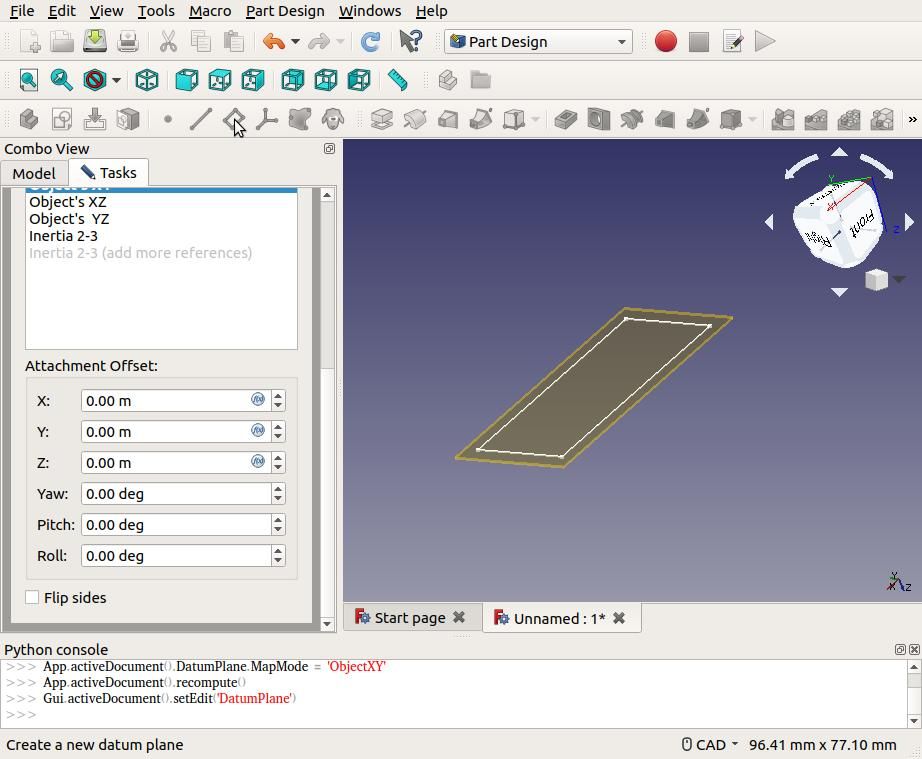

                ‘Lofting’ is the CAD process of generating shapes in the gap between two sketches. Be warned, loft is somewhat fiddly in FreeCAD. If something doesn’t work, go back and try again. One cause of bother is that given a few possibilities, the software may not select what the user intended. Sometimes helps to rotate, zoom-in or hide features to make sure the correct object, face or edge is selected.

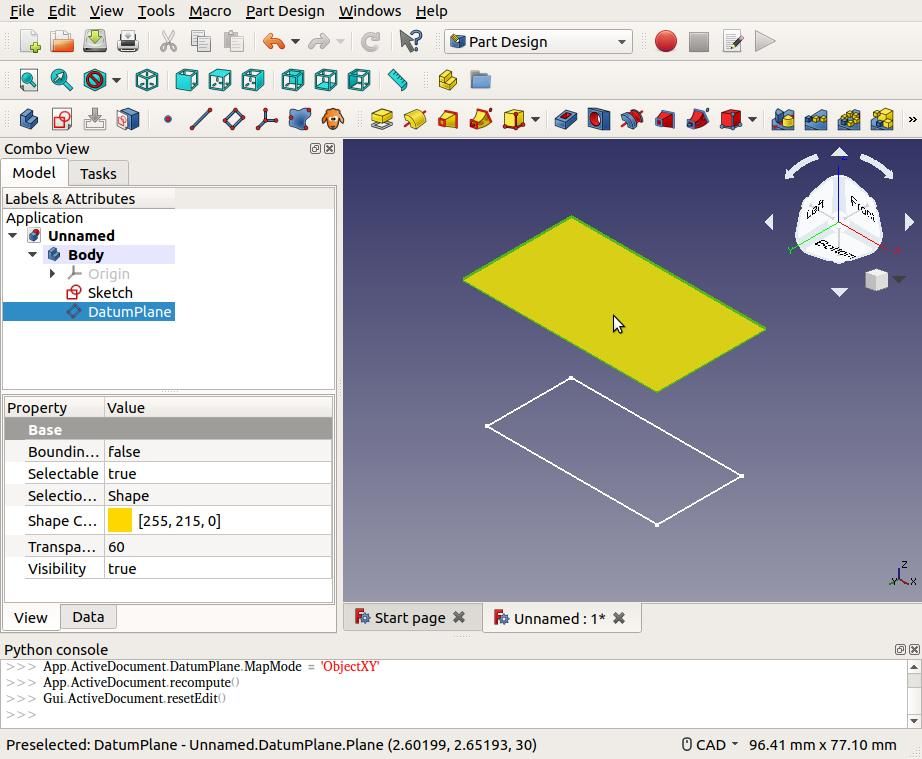

                First open the sketcher and draw a rectangle representing the container’s base. (In the example I’m not bothering to constrain the sketch as would be necessary to model a real container.)
                Close the sketch and click the ‘Create a New Datum Plane’ button.

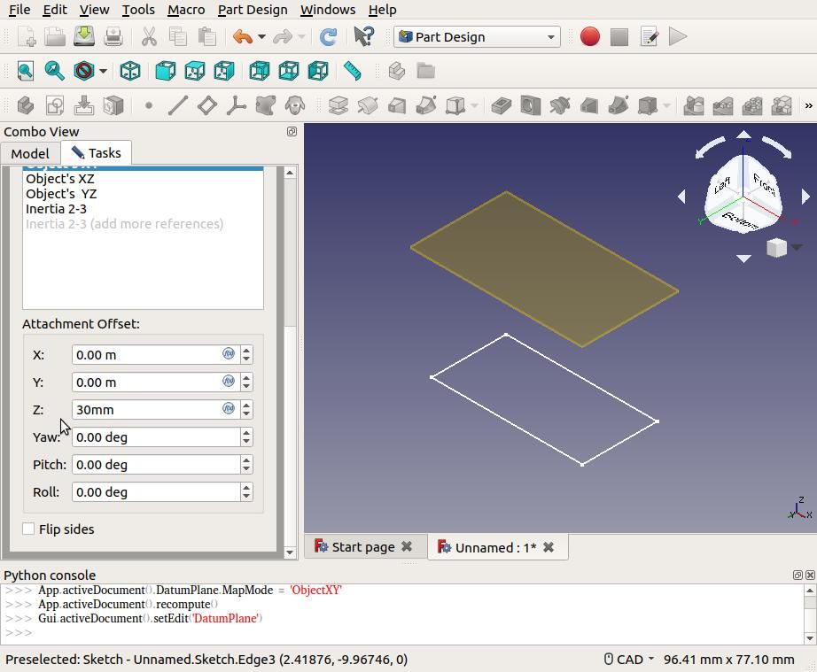

                Now lift the new plane 30mm above the existing sketch by typing 30mm into the Z Attachment Offset. (Watch out! Offsets default to metres. If annoying, before starting a new project have a look at Edit→Preferences→Units. Default setting is MKS: you might well prefer ‘Imperial Decimal’ or ‘Metric Small Parts & CNC’, aka mm)
                Close the Datum tool by clicking on the OK button at the top, then click on the new datum plane to select it.

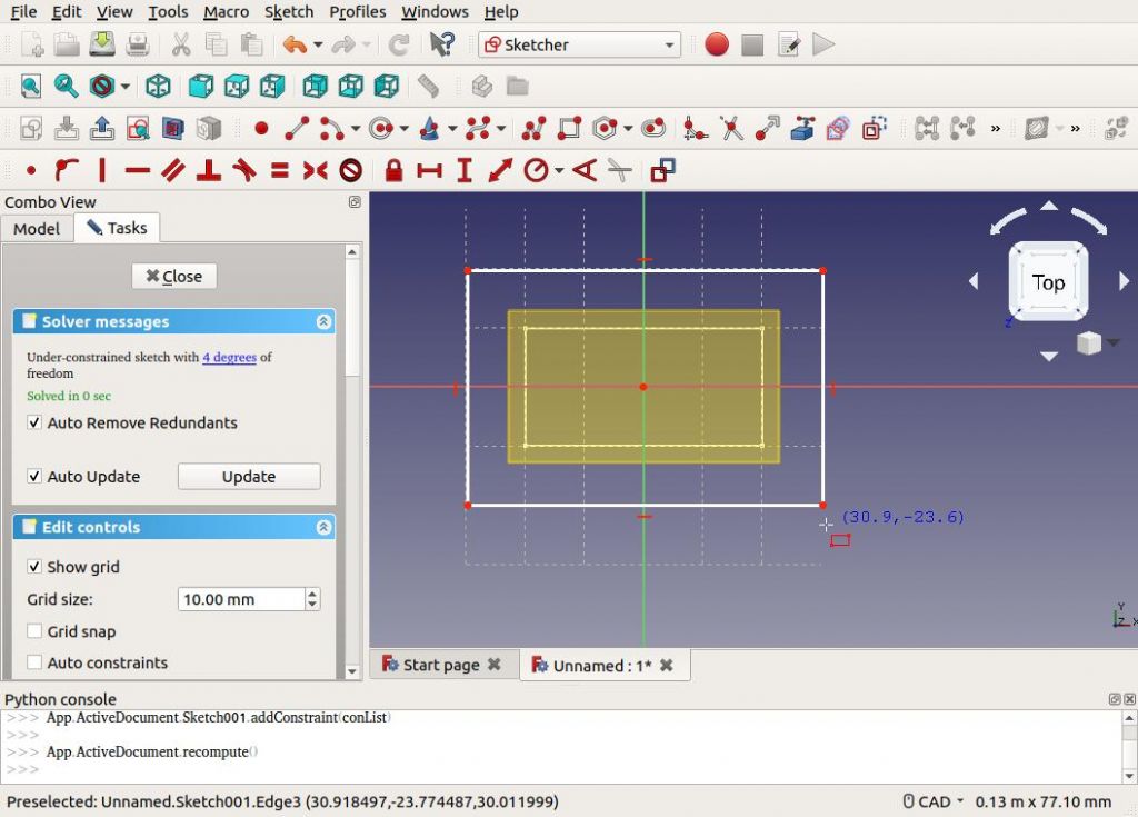

                Create a sketch on the new plane. The earlier sketch can be seen underneath. Draw a larger rectangle to represent the top of the container.
                Close the sketch, revealing the model now has two sketches.

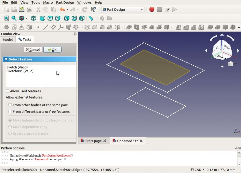

                Click on the ‘Loft a selected profile through other profile sections’ button. Select one of the two sketches. I chose the base.
                The next dialog requires a ‘Section’ to be added. In this example, it is any of the top four edges of the container. Clicking one edge highlights the loft. (Note a loft can follow more than one sketch at different levels, each defining a section of a complex shape.)
                Clicking the OK button generates the solid.

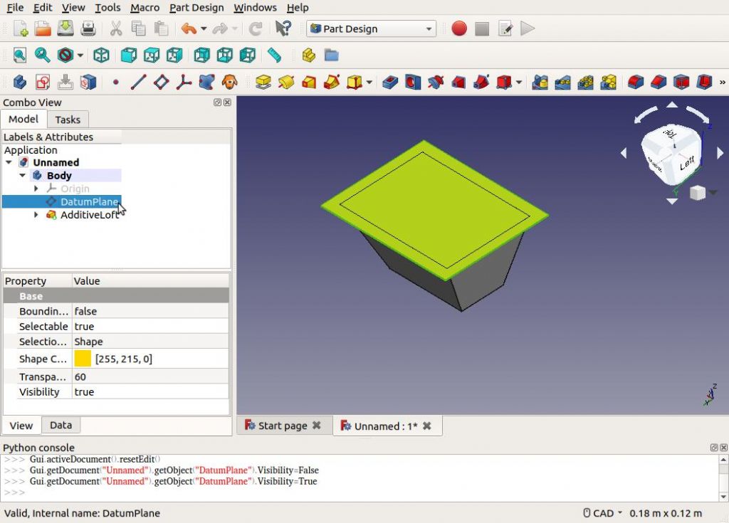

                #415399
                  Part 8B

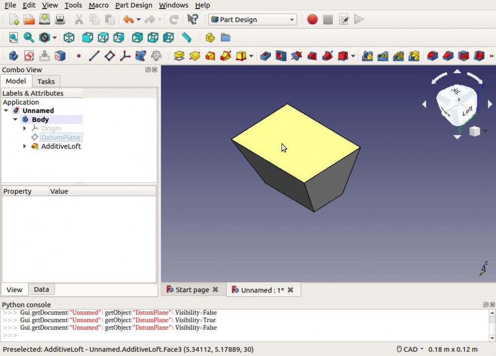

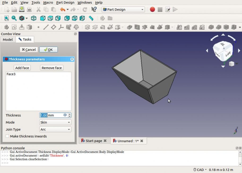

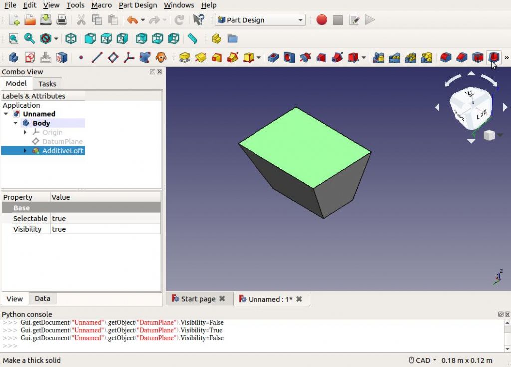

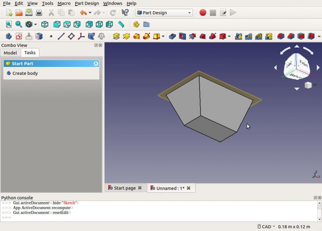

                  A solid ingot isn’t quite a container yet! To convert it, first hide the datum plane. This is needed because we have to select the top surface of the ingot for the next operation. Hide the plane by selecting it in Model list and tapping the Space Bar.
                  With the datum plane hidden, select the upper surface of the ingot
                  Click the ‘Make a thick solid’ tool. (Top right under pointer in next picture.)

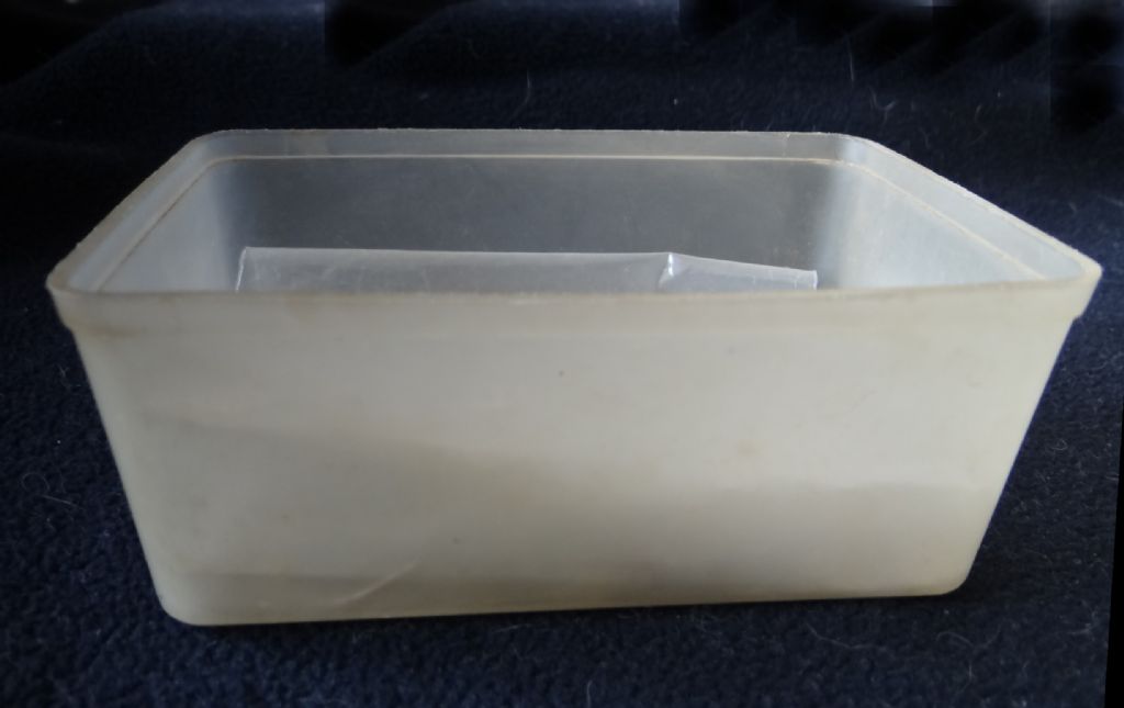

                  Whilst an object shaped like an ice-cream container might be made of sheet metal or even milled from solid, more likely the ‘Make a thick solid’ tool is of more interest to the 3D printing fraternity. In FreeCAD, the ‘Path’ workbench is used to generate the necessary G-Code. It comes with buttons for selecting tools, simulating cutting paths, facing, drilling and various other operations. I’ve never used it! The CAM process begins with this ‘Job Edit’ dialogue.

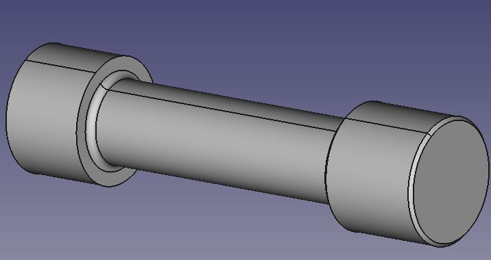

                    It's great to see a champion of Free software, isn't it? Is part of the enthusiasm for other packages expressed by others a reflection of the amount of money they have forked out? However, I digress…
                    I've pm'd SOD about this, but don't want him to feel he has to waste time finding the answer. Far better that his excellent tutorial continues.

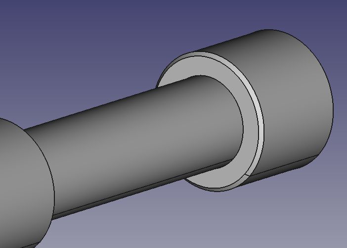

                    Here's the problem. When I applied a chamfer to the annular surface at either of the junctions of the two different diameters of the shank of the chuck key model, FreeCAD produced the expected 'external' chamfer, but also an internal 'fillet' (as would be produced by a V-shaped turning tool). I haven't found a way to restrict chamfers (or what FreeCAD calls 'fillets', but what I call 'corner-rounding&#39 to external edges only. Anyone any ideas – without getting deep into python?
                    #415737

                      Posted by Kiwi Bloke 1 on 23/06/2019 12:41:01:
                      Here's the problem. When I applied a chamfer to the annular surface at either of the junctions of the two different diameters of the shank of the chuck key model, FreeCAD produced the expected 'external' chamfer, but also an internal 'fillet' (as would be produced by a V-shaped turning tool). I haven't found a way to restrict chamfers (or what FreeCAD calls 'fillets', but what I call 'corner-rounding' to external edges only. Anyone any ideas – without getting deep into python?
                      That is a bit strange, I just tried to make an external chamfer, and got no fillet (I also chamfered the free end):
                      On the other end I tried to just make the fillet, and got no chamfer:
                      I don't know what happened, are you sure you clicked on the circle line, not a surface. If I click on the ringshaped surface and chamfer I also get a fillet.

                        I thought I'd replied, but my post seems to have got lost.
                        Problem solved!
                        Thanks Thor, you've got it! Clearly FreeCAD is smarter than this operator. I hadn't realised that the chamfer tool produces different results, exactly as you describe, depending on whether a surface or edge (line) is selected. I had indeed selected a surface to be chamfered, so FreeCAD obligingly found every edge and did its thing.

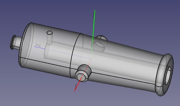

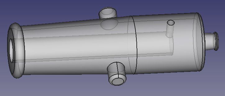

                                  I kind of managed to model Dave's cannon:
                                  I left Transparency at approximately 30% to reveal some of the internals.

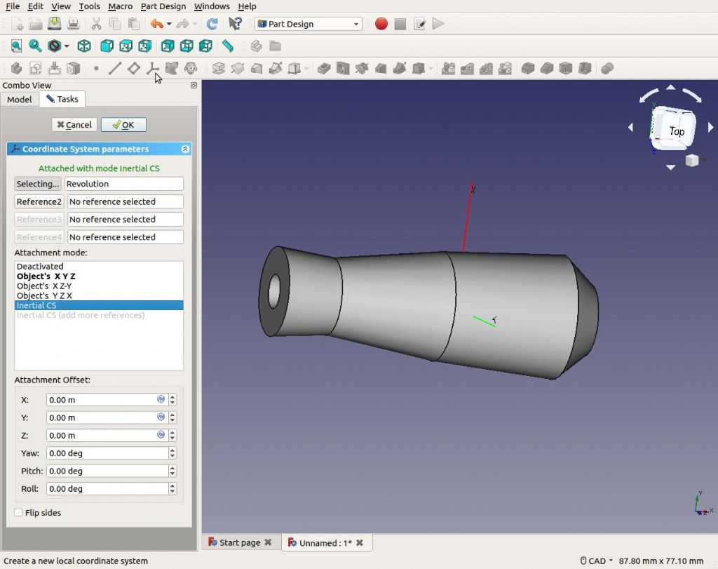

                                    Very good Thor, much better than mine. Here's something to try. Because the cannon is modelled as a solid, FreeCAD knows where the Centre of Gravity is. In a real cannon the trunnions should be positioned a little forward of the centre of mass such that the gun is balanced slightly base heavy. Makes it easier to adjust elevation with a wedge or screw.
                                    Here's how to find out in FreeCAD by adding a local coordinate system.
                                    Select the whole cannon then click on the 'Create a new local coordinate system' button (under mouse pointer above). Then choose 'Inertial CS' as the attachment mode. In my example the Red X and Green Y lines can be seen marking the balance point.
                                    Try it on your cannon to see how well your trunnions are placed! Quite often if it looks right it is right.

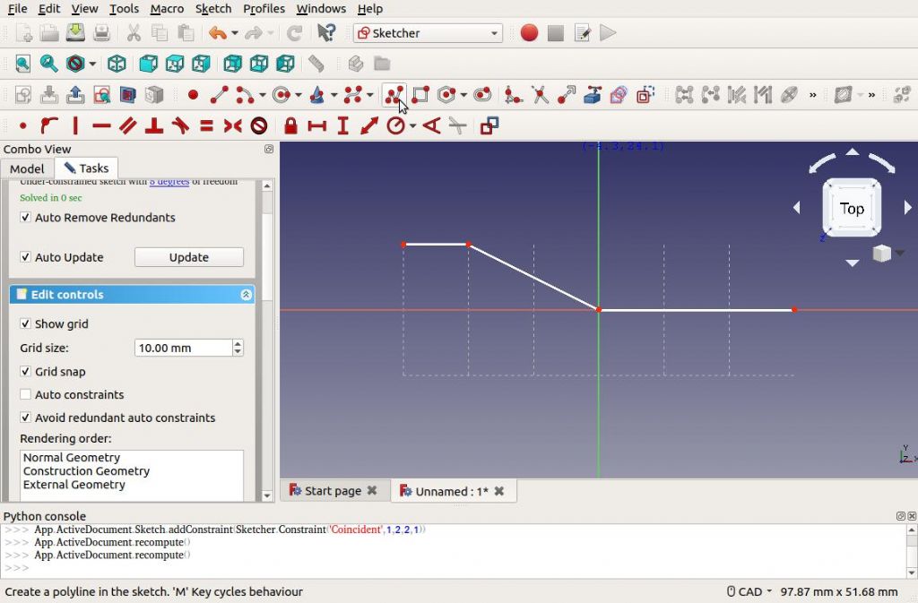

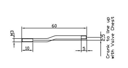

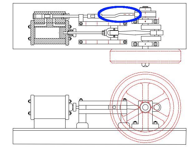

                                      So far parts have been modelled by ‘Pad’, ‘Pocket’, and ‘Loft’. This example is new – a solid made by sweeping a sketch along a path. The example is from Stewart Hart’s PottyMill Horizontal engine – I’m a fan!
                                      Almost all parts in Stewart’s engine can be modelled with ‘Pad’ and ‘Pocket’ alone, plus a few chamfers and fillets. I’ll stick my neck out and say there’s are only two parts needing another treatment, most difficult being the rod connecting the eccentric to the valve. It is cranked to fit – highlighted in blue below:
                                      And Stewart’s detail drawing provides dimensions:

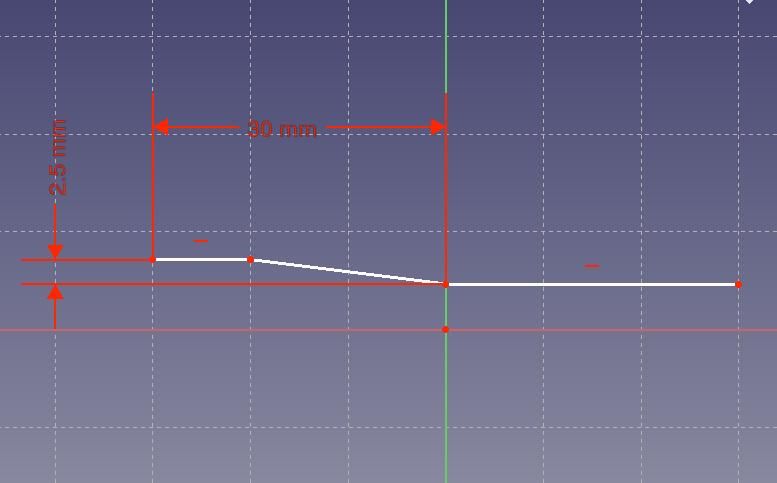

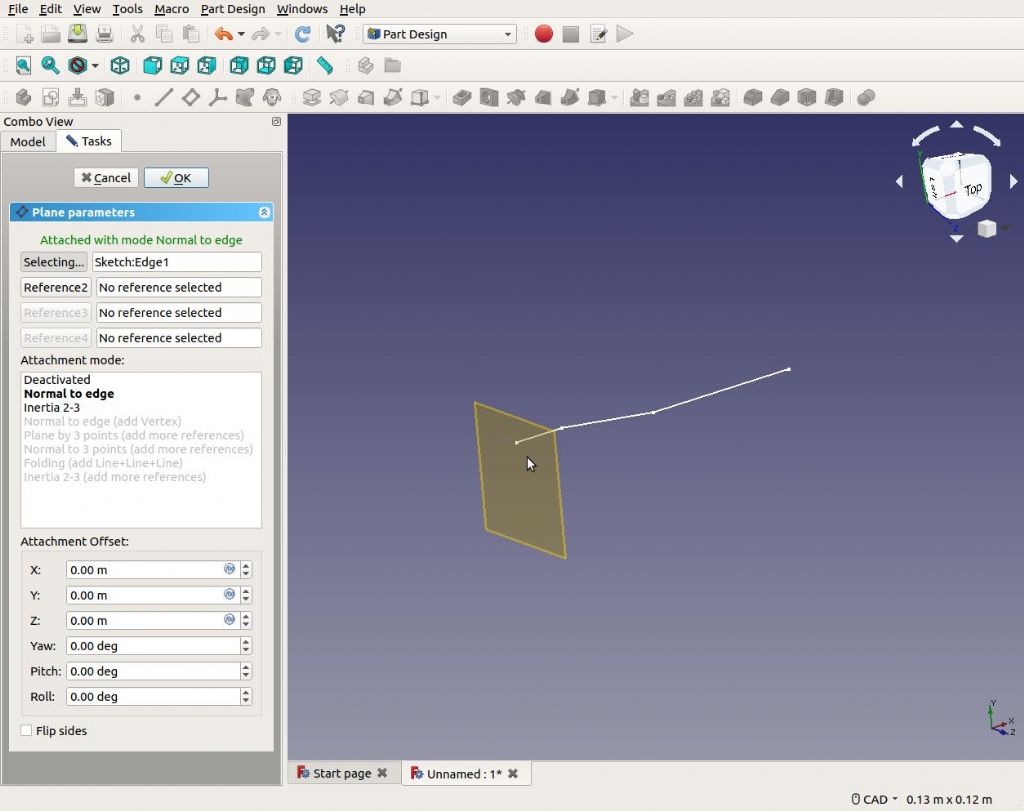

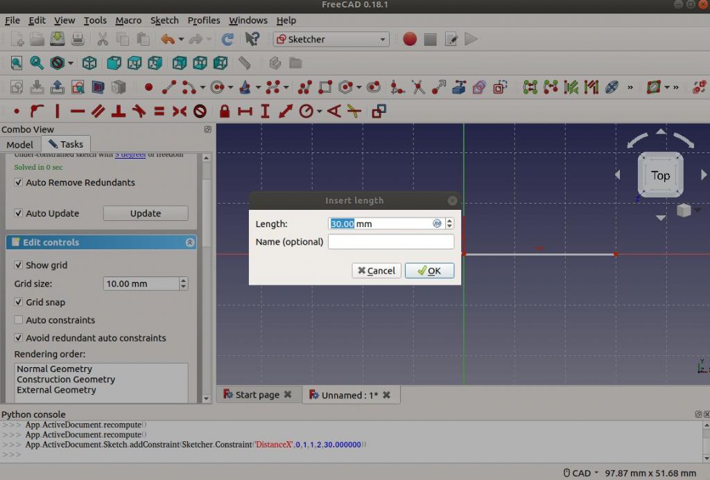

                                      To model this, start FreeCAD as usual and open the Sketcher. As the item is 60mm long it’s convenient to turn on Grid Snap with a 10mm grid. Using the ‘Create Polyline in the sketch button’ draw a skewed horizontal line as shown, 10mm straight then diagonally down to another 30mm straight. (Remember the description of a button will be displayed if the mouse pointer hovers over it for a second or two.)
                                      Before attempting to constrain the line, turn off Grid Snap. (Much confusion caused in CAD when software snaps to the wrong object, or locks something in place. Keep an eye on what snaps and constraints are on and off!)
                                      Constrain the two horizontal lines to be horizontal with the ‘Create a Horizontal Constraint on the Selected Item’ button.
                                      Select the two red dots on the left-hand side of the horizontal lines and click the ‘Fix the horizontal distance between two points or or line ends’ button; in the Insert Length dialogue, set Length = 30mm and press OK.
                                      Re-select the same red dots and click the ‘Fix the vertical distance between two points or or line ends’ button; in the Insert Length dialogue, set Length = 2.5mm and press OK.
                                      Note that in the picture I moved the dimensions to make them more readable by clicking and dragging. Double clicking a dimension allows it to be changed.

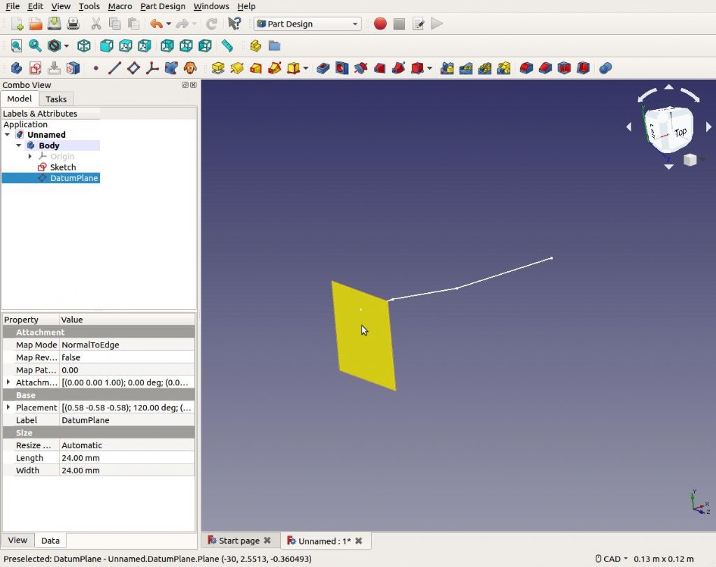

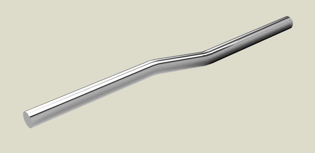

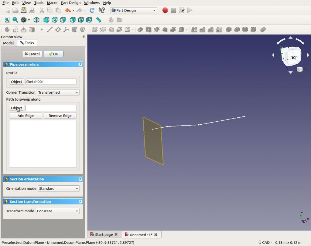

                                      The sketched line defines the length and path of the PottyMill valve crank, but Pad, Pocket and Loft won’t convert it into the wanted solid. This is done by sketching a circle on one end of the path and at right angles to it. It will be swept along the line later to make a ‘pipe’, actually solid.
                                      Close the sketcher and add a datum plane to the line. Experiment with clicking on the line; the angle of the datum plane should change. We want the plane to be at a right angles to the cranked line.

                                        Close the datum plane tool and select the plane by clicking on it

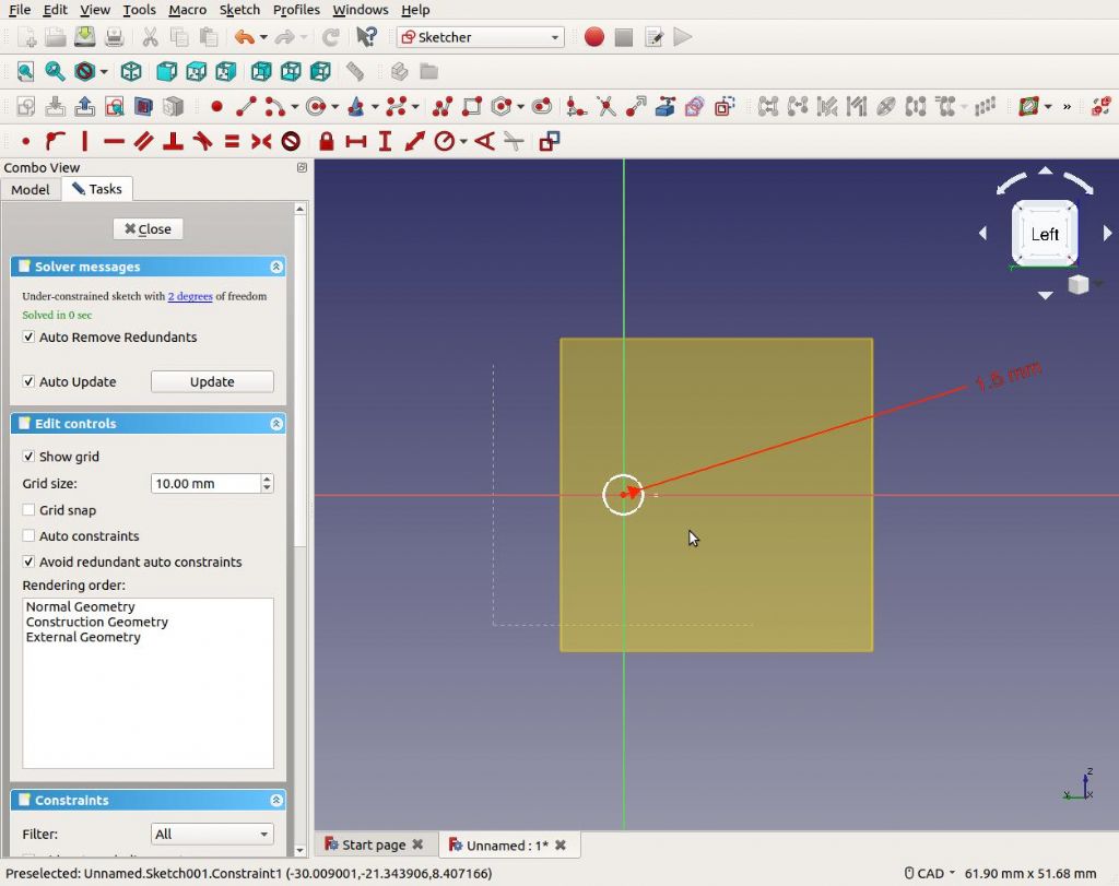

                                        Create a sketch and draw a 3mm diameter circle centred on the end of the path line.

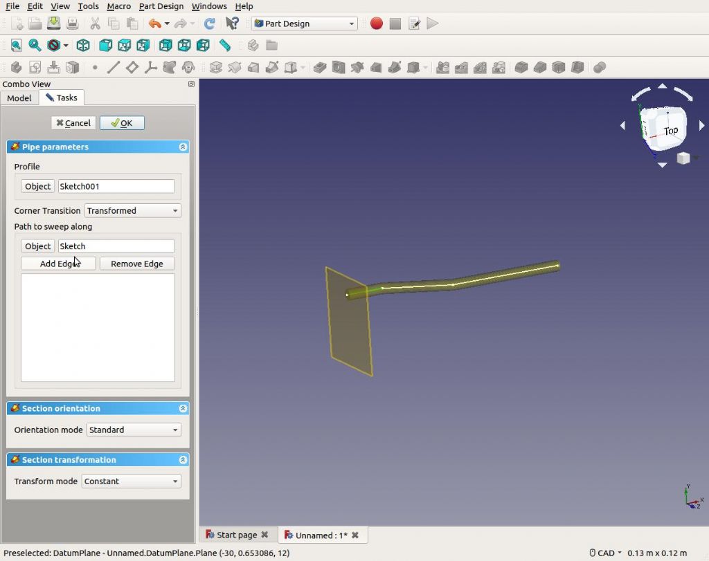

                                        Close the sketcher, click on the the new circle, and click the ‘Sweep a selected sketch along a path or to other profiles’ tool.
                                        A few things to do in the ‘Pipe Parameters’ window. The Profile object is the 3mm diameter circle sketch. Corner Transition defines how bends and corners will be modelled (experiment!). Most important is selecting the Path to sweep along object. Click the ‘Object Button’ and then on the cranked line.
                                        The ‘Add and Remove Edge’ buttons aren’t used in this example, They allow a sketch to be piped along the edges of an object like a cube.
                                        Clicking ‘OK’ generates the solid object.

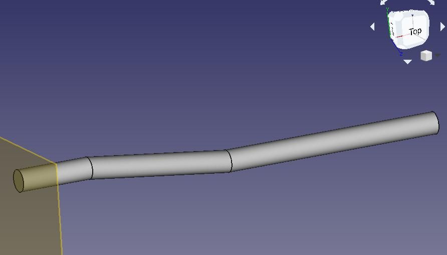

                                            Dave, your path would be better sketched with fillets at the bends so the rod looks bent rather than mitred

                                              Thank you Dave for your kind words and showing how to find the balance point. I guess I was lucky?
                                              I understand that adding a local coordinate system is new in v.0.18.

                                                      Raising an old thread again but for finding the CoG, I've found the CentreofMass and FCinfo macros really useful. Although FCinfo is more finicky.
                                                      Posted by SillyOldDuffer on 24/06/2019 15:26:07:
                                                      Thanks for the info Matt, both new to me! A problem with 3D-CAD is the sheer amount of stuff available and keeping up to date with it.
                                                      My favourites, Fusion360 and FreeCAD are both frequently updated! Not too long ago I confidently announced FreeCAD didn't have an Assembly Workbench only to find there are at least two, neither of which I've had time to try. Lots of Macros available too. Too much to do, so little time. Off to mum's now – she's crashed her phone system!
