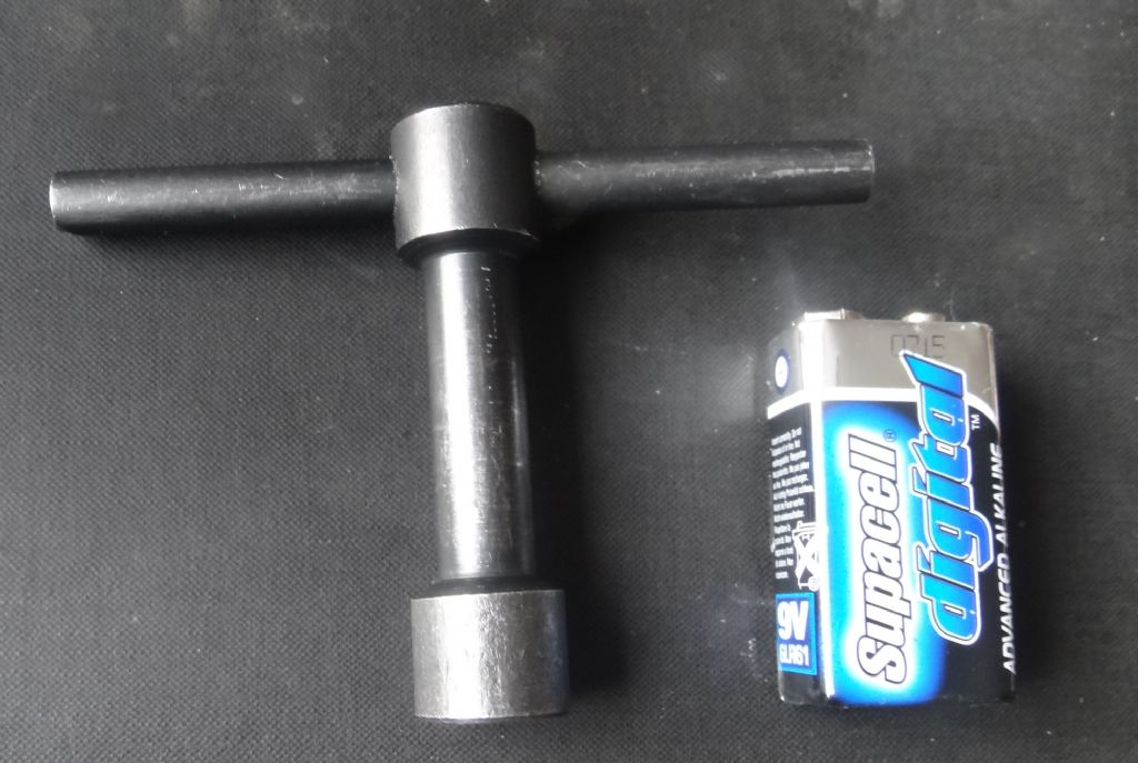

      As getting started with 3D-CAD is a problem I recently outlined how to get FreeCAD into a position where a beginner could start modelling. FreeCAD is of interest because it’s Open-Source free, not because it’s the best possible CAD choice. I find it handy for simple work, and as a safety-net in the event Fusion360 becomes unaffordium. The ‘starter’ piece got some positive feedback and a PM conversation about finding up-to-date FreeCAD Tutorials with Thor inspired me to show what happens once FreeCAD is ready to go. The idea is to get people started by demonstrating how straightforward it can be to 3D model simple objects without plunging into shark-infested depths. I’m not competing with the Alibre thread!

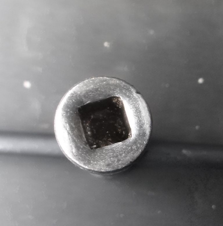

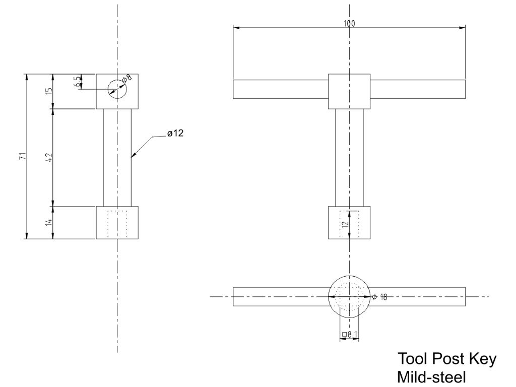

      Here’s the example. It’s the key used on my lathe’s 4-way tool-post.
      For objects this simple, I’d do a ‘back of an envelope’ sketch. A rough drawing capturing the shape and dimensions needed to make the item is good enough. It’s a memory aid rather than a technical drawing. However, sketches like these are a good way to prepare for a 3D CAD model.
      For more complicated objects or drawings other people will work from, I do ‘proper’ technical drawings. These can be done by hand on a drawing board, but I prefer a computer. I use QCAD. With practice it’s faster than rule and pencil, and far neater, especially after multiple mistakes are corrected with a grubby rubber!
      Behind the scenes 2D can be messy! Here's with construction lines:
      Proper technical drawings are skilled work. As an amateur I claim the example above to be a ‘First Angle’ Drawing, but I might be wrong! Also, trained draughtsmen may not be impressed by my treatment of dimensions, line thickness or labelling. Nonetheless, I believe it’s clear enough to be used by someone else to make a tool-post key.
      Two major problems with 2-Dimensional technical drawings. First it’s necessary for the draughtsman to mentally translate a 3D object correctly and unambiguously into groups of 2D views. Secondly it’s necessary for the user to translate the group back into a 3D object. It helps if both understand and follow the same conventions and neither blunders during translation. Mixing up the difference between First Angle and Third Angle can be desperate because the made object could be a mirror image of that intended. Most modern drawings are Third Angle, older European drawings are usually First Angle, and amateur drawings can mix both in the same plan or be neither. Much opportunity for confusion.

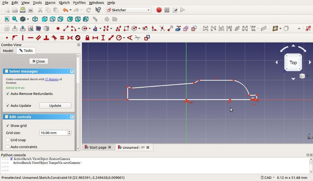

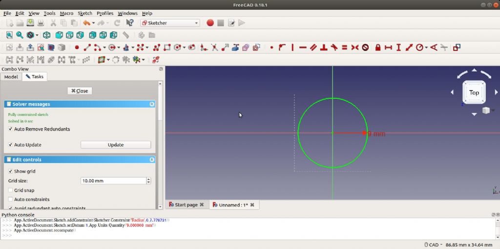

          Start FreeCAD, and follow the earlier instructions to get into the Sketch Editor in the Part Design Workbench. Note that Sketcher Buttons marked with red-dots and white lines are drawing tools, (lines, rectangles & circles etc), while those all in red force constraints, parallel, vertical, distance, diameter, angles tangents etc. Hovering over the buttons should display what they are. Useful tips:
          • the ESC key ends the current action.
          • On the left-side of the FreeCAD window is a ‘Combo View’ Panel. The ‘Model’ tab lists the steps taken to create the model. It can be used to select and edit previous steps, to hide and reveal them, and to alter the stage’s appearance, including transparency. The ‘Tasks’ tab lists the tools that can be used at the moment. Using FreeCAD involves switching between these two lists.

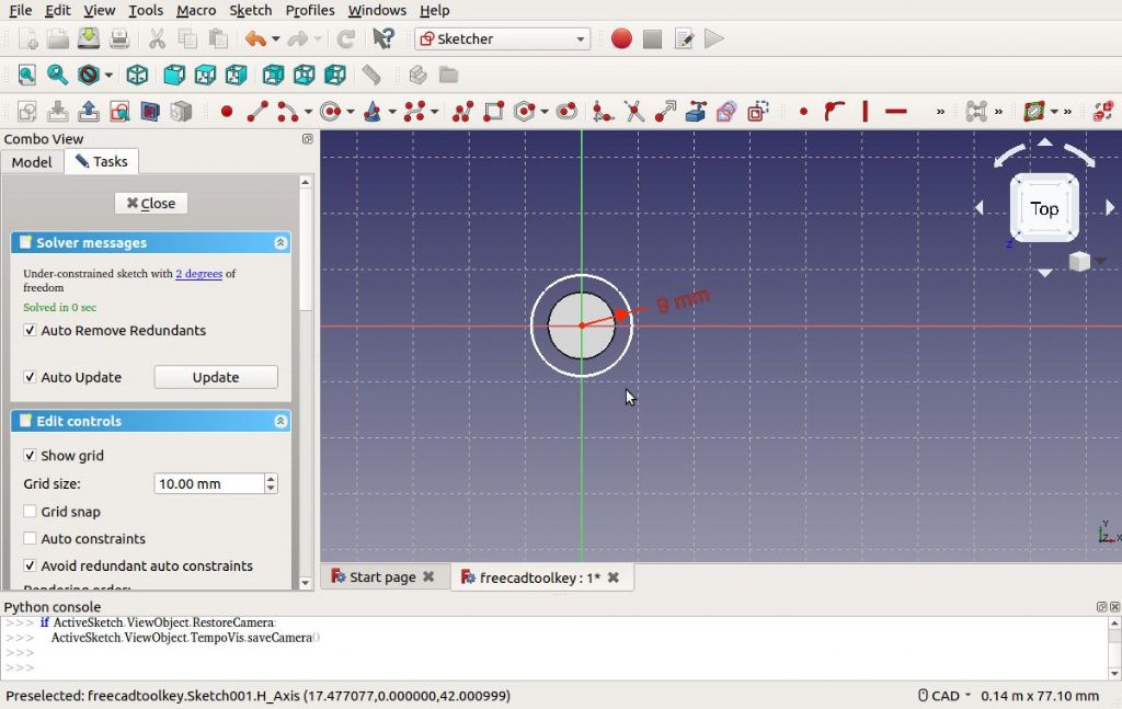

          Using the Circle Radius Tool (which also draws diameters) draw a circle centred near the red dot in the middle of the grid. Don’t worry about the exact size and position; they are ‘constrained’ next.
          Constrain the circle to the centre of the grid by clicking the mouse on the two red dots to select them. Once they are both Green click the button marked with the ‘Create a coincident constraint’ button ( Identified by a small red dot ). The circle should jump into position. It is locked in position.
          Select the circle by clicking on its perimeter. Then click the red ‘Constrain an Arc or Circle Button’ and set the radius to 6mm. Note the circle goes green. This indicates it is ‘Fully constrained’: it’s a circle of fixed diameter locked in position inside 3D space. It’s not floating about. By no means essential for sketches to be ‘Fully Constrained’ but I’ve found keeping things tight minimises trouble later. FreeCAD, like other 3D software can behave very oddly if a user’s model becomes internally inconsistent. Although this can be very difficult at first practice makes perfect – after a while, modelling becomes second nature. It’s important to obey the software package’s rules, it will absolutely not understand what you meant, only exactly what you told it to do.

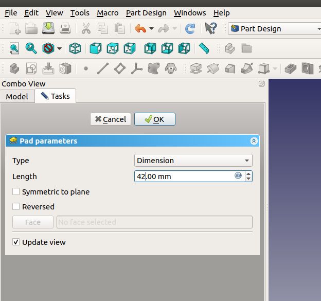

          #414980
            Part 3

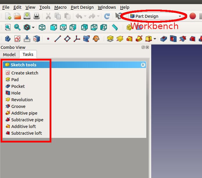

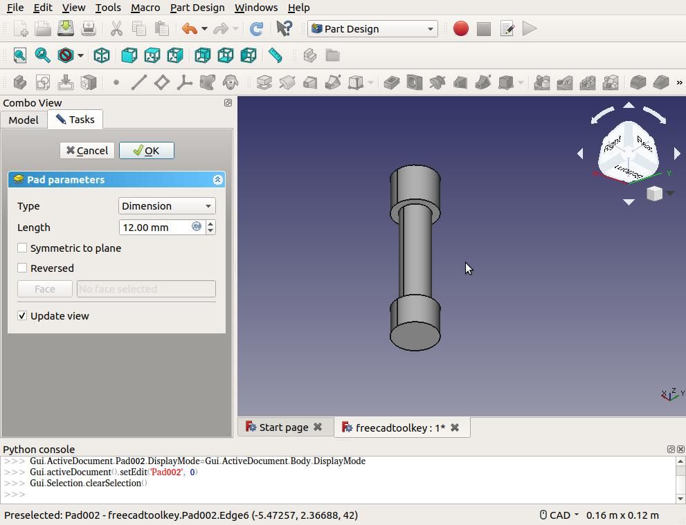

            Now we shall create the middle part of the solid shank by ‘Padding’ the circle. Other CAD packages call this operation ‘Extrude’. Close the sketch editor. In the Tasks Tab in the Combo View should be listed the most common operations likely to be needed next. Keep an eye on the Workbench; much confusion if this quietly changes to one of the others and you don't notice!
            Select ‘Pad’ and type 42mm into the Length box before clicking the ‘OK’ button.
            A cylinder should appear on screen. It can be rotated using the alignment controls. (Mouse controls also available.)

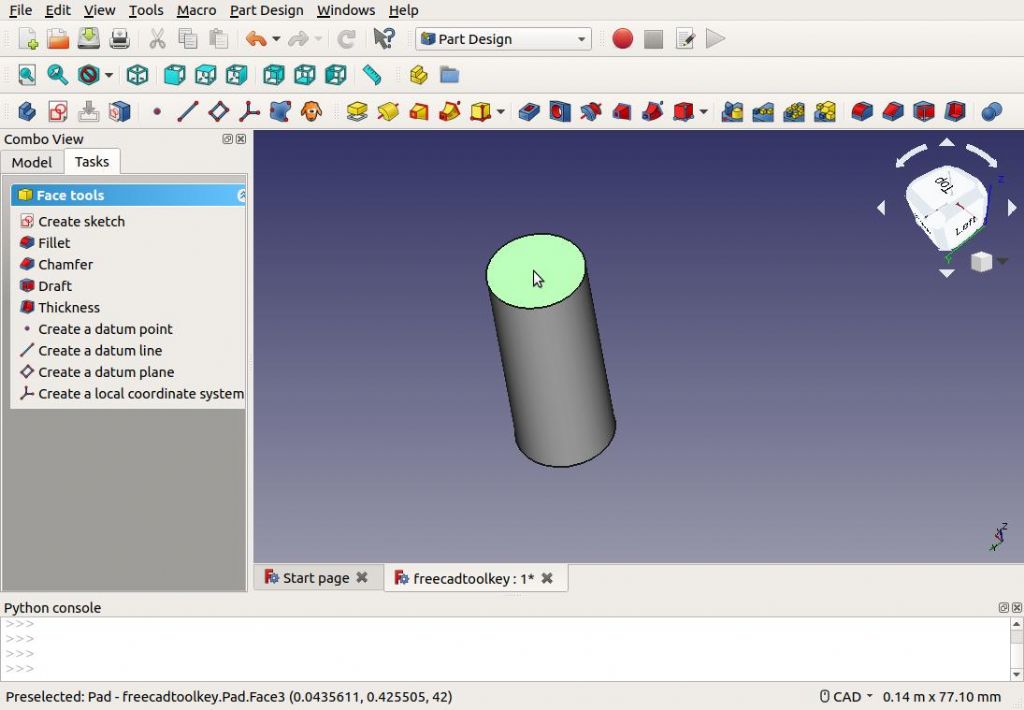

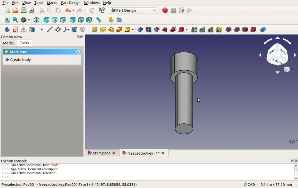

            Next lets add the bottom of the shank. Click on the face at one end the cylinder. It should turn pale green.
            In the Tasks List, click on ‘Create Sketch’. This allows us to draw a sketch on the cylinder’s end-face, that can be ‘Padded’ or ‘Pocketed’ to cut a hole. Draw a circle centred on the face and constrain it’s diameter to 18mm.
            Close the Sketch Task and, as before select the Pad tool. This time dimension the pad to be Length 15mm, producing an new object that, rotated, looks like this:
            Rotate the object and select the other end. Sketch another 18mm diameter circle on it and Pad to Length 12mm to add the base.

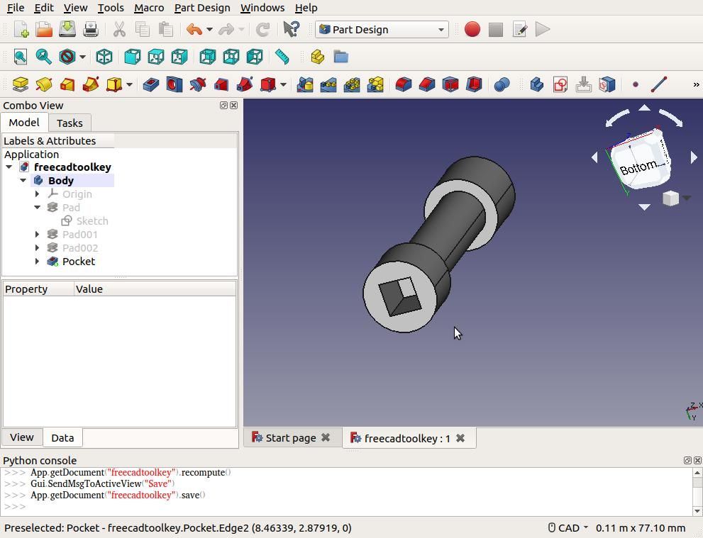

            #414983
              Part 4

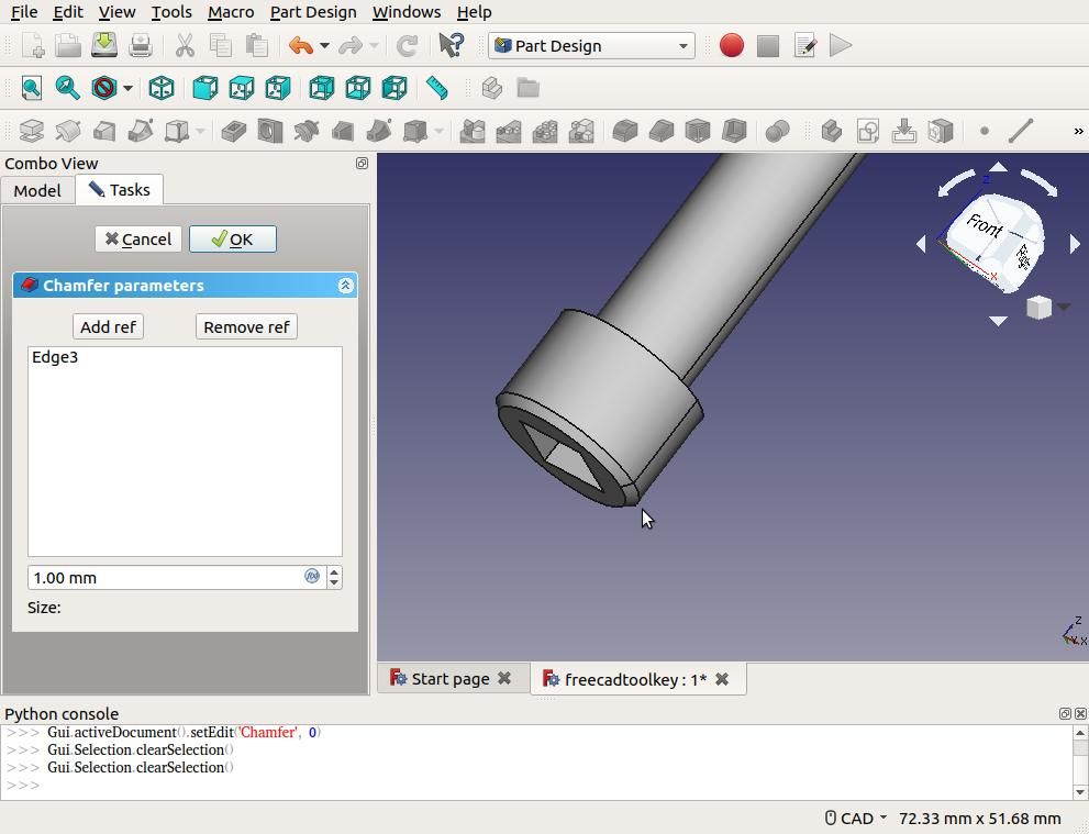

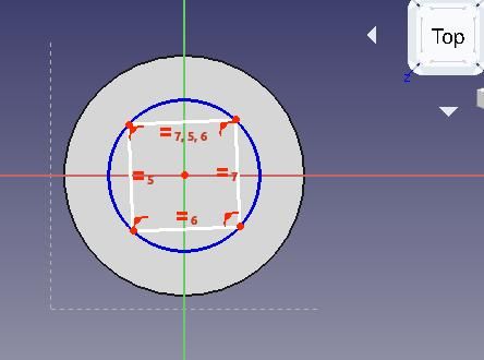

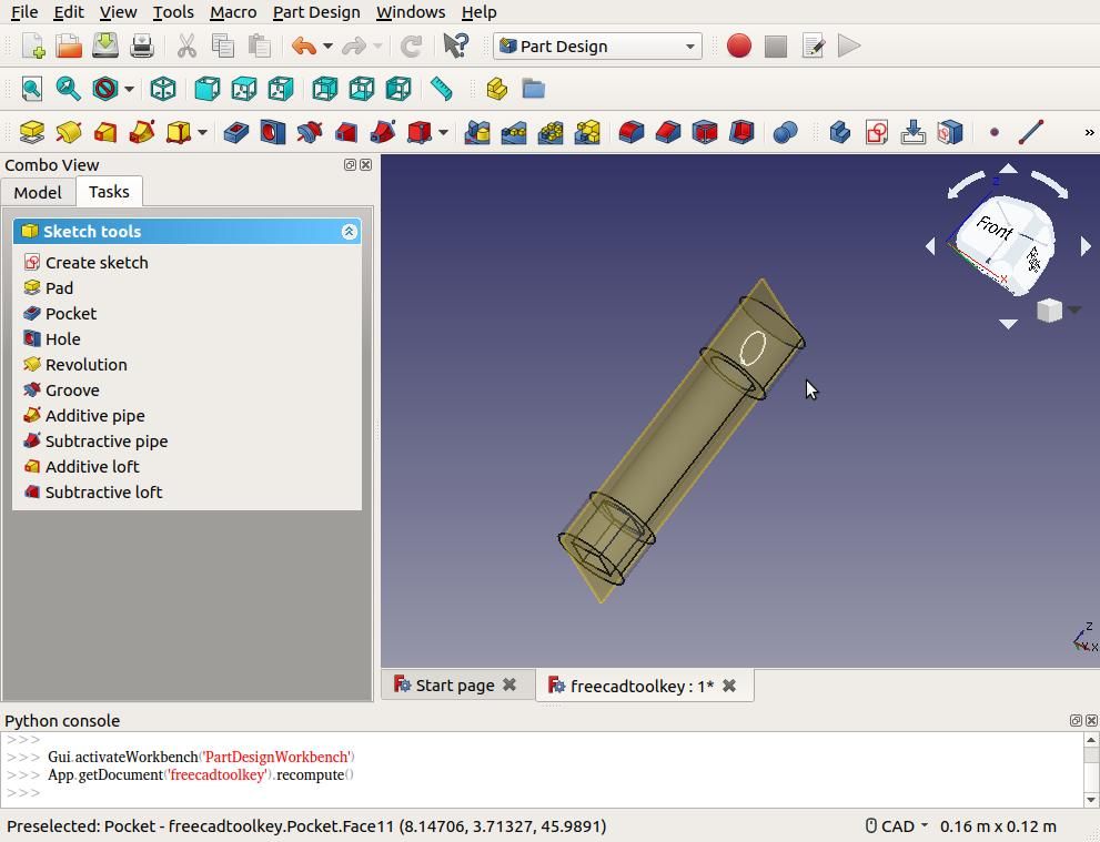

              Now select the new base, and sketch an 8.1mm square on it. Use the ‘Create a Regular Polygon’ tool rather than ‘Create a Rectangle’ . The first positions on centres, the second is on corners. The ‘‘Create a Regular Polygon’ button has a down arrow on the left; clicking it offers a list of possibilities including squares.
              Zooming in (try rolling the centre wheel on your mouse), shows the square drawn with several preset constraints. All that’s needed to fully define its size is to select one side and add length 8.1mm with the red I-bar button. The square should also be centred on the base with the ‘Create a Coincident Constraint’ button.
              Close the sketch and, in the Tasks pane click the ‘Pocket’ tool. Pocket is the opposite of Pad; it cuts a sketched shape into the solid. Setting length to 12mm creates a square sided socket inside the tool-key’s base.
              Brief digression, the similar ‘Hole’ tool specialises in round holes that can be threaded and countersunk etc.

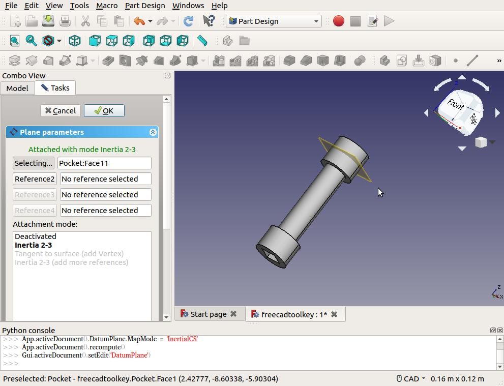

              At this stage the shank is almost complete, the main omission being the Tommy bar handle. This introduces a new trick. The obvious way to make the Tommy bar (or hole to take one), would be to sketch a circle on the side of the shank and ‘Pocket’ it. Not quite that simple because CAD tools do not (usually) allow sketches to be drawn on curved surfaces – the geometry is difficult! Instead, the package can add new planes to the model, and these can sketched on to do the necessary. The technique is powerful because planes can be rotated to any 3 dimensional angle.

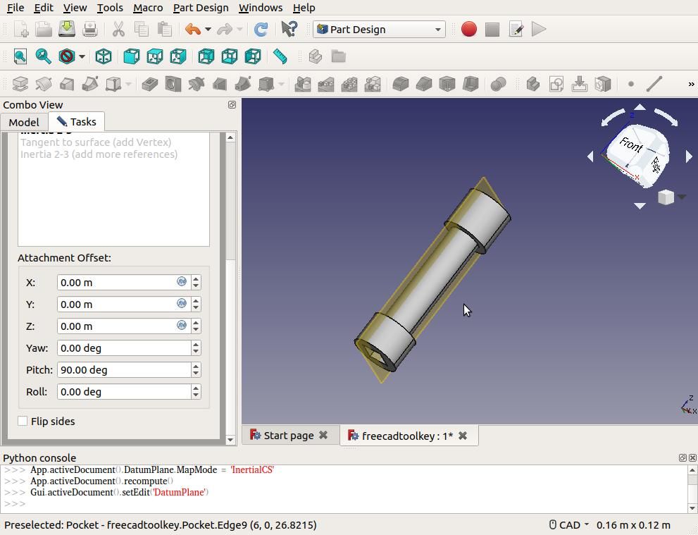

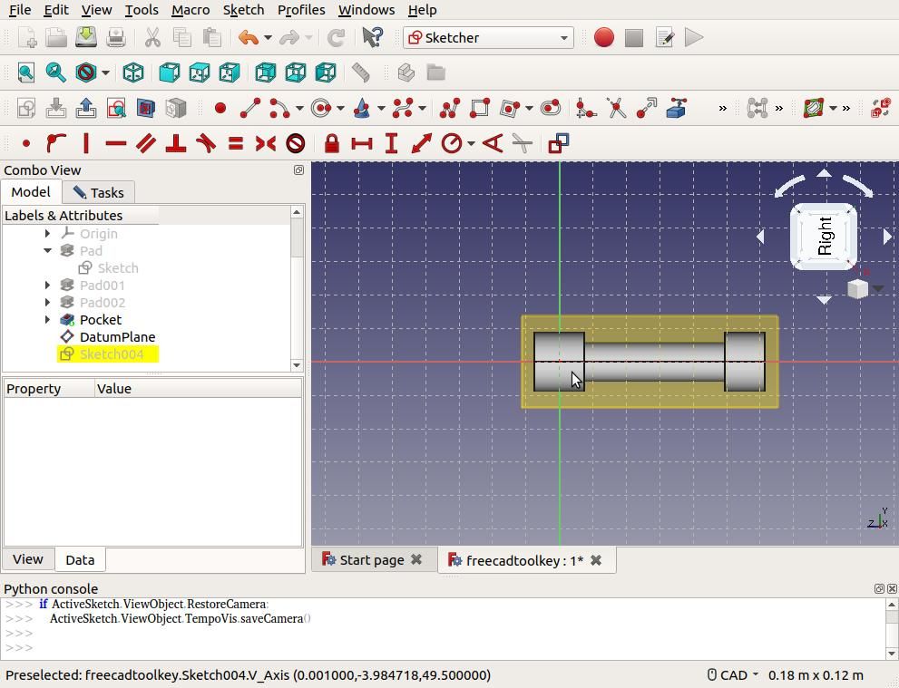

              Select the top of the shank by clicking on it. Then, in the Tasks pane, select the ‘Create a Datum Plane Tool’
              With luck the new plane will be oriented correctly. Not so in this example.

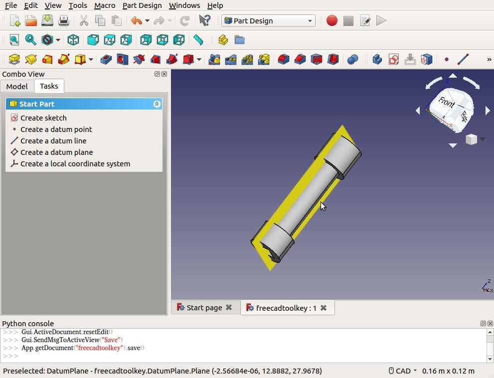

              Scrolling down the Tasks pane whilst the Datum Plane tool is active reveals that the plane can be offset, and turned (Roll, Pitch and Yaw.) Note the booby trap in the X,Y, and Z offsets, which are set in metres! Fortunately numbers can be typed with a unit, eg. 10mm
              All we need to do is turn the plane through 90 degrees to align with the shank’s centre axis. Type 90 into the Pitch Box:
              Click the ‘OK’ button to close the Datum Plane Tool. Then select the plane by clicking on it.
              Now select ‘Create Sketch’ from the Tasks pane:

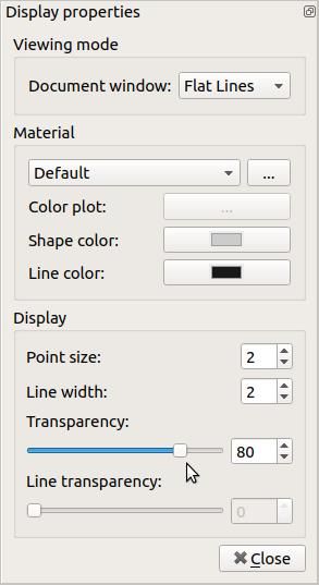

              #414984
                Part 5
                There’s a problem. Although the necessary circle can sketched on the plane, we can’t see it! The cure is to select the Model tab in the Combo View and Right Click on the bold ‘Pocket’ Line. This produces a list of options from which select ‘Appearance’. Use the dialogue to set Transparency to about 80%, producing a view where the sketch grid can be seen inside the solid shank:
                In ‘see through’ mode, it’s easy to draw a circle in the right place on the plane and constrain it as required. Close the sketcher, revealing the result, including internal detail of the square socket.
                Press ‘Pad’ but this time also tick the ‘Symmetric to plane’ box as well as Length 100mm
                The ‘Symmetric’ option pads sketches in both directions, producing a nearly finished tool-post key. The datum plane (or any other feature listed in the ‘Model’ tab), can be hidden or revealed by selecting it and tapping the Space Bar.

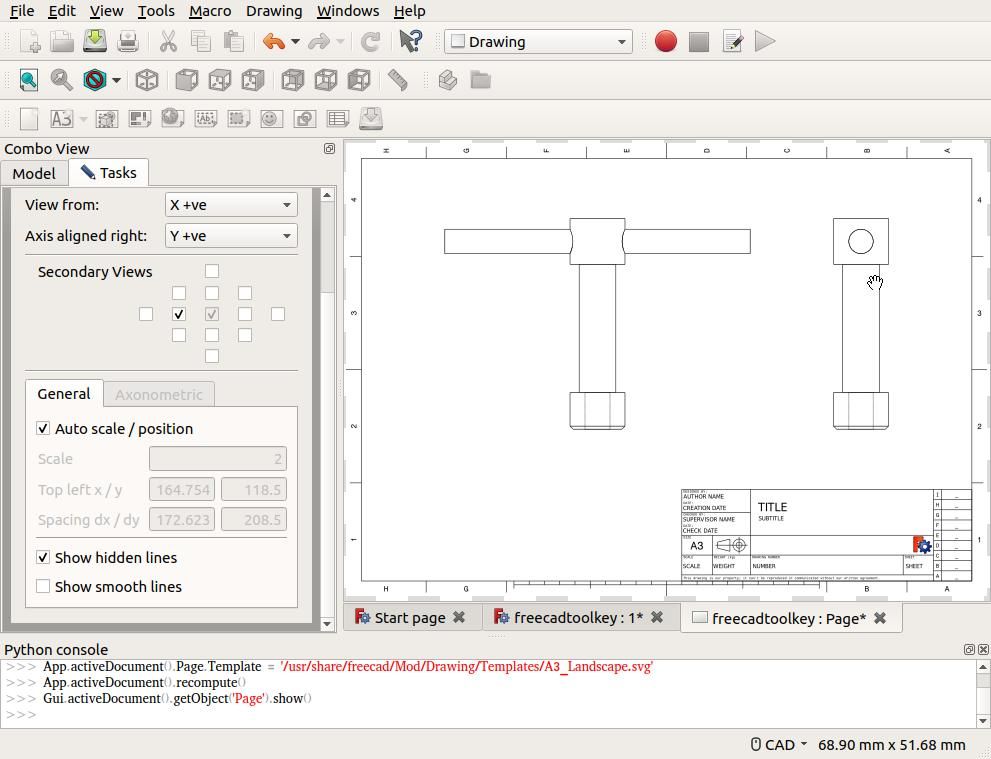

                    Part 6

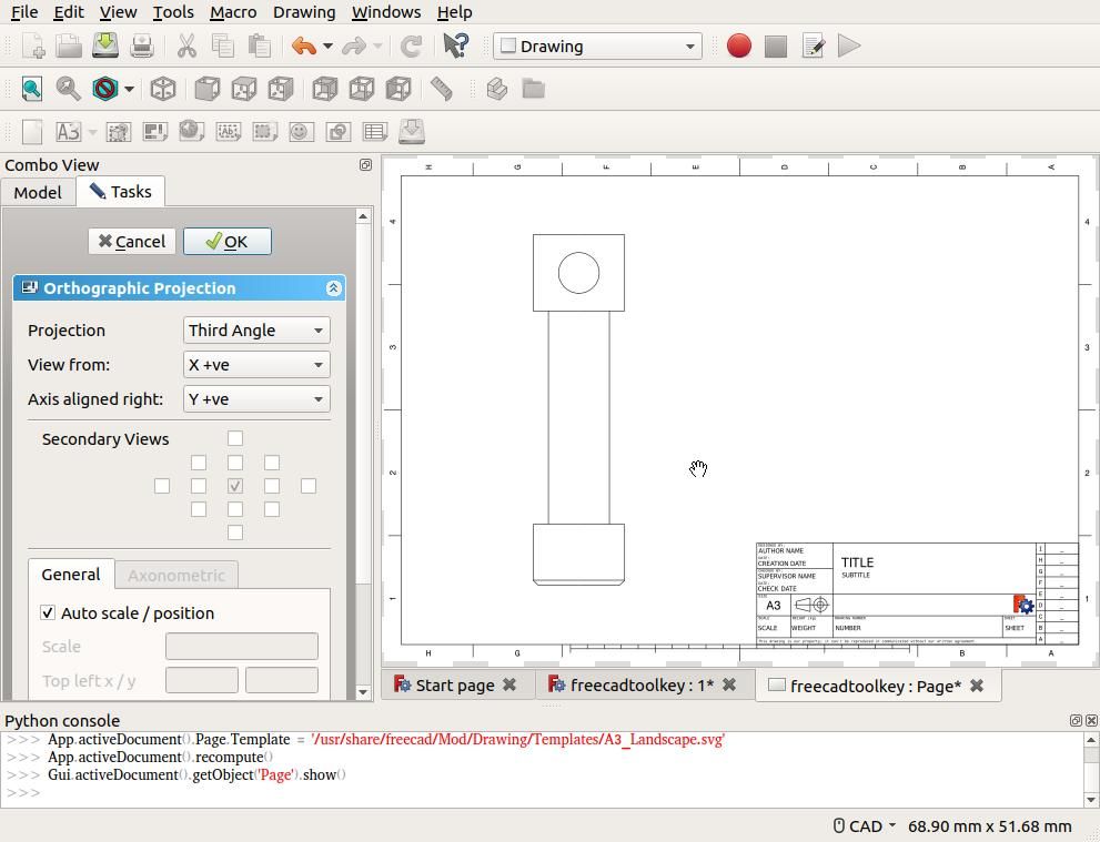

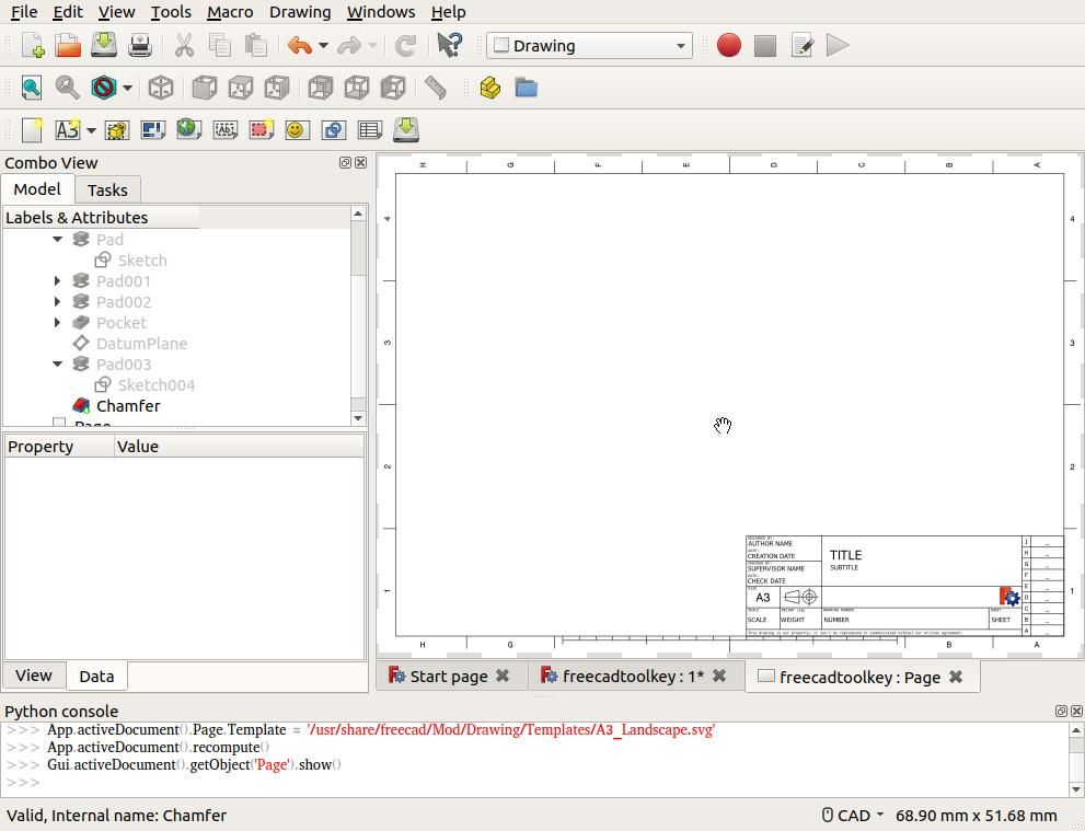

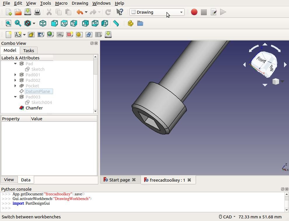

                    Last step in this introduction is to generate 2D drawings from the finished model. Switch to the ‘Drawing’ Workbench (see pointer):
                    Click on the ‘Insert New Drawing’ button to make an empty sheet.
                    Then, select the Chamfer line in the Model list in the Combo View and click the ‘Insert Orthographic Projection of a Part’ button. (The Chamfer line is the last step in the model) Bingo, a 2D drawing should appear.
                    The Tasks pane has several ‘Secondary Views’ tick boxes. Selecting adds more 2D projections to the drawing, scaling as necessary. It is also possible to show hidden lines.
                    This is an opportunity to point out that FreeCAD has limitations. Unlike paid for alternatives the 2D generating tool doesn’t support adding dimensions in an integrated way yet. How it can be done is described here.
                    There are many other examples where FreeCAD either doesn’t support a feature at all, or the way it works is labour intensive! However within limitations, it does a useful job. The way it works is similar to Fusion360, though Fusion is much more advanced.

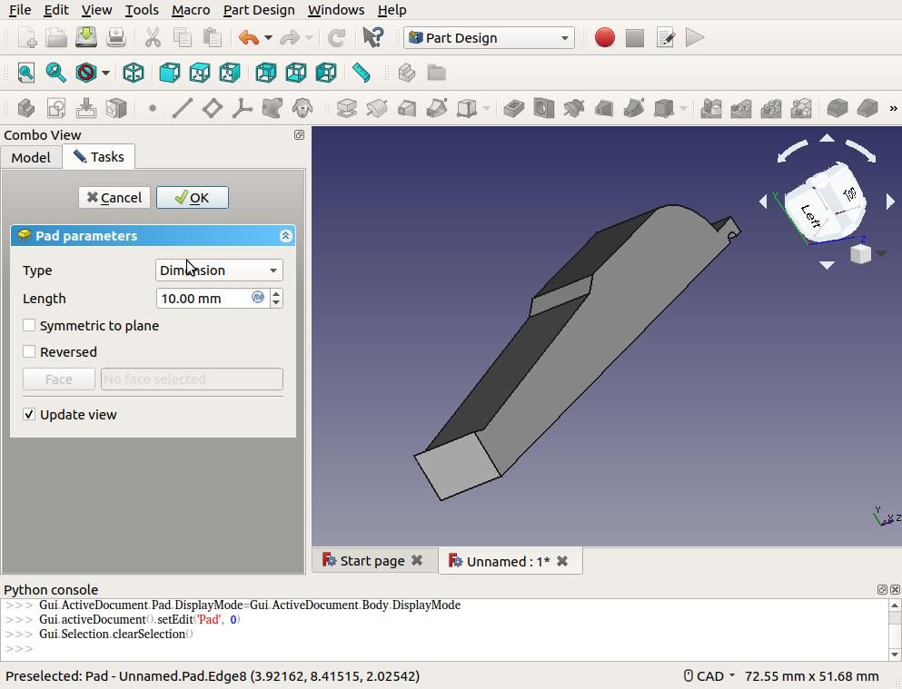

                    #414987
                      Part 7

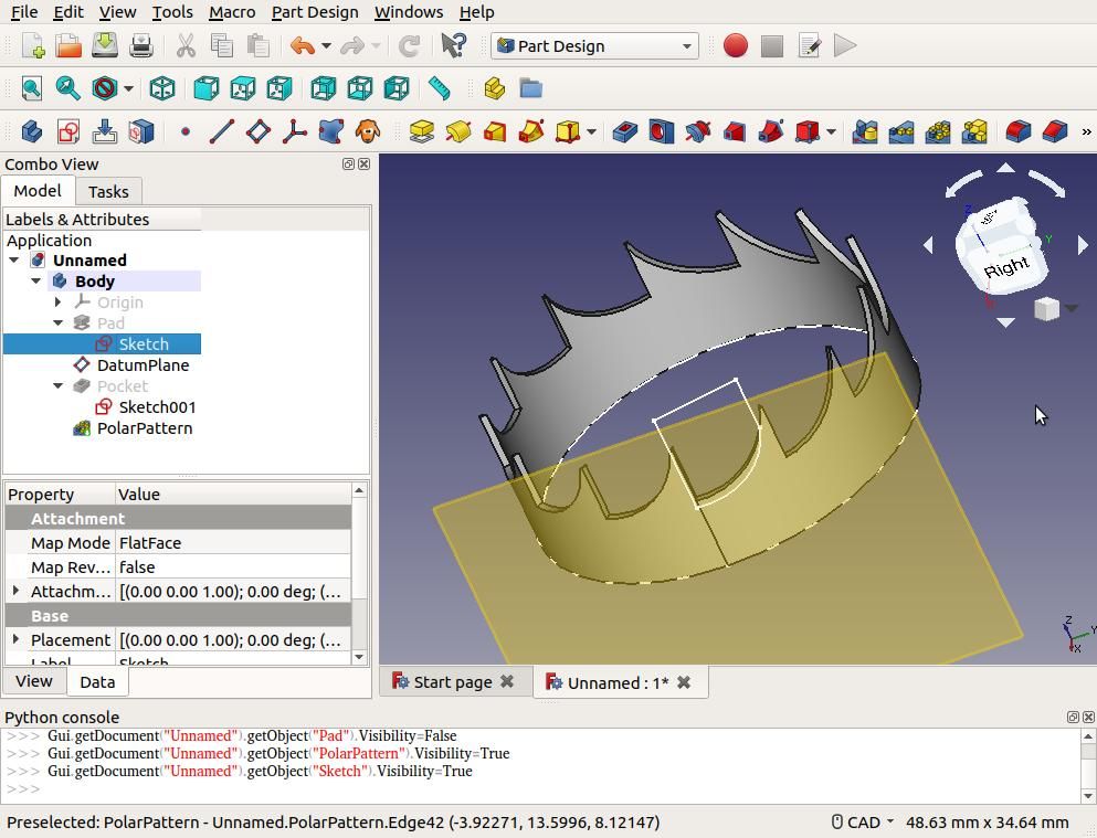

                      Conscious that I’ve only scratched the surface, I’ll finish with two other quick examples. Say you wanted to model an 18th century cannon. Pretty clear the way I made the tool-post key isn’t quite suitable. A cannon object can be made thus. Start FreeCAD as describe before but this time sketch half the profile of the cannon. Drawing the lines and arcs etc that outline the cannon requires more sketcher skills than the tool-post key, but the principles are the same. Sketch the lines, constrain them (including making sure their ends join), and then apply a convert to solid tool.

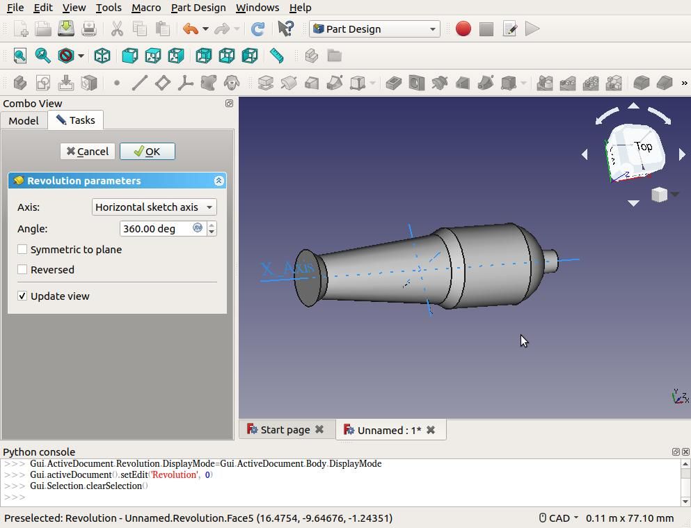

                      Padding the cannon sketch creates the wrong shape!
                      Pad is the wrong tool in this case. Using the ‘Revolution’ tool to spin the sketch around the horizontal axis, does what’s needed.
                      There’s a mistake in the sketch spoiling the cannon model. Zooming in on the cascabel set to 80% transparency reveals a ‘feature’ inside. Mistakes like this can cause considerable bother later on. It’s an unwanted inconsistency, not obvious at first sight, that might confuse when the tool suddenly refuses to perform an apparently legal operation or displays something completely unexpected. As with building a skyscraper you have to take care with the foundations!
                      The cannon can be bored by sketching a circle on the flat muzzle and applying a Pocket
                      Last example, the verge, or crown-wheel for a clock:
                      This is modelled by padding two concentric circles to make a short pipe, adding a datum plane to one side of the cylinder on which the tooth shape is drawn, pocketing the tooth through one side of the cylinder, and then rotate-copying the tooth-shape 13 times around the central axis with the ‘Create a Polar Feature’ tool.
                      Apologies for the long-winded detail but missing out simple steps in 3D leads to chaos. Once understood, modelling can be rather fast. The models described only take a few minutes to create once you know how FreeCAD works. And far longer to describe!

                                        The chamfer tool seems also to add fillets to the selected surface. How do you remove them, or have I done something stupid?

                                              Fillets and Chamfers? Not quite sure what you mean. Do you have chamfers that look like fillets?
                                              In this object, the top is rounded with a fillet, and the other levels are chamfered flat. (The effects are done with different tools, their actions recorded as 'Chamfer', 'Chamfer001', and 'Fillet' in the Model time-line list.)
                                              Do you mean, how do I remove an earlier chamfer?
