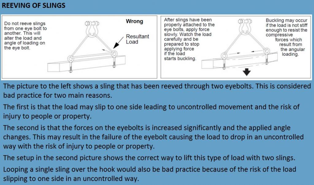

          It's important to find an experienced machine mover, rather than a transport company who will have a go for you. My first move 2 years ago used a good outfit in Liverpool but I lost their details. Then a few months back I used another company that was more of a haulier than a machine mover (the latter would be called "riggers" in N America). Things nearly went tits up (literally) due to a complete ignorance of centres of gravity, lifting points etc.
          This is what happened. Luckily (no skill involved), nothing got damaged, although if I'd been standing there when he did it, I might have seriously damaged my underwear.
          You'll notice that the lifting points are at ground level and the centre of gravity is around chest height. So, if you use 2 long straps looped through the lifting eye (as opposed to 4 short ones), you'll end up with an unstable machine, as ably demonstrated – it's not rocket science. This machine weighs 3 tonnes.

                    Muzzer the term for looping slings over hooks or through shackles or lifting eyes is reeving. It is a big no no in the eyes of anyone with any lifting training since it is easy for a load with a high or offset centre of gravity to start to move with the result so aptly shown in your photo.
                    Martin C

                                        Posted by Martin Connelly on 20/03/2017 15:07:12:
                                        Martin C
                                        That second example is almost as bad as the first!
                                        A spreader bar should be used in those circumstances, so there is a straight lift on the eye bolts, not introducing side forces on the eye bolt threads, as the example shown would.

                                          Martin Connelly
                                            @martinconnelly55370
                                            David, the second slinging example is showing normal bending of the load under the forces caused by lifting but in an exaggerated way. It should show collared eyebolts but this may not show on a small graphic. It is a common and accepted lifting method as long as the "correct use of eyebolts rules" are followed. An understanding of the tension in the slings is important as well as the de-rating of eyebolts for an angled pull. It is necessary to understand the difference between working load limit (WLL) and safe working load (SWL) if you are to lift something in a safe manner. The department I work in regularly lift multi-million £ loads of 30 to 60 tonnes, we take lifting safety very seriously.
                                            Martin C
