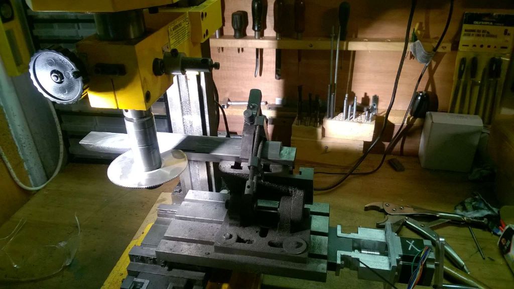

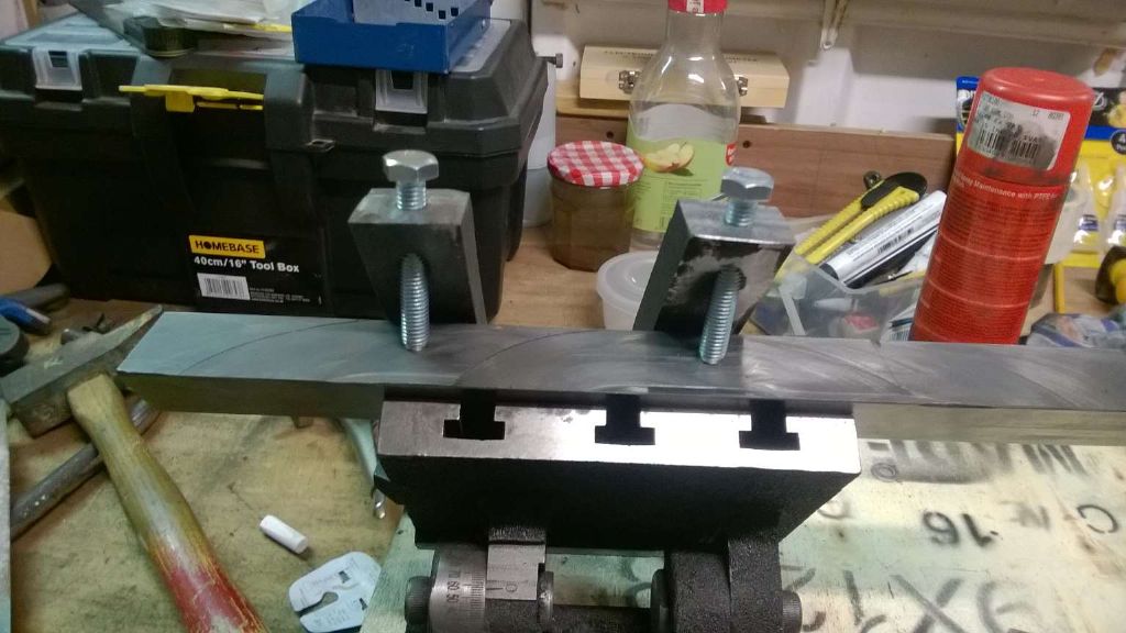

                        I've snuck out to the shed drilled my holes and tapped my thread.
                        7mm works absolutely fine for a standard M8 thread.
                        As I mentioned earlier this was for a clamp which is not quite finished. The piece is intended to be a 55 degree prism as part of my ongoing (never ending?) attempts to tune up my micro mill.
                        First part was to slice off the top of a cast iron bar with a slitting saw.
                        I seem to have learned a lot about using a slitting saw with this task – the hard way. For a whole variety of reasons the cut is not as precise as I would like so my next step is to face it off. But how to hold it?
                        Like this! (obviously with something to protect the surface under the bolts).
                        Iain

                            Iain, good to hear that you were successful producing a usable thread.
                            That is a nice tilting table you have in the pics. How big is it and where did you get it from? I'm looking to get something similar for myself.

                                Steve – this is a 'tilting angleplate' from RDG tools, see here. Current price is 53 quid inc VAT and postage.
                                I ignore the angle markings on it and set it using a cheap electronic angle gauge from Lidl.
                                My only complaint is that it is subject to rust even when one tries to keep it oiled up.
