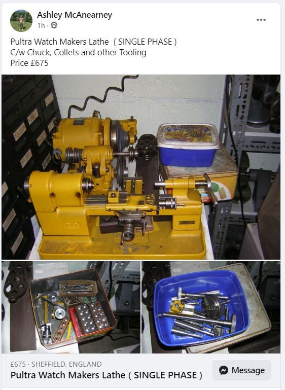

                  Whilst this may not appeal to Henry, anyone in the market for a Pultra might be interested in this advert on Facebook
                  The seller's name isn't that common in Sheffield, so may well be associated with a well recognised local machine tool dealer.
                  You can't see from the screenshot, but it's a private group, so you would need to join, or PM me with email & phone No. and I can pass on a message

                    Well I never
                    That is the very lathe that my late father restored many years ago, he sold it before he died probably around year 2000.
                    I often wondered what became of it, now I know. If I didn't already have one of my own I would buy it back in a flash.
                    Whatever possessed my dad to paint it bright yellow I will never know, but it makes it stand out from the crowd.

                      Perhaps he coveted a Clarke CL300M devil
                      Frivolity aside … it’s certainly worth a look !

                        If anyone has a Facebook account, and is looking for machinery, it might be worth joining the group.
                        The Pultra I mentioned earlier is actually from a respected dealer.

                          Having had chance to look at the other stuff on Facebook from this dealer, it turns out he is selling around sixteen machines that used to belong to my late father, I guess the chap who bought them from my dad must have died and this is his workshop now being cleared out.
