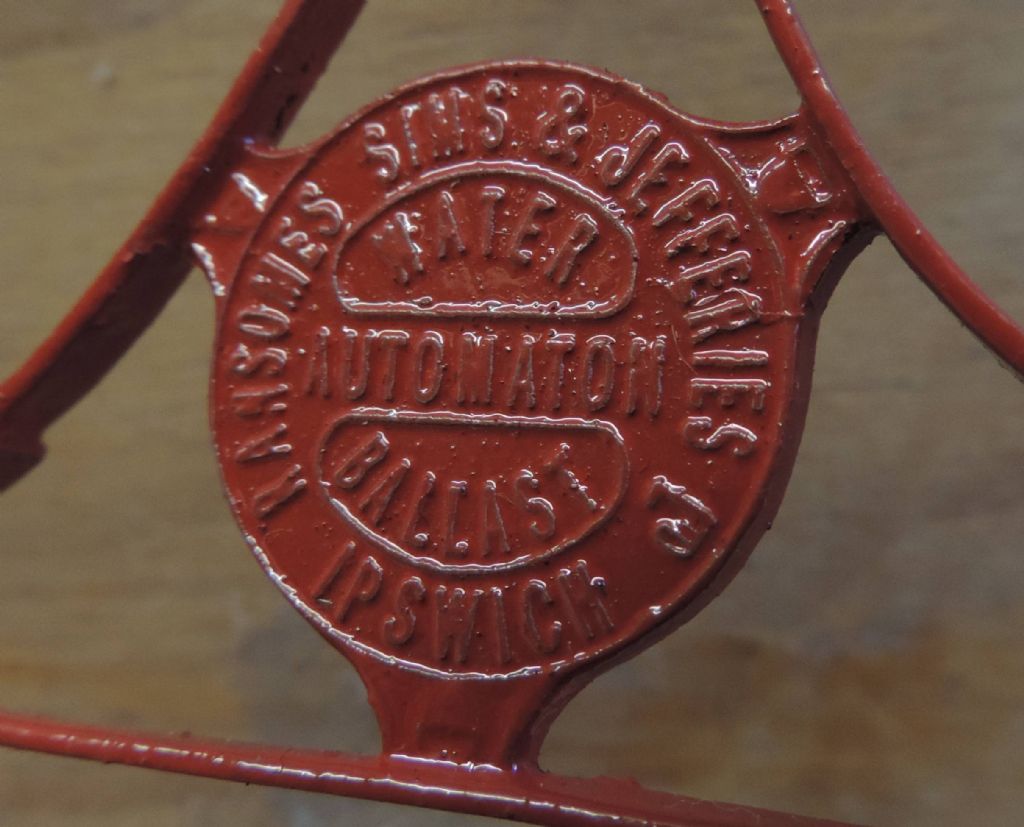

                  Hi Deltic,
                  I'm hopeful that ME might publish a step by step article of mine on the subject in the new year.
                  The disc below is about 7/8" diameter.
