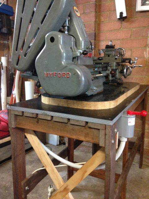

      Afternoon all,
      Does anyone have any experience using a "mechanic" style commercially-available workbench as a lathe stand? Something like this:
      https://www.machinemart.co.uk/p/cwb1205p-5-drawer-workbench/
      (not necessarily that one, just the first one I plucked from the internet. Also, no connection to the vendor etc etc)
      My lathe (an ML7) is currently mounted on a wooyden bench that I built onto the wall of my workshop. It has served me well, but I am thinking about reorganising the workshop. A bench like the one above would allow me to move and re-mount the lathe with a minimum of fuss. And again in the future, should the need arise. The drawers would be useful too, of course.
      Am I barking up the wrong tree? If one of these benches is viable, are there any brands I should look out for?
      Thanks!

                    Coincidentally, I just finished upgrading my ML-7 stand yesterday. It is a recycled barbecue trolley with a bit of ply plus a bit of kitchen bench top. I added two extra legs and some bracing. The switch was from ebay and thanks to Warwick Allison for wiring it to the motor for me. You can tell it is just finished as it is so clean! It is all pretty rigid and flat, plenty good enough for a little lathe.

                        Morning all, thank you for your replies.
                        I am comfortable (happy, even) doing a bit of woodwork, so I can knock up a stand-alone bench if need be. I am trying to decide whether the cost of materials + the time required is worth it versus a store bought bench that's ready to go.
                        Naturally any bench will have to allow the lathe to be levelled and / or shimmed. My present bench is just over 3' high which is a comfortable height for me. I expect any bench I bought would be lower, so I'd need to use raising blocks anyway. Unfortunately I only have a small hatchback for transport, so any option I take either has to be delivered or dismantled / flatpacked.
                        On the other hand, I could just buy a bigger, floor-standing lathe………

                            +1 for homemade levelling blocks. You'd be very fortunate to get it level enough to turn parallel without them.
                            Mine have M16 bolts bored to accept M8 or 5/16" bolts from underneath the lathe.
                            For an ML7 the key dimensions (Courtesy of Wiktoria Jablonska (Anna) from the Myford forum) the rising blocks are on 4 5/8" centres and lengthwise it is 22 1/4" between the holes.

                                  Without teaching my granny etc; I hope that you realise you can only properly set up a Myford if you have a stable base to level the lathe to. Because timber is a dynamic material, and moves with weather, heat, humidity, natural ongoing seasoning of the wood etc, it is not necessarily a static base to work with.
                                  You could level the lathe so it turns parallel one week, and the weather etc effect on a timber base totally throw that out the next week.
                                  It's a chance you need to be prepared to take if you go with a timber base.
                                  All of the six Myfords I have owned have sat on the steel factory cabinets, and I have always levelled the stand first, then fitted the lathe to that base.
                                  Setting up a Myford is not just 'levelling' it in the context of the base being in the horizontal plane, or the lathe itself the same, it has to incorporate a parallel turning test, which is well documented.
                                  For all intents and purposes setting it up to turn parallel will quite possibly involve the adjusters twisting the lathe bed, if the bench goes with the adjustments, it will never achieve the aim of turning parallel, or for that matter necessarily staying that way.

                                      Most of the issues with timber can be overcome by the use of properly seasoned timber for construction with the finished cabinet thoroughly painted inside and out. A good idea anyway if any ply, MDF or chipboard is used in the construction.
                                      By following this process my Myford has been sitting happily, and sufficiently accurately for my purposes, on such a bench for over thirty years.
                                      A steel bench will also expand and contract with temperature and not necessarily at the same rate as the lathe mounted upon it. The effect can be even worse if part of the bench is exposed to the sun through a window. The same applies to the lathe irrespective of the bench (timber or steel) it is mounted on. In this case curtains may be the best answer and the sewing machine your best friend.

                                                  Timber moves with humidity. It also soaks up oil over the decades. I left dad's one behind in Buckfastleigh tip Devon, with its woodworm…
                                                  RDG, who bought the Myford name, manufacture steel cabinets that are to the original design and fit the ML7 and Super 7 lathes perfectly. The only issue is that they aren't making cabinets for the long bed lathes at the moment, Might be worth chatting to them if that's needed.
                                                  Basically, a steel cabinet under an ML7 will out perform a wood one unless one is prone to lighting a barbecue in the cabinet (even thenlaugh). And the RDG/Myford ones have the vague advantage of being sized exactly for the lathes that are sitting on them. The prices are not outrageous compared with that that I paid 10 years ago for a second-hand one 200 miles away…

                                                    My experience with the mighty Drummond Flagellator has been to avoid mounting the lathe on a bench or cabinet that uses a top made of a single piece of sheetmetal or even thin steel plate say 6mm or even 8mm thick. It sags. It bows. It flexes. It vibrates. It drums and makes a heck of noise.
                                                    The bench top needs to have sturdy cross members underneath it to bolt the lathe to. Those cross members need to be made from stout angle iron or square tube or the like and be solidly connected to the main angle or tube frame of the bench. The more solid you can make it, the quieter and smoother the lathe will run, and the smoother it will cut.
                                                    Leveling blocks are entirely optional. You can simply slide U-shaped shims under the lathe mounting points to get it to turn parallel as per the Myford manual.
                                                    That's what I've found, anyhow. The Flagellator's original bench I inherited was a rectangle of 8mm steel plate with four stout legs of 2" angle iron welded directly to it at each corner. Weighed a ton and seemed solid. But the top was sagged in the middle from the weight of the mighty Flagellator and it ran very noisy. When adjusting the countershaft belt tension, with countershaft stand bolted to the bench top, all that would happen would be the bench top would bow and the belt get no tighter! I made a stout framework under the bench top out of 75mm steel channel braced to extra legs that then bolted to the garage floor. Much quieter and smoother operation resulted. the beast was tamed.
