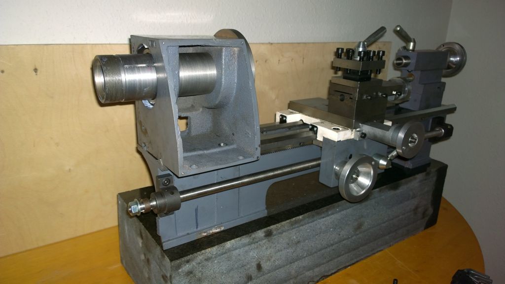

      The MeGa 50mm hole spindle is in and waiting for a 1.5kW/3000rpm/12 Nm industrial sewing machine motor.
      The Spindle flange and tube is copperbrazed..
      Screwed on flanges or chuck are dangerous due to the instantaneous stopping of motor.
      #509603
      Ian P
        @ianp
        That certainly looks a substantial spindle assembly. Presume you have access to a large lathe and other engineering facilities to braze and machine a spindle of that size. (machined after brazing?)
        I agree about the vulnerability of screwed on chucks but having gone to the trouble you have, why not elect for camlock mount?

              #509625
              Niels Abildgaard
                @nielsabildgaard33719
                Posted by Ian P on 24/11/2020 15:12:19:
                Ian P
                The 125mm dia raw flange was machined on my 250 lathe that has been liberated by my son and the tube as well.
                I worked at a copperbrazing site many years ago and the new owner did it at a fair prize..
                If I knew where to get some Easyflow(No,No) I would have done it in garden.
                The important step of turning thread and bearing seat in one go was done on my late 250.
                The main zeal of exercise is to keep overhang from front bearing as short as possible and show the Chinese that they can do a better job within the given constraints.wp_20200426_002[1].jpg

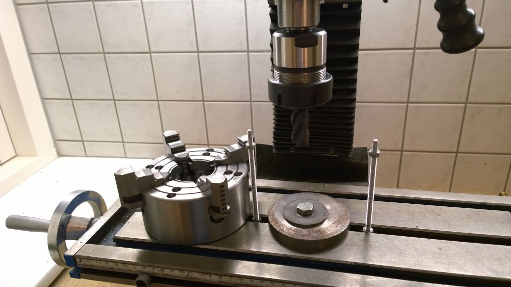

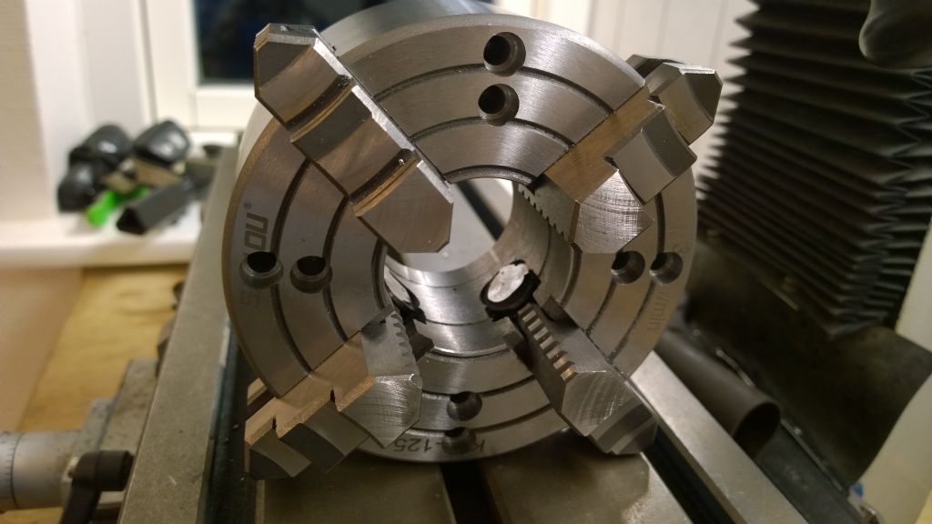

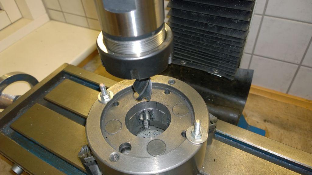

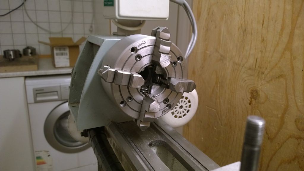

                      #510046
                      Niels Abildgaard
                        Posted by old mart on 24/11/2020 15:19:53:
                        To match the oversized spindle bore, a chuck would have to be far too big for that little lathe, so the whole exercise is a futile wast of time and money.
                        Please find a picture of boring a 50mm hole in a 125mm four jaw chuck on a 180mm lathe with 30mm hole.
                        My 210 mm lathe is not running yet but has a 50mm hole in spinde.
                        Next picture shows how it will look on the 180 lathe ready for action.
                        I have not yet thought of an elegant way to cut the jaw screws.
                        They are hardened.
                        Any sensible objections?
                        #510053
                        old mart
                          @oldmart
                          From the photos, particularly the first, it looks like there will be very little left of the inner part of the screws when they are cut to clear the 50mm bore. The remaining flanges are all that will hold the jaws and the screws in the chuck.
                          #510057
                          Niels Abildgaard
                            Posted by old mart on 26/11/2020 19:28:23:
                            Instead of 9 flanges supporting the jaw I will have seven.
                            No big deal when in 35 to 50mm zone.
                            For smaller diameters I will use the 100mm four jaw enlarged from 25mm hole to 36mm.It is lower mass and more manegeable.
                            II am still thinking I will ask the manufacturer to make a ligthweigth 125mm/50mm bore  four jaw with screws and claws from the 80mm model.
                            Nicer for old toads.

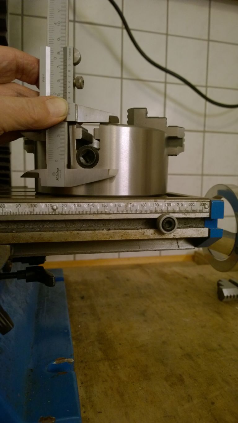

                            If a reader has a 80mm four jaw can You please measure distance from front face to underside of screw hole like on picture?
                            Edited By Niels Abildgaard on 26/11/2020 19:43:20

                            #510100
                            Thor 🇳🇴
                              @thor
                              Hi Niels,
                              On my 80mm 4-jaw independent from ARC the distance is 29mm.
                              Thor
                              #510107
                              Niels Abildgaard
                                Posted by Thor on 27/11/2020 04:48:28:
                                Hi Niels,
                                Thor
                                Thank You Thor
                                On my normal 125 it is 36mm and mass is 5+kg.
                                With Your 29mm a independent adjustable four jaw 125mm dia slimline with 50mm borehole should be feasible with ca 4kg mass.Nicer and safer than 9kg for a standard 160mm version that has a 50 mm bore from factory.
                                Edited By Niels Abildgaard on 27/11/2020 08:40:30
                                #510122
                                Thor 🇳🇴
                                  @thor
                                  Hi Niels,
                                  I have a lightweight (4.5kg) Indian 6 inch 4-jaw independent on my 290 lathe, the distance you asked is 31mm on the 6 inch and the chuck is about 45mm thick. As you say, the lighter chucks are easier to lift when you are old and have worn joints. I'm looking forward to see photos.
                                  Thor

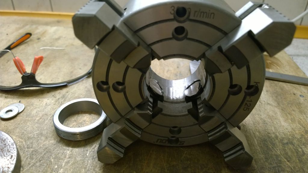

                                        Niels Abildgaard
                                          Hi Thor
                                          It went better than expected to enlarge my 125mm four jaw.Trick was to keep screws fixed by blocking the jaws.
                                          #510336
                                          Thor 🇳🇴
                                            @thor
                                            Hi Niels,
                                            Thanks for the photos, well done. Will enlarging the hole interfere with the jaw adjusting screws? I see your chuck can be mounted on a backplate from the front, makes things easier.
                                            Thor
                                            #510340
                                            Niels Abildgaard
                                              Posted by Thor on 28/11/2020 04:50:13:
                                              Hi Niels,
                                              Thor
                                              The four jaw screws were cut in same operation as the chuck body.
                                              Very healthy diet for a scrapped carbide cutter ,this mixture of cast iron and casehardened steel
                                              #510375
                                              Andy Pugh
                                                @andypugh44463
                                                Posted by Niels Abildgaard on 28/11/2020 05:55:49:
                                                I was a bit surprised by that. It isn't generally very difficult to get the screws out, and then the inside ends could be finished off neatly on a lathe.
                                                Just remove the jaws and then tap the forks back with a punch. They are often only retained by the backplate.
                                                #510437
                                                Niels Abildgaard
                                                  The screw forks are more fixed than the violence and screwdriver misuse that I like to apply.
                                                  I have cleaned up the boring and screws so that 48mm will pass and mass is 4.3kg.

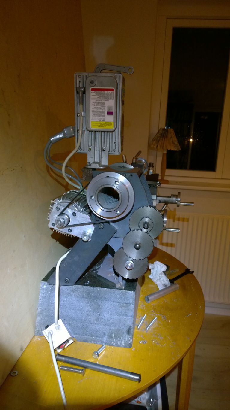

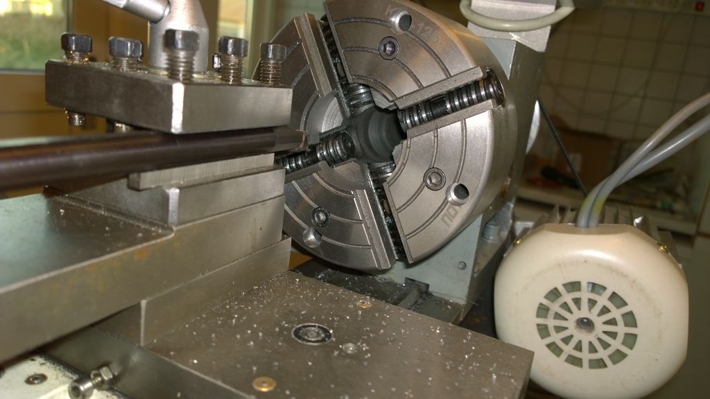

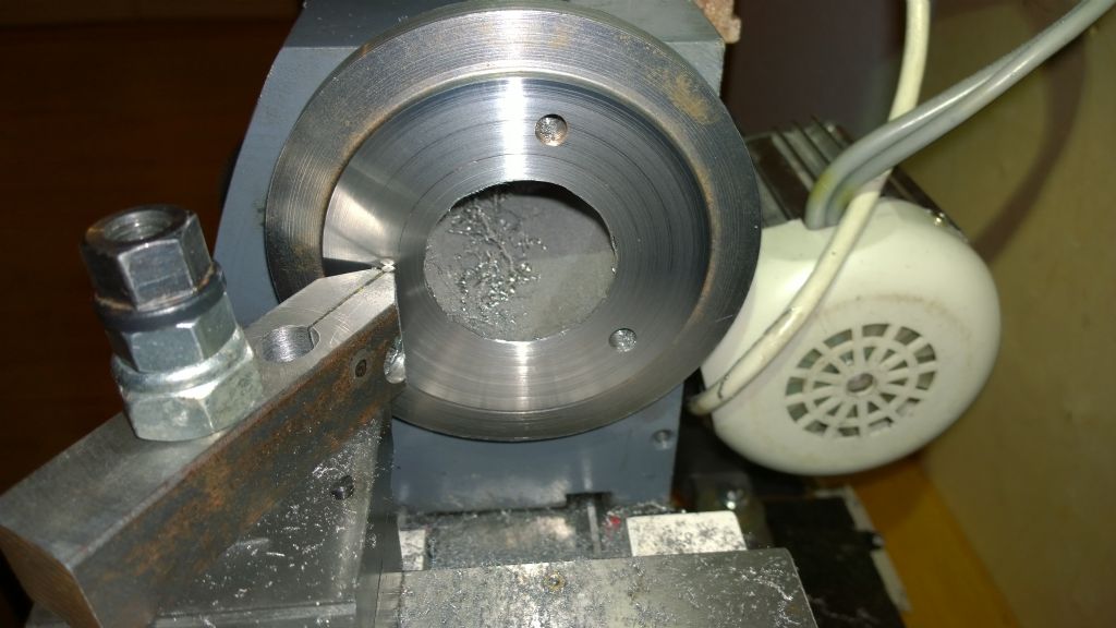

                                                  #518509
                                                  Niels Abildgaard
                                                    A Boxford VSL escaped my inhumane experiments and is in a good home where new owner also has pre WW2 Citroen Traction Avant.
                                                    Very classy company for a Boxford.
                                                    My cheap 210 that came with 38mm spindle bore has cut first swarf on its own new 50mm bore spindle.
                                                    It went very well but bearings are running much to hot.
                                                    It is very instructive to have a Watt meter before converter.
                                                    I made motor run 2000 rpm(Belt to spindle 4 to 1 ca) without belt and used 20 W.
                                                    With belt on but not cutting and same speed consumption was 190W and belt and bearings became much to hot..
                                                    Spindle nut was loosened and a hammer and woodblock worked and consumption sank to 120W.
                                                    Tomorrow the 125mm four-jaw with 48mm hole will be put on and we will try some real parting off.
                                                    Edited By Niels Abildgaard on 08/01/2021 19:56:50
                                                    #518535
                                                    old mart
                                                      @oldmart
                                                      Common spindle preload setup with taper roller bearings is just enough to end up warm to the touch but not hot, after 15-20 minutes at top speed unloaded. This would probably hold good with angular contact bearings as well.
