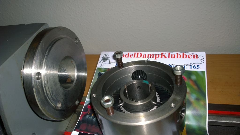

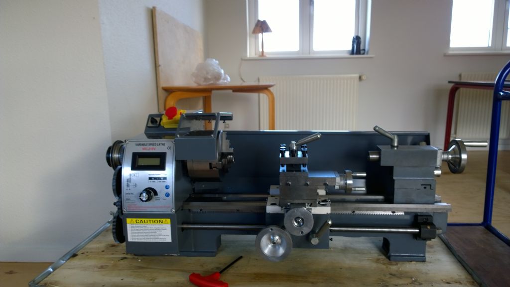

      It has not been a cheap journey looking for the ultimate living room lathe, but quite fun.
      Somehow I feelt a little fooled when I found this :
      210 lathe 38mm spindle
      #431522
      Niels Abildgaard
        @nielsabildgaard33719
        and this:
        700$ ideal lathe?
        Edited By Niels Abildgaard on 02/10/2019 19:38:42

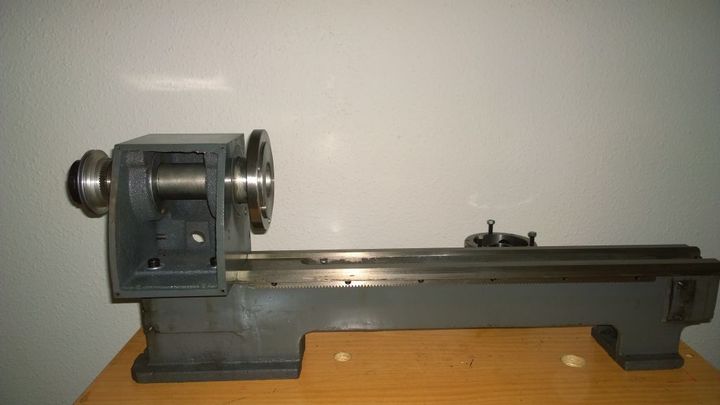

                #434883
                Niels Abildgaard
                  It is getting out of this world.
                  The 210 lathe with 38mm bore was assumed to have bearings 45mm bore ,68mm outside and15mm wide .
                  It has not
                  210 lathe with 30209 bearing
                  These bearings are 45mm inside ,85mm outside and 22,5mm wide.
                  That means I can put in 32912 bearings (60 mm bore,85 outside and 17mm wide) and thus have a 50mm through bore spindle.
                  Please help me with some arguments for this new toy I want.

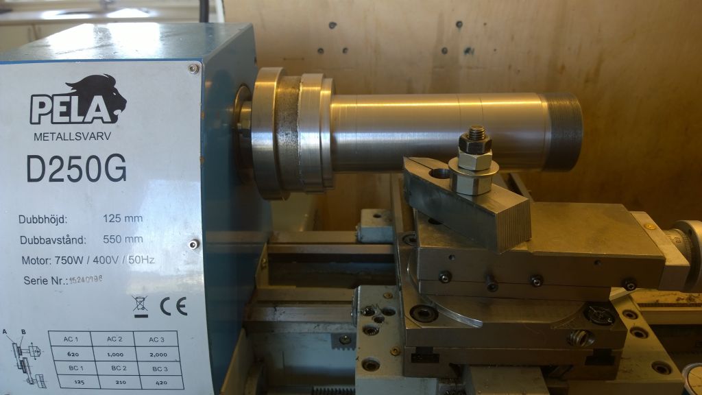

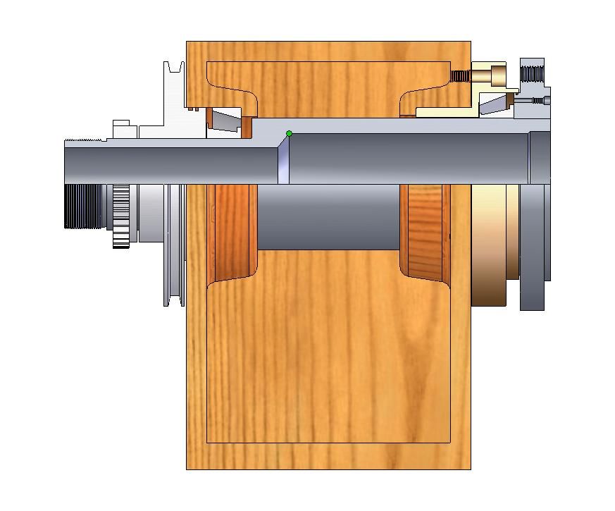

                          #447645
                          Niels Abildgaard
                            The sketch from 28 oct was my plan for making a small envelope,oilfield lathe with a spindle bore of 50mm.
                            I did buy a WM210* 400 with 38mm bore lathe and took it apart.
                            Quality on spindle and chuck was abyssmal.
                            I did not throw it on scrapheap but sold it very cheap after having informed him clearly what was wrong.
                            He lives 20km from here and lathe is running.He have agreed to let me try a bighole spindle if I ever finishes such one.
                            Edited By Niels Abildgaard on 19/01/2020 20:10:44

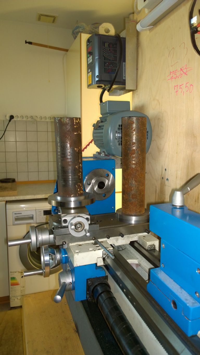

                            #447652
                            Niels Abildgaard
                              Intention is to copperbraze some almost finished flanges unto some thin-walled steel pipes of good quality.
                              And then see if my WM250 lathe can make it.My WM250 lathe has the same 62mm bearing holes like almost all other chineese and austrian mini lathes.
                              Thats to small.
                              I tried to part of some 100mm steel and that was not possible.
                              75mm steel worked but was neither easy or nice.
                              There is really a need for bigger hobby lathe spindles.
                              The monster WM210/38 bore lathe came with two 45/85/22mm spindle bearings and can then have a 38mm bore.
                              Slim bearings (32912 or 60/85/17mm) can hold a new homemade spindle with 50 or51mm bore.

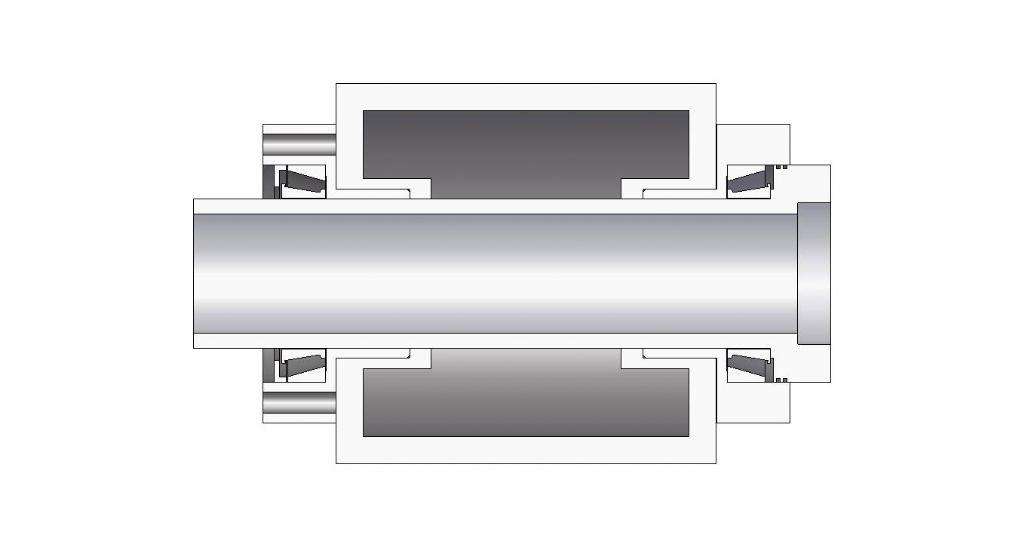

                              It spoils my sleep that I can also fit bearing/spindle set as shown
                              The lower spindle half is the standard 45/85/22mm bearings and spindle from China.
                              The upper half shows cantilevered bearings of 75/105/20mm and spindle bore can easily be 65mm.
                              Edited By Niels Abildgaard on 19/01/2020 20:55:10
                              Edited By Niels Abildgaard on 19/01/2020 20:57:56

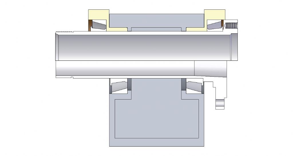

                              #447657
                              Niels Abildgaard
                                The cantilevered bearing scheme can also be applied to my very well made WM250 lathe with its lousy 62mm bearing bores.
                                Spindle outside diameter can be 55 mm and hole through 45- 46mm.
                                This is better than all other lathes with 62mm bearing holes were it must be less than 40mm.
                                What does readers think will be max value for mankind?
                                Edited By Niels Abildgaard on 19/01/2020 20:53:00
                                Edited By Niels Abildgaard on 19/01/2020 20:59:45

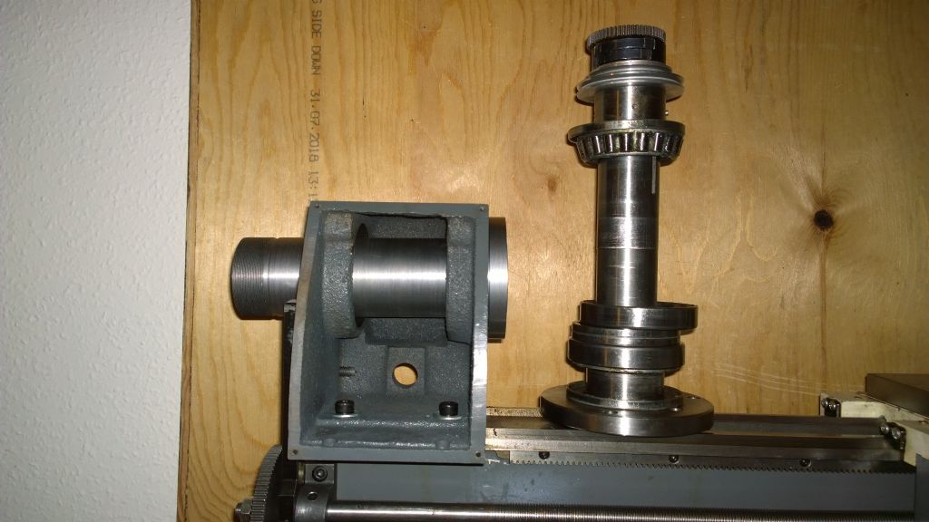

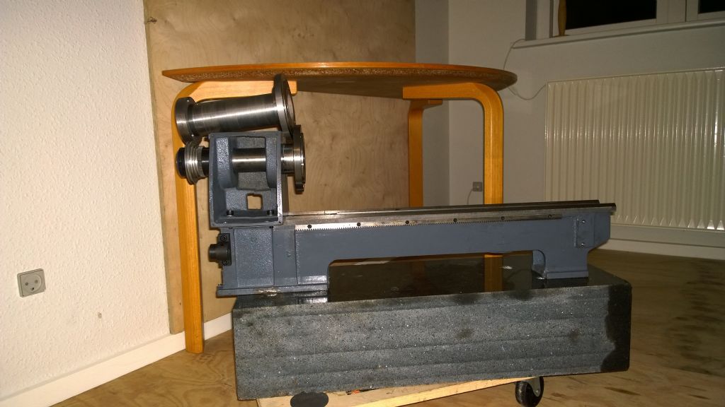

                                #467963
                                Niels Abildgaard
                                  In spite of Corona it is still pleasant to show the Chinese how lathes can be improved.
                                  My 210 lathe with 38mm hole will get a 50mm hole spindle that is made on my new 250 lathe with 27mm hole and MC4.
                                  I made two copper-brazed rawlings and they were turned on the 250 as close to headstock as possible.
                                  first picture shows one of these new spindles in place but waiting for new bearings.wp_20200426_002[1].jpg
                                  Edited By Niels Abildgaard on 29/04/2020 21:12:25
                                  Edited By Niels Abildgaard on 29/04/2020 21:14:30

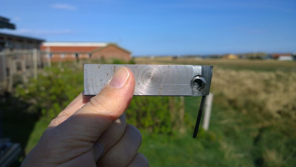

                                      #468018
                                      Niels Abildgaard
                                        The Battle Ship is a tangential holder for 2 times 2 mm carbide.
                                        I use it for more than 90% of my swarf.
                                        On a clear day I have line of sigth to New York
                                        Edited By Niels Abildgaard on 30/04/2020 08:27:58
                                        Edited By Niels Abildgaard on 30/04/2020 08:28:54
                                        #468022
                                        Niels Abildgaard
                                          The 210 big hole lathe is so miserably manufactured that I will ask it to leave house when it functions.
                                          My new 250 lathe on the other hand is nicely made and can stay.
                                          It uses two 45-75mm tapered bearings and I will make a new spindle looking something like this:

                                                      A box came this morning from Pilzen with a 210/38mm hole lathe bought for 780€ via Amazon de.
                                                      Two days late in Corona time is OK.
                                                      It got power and ran very well and everything else was OK and well made.
                                                      An hour later it looked  like this:
                                                      Plan is to put a bigger spindle in and power it with a 1.5kW/3000rpm sewing machine motor.
                                                      I am still looking for a simple yardstick  of hobby lathe performance.
                                                      Edited By Niels Abildgaard on 20/11/2020 18:41:19
