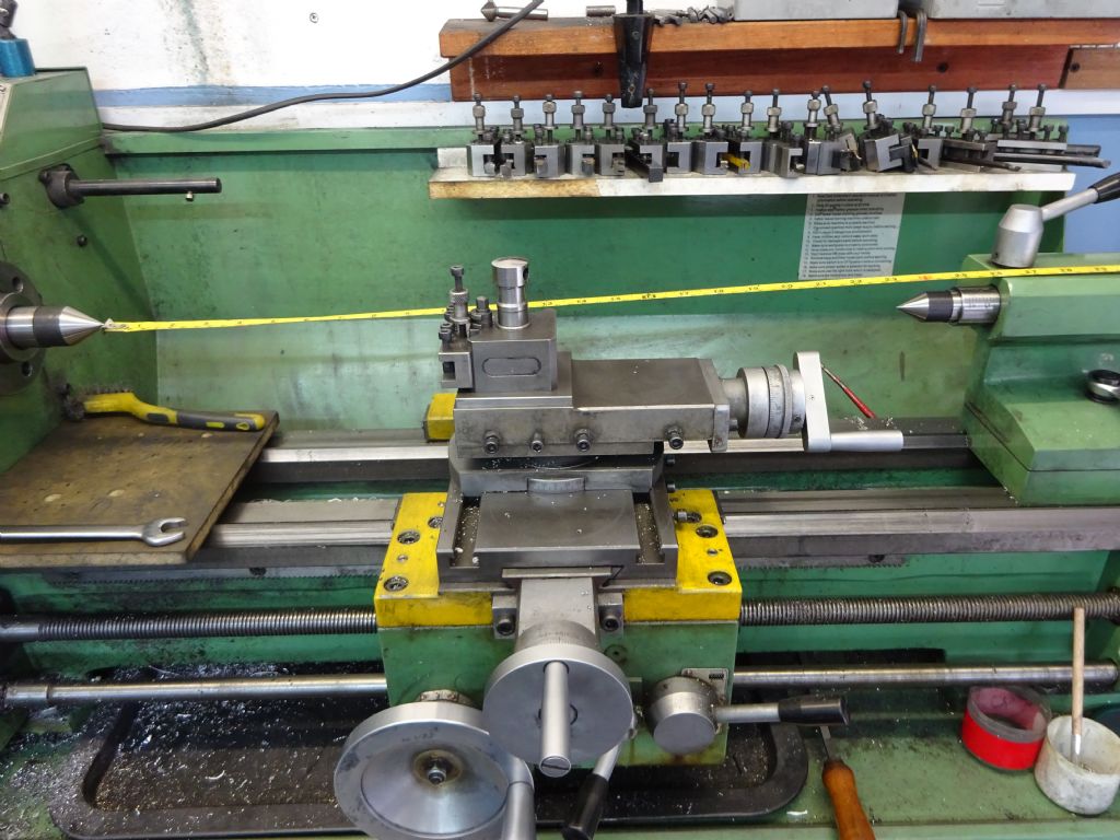

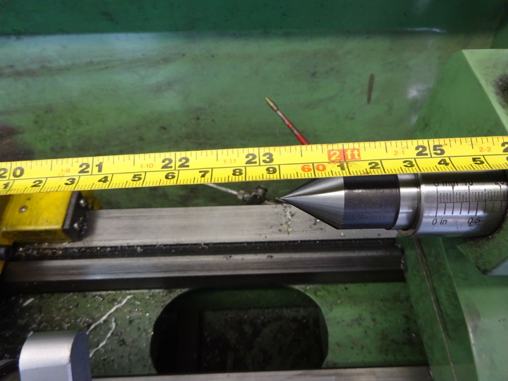

                                    #301164
                                      Lee, before you go chasing too many 290 size lathes how much of that 700mm do you actually need and how are you going to hold/drive the work and support the tailstock end?
                                      Although these machines are sold as 700mm / 28" between ctrs they would better be described as 700mm between sockets, without hanging the tailstock off the end of the bed this is where the 700mm comes
                                      Measuring point to point you get more like 600mm
                                      Admittedly the supplied ctrs are a bit long and some length could be gained by machining up soft ctrs but if you were hoping to drive one end of your work by holding in a chuck and using a rotating ctr at the other end then you won't be working with a 700mm long bit of wood!
                                      Edited By JasonB on 04/06/2017 19:51:46
                                      #301169
                                      Lee Goulding
                                        @leegoulding74917
                                        Hi Jason
                                        Thanks for the great post and 700mm is oversize but 500mm wouldn't be enough and I would support using a live centre on the tail stock
                                        The 290 are the only lathe I can find with bore size and centre distance without search for a decent used English lathe that's within budget and I like the guarantee and delivery of a new lathe which is somewhat ready to go when it arrives
