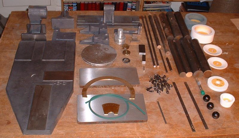

      Our club has been donated a Kennet Tool and Cutter Grinder like this http://www.lathes.co.uk/kennett/ its complete with all the bells and whistles except for the belt which is no problem and the grinder wheels. So the ? is does any one know the correct size of wheels for the grinder and a supplier.

          I bought the complete kit from MES and the wheels came with it. I can measure them up if it would help.

              The wheels that came with the kit are:
              1 off 100mm x 40mm straight cup Green grit – code number GC80-K42
              1 off 100mm x 40mm straight cup white aluminium oxide
              1 off 75mm x 10mm plain disc white aluminium oxide
              1 off 50mm x 25mm taper cup white aluminium oxide
              2 off 80mm dish white aluminium oxide
              The wheels are all 12.7mm bore and 80 grit and labelled Consort. The white whels are all coded WA80-JV1.
              The motor that I used was one I had to hand and is 1440rpm. The small pulley is approx. 1.5" diameter and the large approx 5.2" diameter giving a ratio of approx. 3.5. This will give a spindle speed of approx. 5000rpm.
