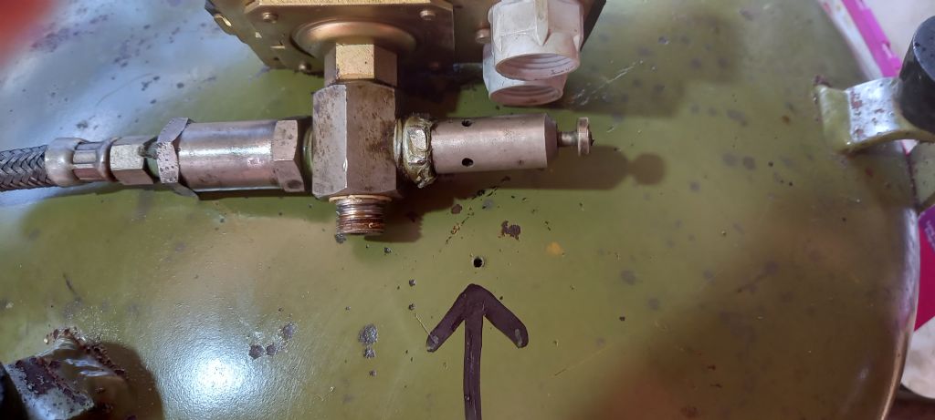

                      Hello all,
                      On this JUN-AIR compressor any idea what the part on the right is,its not the adjustment for pressure as that is inside the black box that the electric leads are held.
                      This arrow shows the pin hole, shame as using a pointed tool it feels solid all around the pin hole.

                        Bob
                        I'd guess the part on the right you refer to is the safety valve. Knob / screw on top to set pressure.
                        That pinhole looks awfully like a drilled hole to me. Complete with characteristic rise round the edge due to a self tapping screw being bunged in. Rus pinholes are, in my experience, generally rather ragged in appearance.
                        Folk have been known to put self tapping screws into air tanks to hold cables et al.
                        I've given up on thinking "No one could be that daft.", regardless of the situation.
                        Clive

                          I put a scriber in the pin hole and wiggled it around that's why the hole is raised Clive.

                            The tank MUST BE SCRAPPED it can not be repaired ! the item on the right is a safety valve. Noel.
