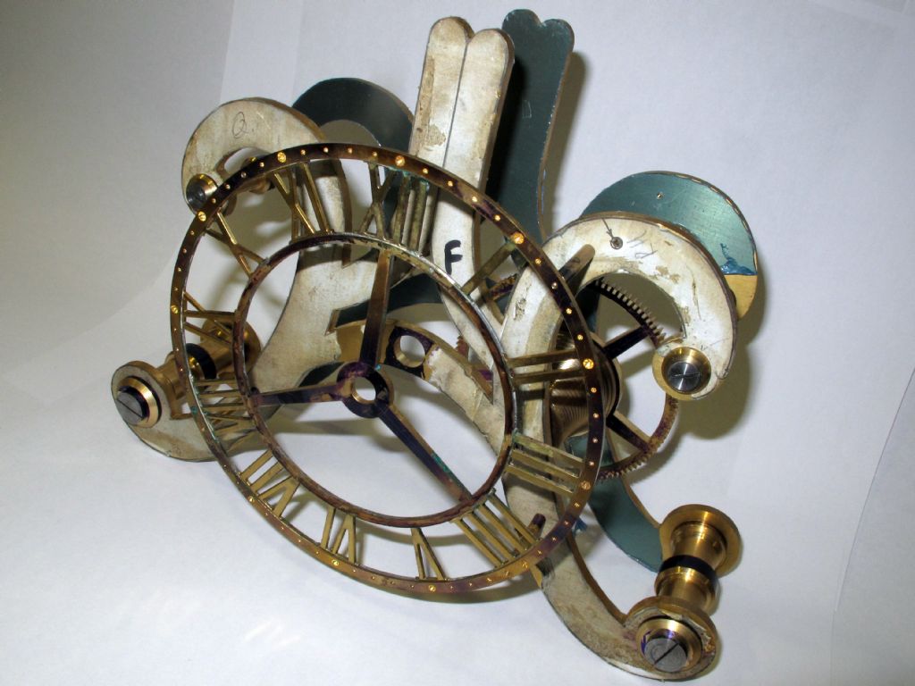

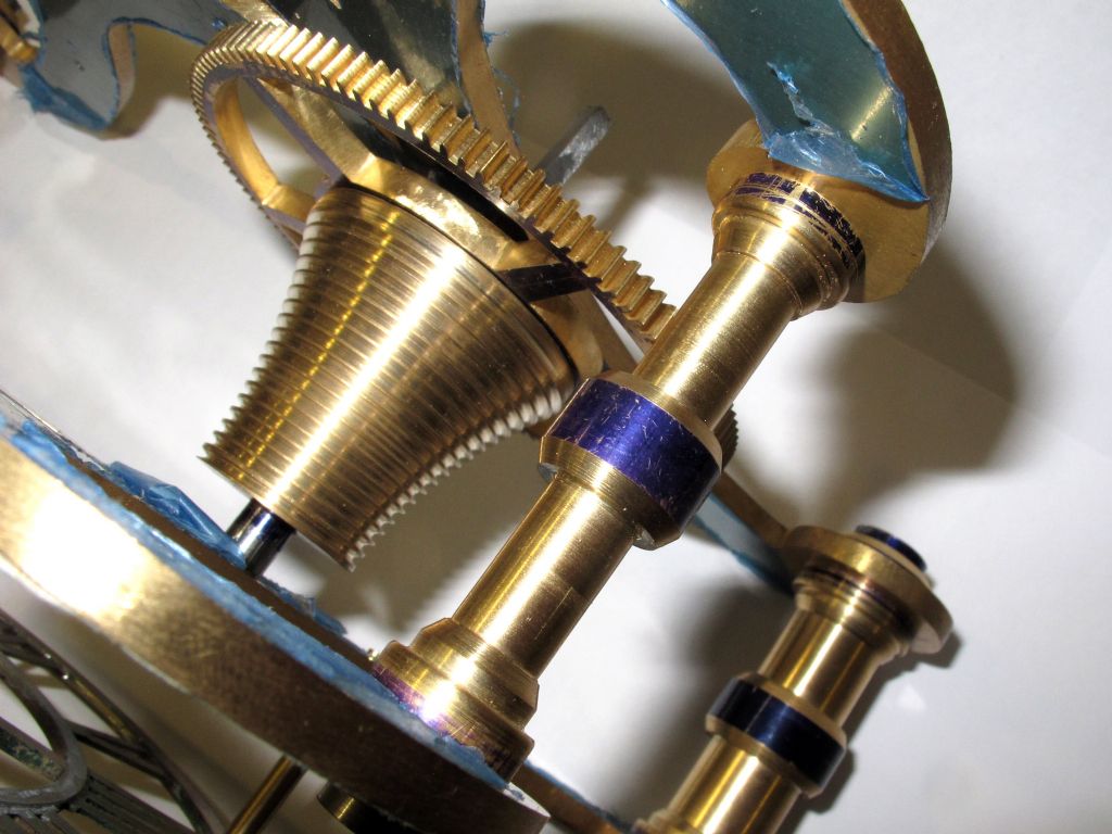

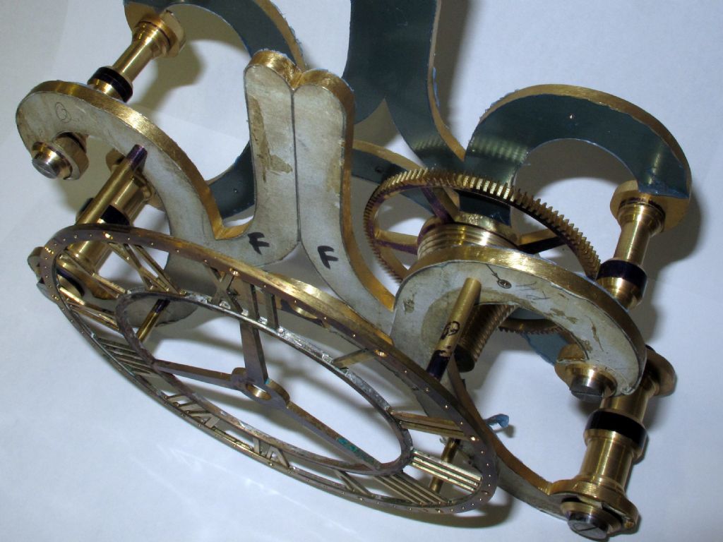

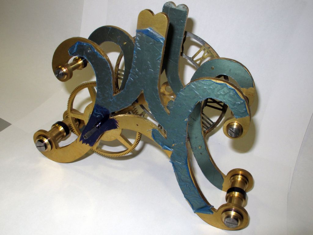

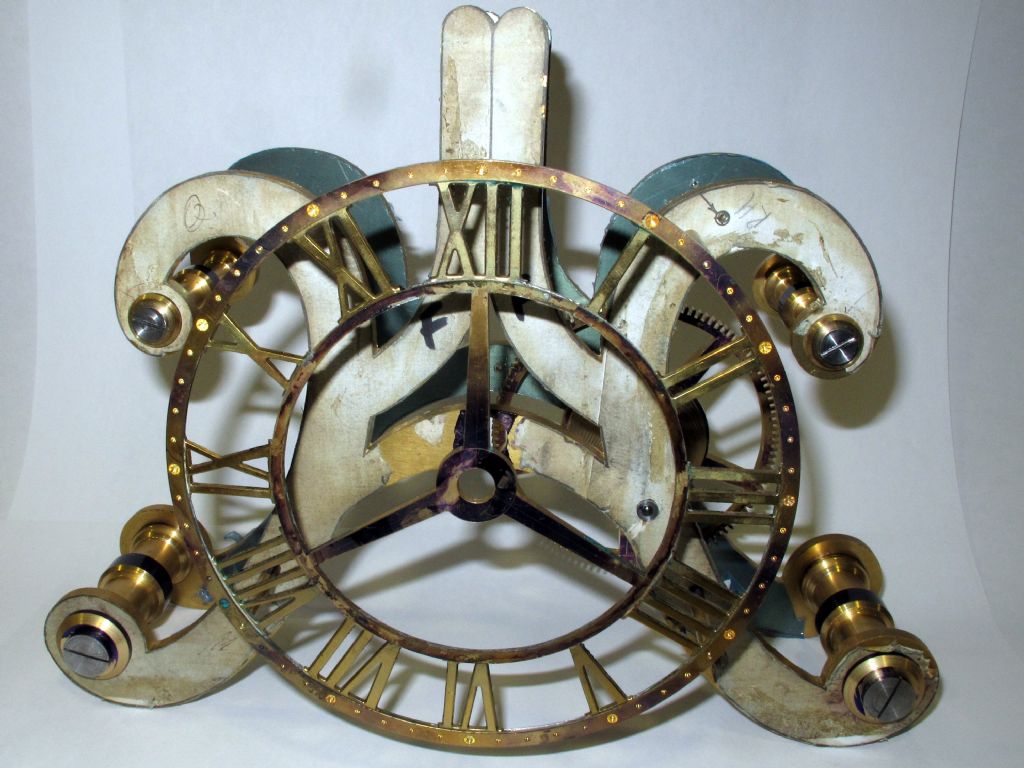

                                          As promised please see current photos of the Strutt clock build to date, I've now also made the main barrel and have that ready to plant in the plates in the next week or so…..hopefully
                                          Regards
                                          Andy Read
                                          #423979
                                          Marcus Bowman
                                            @marcusbowman28936
                                            Andy,
                                            That's good progress, and its nice to see the dial too, as that, together with the frames, gives a real sense of what the finished clock will look like.
                                            I look forward to reading about, and seeing, progress.
