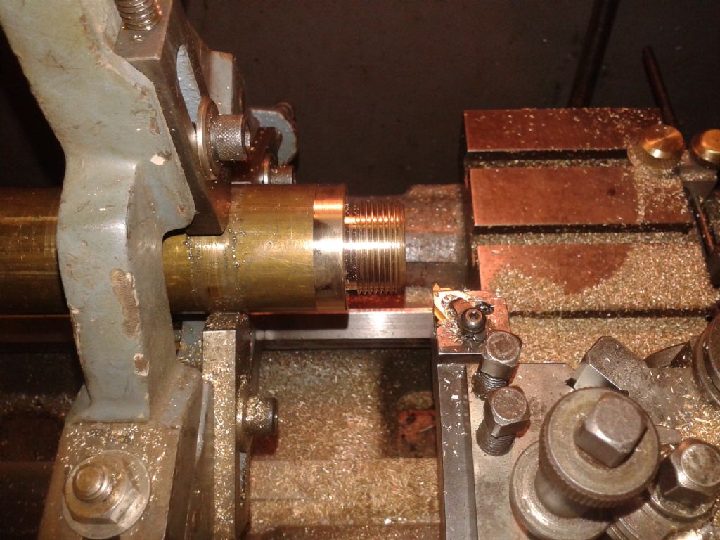

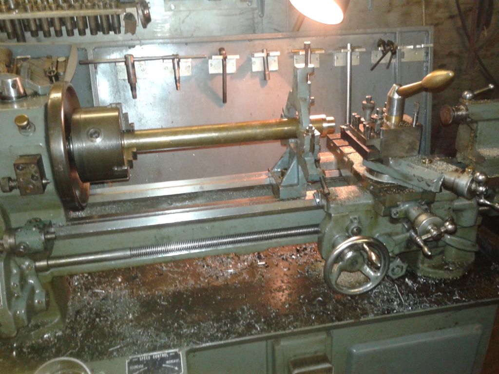

          I do a lot of work with the fixed steady on my 20mm spindle hole Boxford.
          No biggie working at the tailstock end.

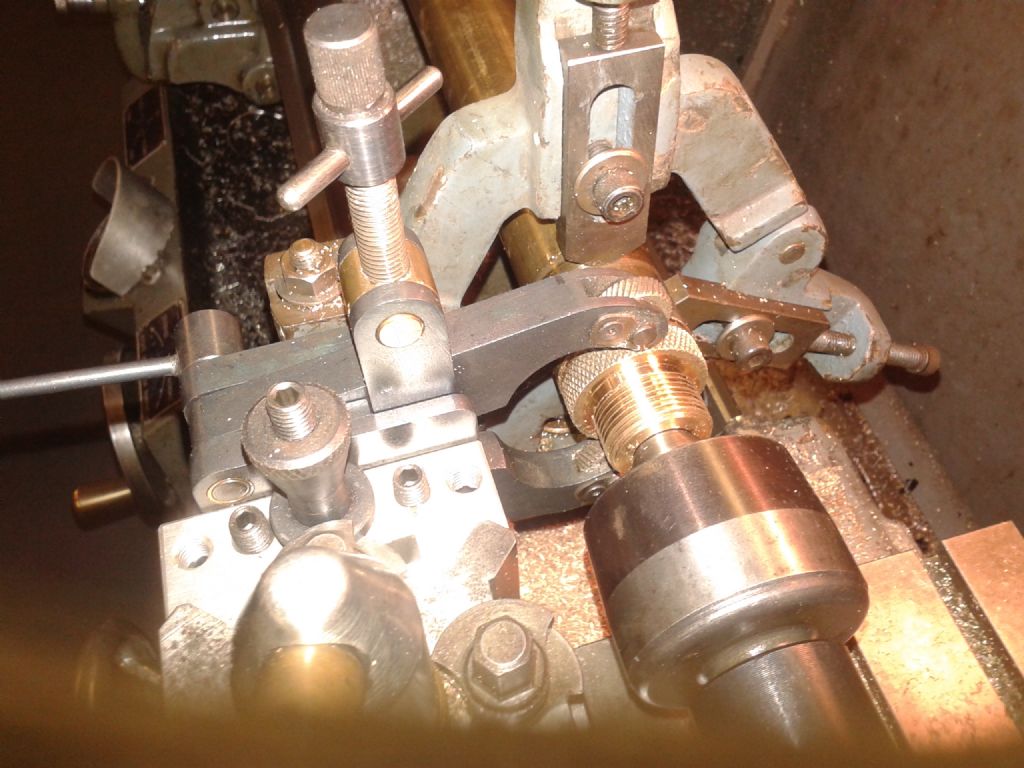

                027.jpg029.jpgPosted by Neil Wyatt on 10/08/2019 21:20:11:
                I've used the full 52mm cpacity of my steady a few times. I even had to 3D print a 3 1/2" steady for one job, obviously light cuts…
                Yep 2" brass in the pic.
