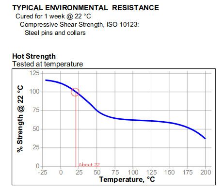

                              Nick, look at the Hot Strength Curves, 648 stays near full strength for longer, 638 drops off rapidly before leveling out at just above half strength. Also heat aging is better for 648

                                    Where I am still puzzled is that the graph for %strength at 22C for 648 shows this to be more than 100% at 22C?????.

                                        Posted by Nick Clarke 3 on 07/03/2019 11:42:17:
                                        There are lies, damn lies etc etc I think!
                                        Do you mean this one Nick? – it looks OK to me:
                                        Very educational this forum! I hadn't realised the strength of a Locktite might drop rapidly over a relatively narrow range of ordinary temperatures, then hold steady from 60C to 160C, before falling off quickly again over that temperature. Using Locktite 648 on a hot machine it would be wise to expect the joint to be less than 60% of theoretical strength. No doubt dirt in the joint would weaken it further.

                                          Posted by SillyOldDuffer on 07/03/2019 12:21:57:
                                          That is the one for 638 which seems OK – it is the one for 648 that I don't get
