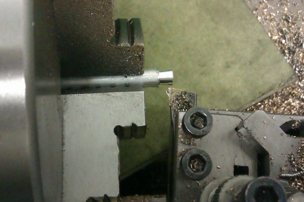

      Can anyone help me please I want to make a bellmouth reamer with a radius of 110 degrees as I don't have a cutter grinder to grid the correct shape on a piece of tool steel I want to turn down a piece of silver steel and braze it to a mild steel shank. But I don't know the correct clearance or how to shape it after I have turned the silver steel to the right diameter.

                Hi David i don't realy know how you mean by your method but I will try to explain what I am trying to do.I am making cones to fit in a steam injector. I have already made the taper reamers to produce the taper holes but at the begining taper it as got to have a curved lead in like the front of a trumpet. The tool required to do this as got to have a radius of .110 inch which will convex in shape to produce a reamer that is concave to cut the curved shape at the entrance to the taper hole.

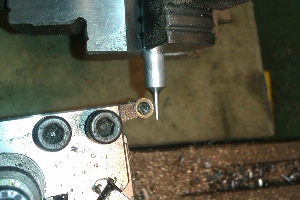

                  Ah thats better the radius expressed as a length not an angle I can see what you mean now and your methods.
                  Easiest way would be to put a bit of 1/4" silver steel in the lathe, face off and then set your topslide to cut an angle of say 10deg. turn say 1/4" length of the bar to this taper until the end is 0.220 and getting smaller as it gets nearer the chuck. Now part off the end 1/8" thick.
                  This will give you a disc 0.220" dia with clearance all round, solder to your MS shank and you now have a round tipped tool with the correct radius on teh end that looks like a lolly pop.
                  Now use this tool to turn your taper reamers and it will give the correct flare at the end, trying to make just a straight taper reamer and then another for the bell will not give the smoothest transition.
                  J
                  EDIT
                  turn the silversteel like this and part off the end, click to see it bigger
                  Imagine my tip is that disc soldered to your shank, turn the taper & belmouth as one then use to make the reamer

                    Hi Jason that is just the job a picture is worth a thousand words.
