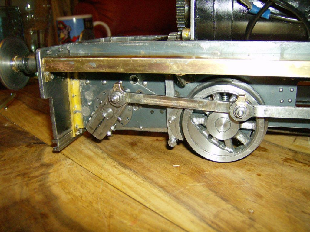

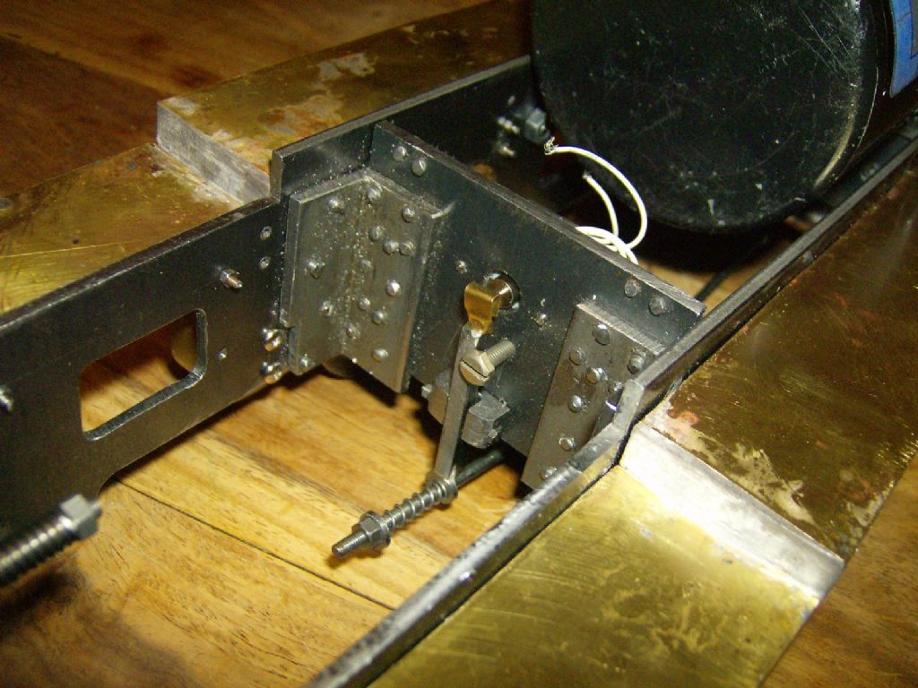

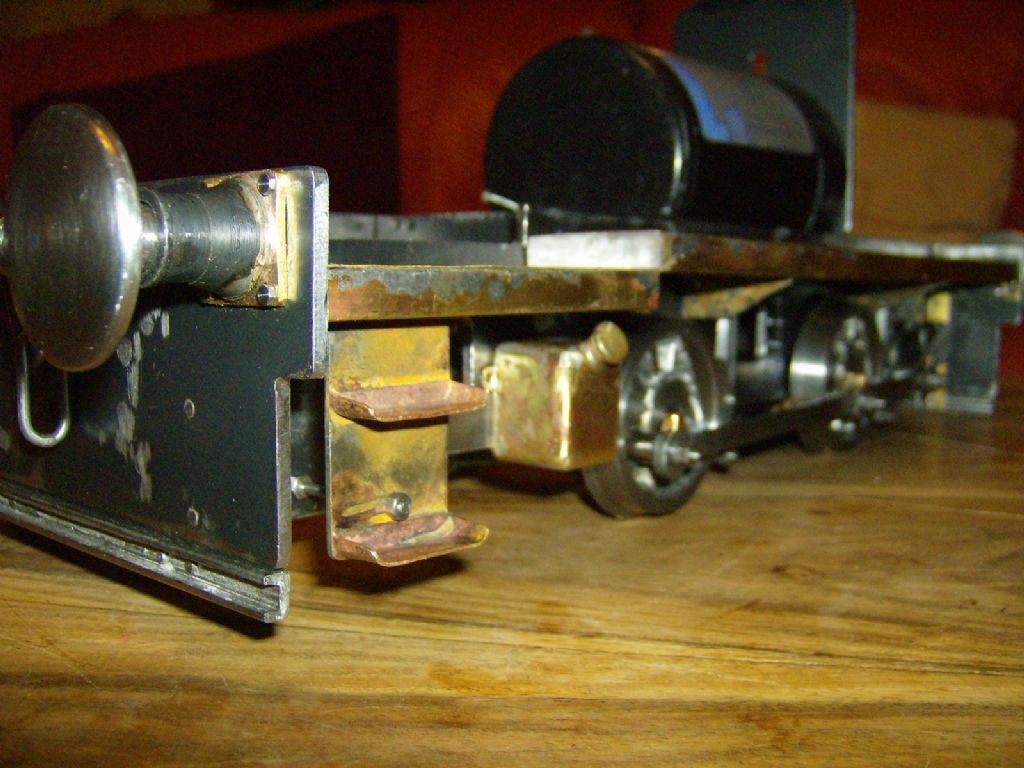

          From such small beginnings… not quite a might oak, but I now have a virtually complete chassis. I tweaked the connecting rods a bit (ok, I made two eccentric bushes to correct slight length errors). I haven't fitted the strong springs yet, as I don't yet know final weight. I need to rethink the brake gear as the front cross bar fouls one of the drive gears!
          A general view from the front:
          other bits
          And from the back (I like the steps, with their support rod and the sand tank from sheet brass):
          Back
          This is a detail of the crank, with dummy rivets around the 'hydraulic gearbox' – still some countersunk screws missing and to be filled. The running board has a frame from brass angle and steel brackets silver soldered up, and is the bit I struggled to solder a flat plate on top of:
          Chassis 3

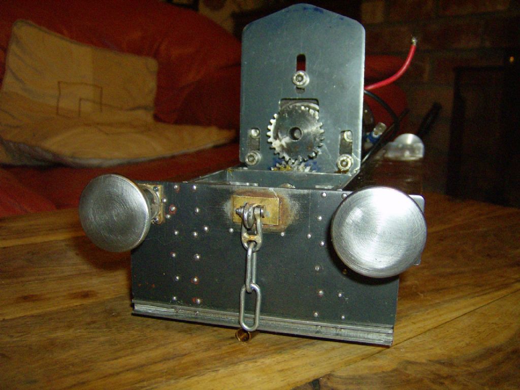

          This is the front – I had to remake the plate in the previous picture, it was too narrow:
          Front
          This is the gearbox, with four home cut gears and bevels from a burnt out angle grinder. Note the slotted motor mount so I can change the gear ratio if it is over geared.
          Gearbox
          And this is the solenoid for the brakes. It will just pull them on gently at the same time as a relay shorts the motor for back-emf braking:
          Brake solenoid
