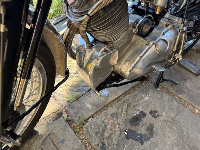

      i want to make a quantity of tommy bar nuts and bolts like these
      IMG_8127
      I’ll be using 1/2 bar with a 6mm tommy bar how to hold the bar in?
      on the sample i have theres no sign of being pushed into an undersized hole,no sign of soldering..
      how would you do it?

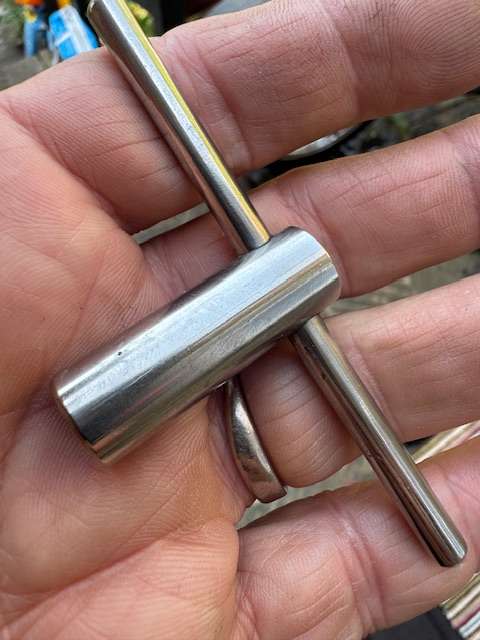

                              Right all made now and fitted…I decided to upset the middle of the tommy (why is it called a tommy bar?) and then some studlock…lets see how long the vibrating machine makes them last
