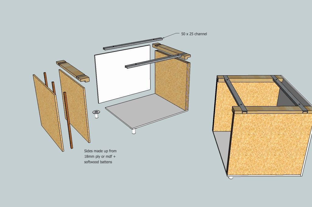

      If all goes to plan I'll be buying a new milling machine (Warco GH Universal) soonish. It'll be sited in a cellar with a low vaulted roof, which doesn't give enough headroom (by about 2.5 inches) for it to be mounted on the stand Warco offer. So I'm thinking to bench mount the thing – I'm not worried about it being a bit lower than design because I'm below average height myself, but I'm wondering if a wooden bench will be strong enough. The machine itself weighs 320kg – I am thinking to make the bench by laminating 4×2 redwood, so a 4 inch thick top and 4×4 inch legs. Trouble is I have no idea how strong wood is! Has anyone out there done anything similar and could advise?

              I don't have my little civil engineers pocket book with me at the moment, but assuming that your table is going to be about 1000 x 800 mm, and the mill weighs 320 kg, I don't think you have a lot to worry about.
              Using **LINK** as a rough guide (its really intended for bookshelves and the like) the deflection is well within acceptable limits – 0.013mm/305mm sag compared with the acceptable limit of 0.51 mm/305mm.
              The only thing I would be slightly concerned about is seasonal movement. If you intend to laminate a solid top 800 wide from timber with a nominal depth of 100mm there will be movement, with both the width and the depth changing with the ambient humidity levels. Your bolts will become loose when the timber dries out, and the hole positions will move as well. You could counter the width-ways movement by cutting slots rather than holes.
              I think a better solution would be a couple of pieces of steel channel to mount the mill, and use the timber just to fill the remaining gaps in the top (in which case you could use something much thinner as it wouldn't be load-bearing. The 4×4 legs will be fine – timber doesn't move much along the grain and the size is much more than adequate (but don't forget the diagonals to stop it racking, or maybe a plywood back and sides). To be honest, you could probably build a strong enough base using just 18mm flooring grade plywood and dispense with the softwood altogether – you wouldn't need to worry about timber movement at all and you'd end up with a useable cupboard space.

                              You need to be careful to cope with the sideways wobbles produced when the tool is not central – ie its C of G is not in line with the spindle. If your proposed bench is as in the sketch, you will find that it will wobble at the floor supports, and the sides at different rpm. Diagonal bracing firmly fixed at both ends will help, both across the design and at right angles to it (ie in both the x and y planes) and screwing the bench top to a strong wall will help too.

                                If I used mdf I would also use double sheets at the back to brace the sides. If that sort of weight tips a bit sideways for some reason a thin back wouldn't be a good idea. Actually the fact that only the back was braced would bother me.
                                I think for low cost and strength I would teach myself how to lay high density concrete blocks – not forgetting to add what I vaguely remember are called reveals at the front – walls for an L shape and I would lay all of the way across at the back. These blocks are dead easy to cut with an angle grinder and are also load bearing. The super light ones are more for insulation. If the walls were under the millers feet you could simply lay a sheet of mdf across the top maybe with checker plate or steel sheet etc on it.
