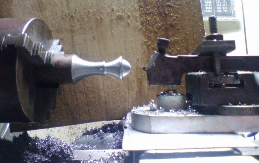

                              There is a useful variation that is well worth knowing about and is shown in the first photograph of my previous post.
                              If you are cutting maximum possible sized balls then the pivot point must be vertically beneath the lathes axis, but the cutting tool does not have to be anywhere near the axis. See photo above
                              If you crank the cutting tool around so that relative to the pivot point it is at 45 degrees to the left of the pivot then you are better able to cut a full ball without fouling the chuck (or the steady rest if you are using one). See photo above.
                              The critical thing is the distance of the tool from the pivot point, it doesn't have to be aligned axially.

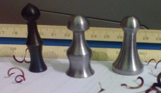

                              In order to understand how they work I've been doing some doodling using the ball cutter linked below, having a go at making chess pieces. Its been very interesting cutting bobbles on the end, and coves into the sides of the pieces with the pivot point well outside the workpiece. Cannot figure out how to attach photos.
                              Interesting that I was able to use a shear tool to get a nice finish.

                                  See proof below that I understood the instructions. Blackened pawn achieved by heating and dunking in engine oil. Am always pleased and amazed when I read something, try it …………. and it works ! Yeeha
