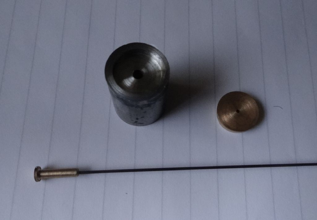

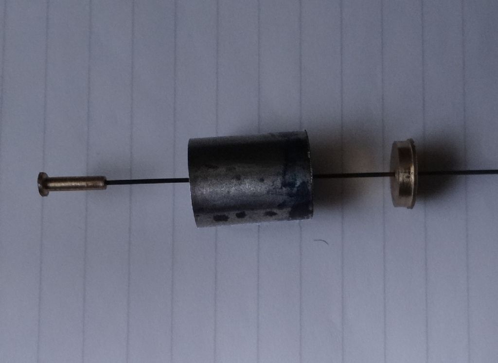

      My current project has me experimenting with a home-made pendulum clock driven by an electromagnet.
      The latest pendulum consists of a mild-steel bob suspended on a 1mm diameter carbon-fibre rod.
      The mild-steel bob has been drilled through 2.5mm and counter-bored to take the brass fitting on the right. The brass top-hat on the left takes the weight on it's shoulder. It's turned to be a sliding fit into the bob and is 10mm long. It's also been drilled through with a 1mm diameter hole to fit the carbon rod which is is super-glued in position.
      No problem making the brass parts to fit 1mm carbon fibre rod because 1mm is a standard metric drill sturdy enough to cope with my heavy-handed metal bashing.
      More challenging, I want to use the same configuration with 0.28mm diameter carbon rod and foresee two problems:
      1. Although 0.28mm drills can be bought, they're quite expensive and I can imagine me breaking several. Also I only want to drill two holes in brass, and might never need such a fine drill again.
      2. 10mm is deep for a 0.28mm diameter hole, and I can imagine the hole wandering and the drill breaking.
      Can anyone recommend a way of doing this job without me spending a fortune and/or having a nervous breakdown? (Too hot & humid this week for me to do anything frustrating.)

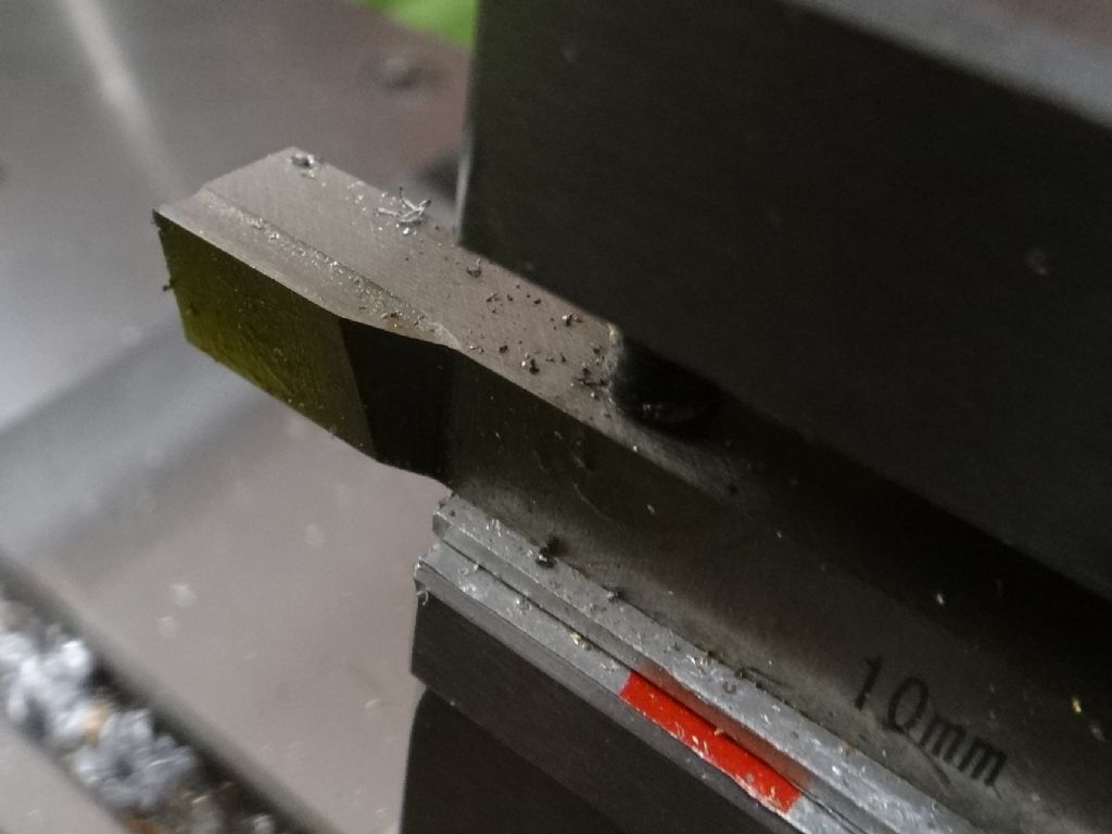

                        My first attempt at turning 0.28mm diameter over 10mm ( 11thou over 3/8 "  failed:
                        This was with a new HSS form-tool at 2400rpm.
                        Depressed, I had decided that the best way to avoid wasting money on a twist drill was to order a collet chuck and collets, and perhaps make a jig.
                        Jason has saved my bank-balance. Now he's pointed out 0.3mm drills are available, I find they're cheap! (The 0.28mm carbide drills I found were £30 each…)
                        While waiting for the drills to arrive, I'll give packing a try. I may even have a suitable hypodermic needle.

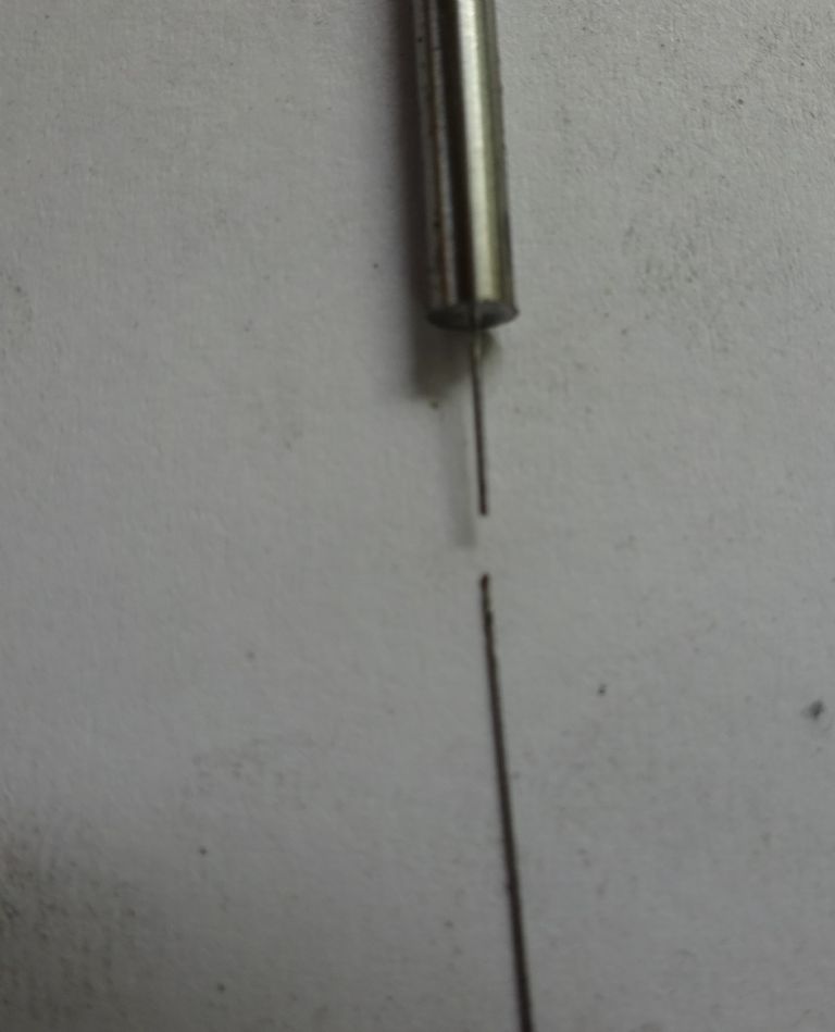

                                Dave someone has to say it, why a form tool and what an earth did it look like? Forgetting the small dia even the larger one looks as rough as a badgers, I think my dogs could have got a better finish if I had given them the metal to chew.smile p
                                So while the BBQ was warming up I quickly put a bit of 1/8" silver steel in the chuck, ignoring the old gits tale that inserts tools can't be used for fine work I stuck the tool holder with a CCMT tool in the QCTP, wound up the speed but did not bother to select high ratio so only about 1100rpm and got this. No fancy form tools or having to buy gravers and diamond wheels to sharpen them with just one of my usual tools, does not look too shabby to me.
                                Sorry it's a bit out of focus but this is the part and a 0.3mm drill bit. Part is actually 0.012" rather than 0.011" as I just quickly touch off on the 1/8" dia and used the handwheel dial rather than measuring until it was out of the lathe.

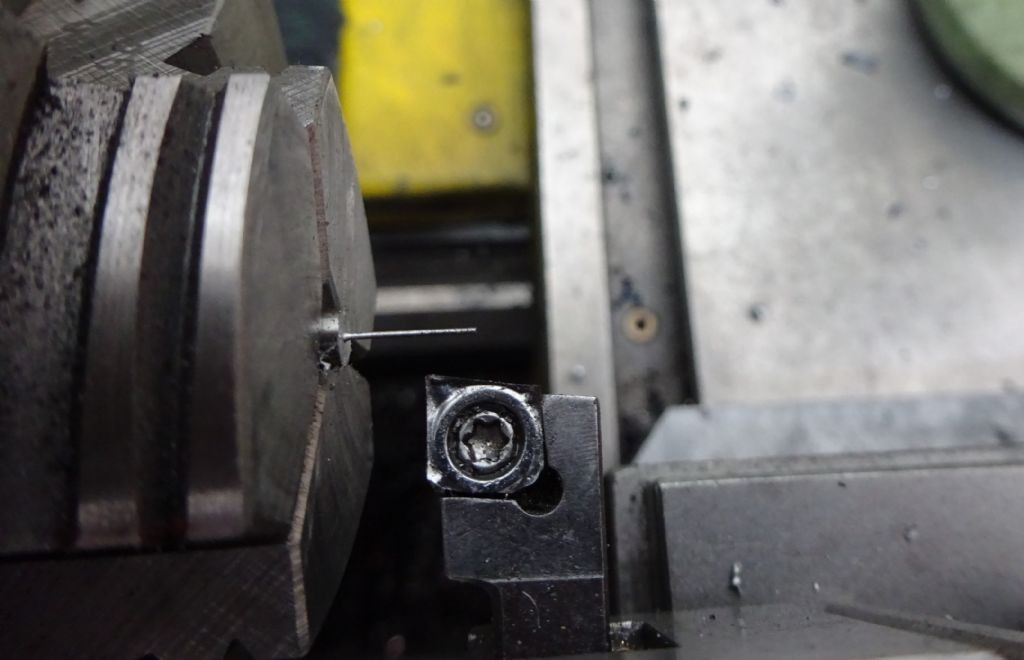

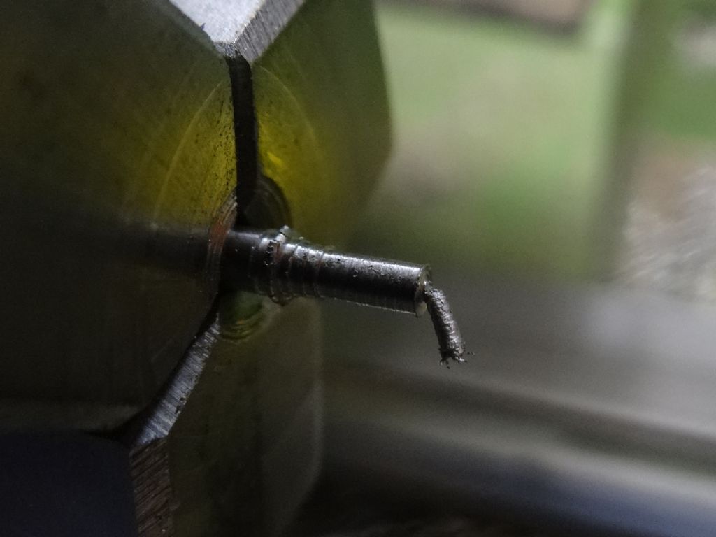

                                      I wish I was using crumbly Cheshire, then I might have an excuse!
                                      Inspired by Jason, I just tried again using two different rods in case the metal was suspect.
                                      The 'Form Tool' is a knife, not one specially shaped to cut a profile.
                                      You can just about see in the photo that it's blunt.
                                      Rather than sharpen it in my unpleasantly warm workshop, I switched to carbide inserts and failed again with two different types. The tools aren't keen to cut, and the work breaks when the cutting point digs in.
                                      I think my problem could be insufficient sharpness plus tool height not set accurately enough for fine work.
                                      Jason and I have much the same lathe. He made this:
                                      I did:
                                      Possibly one of us knows what he's doing and the other, ahem, doesn't!
                                      This has turned into a challenge. Fingers crossed I'll do better tomorrow when it's cooler.

                                            Dave, I'll have a word with Neil and get him to add thin turning to his beginners series, I'm sure he would like to show how it is donedevil
                                            Main thing is not to pussy foot about, I did that in two cuts first 60thou off dia and then the remaining 53-54thou. Did half the length that way and then the remaining so 4 cuts in total.
