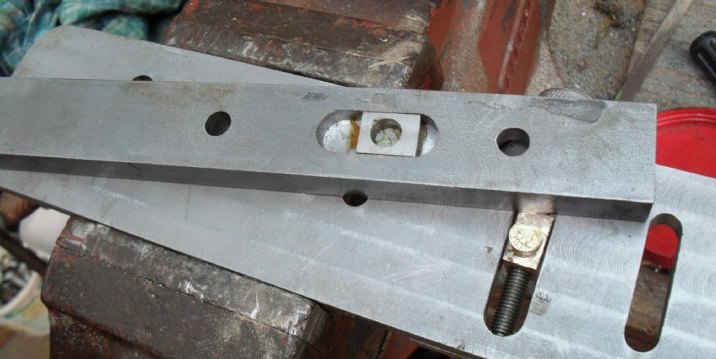

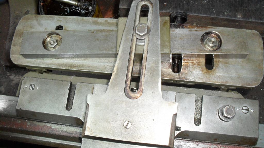

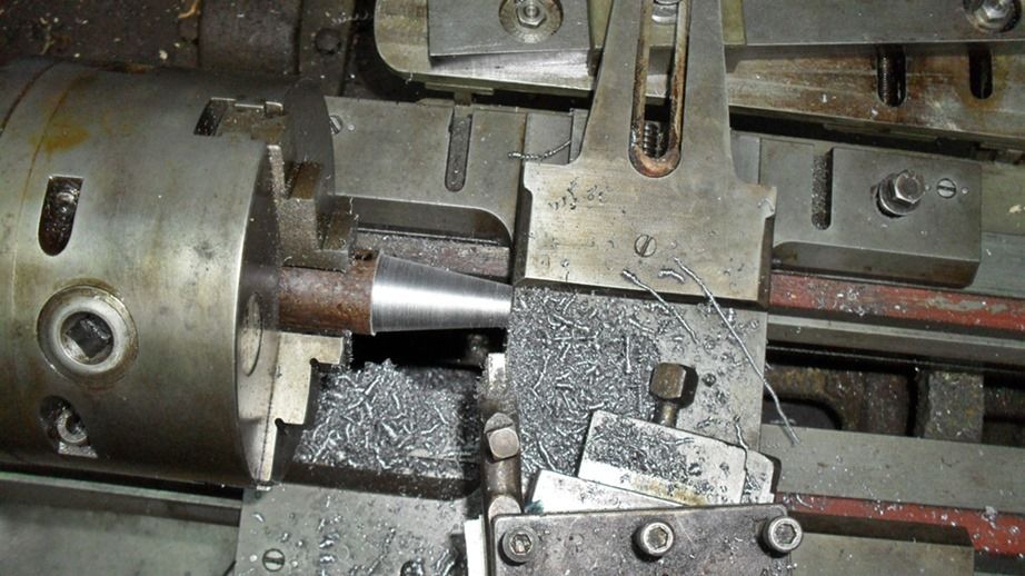

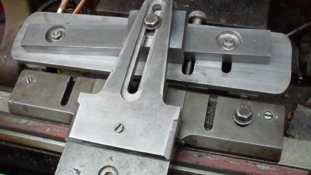

          photo5.jpgtesting the taper attachments bit of ageingI've finally got around to making a taper turning attachment for my B8, I also had to make the slotted extension to the cross-slide as the original was broken off some time in the past and it always bugged me. I did intend to make it as near to an original as possible, seeing from photo's that the main bracket & top plate are all cast as one piece made that a step too far so the bracket & top plate were made separate.
          It's complete enough to actually use it now, I just need to devise a way to add a graduation scale.
          I did a test run on a 1" bar and it works perfectly, the sliding block that connects to the slot has an adjustment gib & two screws, there is no play whatsoever so seeing it now looking like it actually belongs is very satisfying!Ready to test!
