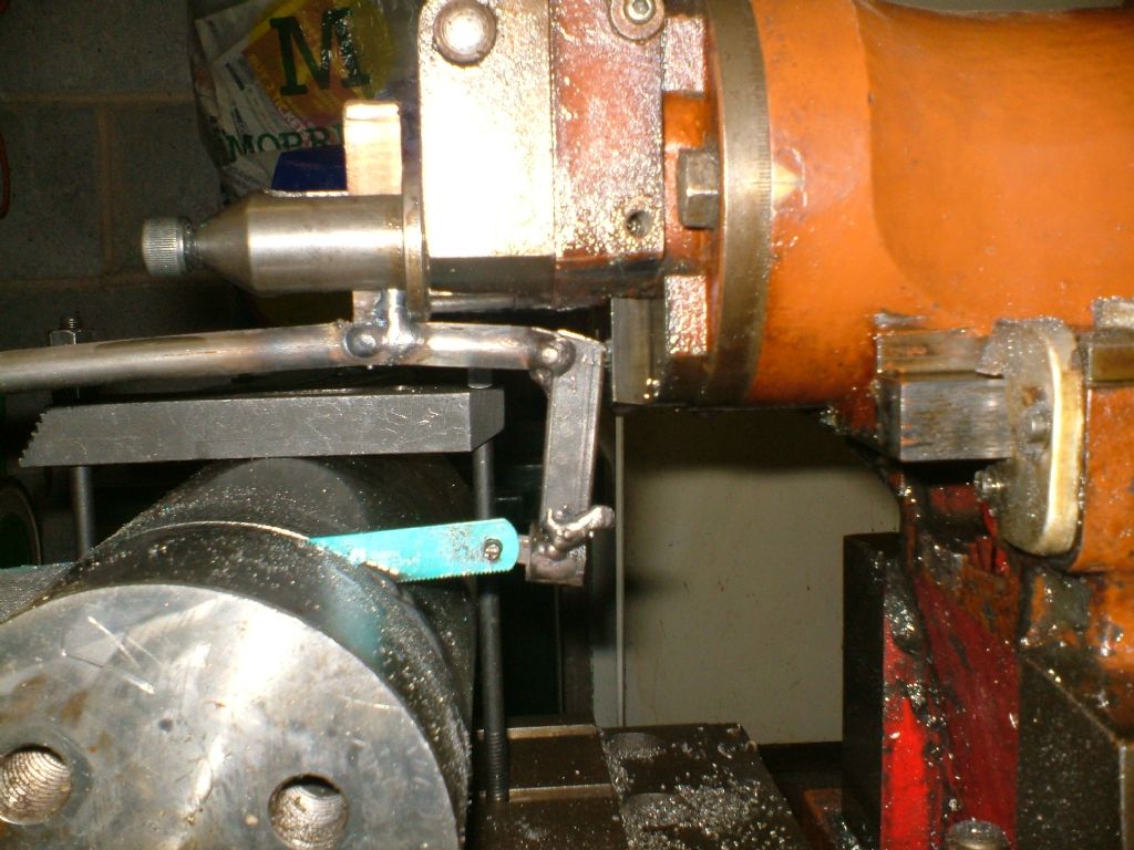

          Going to take a few days for this, slicing up a 6 inch billet of steel to make some more steel vices
          The original has been so useful I'm making at least one more

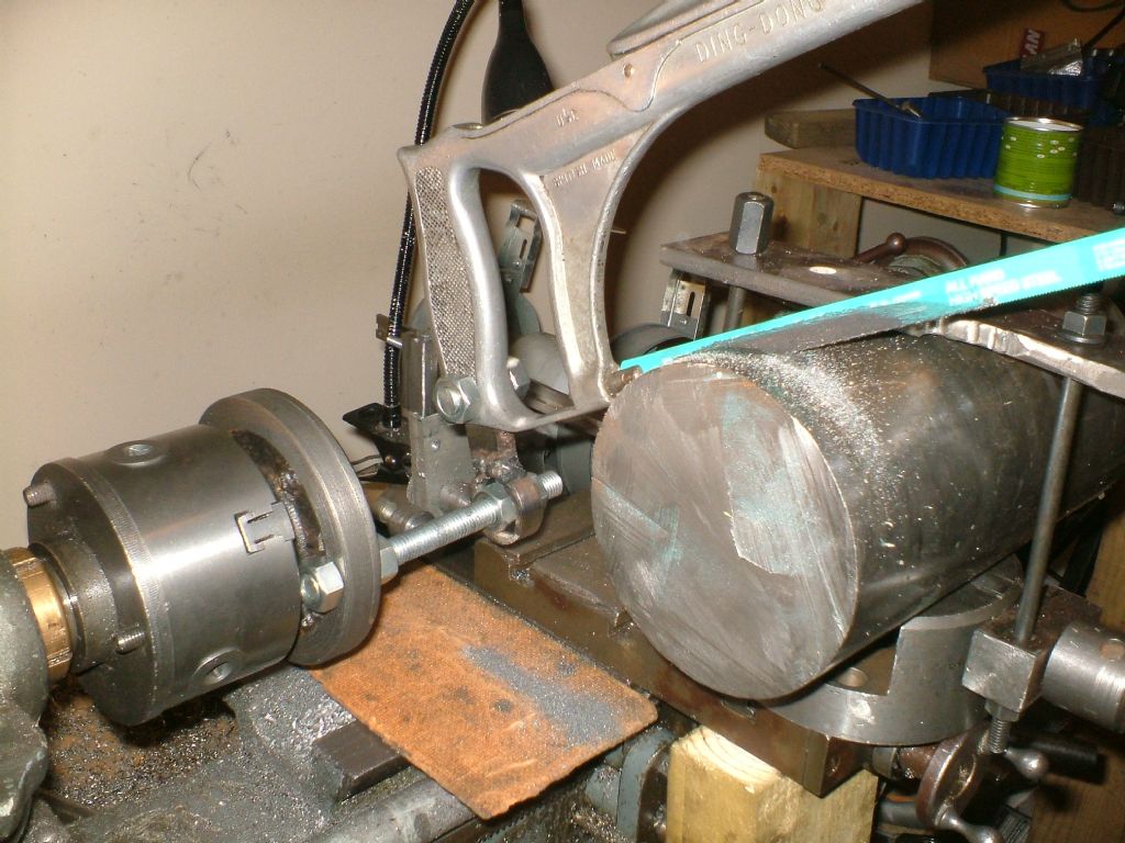

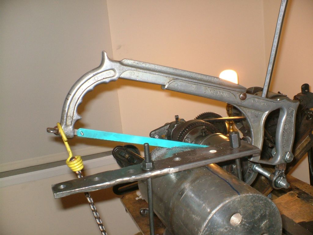

              Is that a mod to your shaper to use it as a power hacksaw. Looks a good idea for large sizes of material.
              Colin
              #186761
              Ady1
                @ady1
                It's a mod for moderate sized chopping up. This job is going to be too big to finish on the shaper, the last inch in the centre/middle will need done by hand, it's actually right on the edge of the envelope for what can be done.

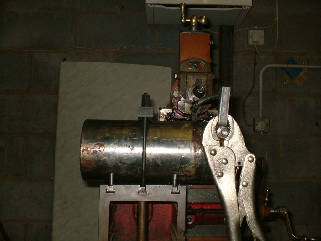

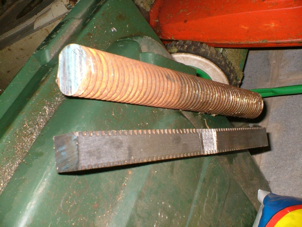

                  An extreme example of what can be done with cobalt tooling, 25 intermittent cuts per stroke
                  I need a bunch of squarebar to fabricate a dividing unit for my shaper, and I had a pile of approx 40mm threaded bar doing nothing, so…
                  I only resharpened the cobalt tool once during the entire process (3 done so far, more needed)
                  Shapers are fabulous workhorses, but be careful with them, IMO they are way more dangerous than a lathe

                          A job like the above shows me that I can now produce things like a large hex bar whenever I need it, something which has become increasingly difficult to find in recent years.
                          I have also adjusted the hacksaw to maximise the stroke, cutting off the end part for the lantern and moving it forwards by a couple of inches until the back of the hacksaw almost touches the clapper slide, this has made a big improvement over the original setup. Even a giant job now has a decent stroke
                          The hacksaw itself looks a bit knackered now after all my messing about but it gives me a proven template for making a nice tidy replacement which will work 100%

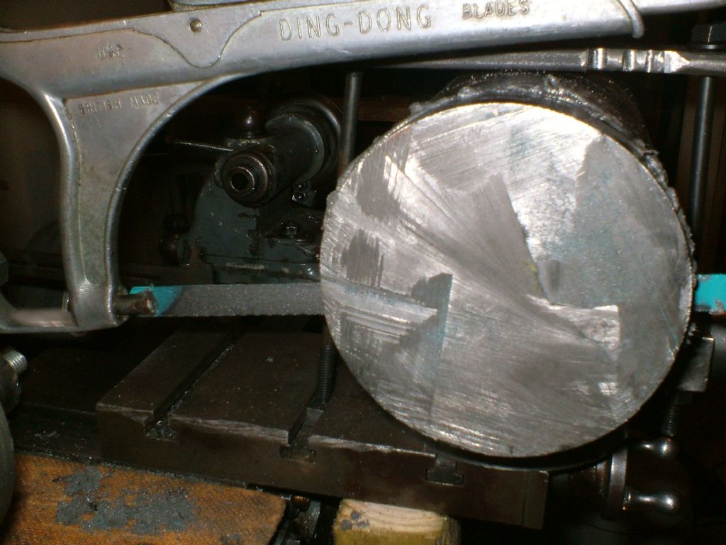

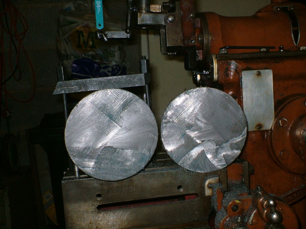

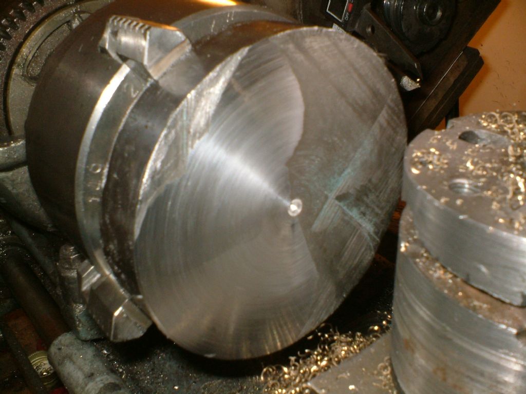

                                          Well it took 9 days and about 3 hours a day to finish that, plus 3 blades. One did 90percent of the work but there were 4 deep cuts and they all wandered once they got down to the final three quarters of an inch. That made the final cut, by hand, right in the centre, a real tuff job and I broke 2 blades before it finally came away.
                                          That made the surface wonky, so I threw it onto the lathe for a quick facing off and pushed one of my shiny new cobalt tools into it.
                                          30 seconds later I looked at myrounded flattened cobalt tool and swore gently, it was EN hardaswitchestits
                                          The carbide took it down, slowly, but it didn't like intermittent cuts at all and made too much noise for my liking so I drilled it with hss and slapped it on the shaper
                                          This time the cobalt tooling was fine and it's currently being shaved down for final finishing on the lathe
                                          It's like a machineable stainless steel and the cutting noise sounds like tearing metal, even when a nice surface is being cut
                                          The cobalt tooling didn't have a hope on the lathe, but has saved me on the shaper part of the job

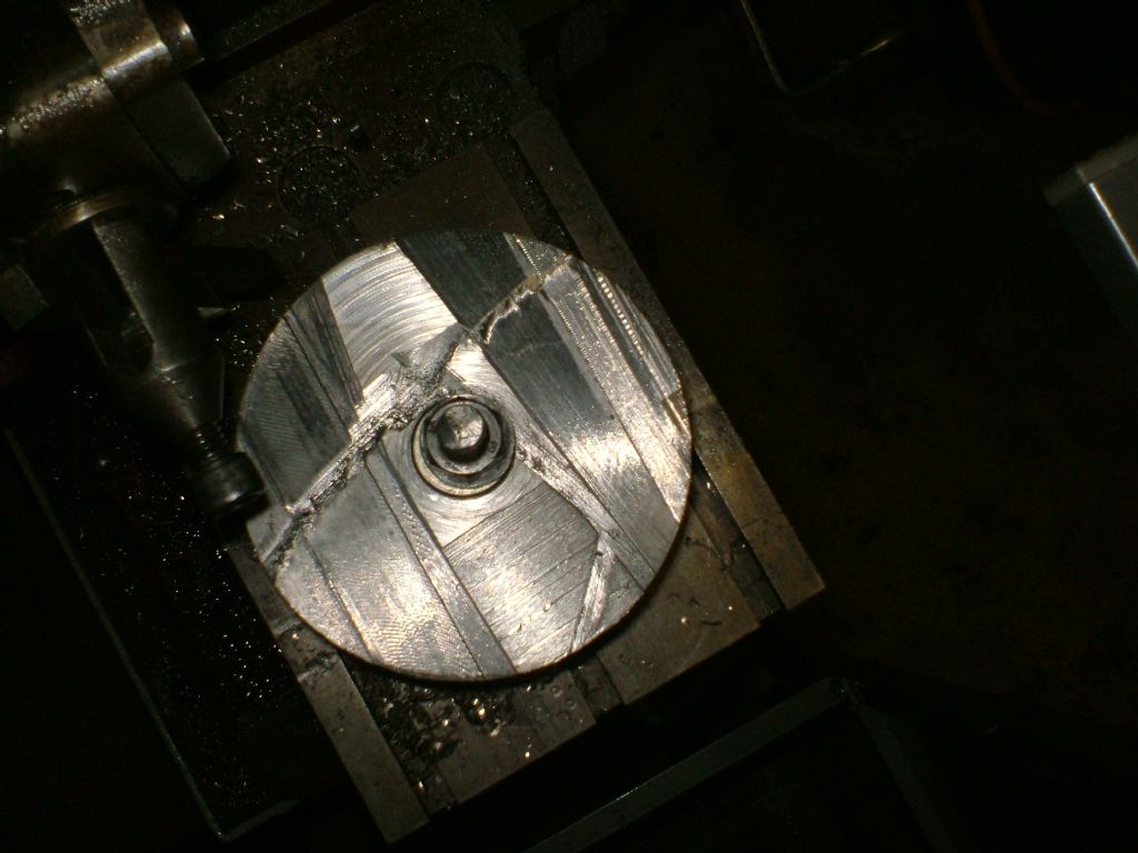

                                                      Well I had to get this billet chopped up and I wasn't going to work my shaper for 9 days again just for a slice of steel, so I returned to my old original lathe system
                                                      In the absence of a dedicated machine this is by far the least wear and tear on my equipment
                                                      The cut got nice and deep before any adjusting was needed and a slice dropped off after the third cut
                                                      Accuracy/straightness was medium
                                                      Then came the facing off on the lathe, to save me using the shaper
                                                      5% cobalt- failed
                                                      Cleveland mo-max M42- failed
                                                      WKE 45 cobalt (tuff stuff and hard to grind)- failed
                                                      They all flattened like cheap chinese HSS
                                                      It's kinda strange because it can be drilled quite easily with cheapo hss drills
                                                      Anyway, King Carbide came to my rescue, yet again, and is doing the necessary intermittent facing off on this job. Just got to watch the chips, oh boy are they hot
