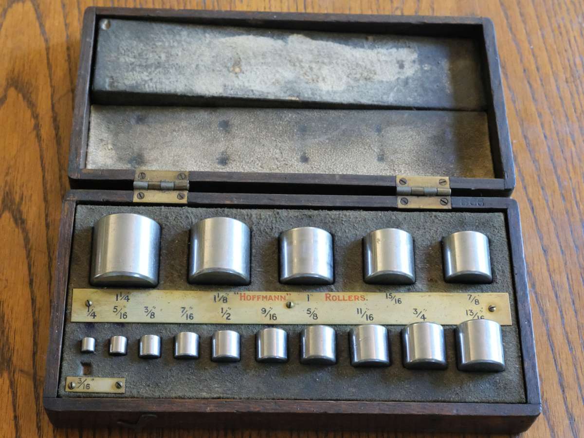

      Came across a set of Hofmann Rollers a couple of days ago. Would someone like to enlighten me as to their function and usage please and fill a gap in my knowledge.

      Julie Ann
        @julieann
        I used mine for gauging the width of the slot in an expansion link. The expansion link slot was CNC milled a couple of thou undersize and draw filed to fit the appropriate Hoffmann roller. The matching die block was then filed to fit the slot.
        For anyone who doesn’t know, these are Hoffmann rollers:
        Hoffmann Rollers
        Although they don’t look it the height and diameter for each roller are the same.
        Julie

        Nigel Graham 2
          @nigelgraham2
          You can also use such rollers for calibrating measuring instruments.

            Charles Lamont
              @charleslamont71117
              They can be useful for measuring things like the width of a dovetail (with a bit of trig.)

              Martin Kyte
                @martinkyte99762
                <p style=”text-align: left;”>Thanks for the replies, simpler than I thought.</p>

                gerry madden
                  @gerrymadden53711
                  As someone who’s first employment was at the site of the company that made these things, I have been on the lookout for a good set for a while. Sadly, the remaining sets all seem to have at least one part missing, have an excess of corrosion or have been dreadfully abused during industrial activity by people like Julie  🙂 . These poor things should never have been allowed to leave the standards room.

                  howardb
                    @howardb
                    A tidy set of these is available from G & M tools – £25 + postage
                    Set of Hoffman Rollers 80210006

                    gerry madden
                      @gerrymadden53711
                      Lots of rust staining on the lids padding, but none on the rollers. However the rollers are rather matt in texture suggesting a touch of cleaning has been going on, which isn’t good for the dimensions.

                          gerry madden
                            @gerrymadden53711
                            As far as I know, metric versions were never made.
                            As regards their use Jason, if I’m honest, I think they were more of a sales advertising gimmick, than a serious metrology tool. They certainly weren’t the most accurate rollers that could be made, and their short length is a handicap. I don’t think I have seen any with an original inspection certificate….but I may be wrong.

                                      Rather than handicap, those ones are not short for a specific reason, perhaps – such as using with a sine bar?

                                        Nigel McBurney 1
                                          @nigelmcburney1
                                          Back long ago in apprenticeship days ,the company had a set off Hoffman rollers, and could be drawn from the stores, the slip gauges on the hand could only be used with the bosses approval , his reasoning was that if the Hoffman rollers were looked after they were accurate for most purposes and quite accurate when used in conjunction with  a set of of feeler gauges to measure intermediate sizes using the flat ends of the rollers. The attitude with slip gauges was they should not be used unless absolutely necessary  to reduce wear and maintain accuracy and wo betide any one who touched and left fingerprints on the accurate faces of a slip gauge. Nowadays due the collapse of the engineering and metrication ,slip gauges have become available at very low cost,I have a good set  and due to my training I still use my rollers ,as they are useful for quick bore measurement on fractional size holes.Hoffman rollers were very accurate as I heard that they were selected from large batches of rollers.
