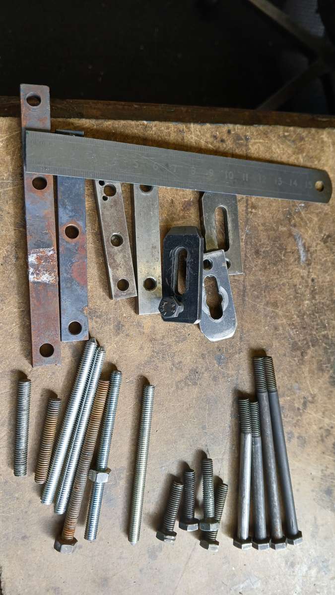

                  That must make two of us, some random bits of unknown studding from my box of M6 “bits” which were just scrap from something else. The longer bolts are all un marked only the shorter screws are 8.8 but they were free not bought for their properties. So no real need to spend money on HT and certainly no need for name brand premium prices for this use.
                  Clamps 20×5 and 1/2 x 1/4, as I use them for silver soldered fabrications as well they are a bit rusty but also well annealed/stress relieved but still don’t bend under clamping loads unless I get silly.

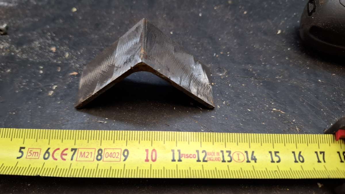

                      I have some M6 stainless studding which I guess will be fine and I fully take your points about over tightning.

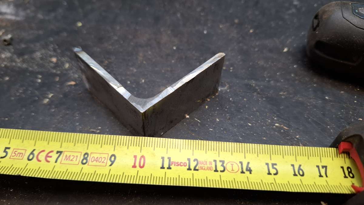

                      I’ve found some L section (50x50x3.2mm) which might do the job for the hold down clamps.
                      I’ll put up some pictures..

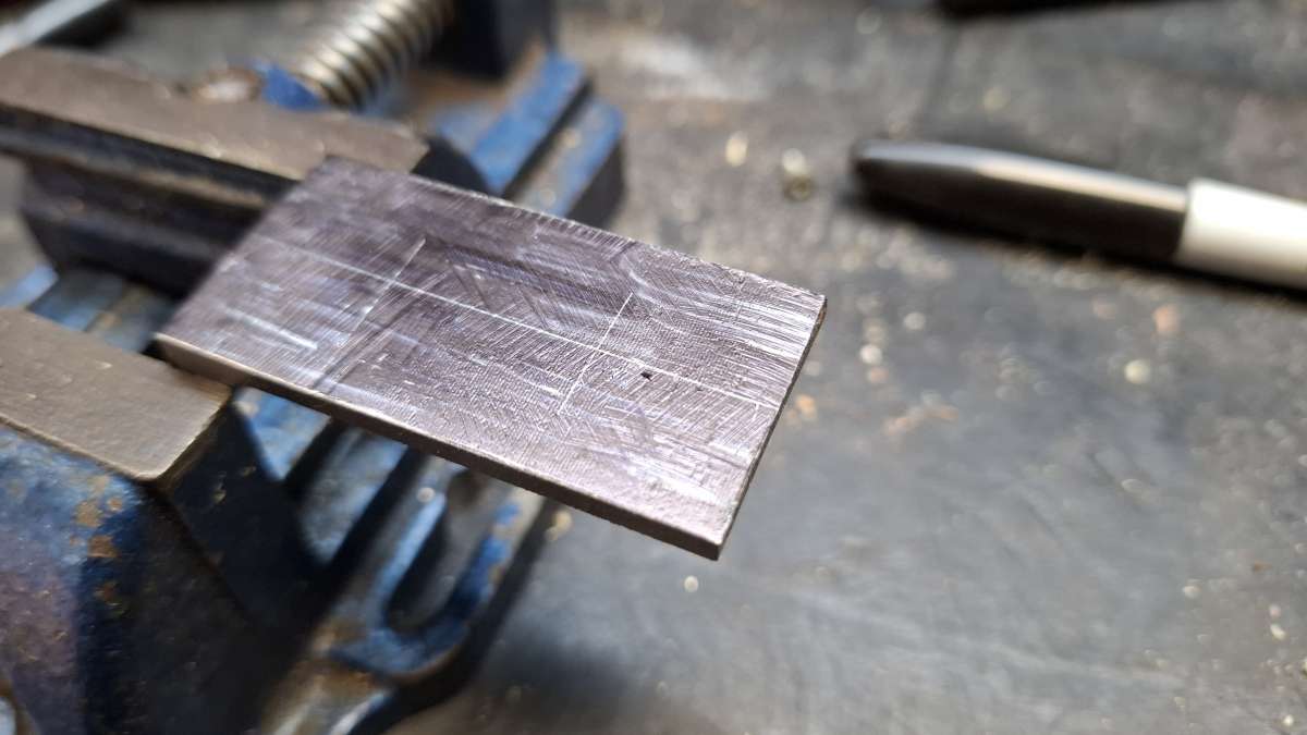

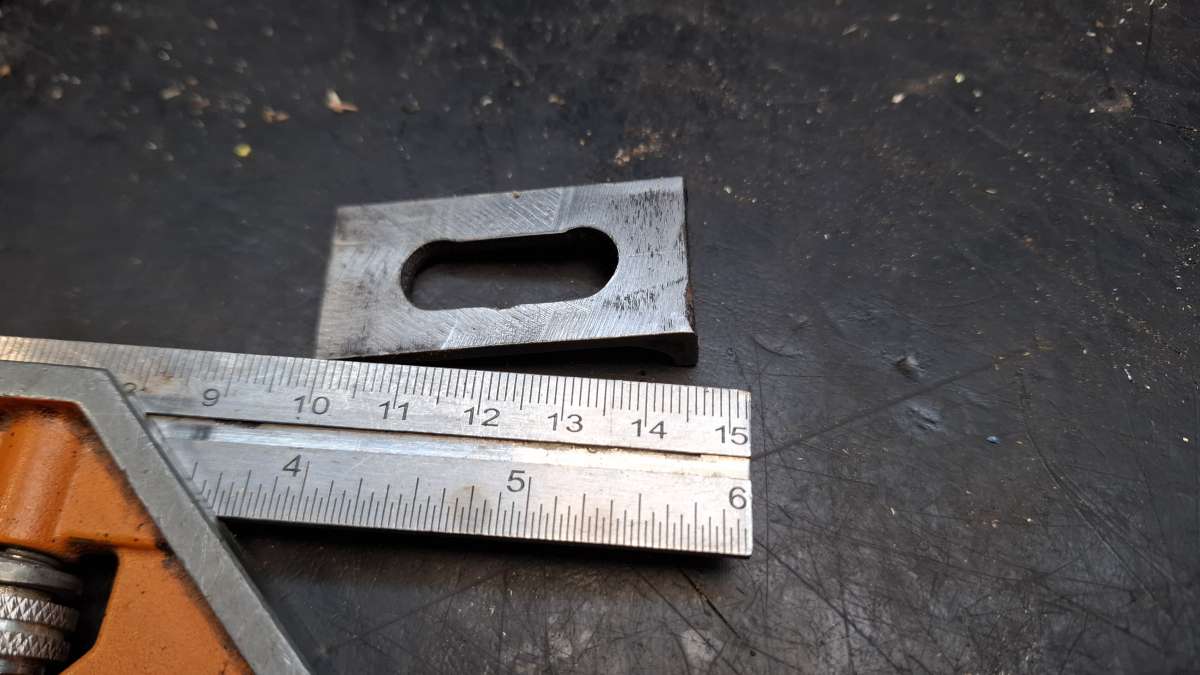

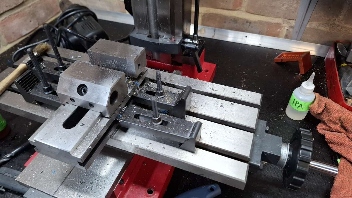

                            Please bear in mind this is my first attempt at milling…
                            I cut the steel down using an angle grinder then tried to end faces parallel on the mill.
                            Then I cut 3x M9 holes with an HSS drill bit.
                            Then using the mill, tried to join up the holes to make a slot using a 9mm cutter.
                            I was a bit reticent of trying to do a plunge cut with the cutter hence the drilled holes.

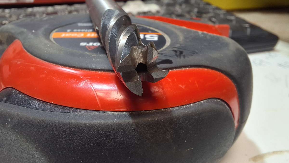

                            The cutter in question was
                            I now realize that the slot is probably not needed and a midpoint hole would do the job.
                            If I was going to cut another slot it would be narrower, maybe 7mm.
                            Using a stubby 10mm spanner, I can feel the steel starting to deform as I tighten, so thicker L section steel required?
                            20250410_12111320250410_12112120250410_13290020250410_12402320250410_13290620250410_13331020250410_14233520250410_134124

                              Hi, stainless steel is fine, but if you use stainless steel nuts with them, make sure they are well oiled, as stainless on stainless will quite easily gall and then you will not be able to remove the nut. For clamping, using stainless steel thread, it is better to use ordinary steel nuts, as these are less likely to gall, even when used dry.
                              One other thing is you should get your clamping bolt as close as possible to the item you are clamping down. Your clamp with the slot that you have made, is too thin for the length of the slot, and you would’ve been better to have just used holes.
                              Regards Nick.

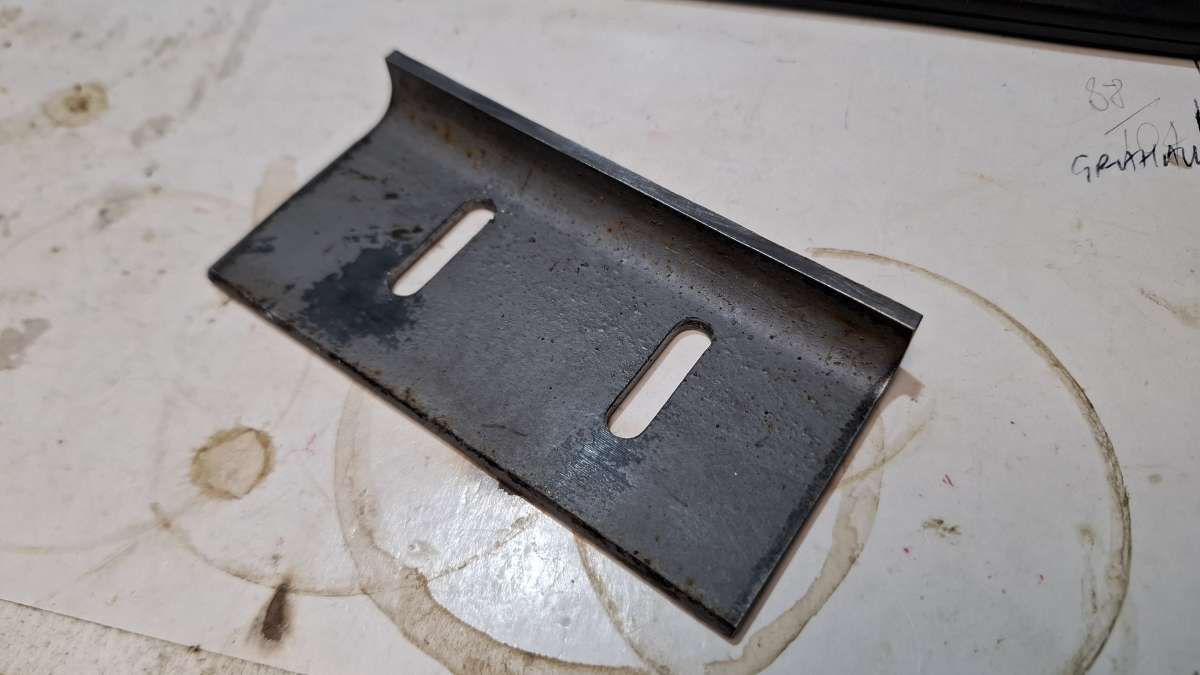

                                You may well find that you’ll get better results forming a slot with a dedicated slot milling cutter with, say, two flutes, rather than the four-flute version shown in your photo. It would obviate the need to drill a series of holes to be joined up later.  Often, the slot is formed undersize in width and widened to finished size afterwards, depending on the accuracy the job requires.
                                #792690

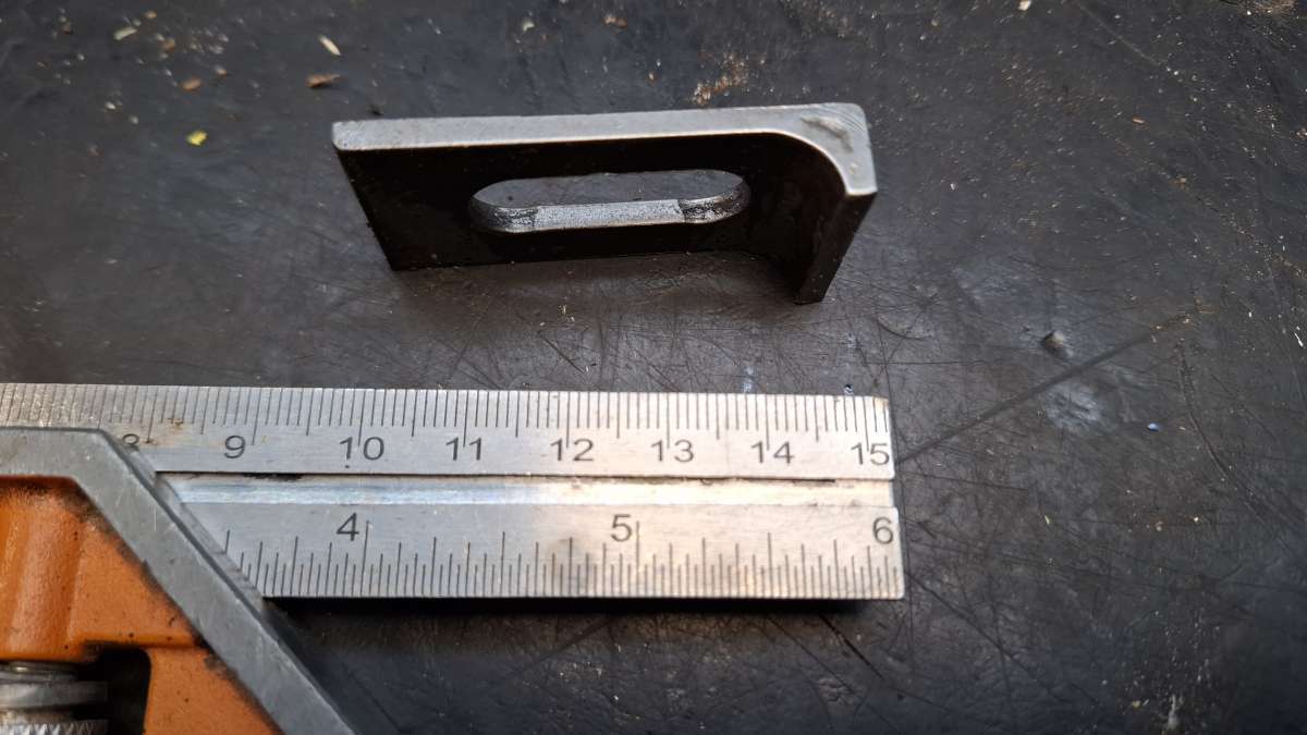

                                  Here’s V2.
                                  No pilot holes this time and using the 6mm 4-flute cutter I milled the slots in 5m passes.
                                  The slots ended up being around 6.15mm.
                                  I’ve also got a 6mm 3-flute cutter (ARC 060-283-05006) which I’ll use on the next one.
                                  With skinnier slots and a wider body overall it should be more ridged..

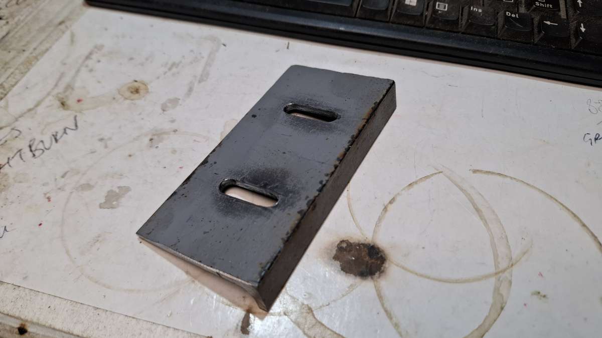

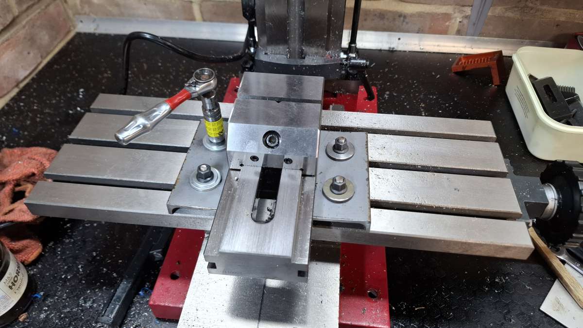

                                  nevillet
                                    @nevillet
                                    Job done.
                                    2 of 2 made.
                                    Many thanks for all your help,
                                    It’s much appreciated.
                                    20250410_182543

                                      That looks tidy

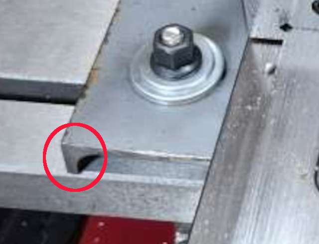

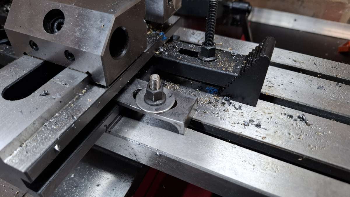

                                        There’s a risk the sharp edge of the clamp will damage the table.  Particularly as the tables of these mills are often unhardened – test  with a file.
                                        sharp
                                        Easy fix, reduce the pressure by putting a strip of metal, say 12mm wide, between the edge and the table.  Almost any metal will do.
                                        #792739
                                        Clive Brown 1
                                          @clivebrown1
                                          I would slightly alter the slot length aad washer diameters to get the studding as close as practicable to the object being clamped. In this case the vice. This ensures that the clamping force is being exerted mainly where it’s wanted. It also has the secondary benefit of reducing the force that could damage the table, as per SOD’s remark.
                                          Small point but why not?
