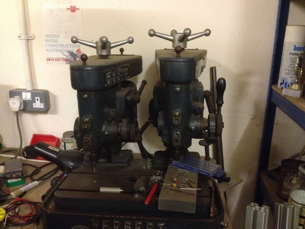

      About 15 years ago when visiting a local scrap merchant which also dealt in machine tools I came across 2 Herbert Type B machines for sale at ridiculously low prices. Unable to resist a bargain, I think that I purchased both for about a tenner for the two, I took them home with the intention of restoring them & putting them to good use in the workshop. However, as happened with a lot of things, work & family pressures deflected me from my course & it is only now, after retiring, that I can see my way clear to doing something about them in the coming weeks or months.
      I have seen in the albums that member Ian Parkin posted in 2015 when he uploaded a series of photos of the restoration of a Pollard 9FX machine which appears to be identical in every way to the Herbert Type B. I believe that it was also re-badged & sold under the name plate of several other manufacturers. Has anyone else either got a similar machine or has had one in the past? I am interested in the work that Ian did to his machine but cannot find any forum posting devoted to it. I have Emailed [email protected] today but being a Sunday I don’t expect to hear from them immediately.
      Any information will be gratefully received.

      #13091
      Brytech
        @brytech
        Herbert Type B
