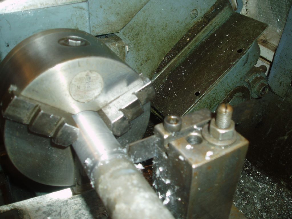

      Hi all,
      I'm new here, all the google searches led me to this website, so i thought of joining and asking for a little help…
      I'm not a model engineer, but looks like you guys use lathes a lot, so are probably the best people to seek advice.
      I recently bought a Myford ML7 to help on some work I'm doing on a 1976 and 1979 Harley…
      Its my first lathe and completly new to this type of engineering, have read a lot and watched a lot of youtube videos…. but there's stuff that you can only resolve if you have someone to ask..
      So, I can do the turning and facing pretty good now..but parting is nowhere to be seen…
      I just can't do it at all.
      I've tried at high speed, low speed, centre height, just a litte below….and nothing, just get chatter.
      I did manage to get a few nicely formed cuts coming off today, but promplty followed by a lot of chatter…tried easy on the feed, hard on the feed….
      Basically I've tried everything and I dont know what else to do.
      I'm trying to cut a spacer out of a 24mm bright steel rod, which already has a 13mm hole through it.
      I have a quick change tool post, that I've lined the centre height with a dead live centre on the tailstock…
      I have 10mm shank tools as that's what my tool post can take.
      One is carbide, the other is a thin HSS blade, not very wide… chatters with both.
      Both tools were completly flat on the top and after seeing some videos on youtube where the top had also been ground for clearence, i did that on the carbide and that's how i managed to get the few nice chips coming off…

              Parting off is the most difficult thing to achieve on a hobby lathe
              All part of the learning experience
              If everything isn't just right, and I mean everything, it won't work
              I can only do it with the backgear engaged and an upside down tool on the back

                Use the backgear and plenty of cutting fluid.
                All that has happened by you moving the backgear lever alone is the backgear is engaged but cannot turn as it is also engaged with the spindle.
                To engage the backgear on an ML7 raise the lever closest the chuck and also loosen the allen screw and locking dog away from the spindle (this screw can also have a bolt head) lift the belt cover and you should see it on the face of the big gear you may have to cut an allen key down to suit the available gap.
                Lubrication some have an allen screw and some an oil nipple which must be lubricated to allow free running of the backgear against the spindle shaft.
                If it still wont turn the backgear could have gummed onto the spindle, check for missing/broken teeth also.

                  Assuming your ML7 is not completely clapped-out, you should have no difficulty parting off if you follow these simple steps:
                  (1) Buy one of these: **LINK** This is by a large margin the best parting tool I have found at this size, and I tried quite a lot before I found it. The shape of the tip is the vital thing, it curls the chip so it is narrower than the gap, which totally avoids it jamming in the gap (the cause of many of the problems, especially with steel).
                  (2) Set the tool up in whatever you use as a toolpost – it ought to be as rigid as possible. And – this is most important – make sure the tool is exactly square on to the lathe axis.
                  (3) Locate the tool where you want the cut to be.
                  (4) Lock all the slides you can, other than the cross slide.
                  (5) Select a fairly low speed. In the bad old days, using old-style tools, I used backgear, now I just use a low direct drive speed.
                  (6) Switch on and advance the tool into the work. Don't hesitate, feed slowly but firmly (having the tool rub does nothing any good – and for work-hardening materials like stainless steel or titanium it is disastrous). For mild steel, drip feed neat cutting oil on to the work – every few mm of cut should be enough. For other materials, use oil or not as suits the material (dry for cast iron or brass, paraffin for aluminum, neat cutting oil for most others).
                  If this does not work well, your lathe may need a check-up.

                          One problem many people have is being too cautious. If everything else is apparently right, it may be that your early problems have made you over cautious. One thing though, as TerryD has pointed out elsewhere, as long as you have enough power available the SMALLER the diameter, the trickier it gets.

                              My ML7 jumps about like a mad frog when parting, I find the best way to deal with it is to go steaming in (so to say).

                                I could never part off with any success with a highly modded ML7, there was way too much flex. The only relative success was with cobalt tool steel ground up 1/16" wide, but could only go so deep, not the 5.5mm required here without probs.
                                The only tips ever broke are when using too slow ie less than 500 rpm, couldnt catch in time.
                                Just gave away one of those Sandvik part off tools, had it 20 odd years even in the ML7 days. Current machine at best because couldnt generate high enough speeds so kept binding up. Swarf down the sides etc jamming. Plus it always left a right burr on the part wanted so had to centre up and bore at an angle knocking burr off. Glad to see back of it.
                                Just accumulated 10 Iscar and Arno cutters of various designs and types of tips, like chalk and cheese compared with above Sandvik. These are meant to run like all others in excess of 2000rpm with coolant.
                                Ever wondered why you can start to part off, go in a certain distance then plays up, its the heat.

                                  Try steading the workpeice with a centre in the 13 mm hole in the tailstock.
                                  rear post Or part off from the back .

                                    The Q-Cut has a 12 mm shank, but it is quite easy to get the right height in my S00 (Myford size) Dickson setup.
                                    I have a number of Glanze tools, including a slightly larger version of the Q-Cut, on my M300. They are OK, but don't have quite the same quality. The toolholders are not bad, but the normal turning tips seem to break more easily. Having said that, my Glanze parting tool parts off fine under power XF on the M300, which is of course a much bigger and more rigid machine.
                                    Any parting tool will leave a pip somewhere. With HSS tools, you can make it be on the stock side by grinding the front of the tool at a slight angle – but then you will have far more problems as the tool will be pushed sideways on its way in.
                                    Parting off with a tailstock support is not recomended; you can use one part way into the cut, but don't forget to remove it for the last bit.

                                      Parting off from the back is a lot easier on an ML7 if using a rear toolpost and can be carried out using cheap HSS tooling, some years ago I bought a HSS rear parting toolpost (from RDG I think) it was such a great success I fitted it with an adaptor plate and use it on my Boxford lathe too, it is in very regular use and only requires a lick on the grinder every now and again to put the edge back.
                                      The Boxford will depending on material part stock using the power cross feed using the same rear toolpost.
                                      As Nobby says why not use a centre in the tailstock to support the work as long as you dont cut all the way through thats fine, finish the last bit with a hacksaw and face off if you need to.
                                      Plenty of cutting oil always helps unless it's CI of course.

                                        Using a tailstock centre is pretty much an essential part of learning about hobby lathes
                                        They greatly increase the stiffness of a workpiece for any job at all

                                          When parting off an unsupported piece, the piece being removed falls away cleanly causing no damage. If you complete the parting with a tailstock centre in place, the piece being removed cannot do this, and will fall sideways trapping the tool, causing damage to the work and possibly breaking the tool. Still, if that's the way you wish to do it, it's your choice.

                                            So cut it down to a pip, then remove the tailstock support

                                              I thought I did. I haven't had any problem parting off since I started doing it the way I set out above.

                                                Sorry I should have menioned . Remove support before final seperation . As Ady1 says I dont know but is there some thrust bearings on the ml7 that may need adjusting or shims to be remove to help the headstock to be more rigid when parting off. My myford is a s7 mark one and i always try to part from the back . But DONT try and part from the front with the tool upside down & the lathe in reverse as the chuck is screwed on one . and will unscrew when cutting. Awaiting flack?

                                                    I used to have a problem with parting off on my Myford , I tried various parting tools, hss,carbide and a tipped parting system ,these all failed and through research and trial and error ,I found that the following all contributed too ' chatter ' spindle speed, width of parting tool, work piece support and lack of coolant.
                                                    through my own experience the latter all helped , a low spindle speed ,a form of coolant ,I use wd40 on aluminium, a thin parting tool ie 1.5 mm ground from hss and locking the saddle and parting off as close too the chuck as possible all helped ,personally I found a rear tool post has to be the most effective way of parting off , also intermittent cutting causes bad chatter .
